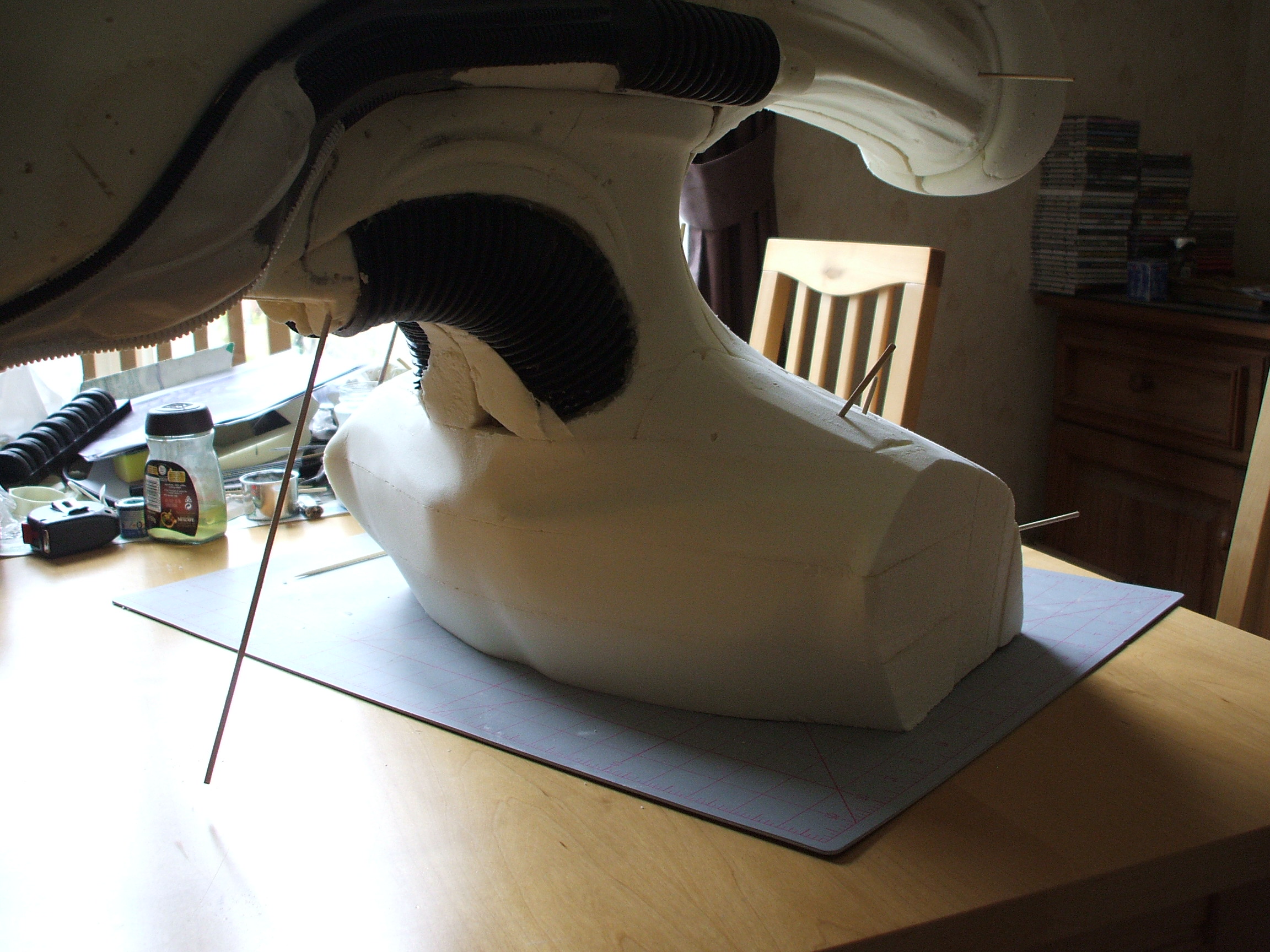

It does look better with the head on:
All Glued now, I'll see how it is in the morning, gotta find those muscles in the foam & then on to some detail :)

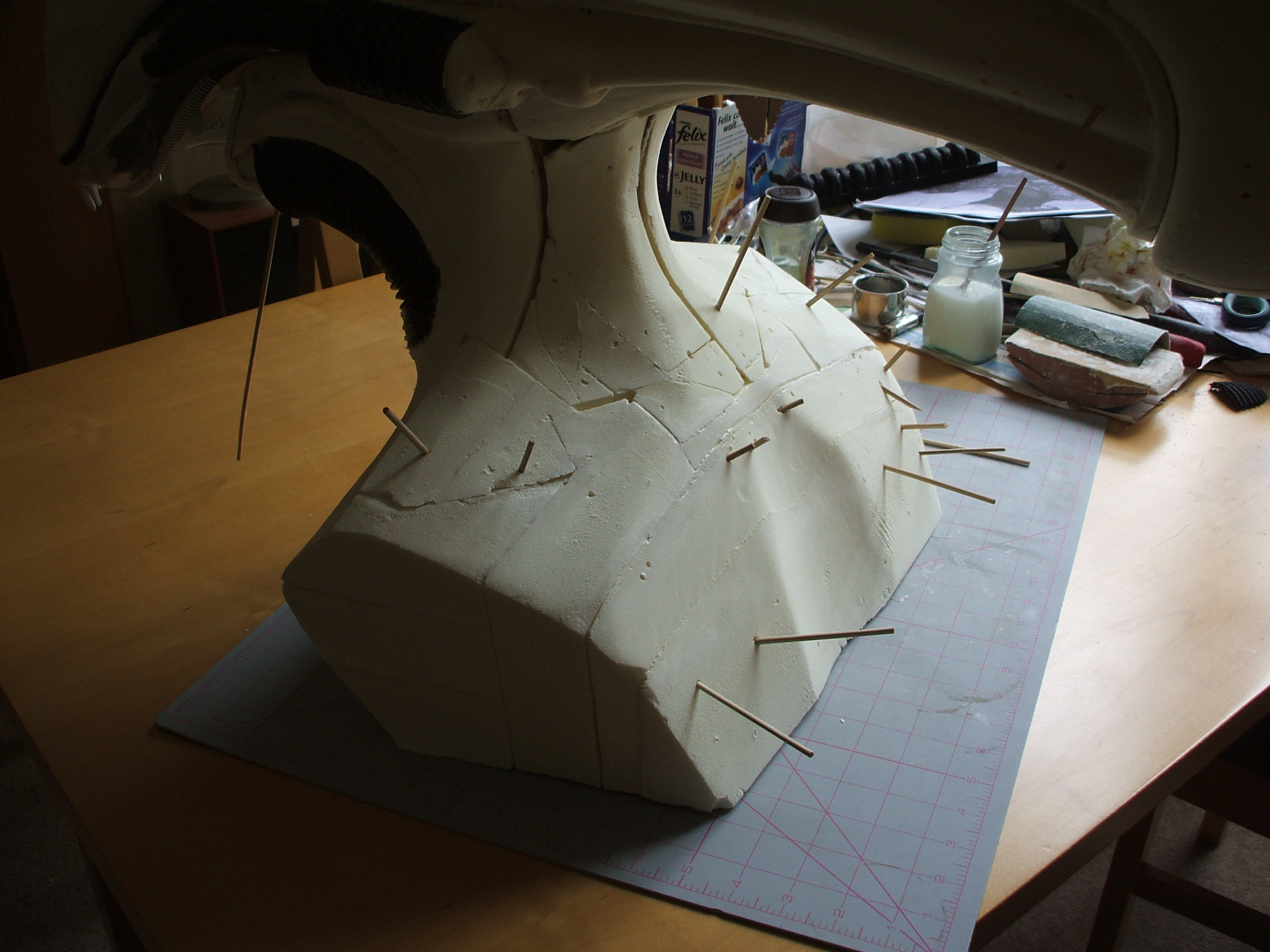

Done a bit more shaping up this morning but I'm back to wet glue again, the PVA only drys where the air can get to it so I have to do a bit then wait before I can do a bit more, Its comming along though slowly.
Leigh
Re: Bob the Alien creature
He now looks as if he was acting as a shield for Indy at the begining of Raiders....Didn't get much done yesterday but heres the latest:
The glue's dry enough to carry on now & a little more shaping up is needed before I start adding Alien features.

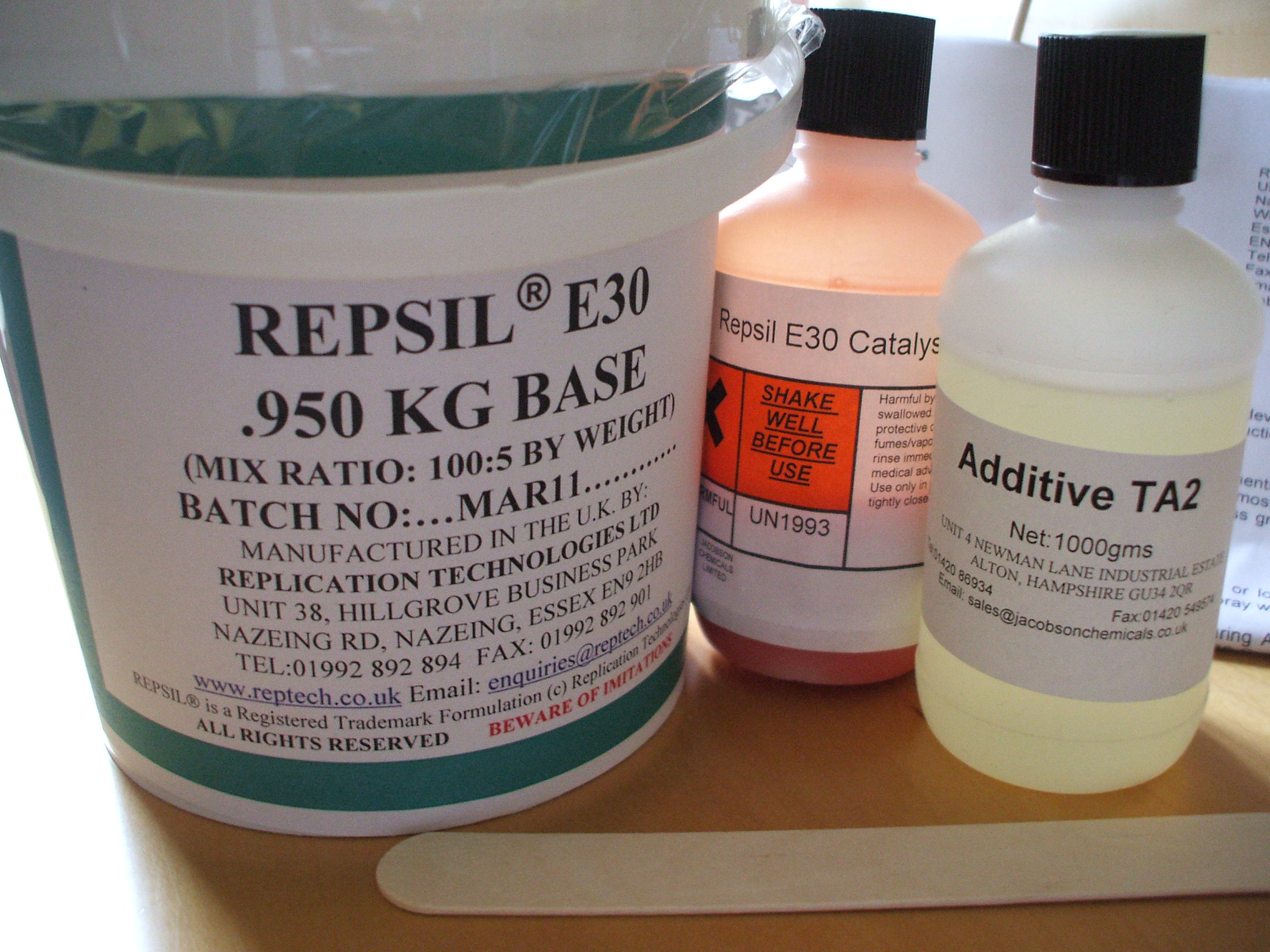

This turned up this morning:
Silicone, Catalyst, Thickener, Spatular & a set of instructions. It'll be interesting to see how this jaw moulding comes out, the clay I've used is "Newplast" there should'nt be any reactions as its sulphur free but we'll see.

Not knowing to much about the whole art of sculpting, I have to ask. What are the sticks for ?
Holding it all together or there to add stuff to ?
Leigh
The sticks are for pinning the foam together while the glue dries, They also make for good reinforsement in structurally weak areas.
They're "Barbecue Bamboo Skewers" bought from Wilkinsons for 50p, they're 10" long a little over an 1/8" in diameter & pointed on one end in packs of 100. I break them to length as I need them & re sharpen, I also shaped a couple of them for using as sculpting tools for the clay as I dont have any proper clay sculpting tools.
Edit: I also dont know alot about sculpting, I'm learning as I go, This is my first sculpting & moulding effort but I am determined to do a good job of this.

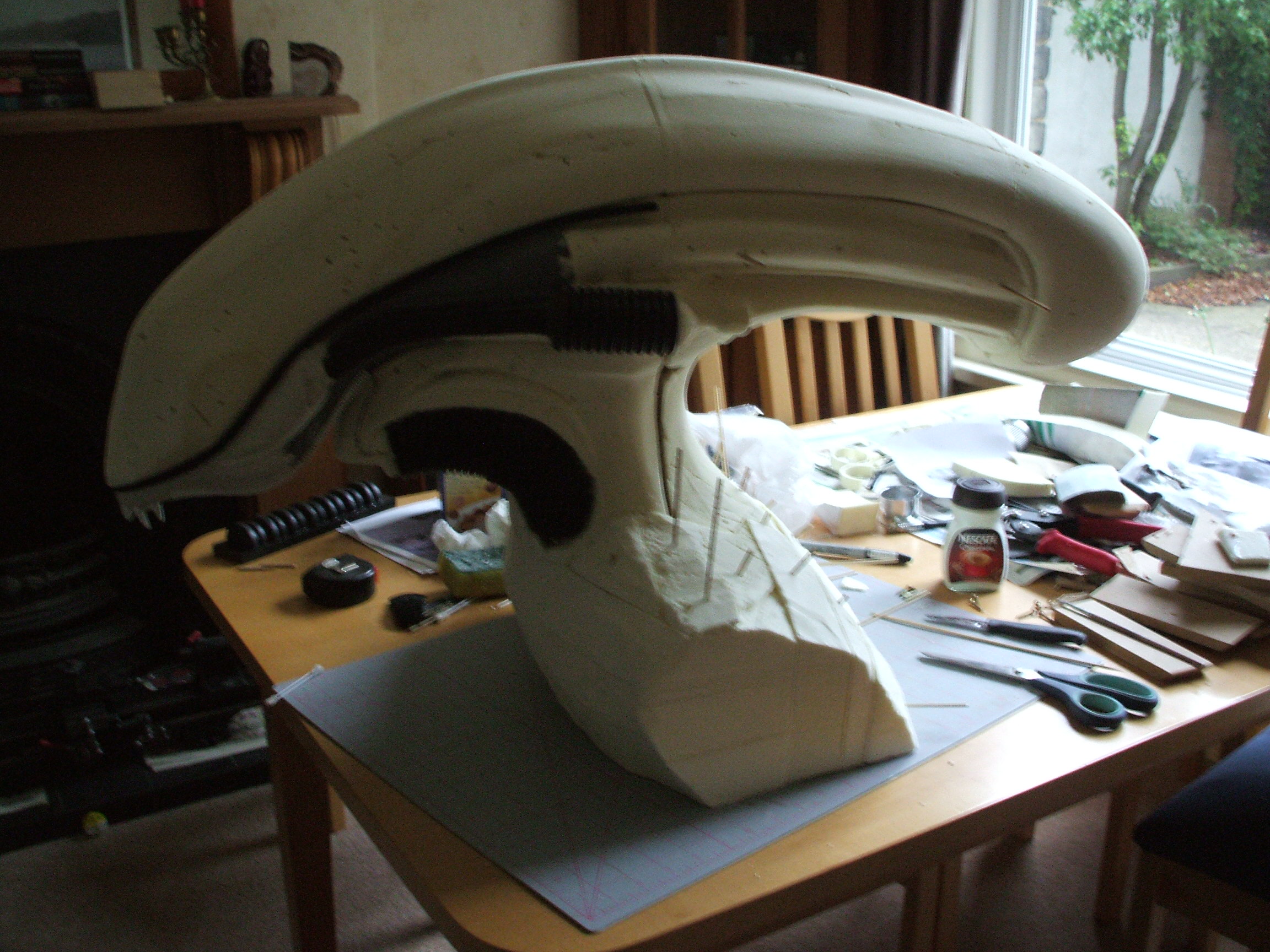

Had a play with one of the pic's I'd taken, I'm not very good with paint programs but I was looking to get an idea what he'd look like with he's lips, tendons & he's top cowling brought down to cover the convoluted pipe that runs arround the head. I'm really looking forward to reaching this stage :)
Its rough but It gives an idea to what I'm aiming for

Cheer's, I figured it was probably not the most conventional way to do this but there is a method to my madness.
Firstly the cost, the materials I've used have been very cheap & I've been able to buy them in small quantities a bit at a time which helps to spread the cost.
Secondly my inexperience, I've not done this before & I wanted to pre-visualise it, I wanted to make sure the parts fitted together properly & it also means that I can perfect the shape (to my taste) while its easy to change it. Once I'm happy with everything I can seal it & add a layer of clay & the pipework for the final detail.
Another bonus is that its light weight, I was concerned that if I'd made it out of a solid lump of clay it might have distorted under its own weight :confused. Its also easy to move about as I'm making this on the dinning room table :D
