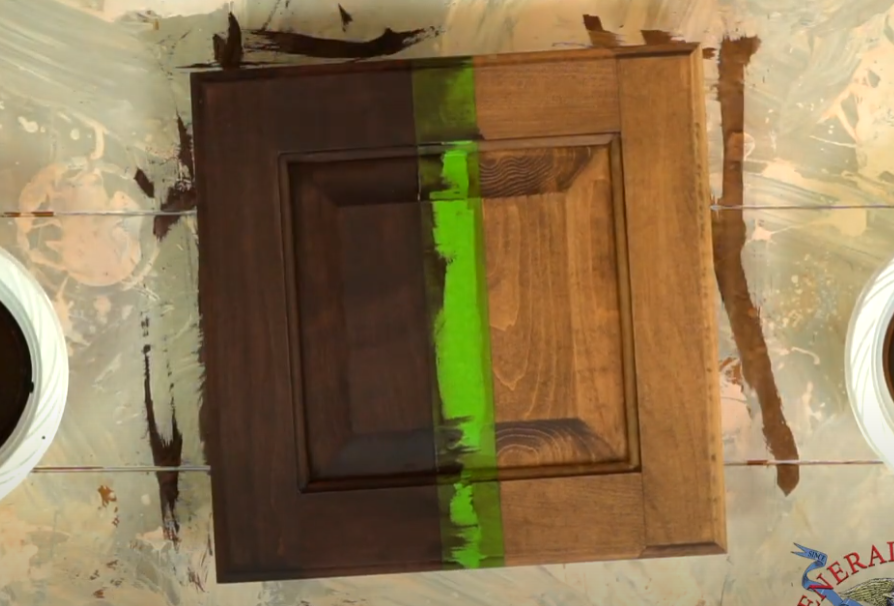

You may want to try a trick we used for getting perfect sunburst finishes on guitars every time:
First you seal it with your sanding sealer.
Then apply clear.
Then apply the tinted clear to achieve final color.
Finally top coat with clear to seal it.
This way, if you F-up, you can sand it back and never touch the wood.

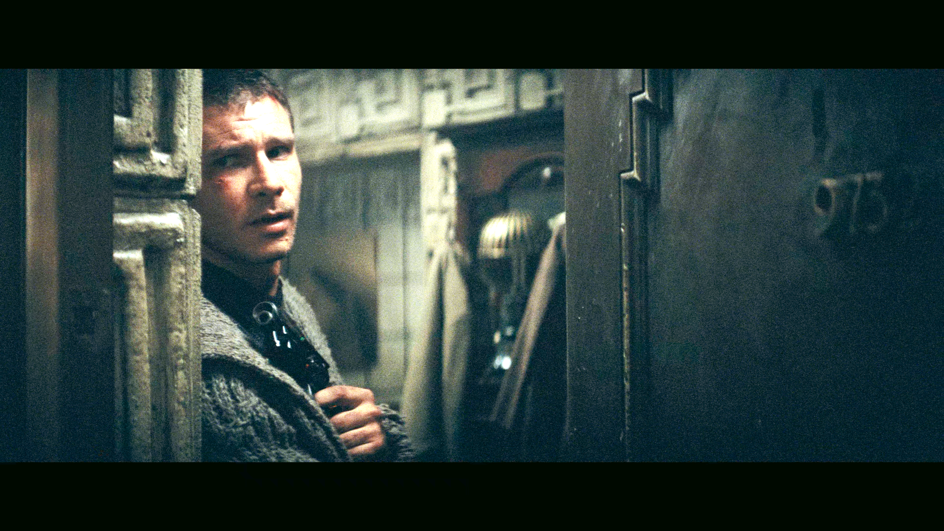

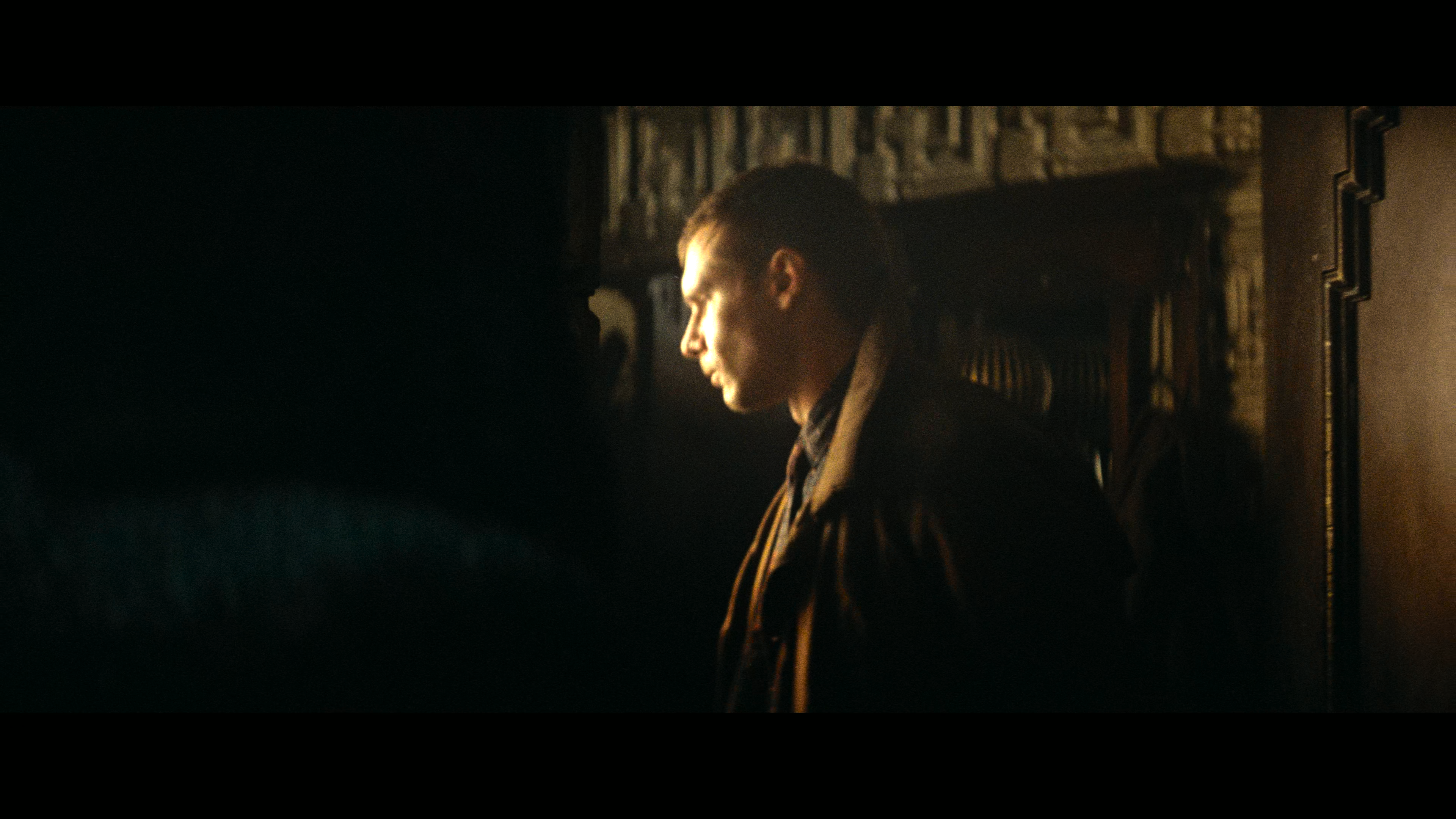

Thanks for the tips. I've been watching videos on staining Maple, trying to find one that's the shade I want so I can copy it exactly. The door is very dark. It might even be painted. So I'm not too concerned with it getting too dark. It's hard to tell exactly because the lighting changes so much and the film is so dark. Here are a few shots with different levels of the brightness adjusted that show the general color. In some scenes it has an almost espresso or ebony color and in others there's more red chestnut.

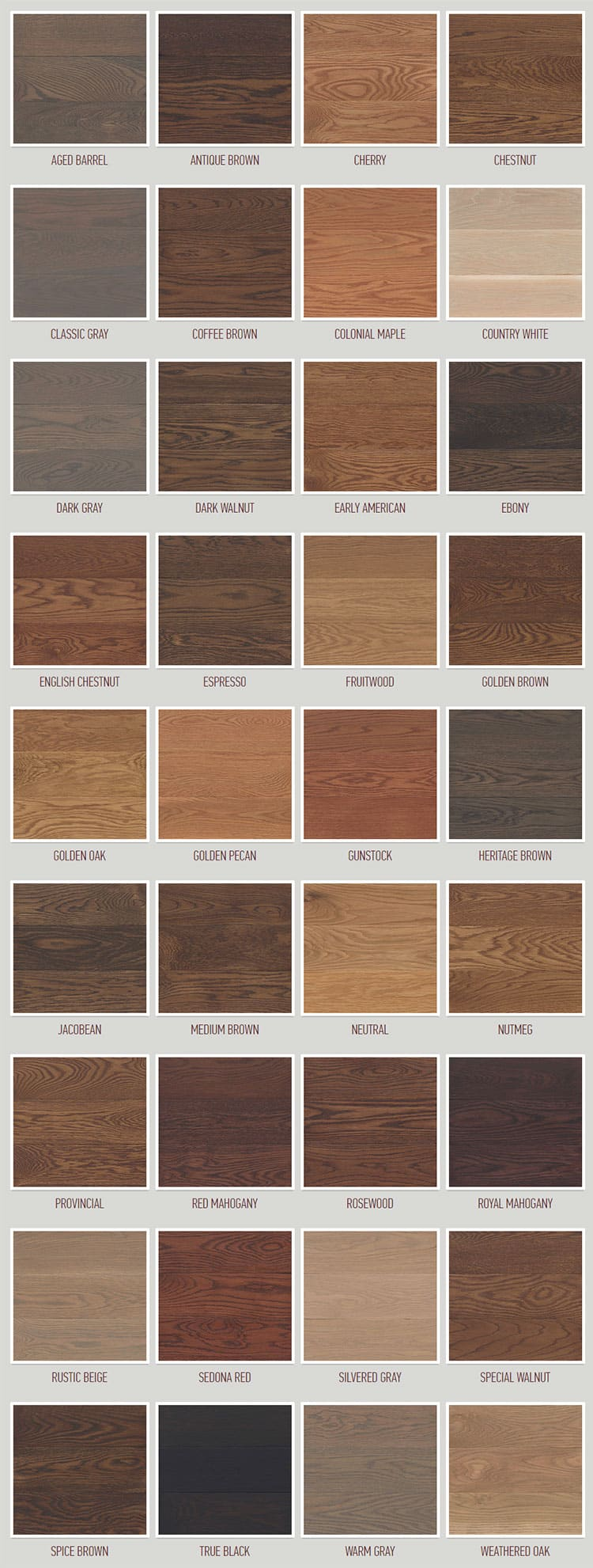

This example on the left is espresso on raw maple. Looks the part to me.
View attachment 1814608View attachment 1814609
I agree
Have you cleared it? That will darken it further.
Looks to be a matte clear- maybe try on a section of the stained board. That on the expresso will be very close (note the sanded trim corners for "wear" on the door- not sure if you are going that far, but if so, be sure to seal before you color!)
I was going to suggest Minwax "special walnut" stain, but I think you're in the ballpark.
And nothing says you can't mix a cherry into your expresso to get the redder undertones...
