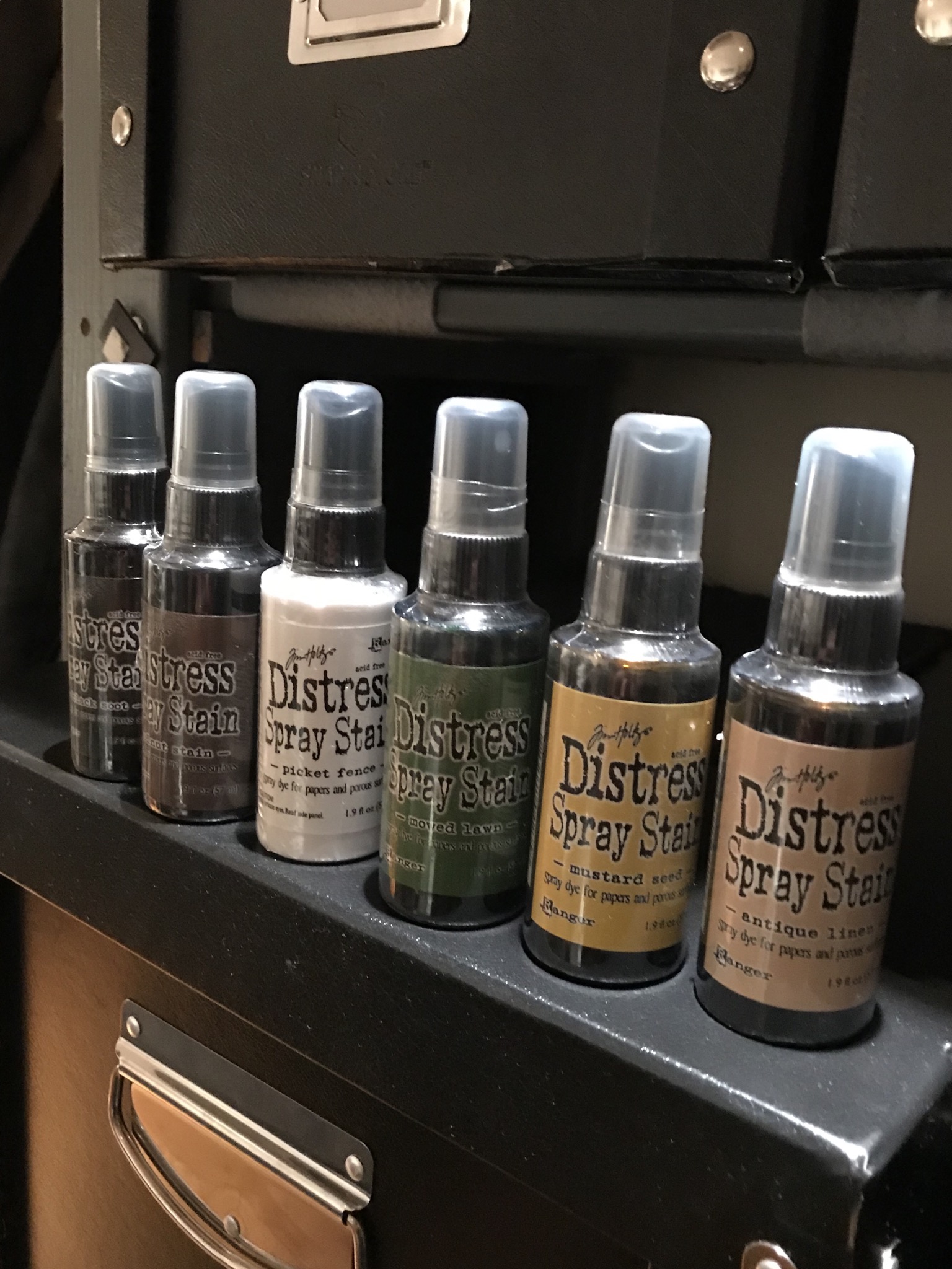

I plan on tackling the fur after the main jacket color is achieved. I took zlurpo’s video advice and acquired these distressing colors
Heads up, those are the same brand as the inks that I used, but I haven't tried that actual product. If I remember correctly they're more opaque than the inks, which means there's a chance they have more body/build to it, and could change the texture of the fur. Test it on a small inconspicuous area or a scrap piece of similar fur first!
Yeah I’m aware, I’m gonna give it a go and see what happens. I’d rather have to build up the color a little at a time .

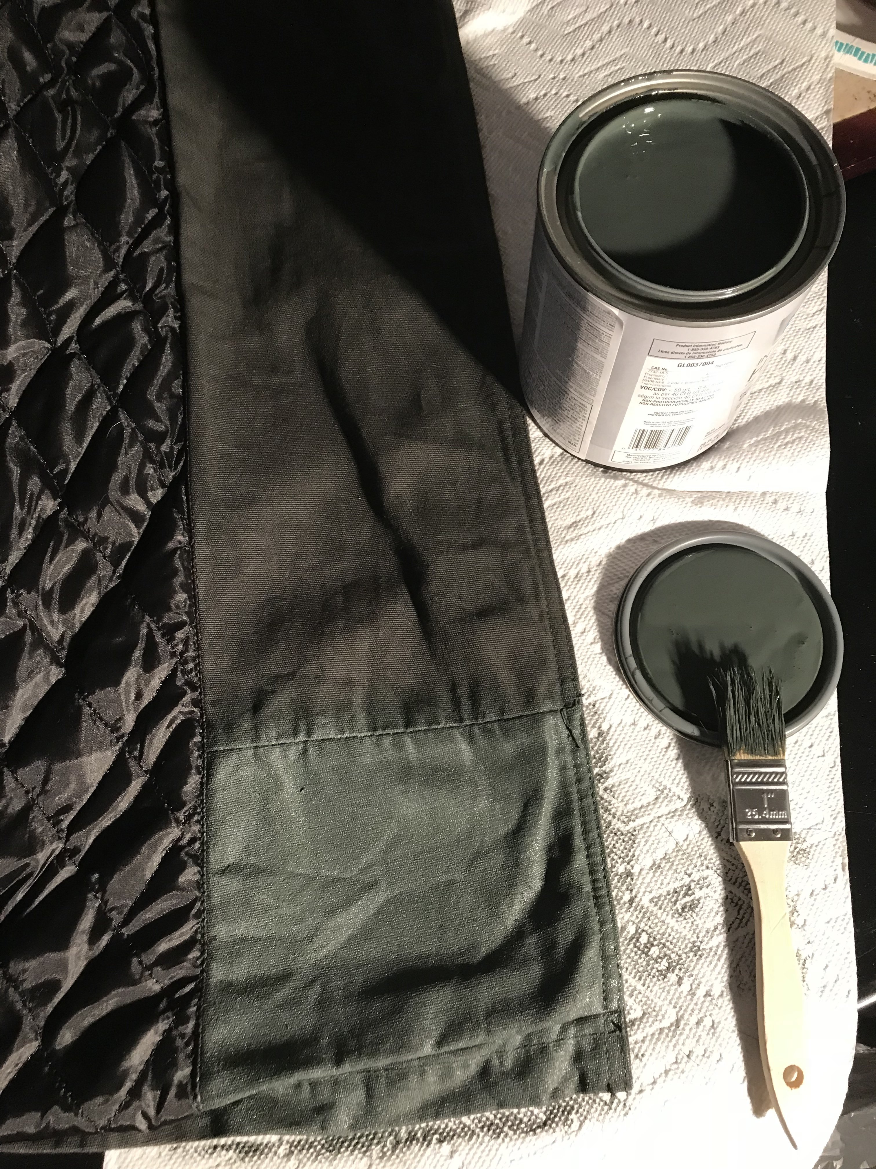

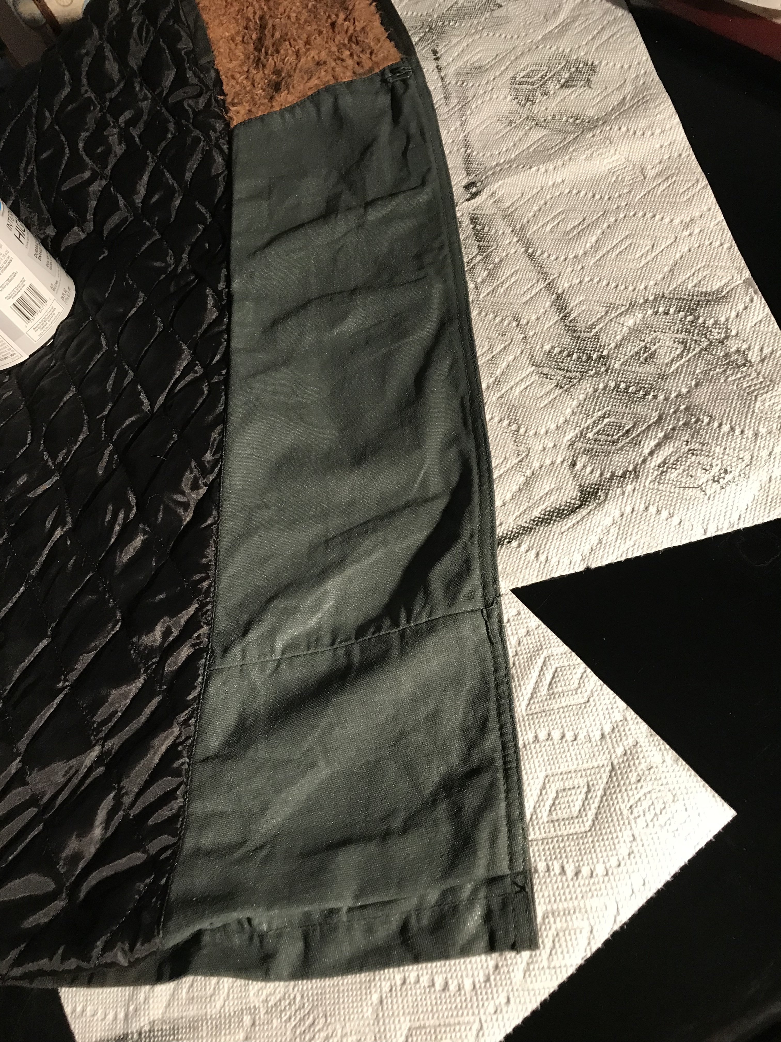

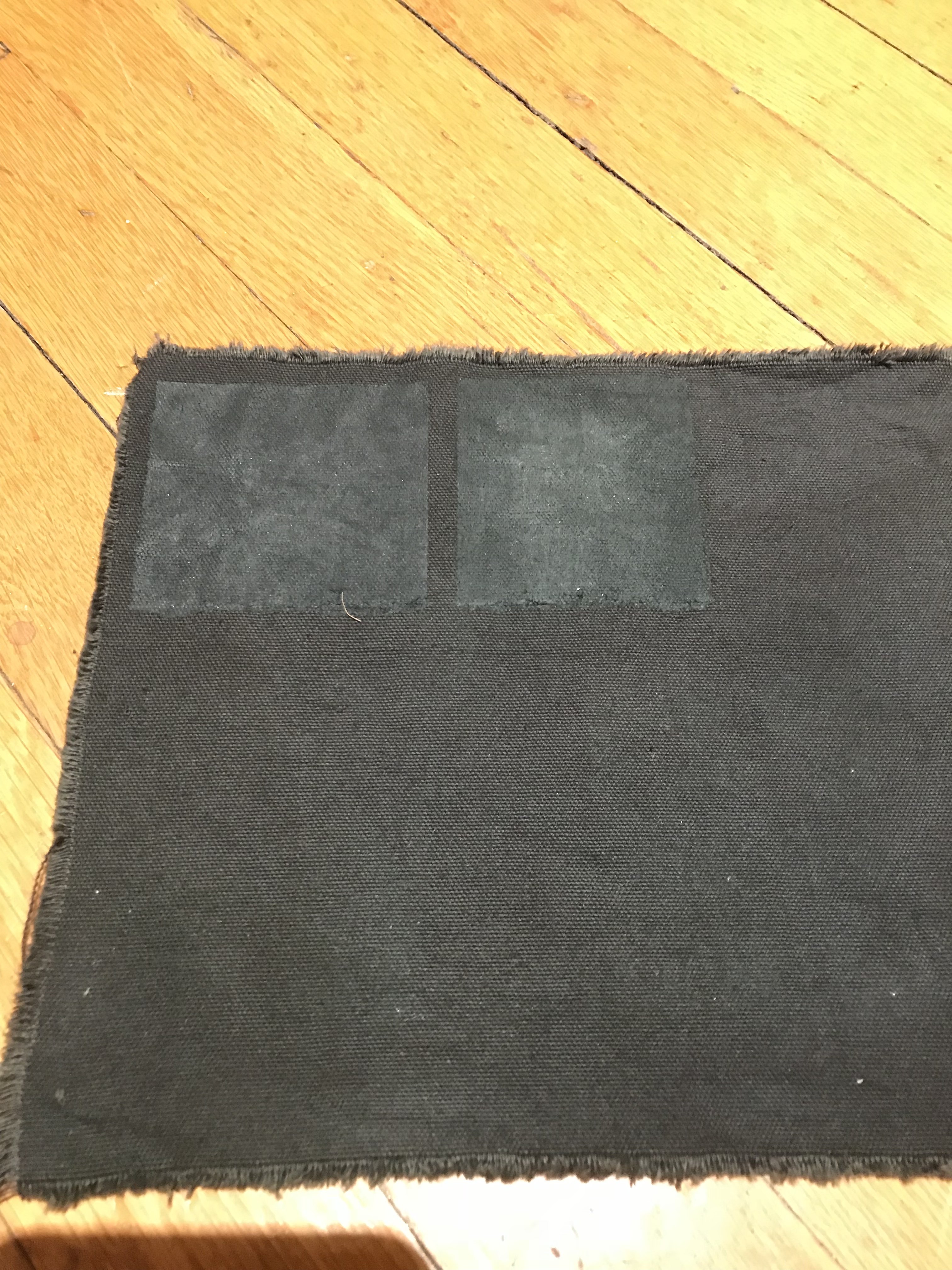

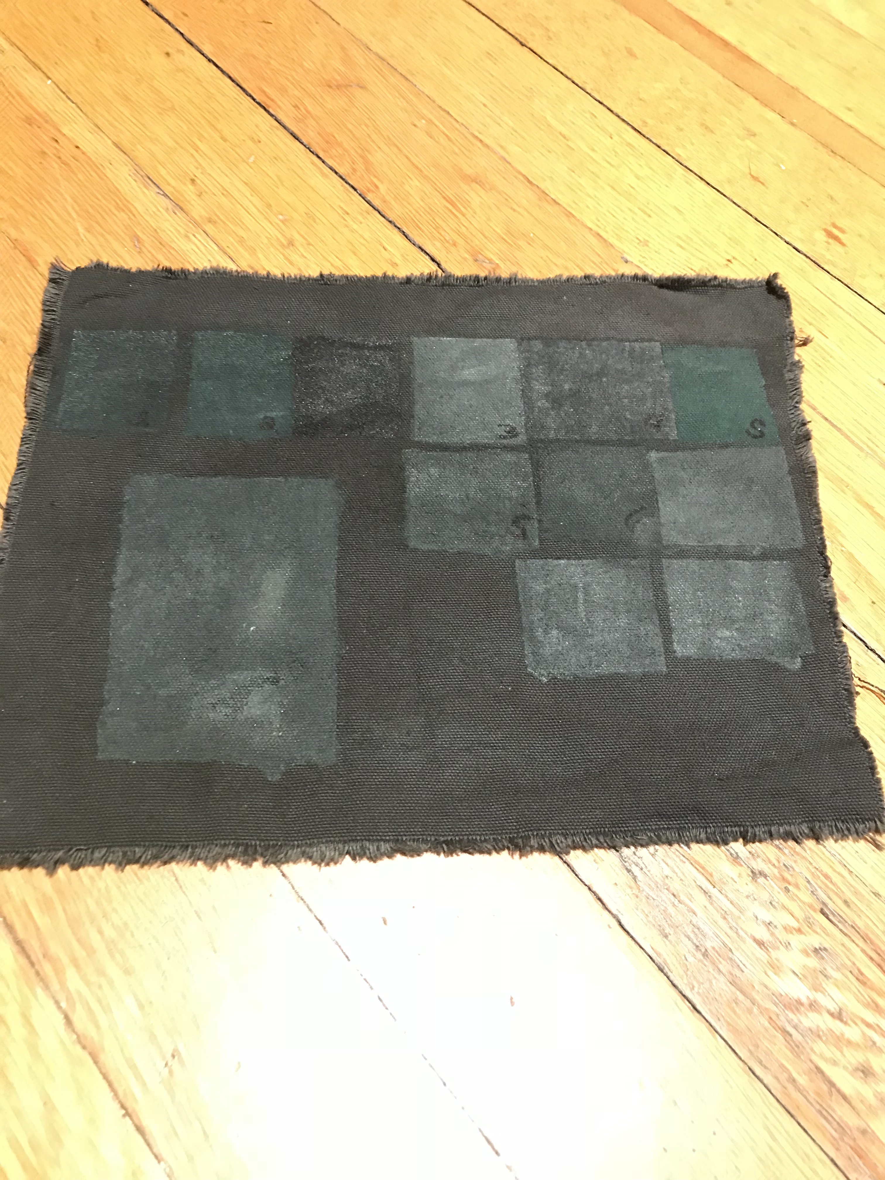

Operation “no return” has commenced.... I’ve started the lamination process. I did a lot of color tests with zlurpo’s sample fabric... and here’s what I settled on.
View attachment 795014View attachment 795013The large squares are my final color choice, and I know it’s a preference thing and I laid awake thinking about it.
View attachment 795015View attachment 795016Here’s hoping ... the color looks light under these conditions. However it’s a darker tone, and a high gloss finish... I’m gonna let it dry over night and see.... fingers crossed
So what is it exactly that you're painting onto the coat there? Is it making the coat incredibly stiff? Keep us updated on your progress very curious!

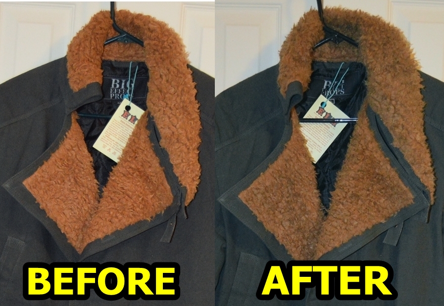

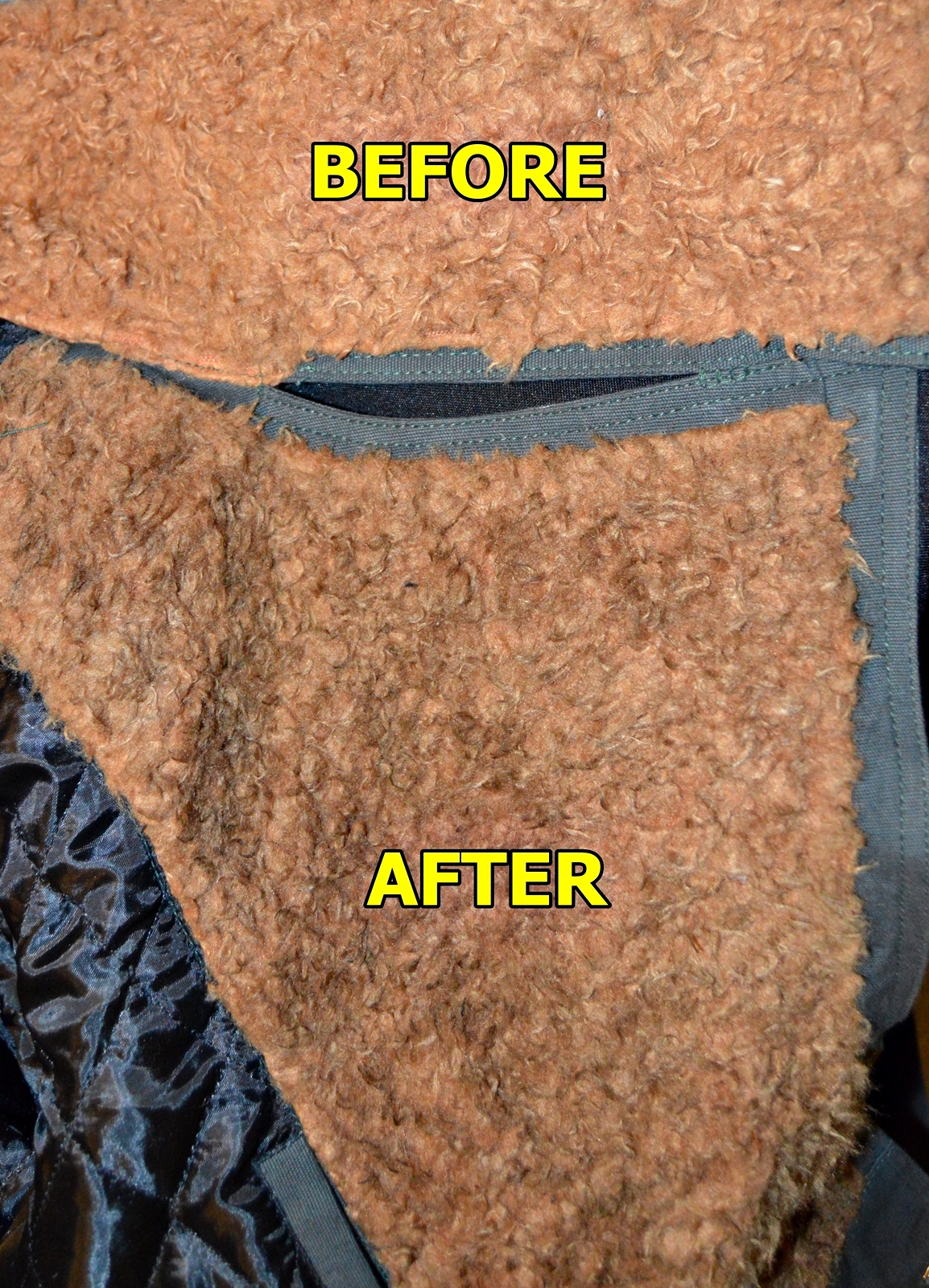

I just used Zlurpo's guide to dye my fur. In addition, I decided to add that oily, sooty look of the original prop. But I didn't want to overdo it. I wanted it to look a bit weathered, while keeping it presentable enough to wear. Here's what I did:
1: Mix 2 ounces of alcohol with 20 drops of red, 40 drops of green, and 25 drops of blue (as recommended by Zlurpo).
2: Spray the fur evenly, as shown in the video. Let it dry.
3: Make the formula again, but this time raise the blue from 25 drops to 40 drops.
3: Spray the fur. But instead of massaging it in evenly, just pinch/rub it along the tips of the fur, keeping the interior clean. Instead of darkening the fur, we just want to add a darker layer on top.
Here are the results:

How permanent is the dye? Will it run if it ever gets wet, like being caught in the rain?
The alcohol ink dye I used and suggested stays even if you run it through the wash with detergent, so I imagine rain won't do a thing.
I'm shocked at how well this dye adheres to the fur. I like to make replicas of movie props/costumes, and I have some experience with dying/weathering fabric. And these are some of the best results I've ever had.
Whenever you dye fabric (and especially synthetics), there will be a tiny amount that doesn't get absorbed. Each strand is like a tiny sponge, and it can only hold so much. So once you're finished, you have two options. For fully-dyed items, or casual clothing, you just wash them in cold water, then put them through the dryer. For partially-dyed, or dry-clean-only items, you can rub away the excess with a damp cloth.
Personally, I didn't want to put these coats into a high-heat drying cycle. So after waiting 24 hours, I just scrubbed the fur with a damp cloth. I was expecting a bit of dye, but the cloth remained almost pure white. To put it in perspective, I used two full bottles of dye on this coat, and after scrubbing it, there's less dye on the cloth than there would be from a single spray of the bottle. A second cloth came back clean. So I think the results are very nice.
I also experimented with my second coat, and went for a deeper, richer brown, with no weathering at first. And again, it came out perfectly. I'm still going to weather mine, because I think the matted fur looks far more authentic with a bit of aging. But I've now attempted a weathering, along with a smooth recoloring, and both came out beautifully.
I also tried a few new techniques that worked much easier the second time. I might write more details later, if anyone is interested. But to go back to your original question, yes, the dye adheres very well. Like any synthetic dye, it will begin to fade if you put it in the washing machine every single week. But I'd have no problem taking mine into the rain, or having it dry-cleaned, or putting it through a washing machine on a limited basis.
Of course, I'd advise against much exposure to hot water. Hot water fades synthetic dyes much more quickly. So if you wash it at home, use a cold cycle.
