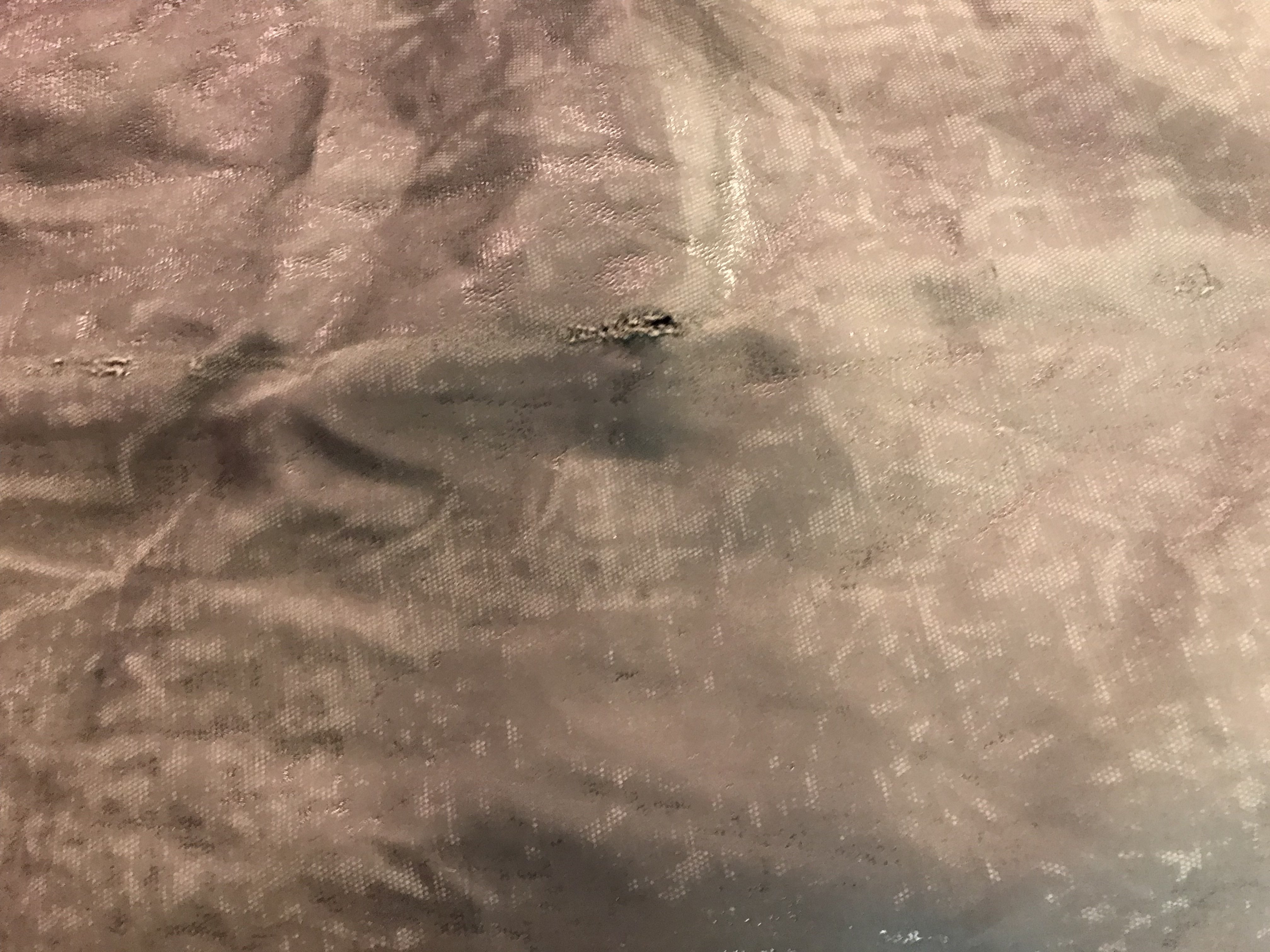

This is when you start sanding, again lay the jacket flat, work one area at a time, be VERY mindful of the seams.
This is is what happens if you spend too much time in one area and there’s a seam on the underside of the coat
I call this “battle damage”. Just be careful

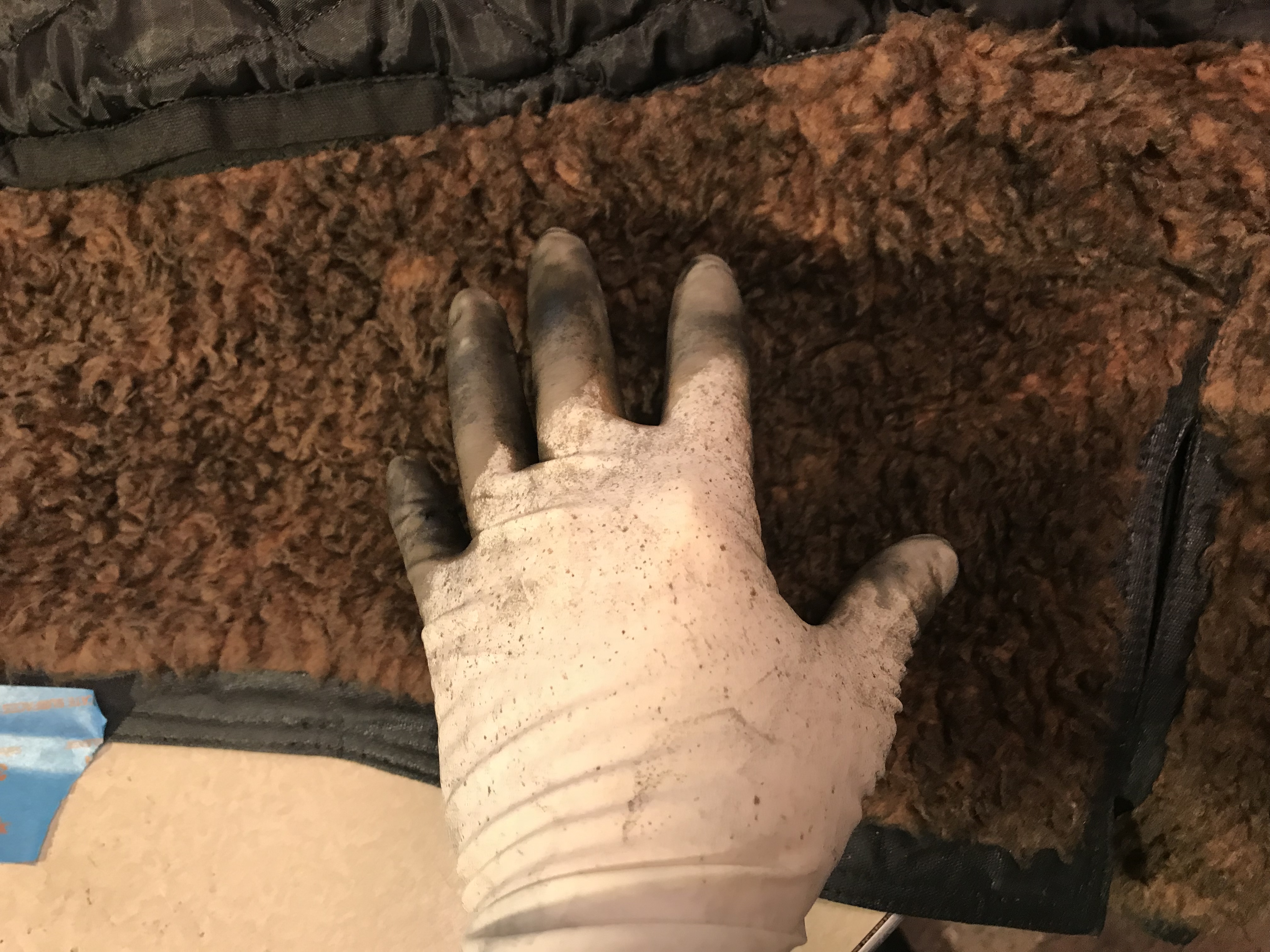

Step 2. Take the water squirt bottle and moisten the fur, no need to soak it just make it damp.
I then put on the rubber gloves. I test sprayed all colors on a paper towel just to get a feel on how it sprayed,
i misted just a small area of the fur with the mustard yellow to get a feel for the process. Mist the the whole
section and work it in with your hand, keep in mind you can blot the excess with a paper towel, move the fur
around, work the color. Next I misted in the walnut color,don’t be afraid, blot when necessary. Work in the brown,
Lastly, the black soot
Same thing, mist the whole area and massage it in, blot and add color as you see fit. Once you achieve
the color you’re hoping for, I misted the antique linen over the fur VERY LITTLEY. Repeat these steps
for all sections of fur. Once you feel you are complete,let it dry over night. The next day, take a paper towel
and rub the fur, more like dabbing the fur, this picks up any dye that didn’t soak in. After that, I tossed it in
the dryer on medium temperature for 20-30 mins. In hindsight, the walnut brown and black are really all you need.

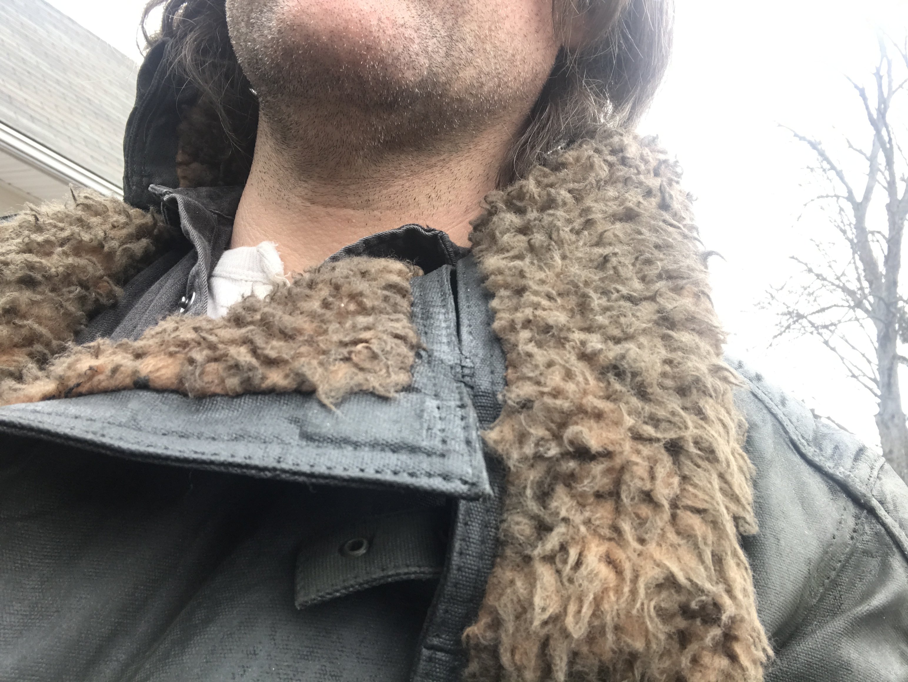

Here are he results
86481C9B-F6BA-4D82-898F-696261F7A521.jpegF211F7EA-CE78-46CC-BA5D-803D523C1009.jpeg7FB82F42-8155-4187-AA11-11EB5E60EEFC.jpeg54DEF471-E40A-405B-96D4-0D539CF87CFE.jpeg6A930E47-9FB2-43A0-8D6D-BD25296DAC0F.jpeg9430011D-B125-44DA-BE52-381D9E0DE9DD.jpeg44AE66C3-1BDF-4A23-B8CA-49EBC0CD17ED.jpeg89F824D4-C476-4FEC-83C6-80C5C1070FFA.jpeg
I took the photos outside on an overcast day. As for my thoughts on the process, it’s a little labor intensive, and there’s areas
you can’t just get right. The color I choose looks different once you see the whole jacket painted so beware of your color choice.
My color was a green olive almost black, I felt it was too dark, that’s why I misted the other spray can green over it just to bring
out the green hues. As for stiffness, it’s a little stiffer then I hoped, but it’s no stiffer then a heavy rain jacket. All in all, I give this
build a solid B. Thanks to Zlurpo and everyone for following. I would gladly answer any questions any of you might have. Also
I have no idea as to why the photos are misaligned, once you click on them, they right themselves, so please forgive me. Mike
