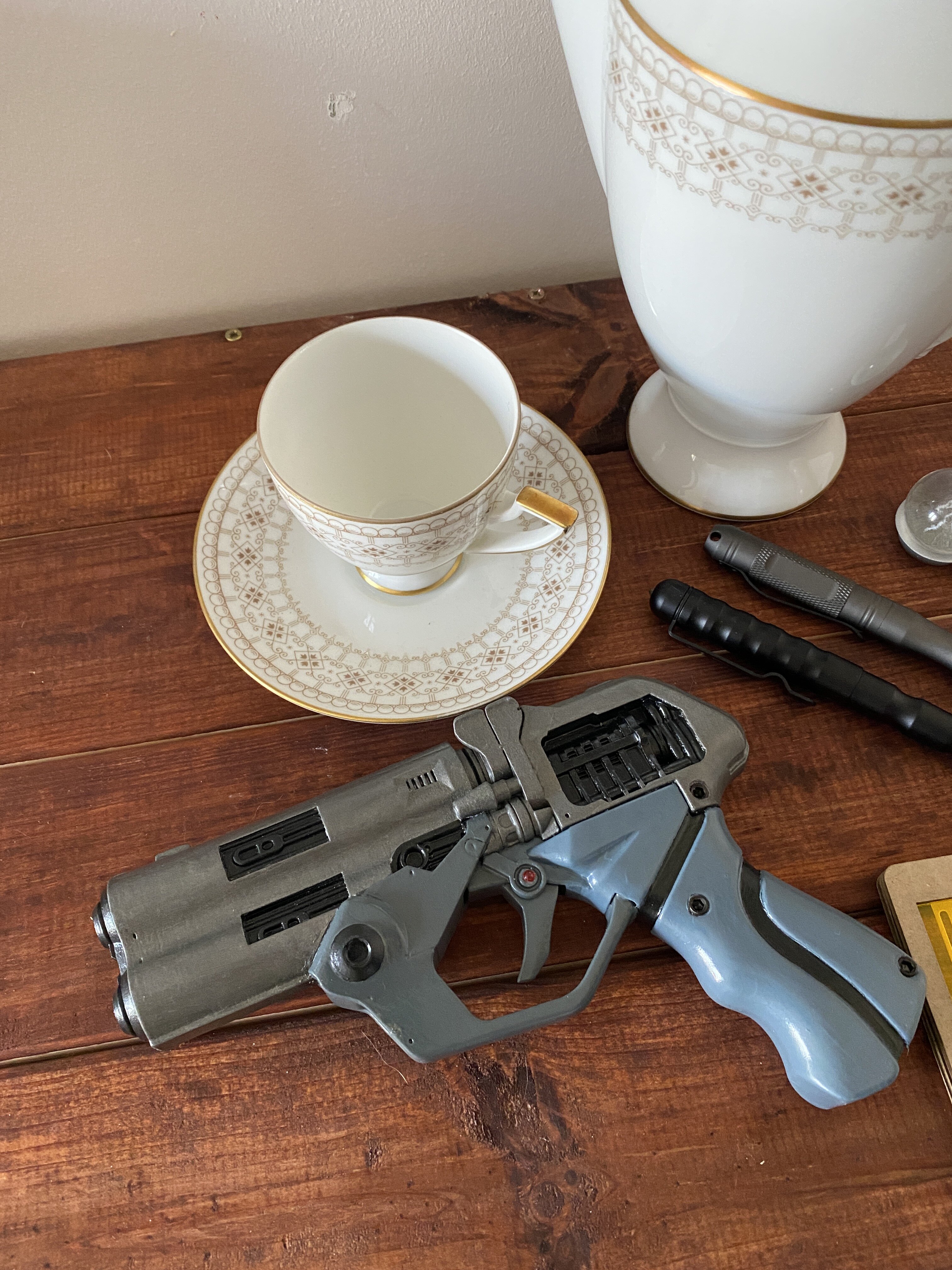

I spent an hour or so paint mixing this morning and then did a quick paint card to show you what I'm fairly happy with and interested in what you all think. This is under natural light and looked a lot better to the naked eye. I ended up believing the colour we're looking for is in between Vallejo Mecha Grey Green and Blue Grey (see below). I believe the 20% Grey Green and 80% Blue Grey is about right. I also experimented with adding some 'metals' into the mixes for the main body parts and believe the Steel from Vallejo works fine for me; this is just a tiny amount to make the mix more grey.
What do you think?

Looks good! I found that you are looking for a grey with blue and not a blue with grey, if it makes any sense :D so your 20/80 is almost too blue, I would bet more on the W. steel you have there :)

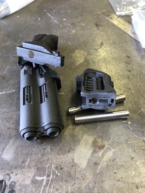

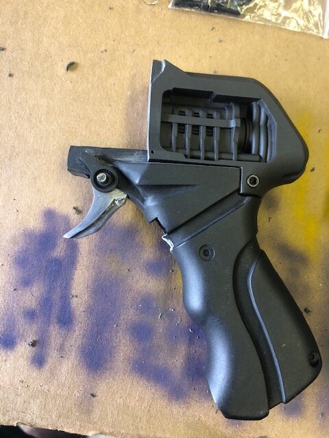

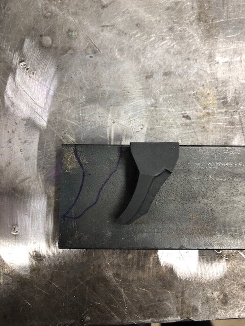

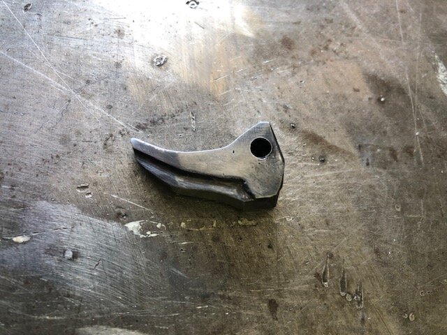

I like to put as much metal into a build as I can for the look and feel of the weapon. Unfortunately, there aren't a lot of parts on this that are easily replaceable so I settled for the trigger and drilling out a bunch of the kit and adding some 3/8" rod for weight.
Cutting out the shape and getting to work with the dremel
Some clean up and a test fit before bluing

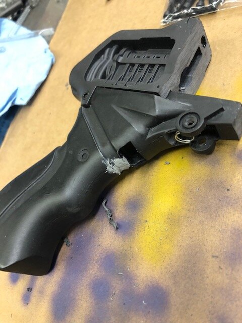

As I said, this kit is very nicely cast. The only bubble I had to fill was just under where the trigger guard meets the grip.
I drilled out the barrels and into the grip and rear upper to add weight
I couldn't reconcile getting LED's into the trigger pivot and get a working trigger as I've seen on other kits, but I came up with a compromise.

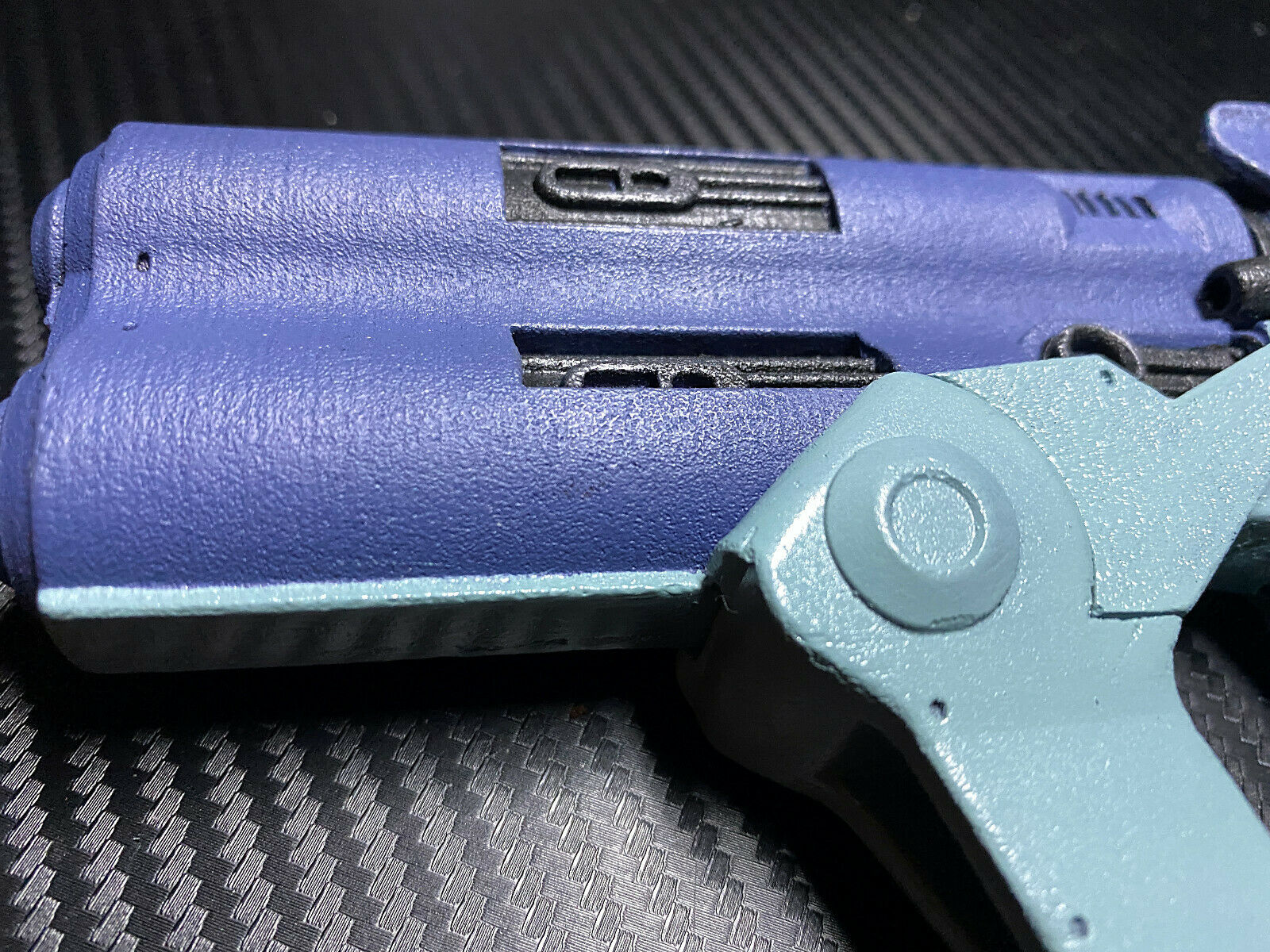

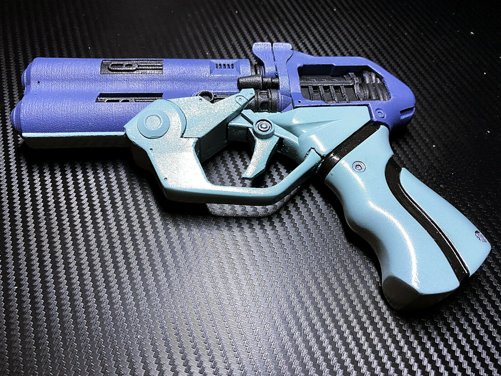

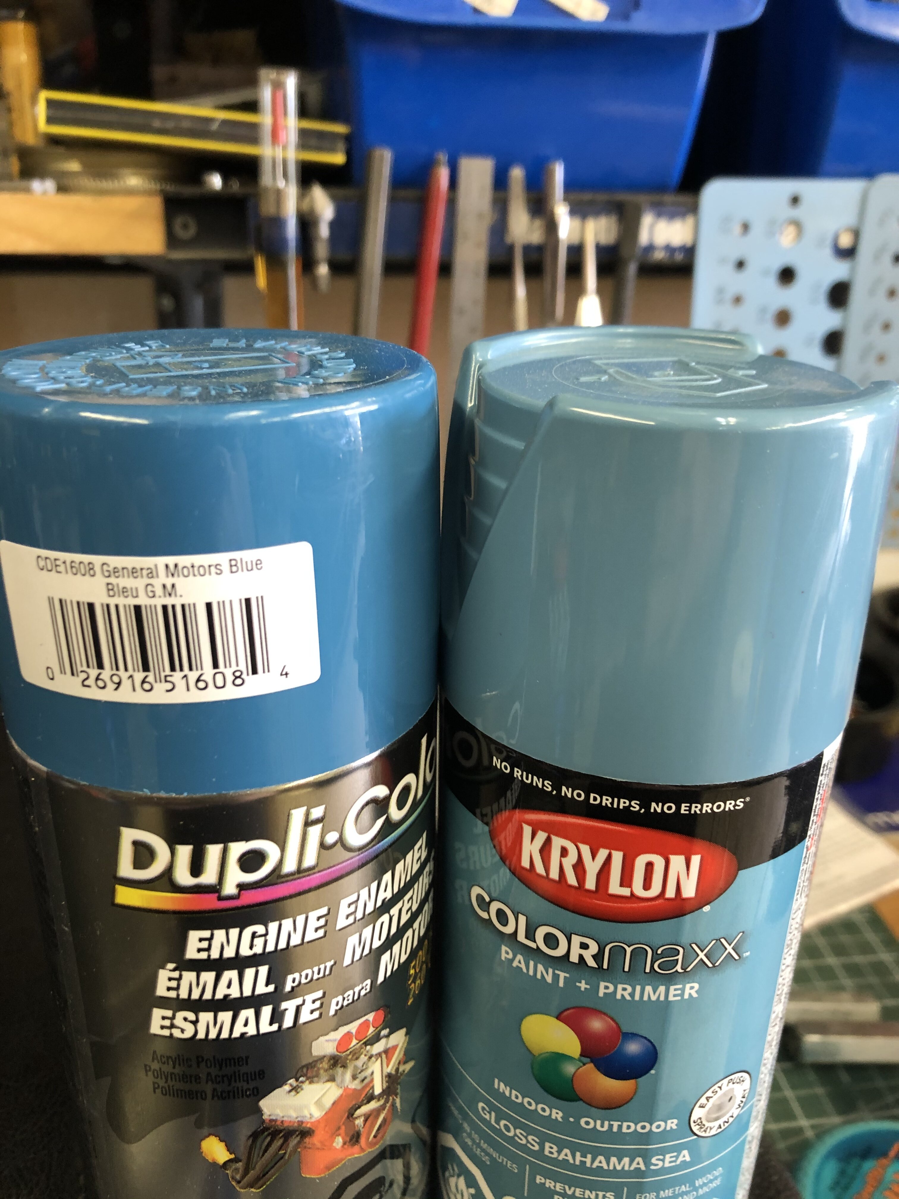

I think I’ve settled on my colours.
the blue is the hardest. I narrowed it down to 2. Dupli-color GM blue and Krylon Bahama Sea. I think the Krylon is the ticket.

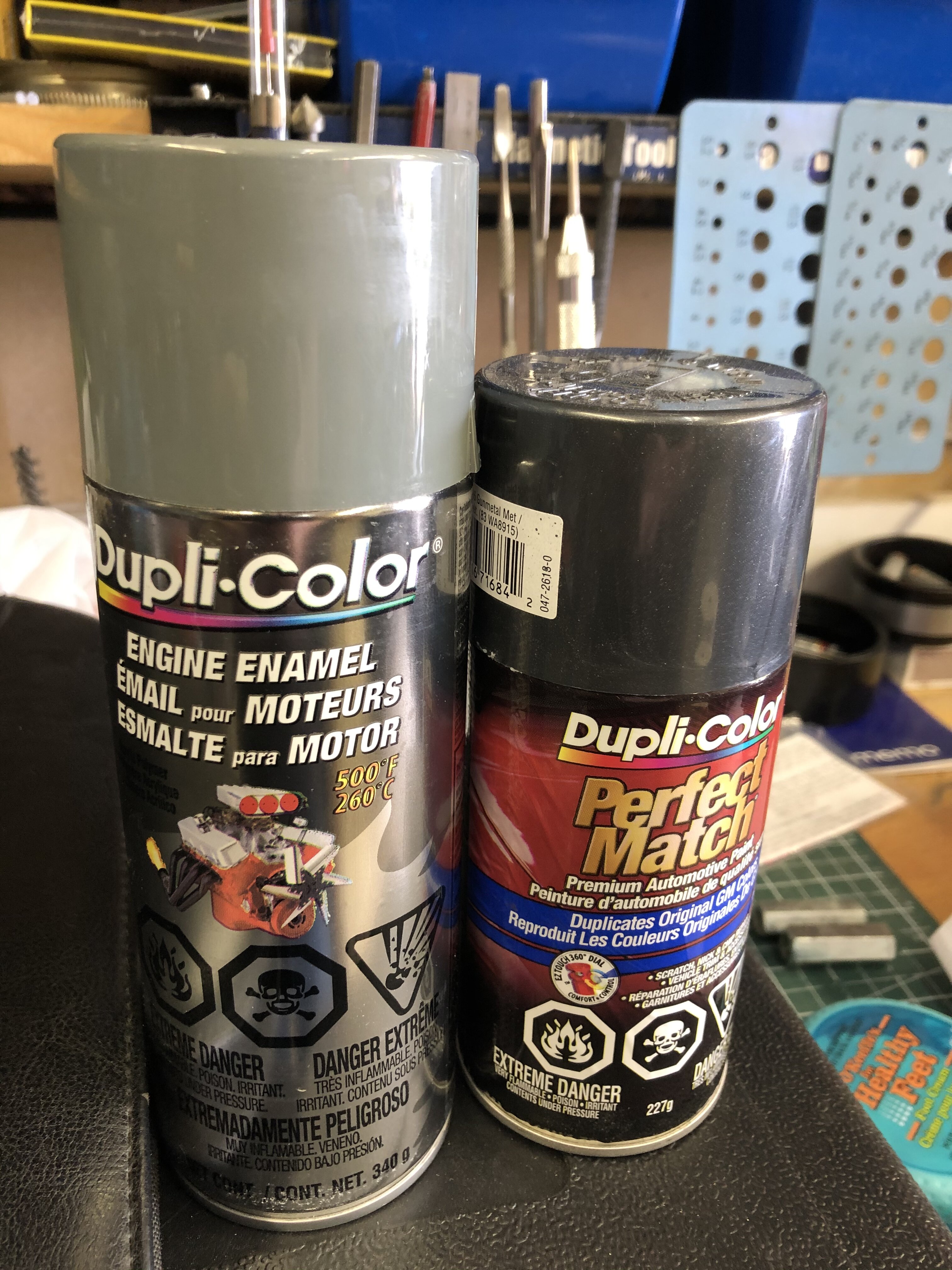

For the trigger guard I like the Dupli-color New Ford Grey engine enamel and Gunmetal for the barrel.

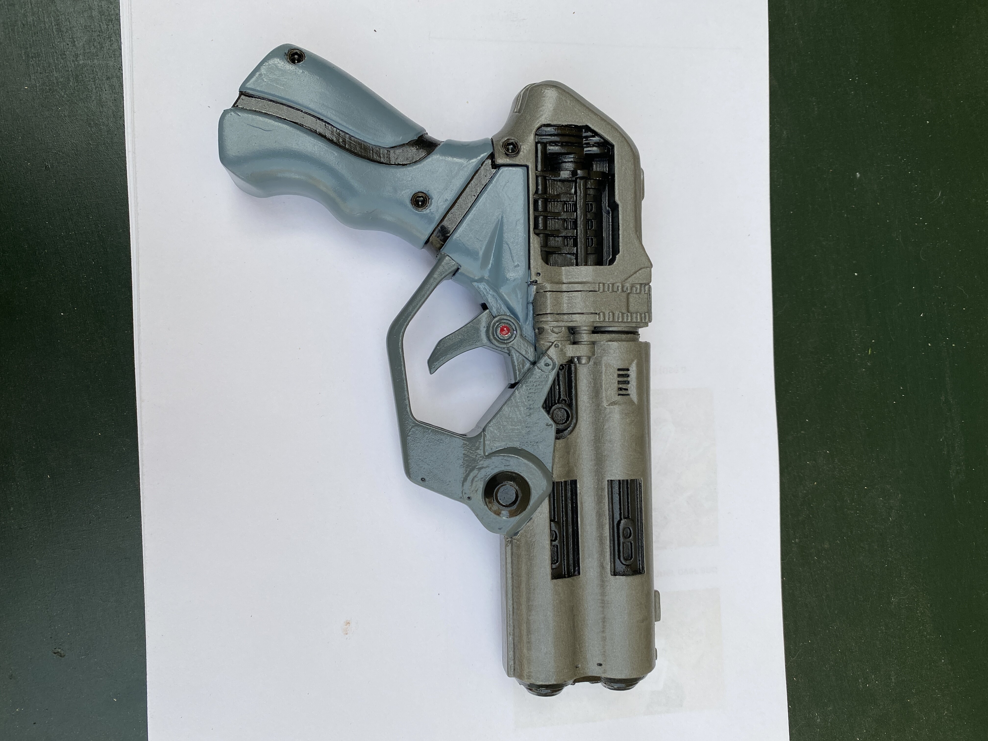

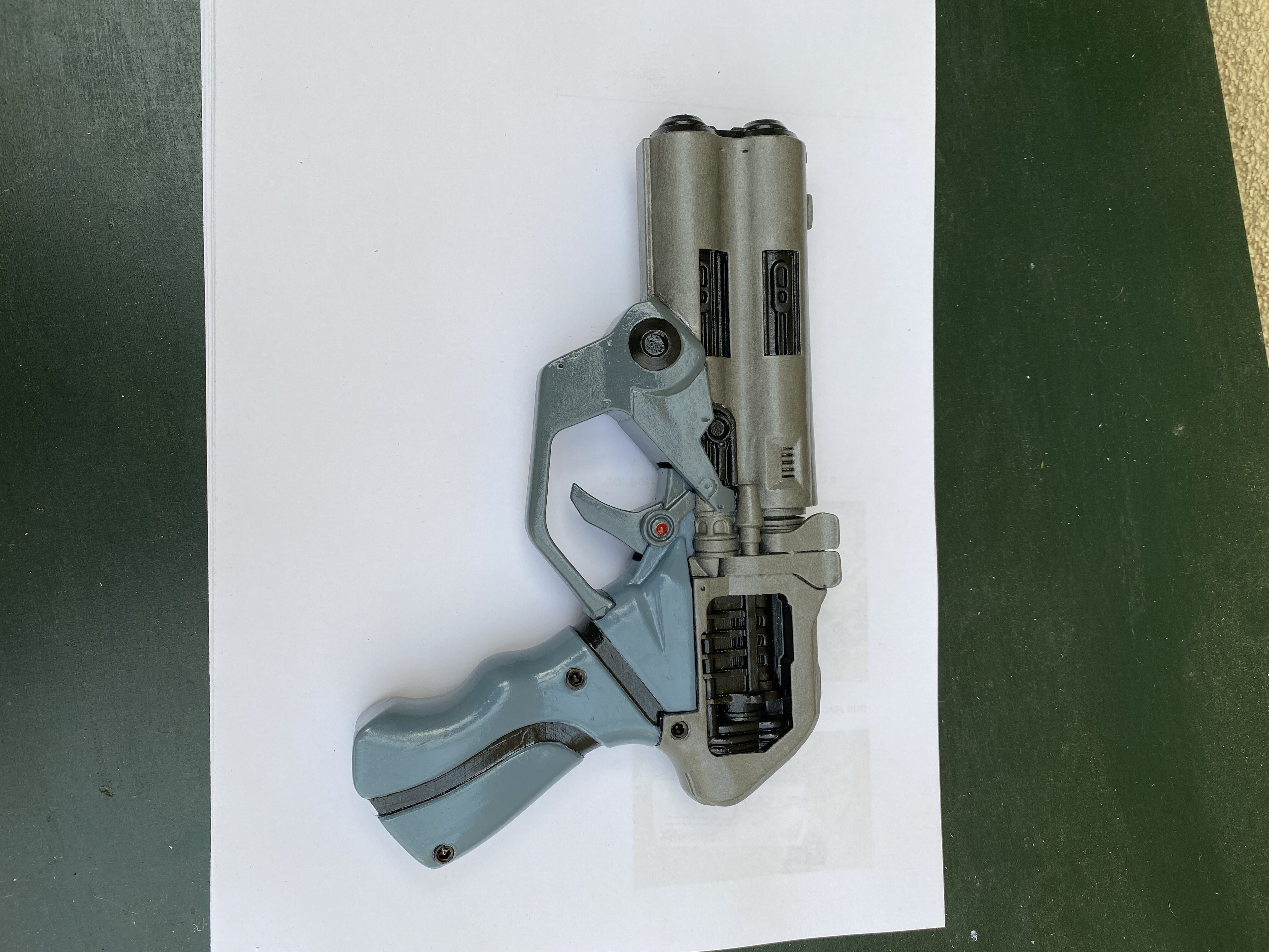

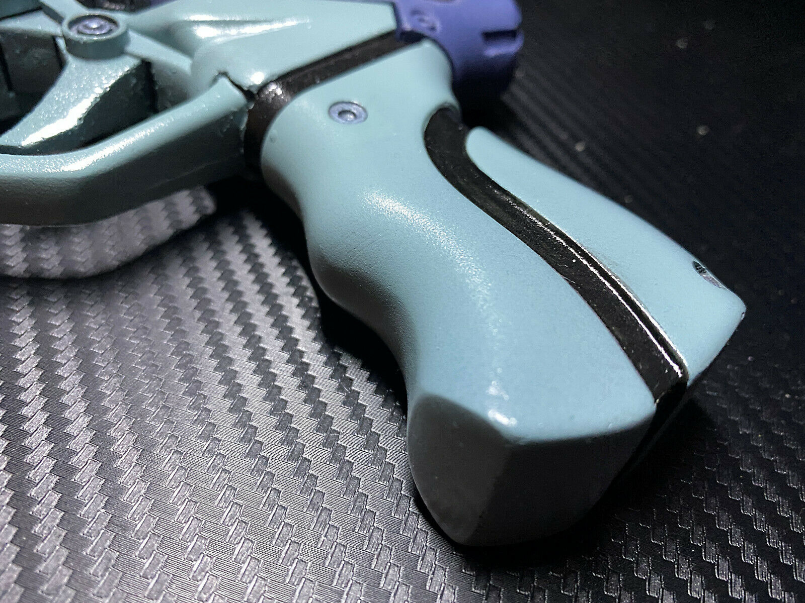

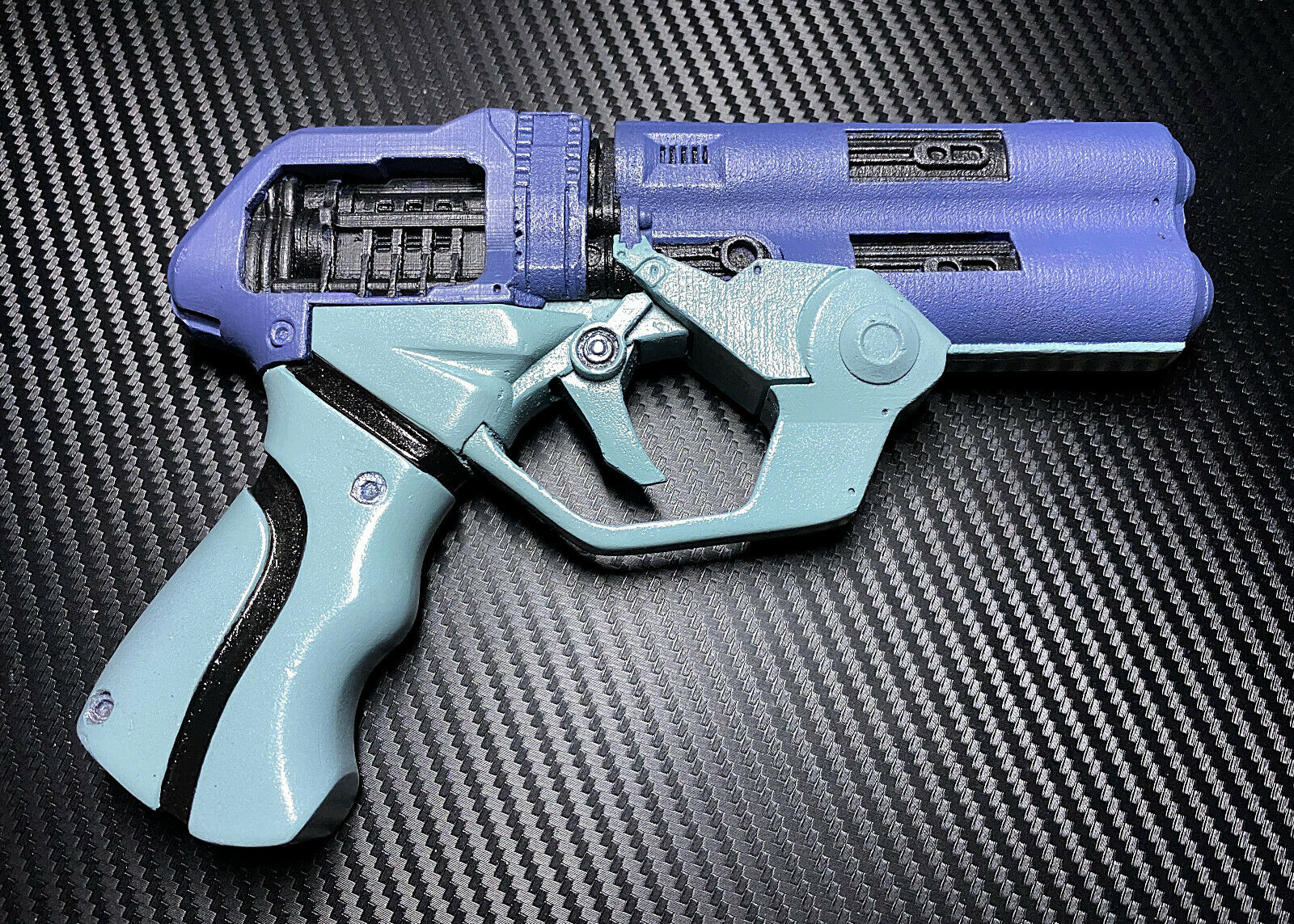

Here is one i had built and painted but wasn't overly impressed with the finish i am offering to anyone who could take it and re-paint it.
Yeah, that’s nasty. They did no prep work at all and didn’t even paint the barrel. I hope you didn’t pay much.

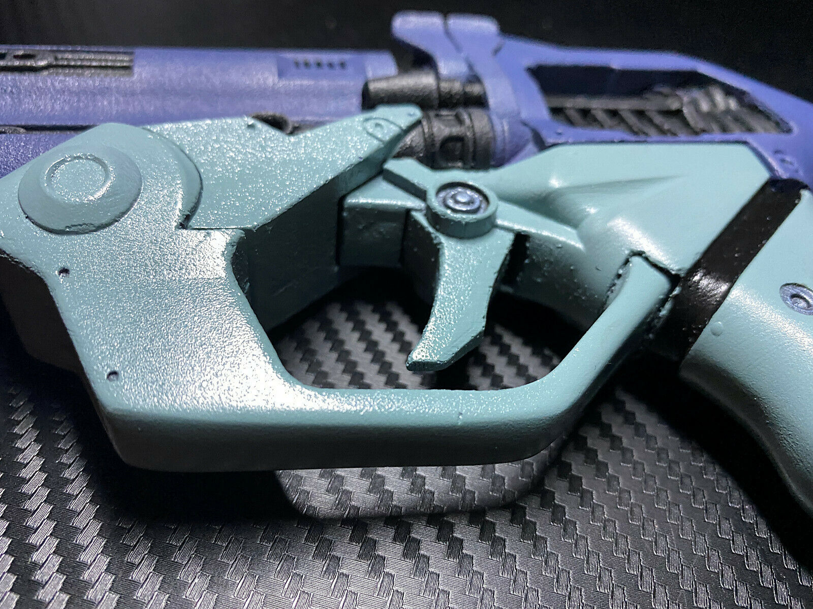

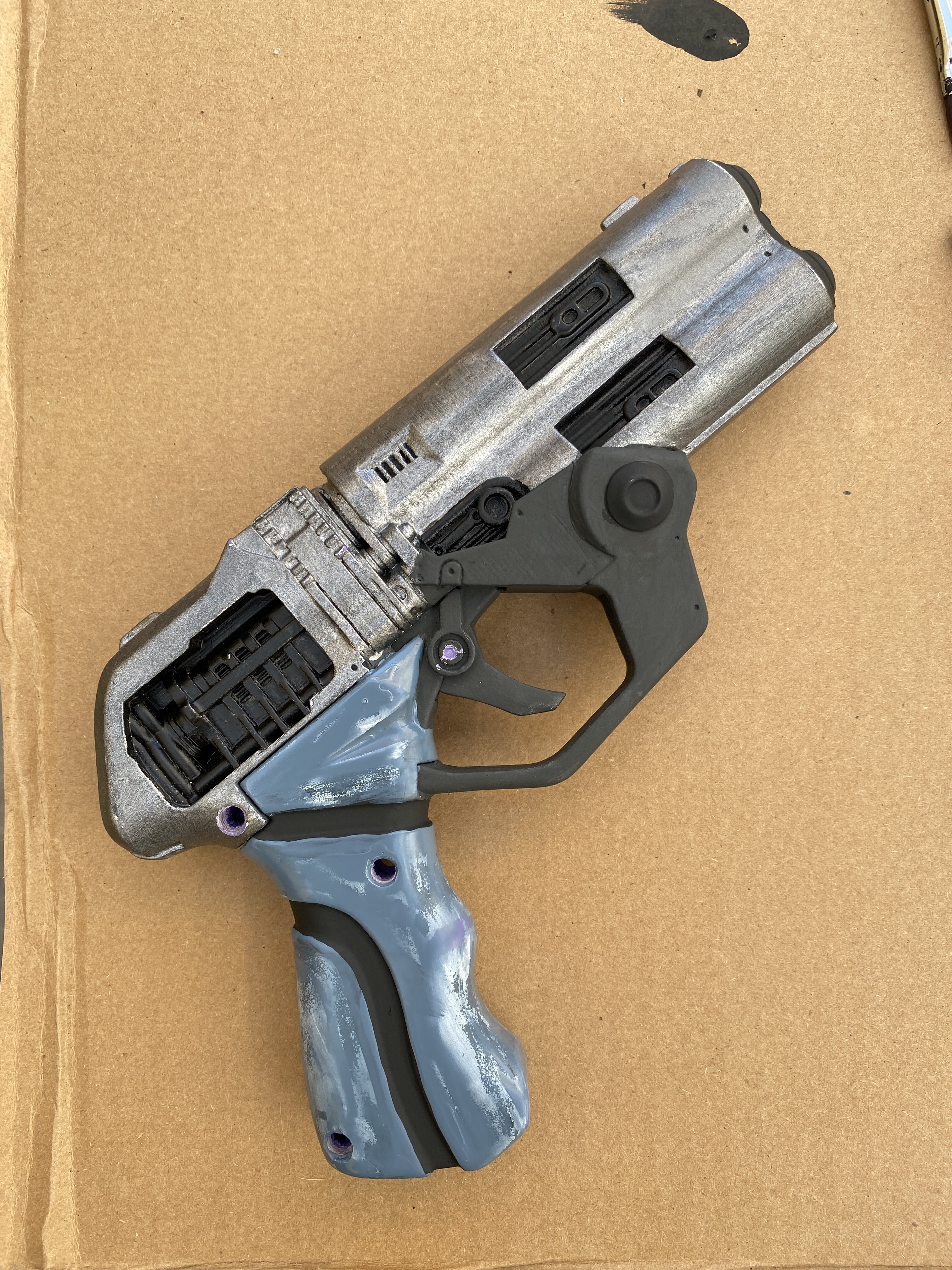

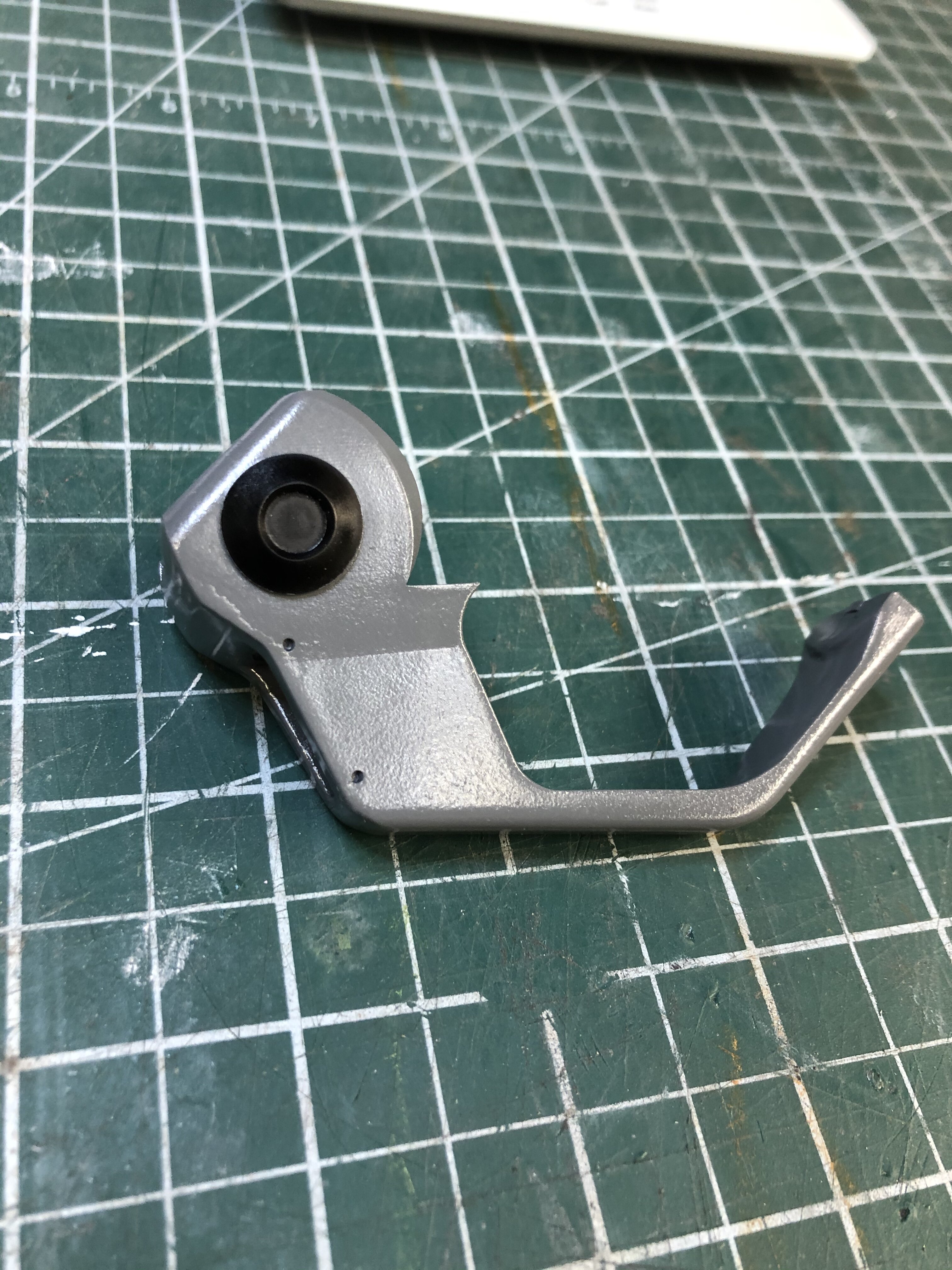

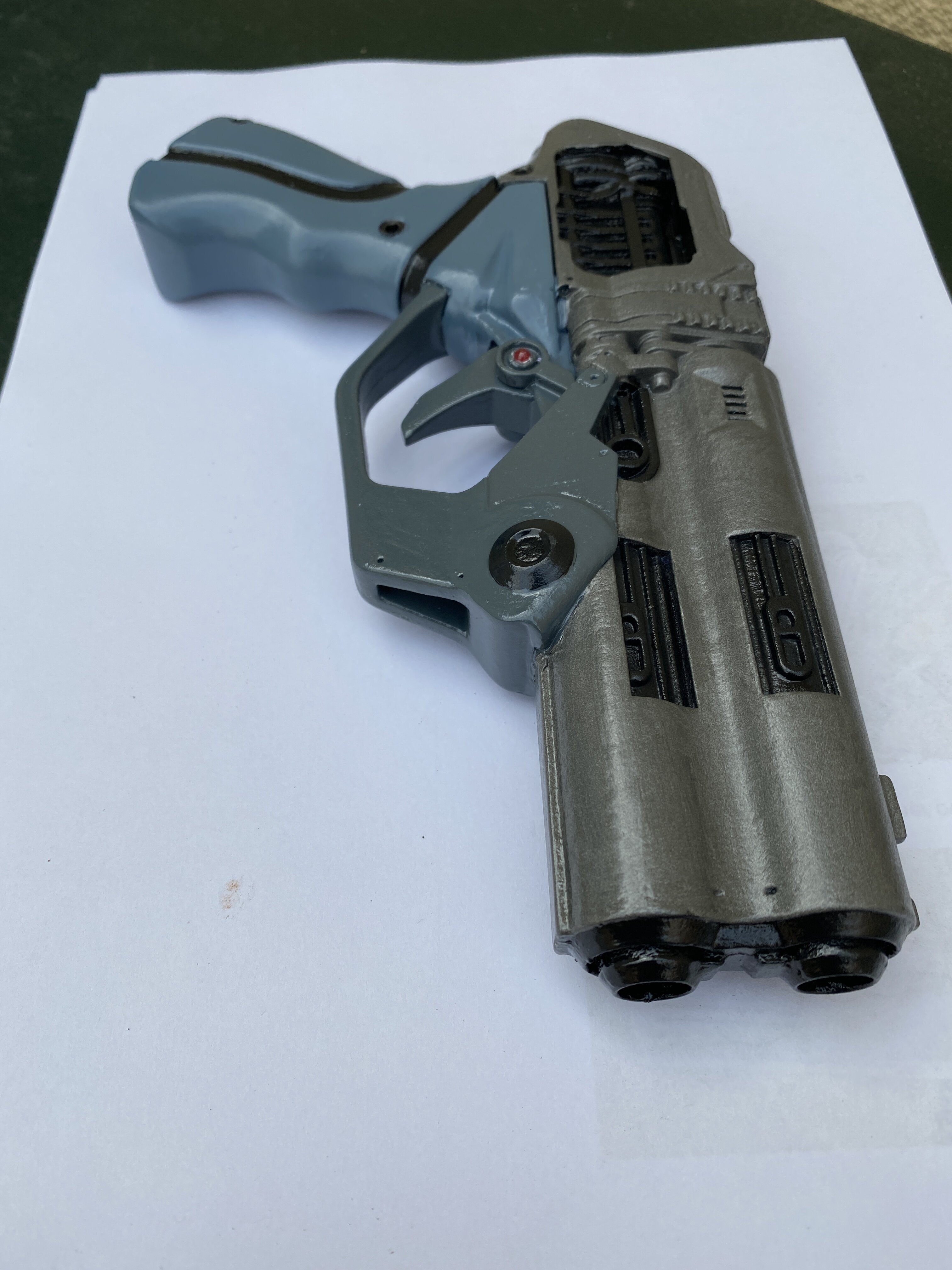

I’ve started the paint process.
Trigger guard is looking good

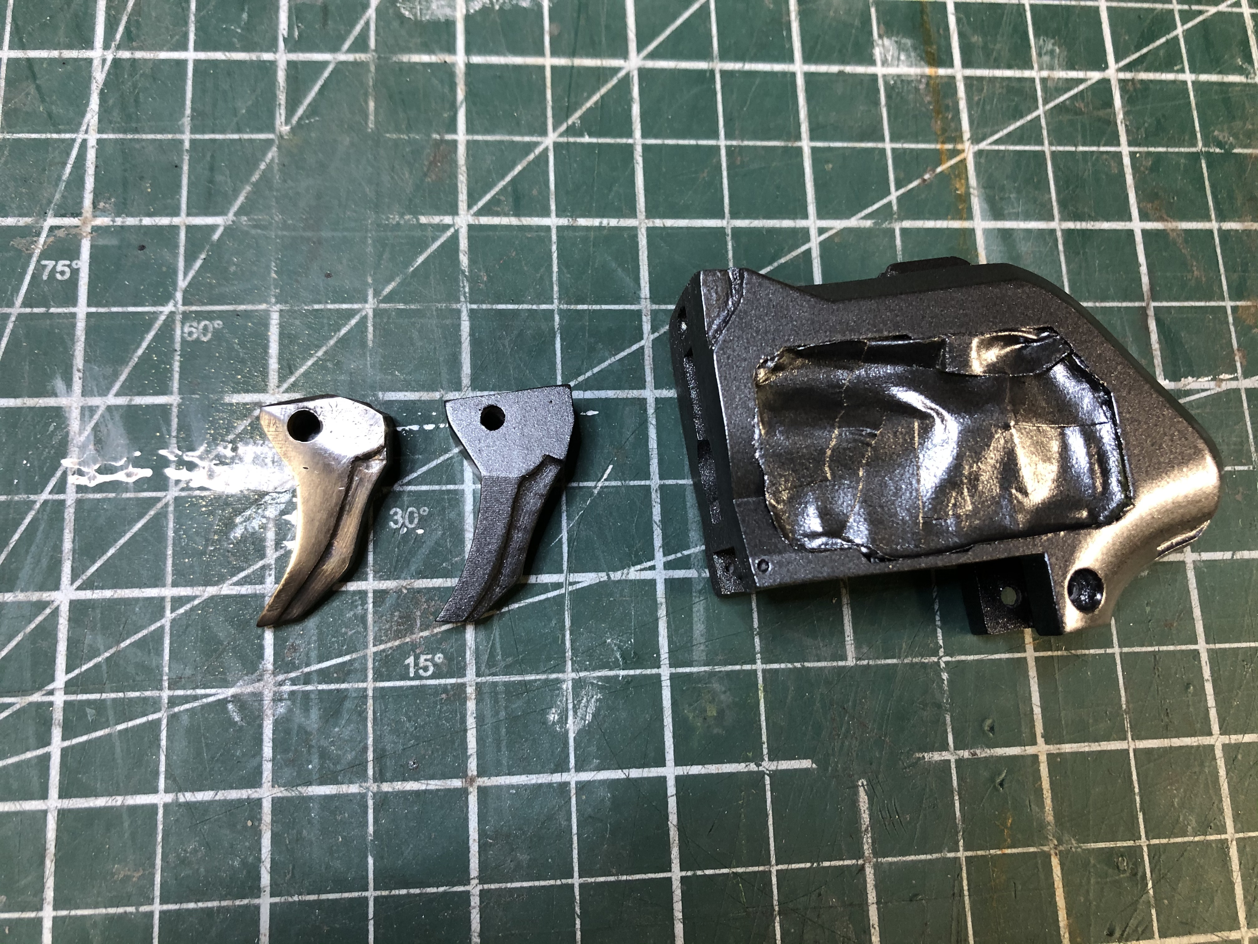

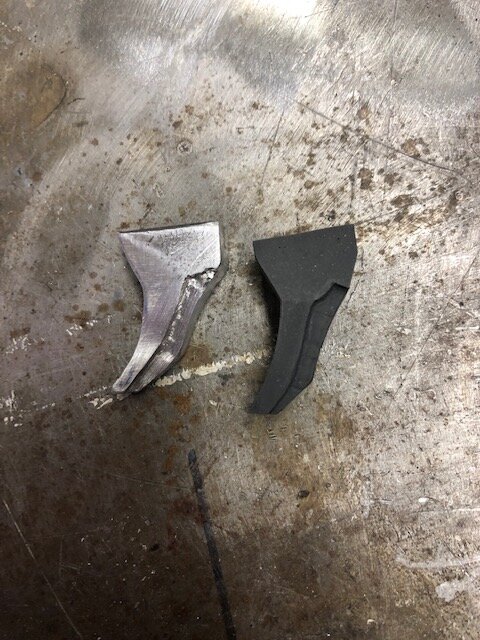

Did the rear upper. I tested a graphite powder rub on the resin trigger to see if I wanted to do the barrels as well. The effect is subtle but I think I’ll go with it. That’s the blued steel trigger I made on the left for comparison.
