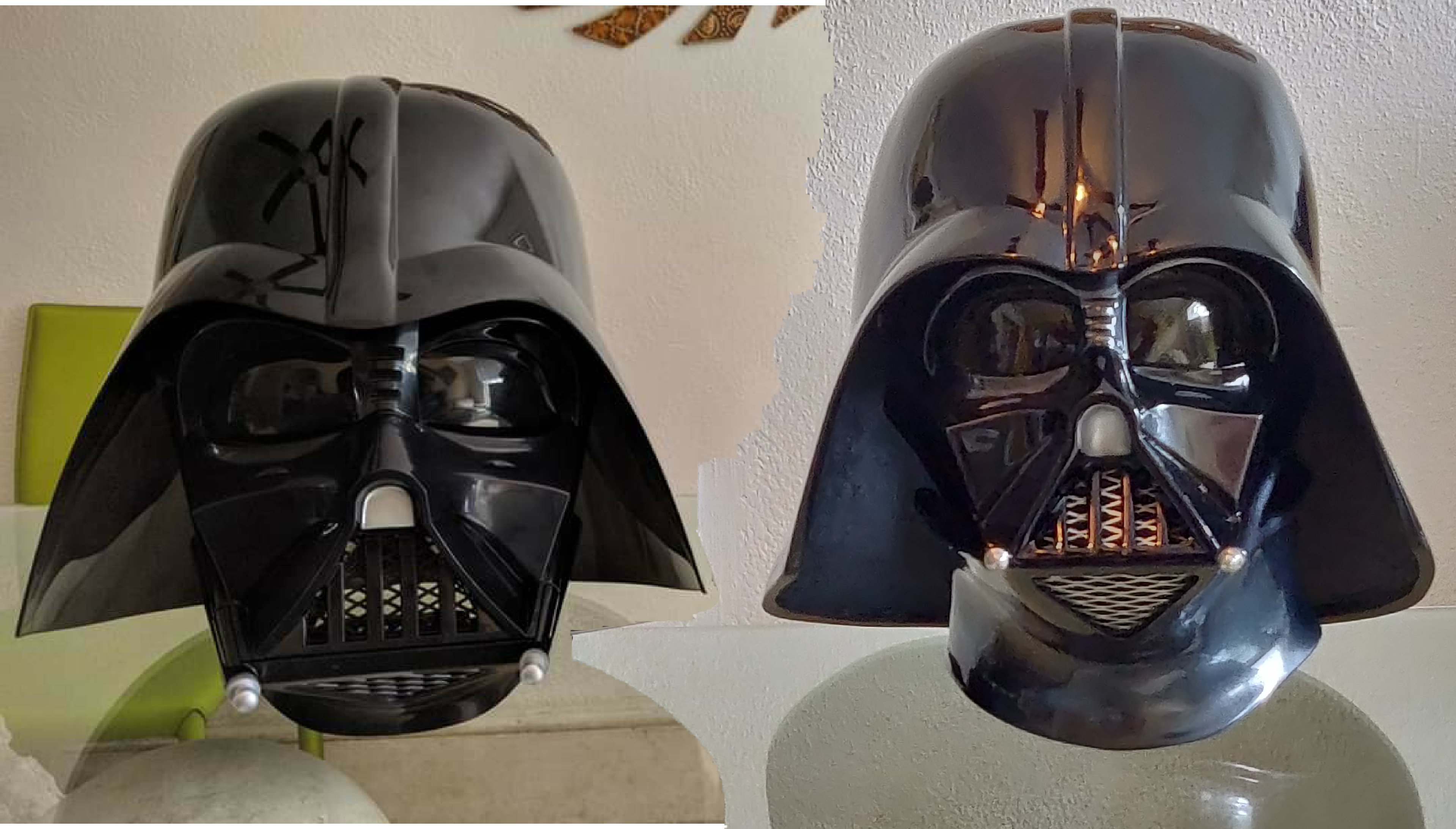

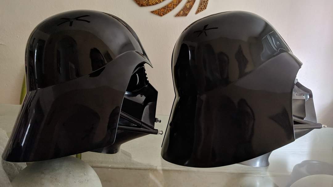

I'm comparing mine directly with your left picture. Other than some paint differences, and small details, and the thickness of the hood's "apron" sides, they look really, really close to me shape wise. I'm pretty happy with what we got.

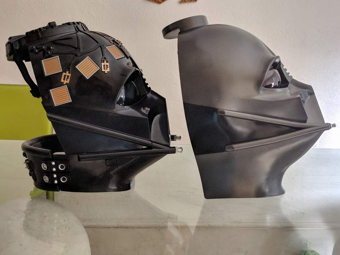

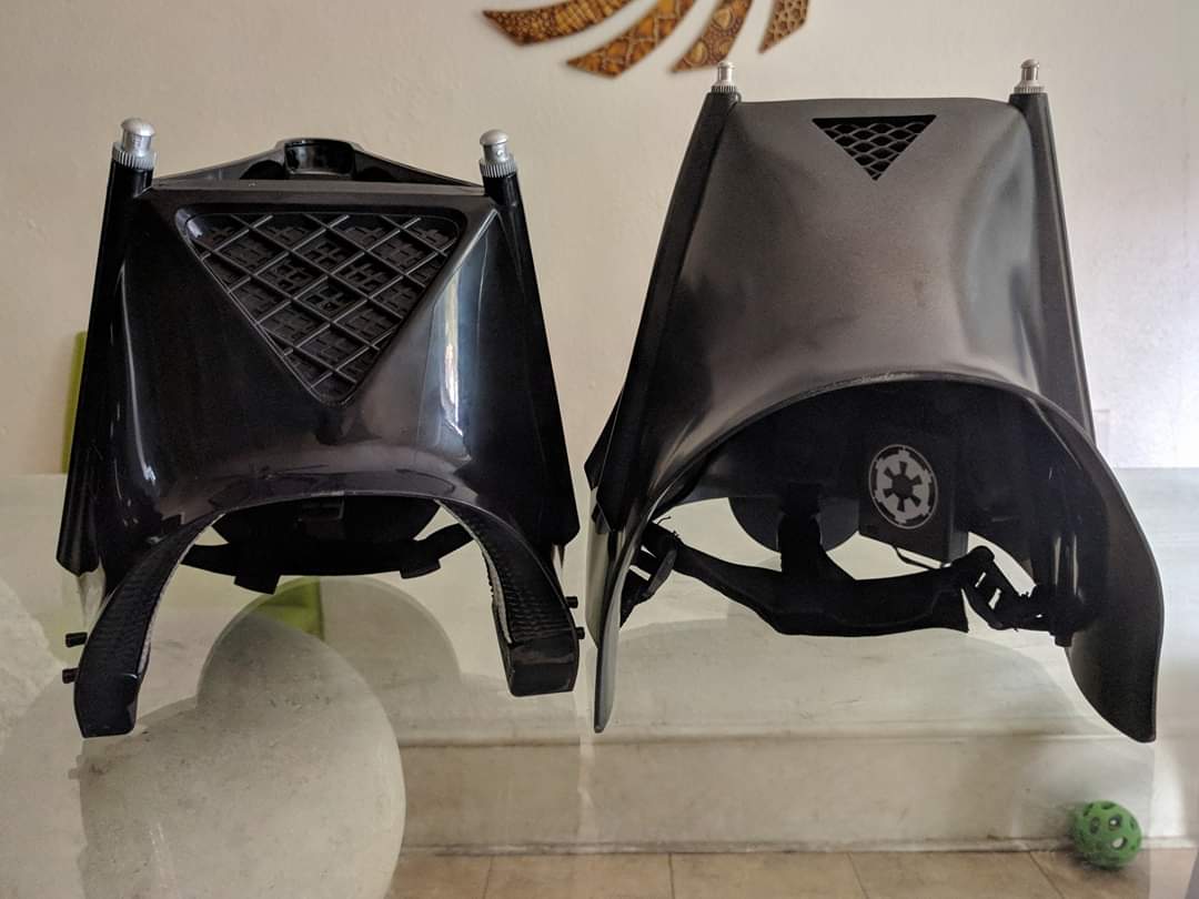

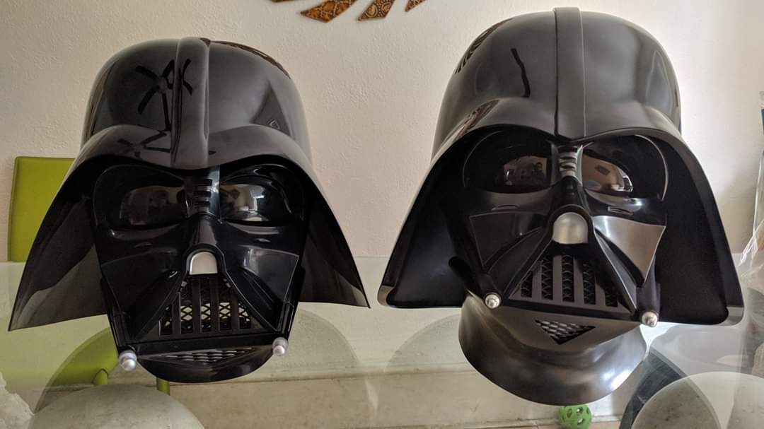

Here is my comparison with the EFX. The Black Series helmet is so small I cant even wear it. If I move my jaw at all the magnets break apart. That's the biggest problem with it not having a neck plus all the space the electronics and magnets take up.
Thank you for those. I still don't see a huge amount of difference. The small details yes, but overall it looks pretty close. I'd also like to see it next to an ESB/RotJ version.
Everyone's different size wise :/ I have a pretty big head and I have a lot of room back and forth, although my cheeks do almost get caught between the magnets. It's comfortable on me.
The black chin grill is called the vocoder, on the OT helmets it was raised ridges molded into the faceplate. On the R1 helmets it appeared to be tubes that are raised from the surface and attach at the other end. I believe on the BS helmet they are ridges, not tubes separate from the surface. This makes this feature more OT style where other parts are more R1 style.
I wanted to make sure. You said "vocoder tubes". I wanted to make sure you weren't referring to the aerators. While the R1's are more pronounced (too much so to look good, I feel), with the reference lineage piece in my other hand to compare when I was sanding the surface of the HBS and preparing to cut the vocoder (I call it the annunciator -- vocoders are something different) grille out, the HBS has a sharper, clearer delineation between grille and faceplate chin, both have the grille stand out respectably from the surface, but no, the HBS doesn't stick out as far as the R1.
I'd recommend cut out and replacement, anyway, though, because a drop-in detail from behind is more film-accurate to the Anthology Stormtrooper helmet. Along with cutting out the tube stripes in the right locations with nice sharp edges and backing the openings off with blue-anodized aluminum strip. And other things, but I'll stop there. Point is, it's not dead-on to anything out of the box, just like all the HBS helmets, but with work can be made more accurate either way to (idealized) OT or R1.

Not a direct comparison. This image is of my Quasimodo ESB Vader taken from a comparison with the EFX. I tried to match it up as closely as I could but it's not perfect. The Quasi is a little smaller than the EFX. Perspective is a little off as it's taken about a foot further back than the Black Series.
No personal disrespect towards you. We all have opinions.
Are you sure you're looking at the same helmets as we are?
Well the face definitely looks bigger like the triangle.
The B.S. eyes and dome brow are over exaggerated making Vader look peeved off. The film sculpt has more of a netural expression. The walls of the mouth vent bend inward considerably when they should slightly bend outward. Aside from the straight on view of the mouth and cheeks the film sculpt has more length and width in every other aspect.

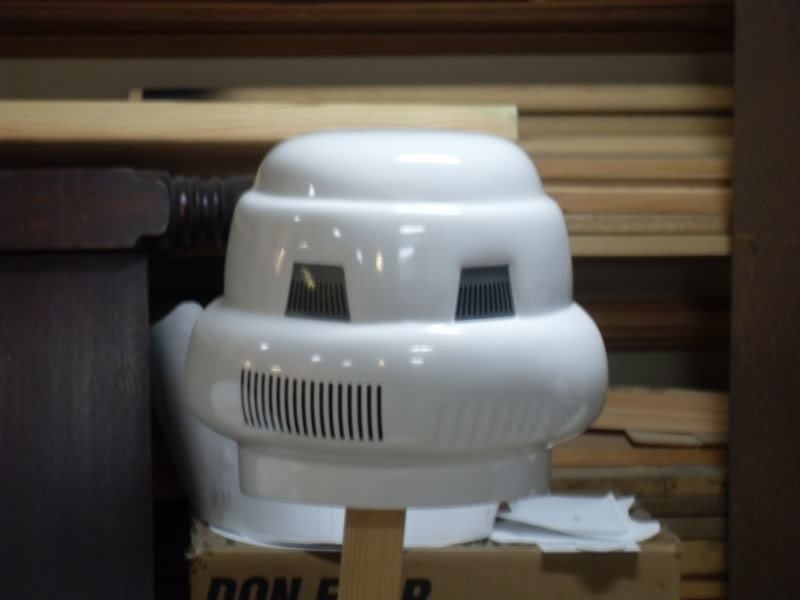

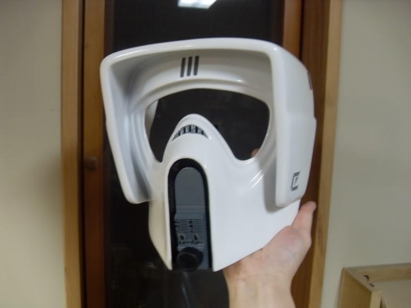

• Then, for a white Supertrooper helmet, white primer, followed by Rust-Oleum's Professional Grade white. I'm not sure about all the colors, but white and black, at least, have ground up ABS dissolved in suspension. Paint three coats, five minutes apart, and then don't touch it for a week to let it cure. When done, you'll basically have coated the thing painted in ABS plastic. Here's a fiberglass Scout helmet painted with it:
It's a little fiddly, but for the turn signals, you can tape off the openings and paint them afterward. Or, like me, you can grind away the inside of the dome at that spot until the back wall of each inset is gone and back them off with some appropriately-painted scrap plastic.
Further, I personally plan to do all the initial priming disassembled to make sanding more convenient. Then after all the spot putty is sanded back off, reassemble the dome liner to the dome, then glue the lower main helmet pieces to the dome, then glue on the earcap substrates, and putty and sand those seams. After painting, then go ahead and put the visor and lower interior pieces back in. Probably more involved than you wanted, but the result is cleaner and more durable. If you're not doing serious modding, like me, then it should only take a several days to a week for all the prep work. Biggest time-eater is having to wait for the various paint apps to cure enough to go on to the next step.
