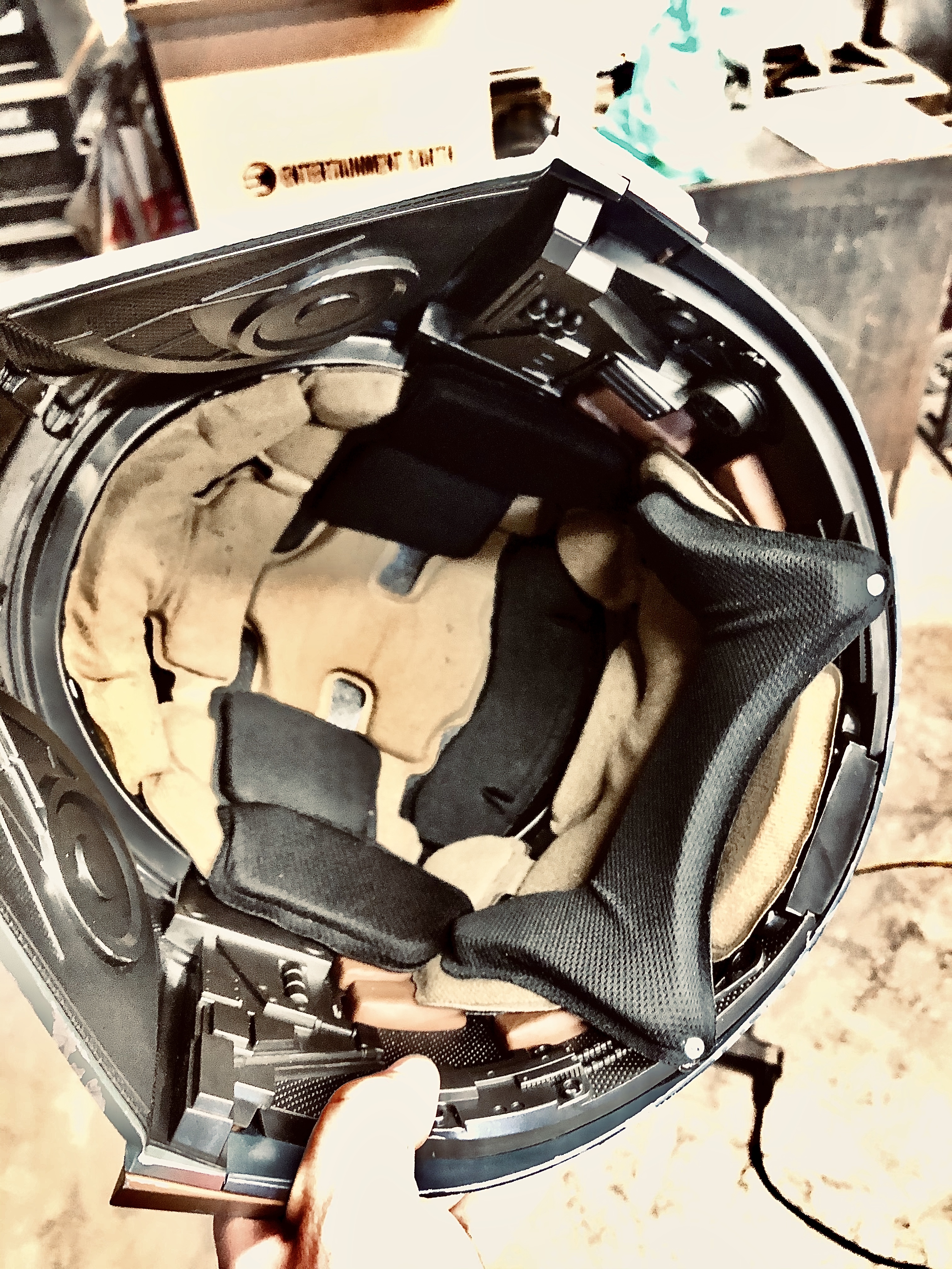

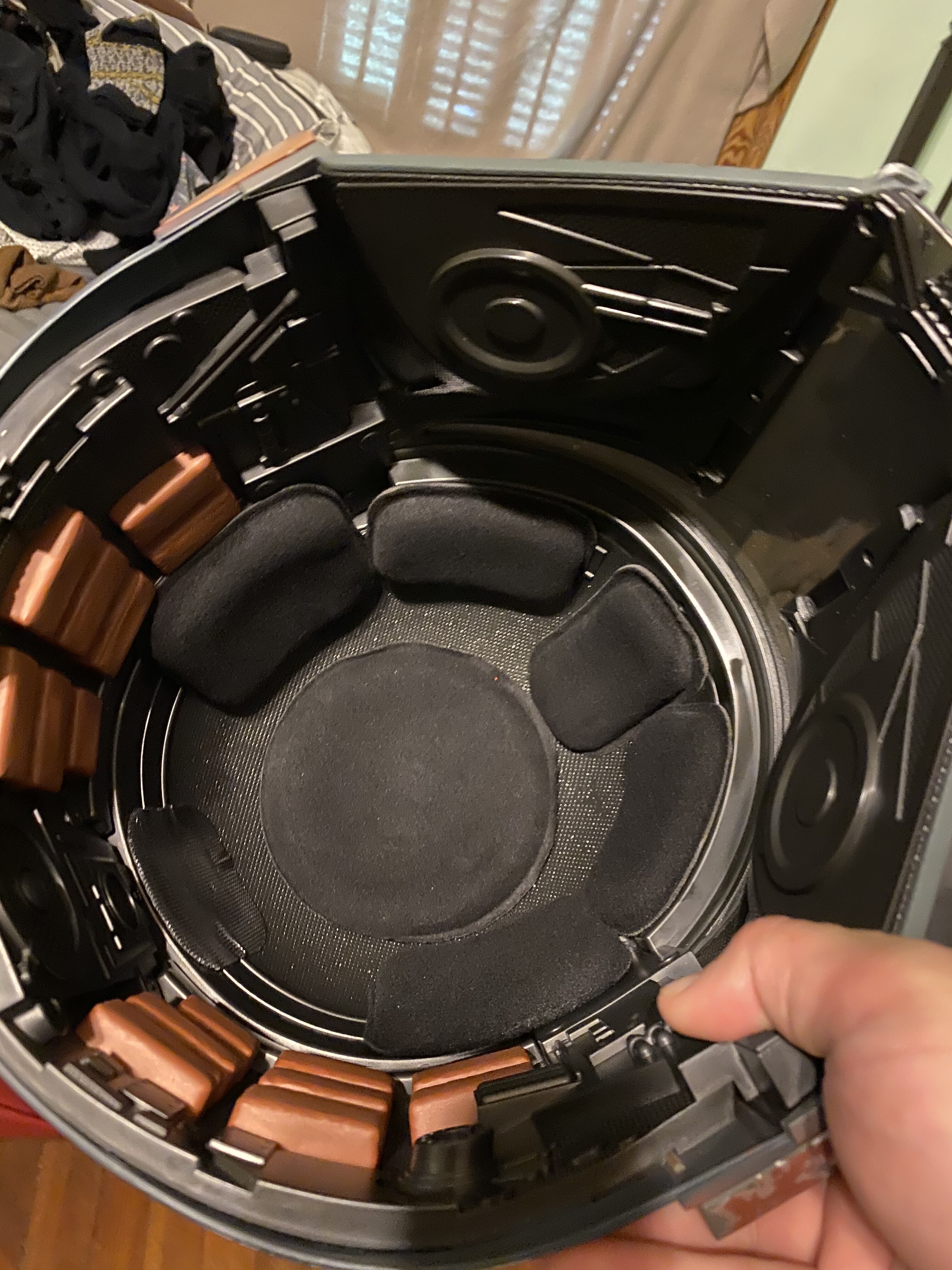

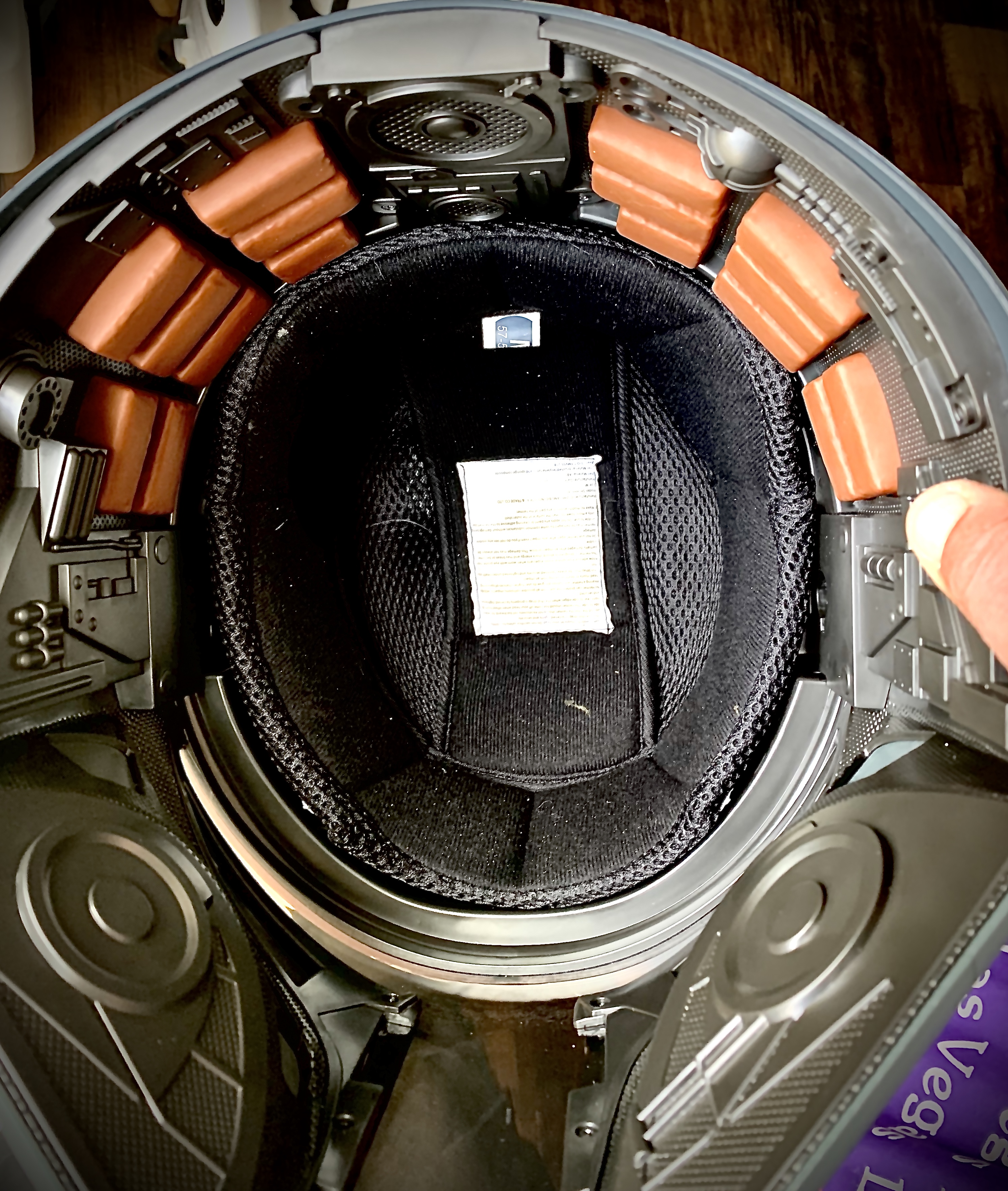

I considered that liner as well before I placed my order. But with with the other type. If you are getting the padding because your head it to large for the supplied liner, then my tip to you is to put in the front section first and try it on, you may not need more. If you need more, then do the mid section. As you can see from my last image I posted, I only needed a few well place pads for it to fit well. Too many pads and it made it too small and/or forced it to be worn smashed against my nose.
Agreed. You want it to sit as far forward as possible for the screen accurate look.
Additionally when I had my helmet on with no liner, it of course wobbled and it set too low and could not see out the visor properly. You would think based on that, I would need a pad at the crown. However I found that just by using only pads around the front half, it allowed the helmet to set higher on my head and I could see out of it with the helmet at a leveled position. I did experiment with the crown pad installed but when worn, it forced me to tilt the front of the helmet down so that I could see out of it properly and also pressed the visor against my nose.
I don’t know if I’ll be able to recommend the same setup for others; but this is very comfy. I have fairly small head (and no hair) so I was able to shuffle the padding into a format where the back of the neck also has support.
It’s snug, but not tight. And well supported (no wobble)
I’m not disappointed that the detail is covered; it feels correct somehow. I riveted the neck support padding into the plastic interior

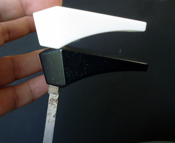

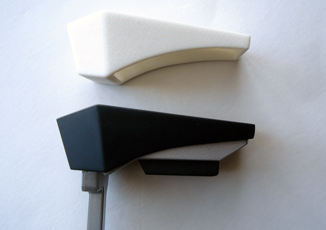

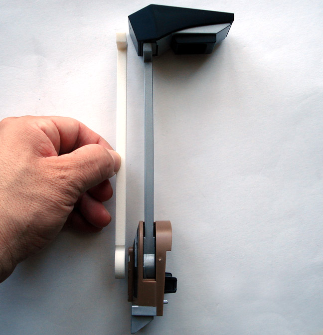

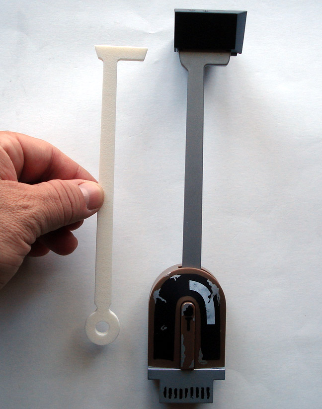

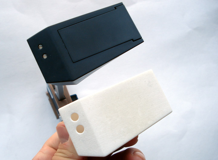

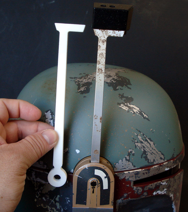

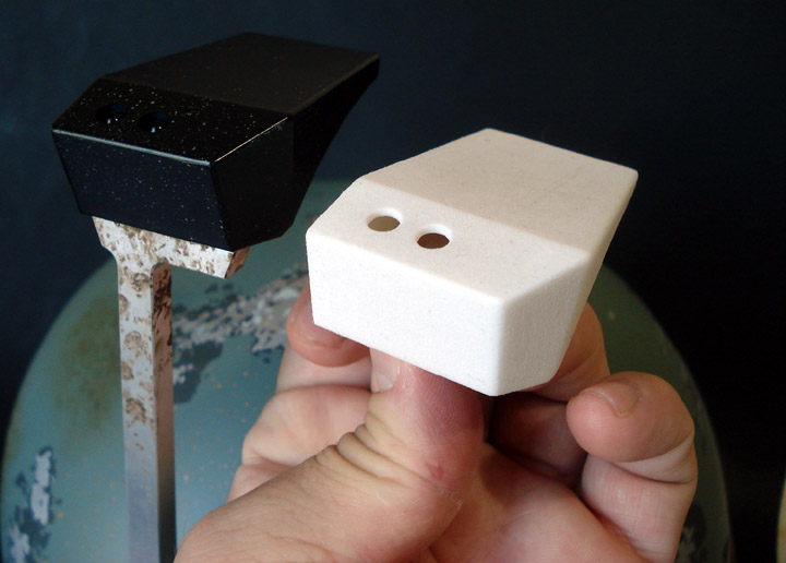

You guys mentioned Rafelfetts's works.

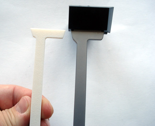

I own his Stalk (hollow inside), Range Finder casing and lens frame, bought from his store at Shapeways.com
But Rafel offers templates of his works if one wants to make them themselves, but you have to search for the templates on TheDentedHelmet

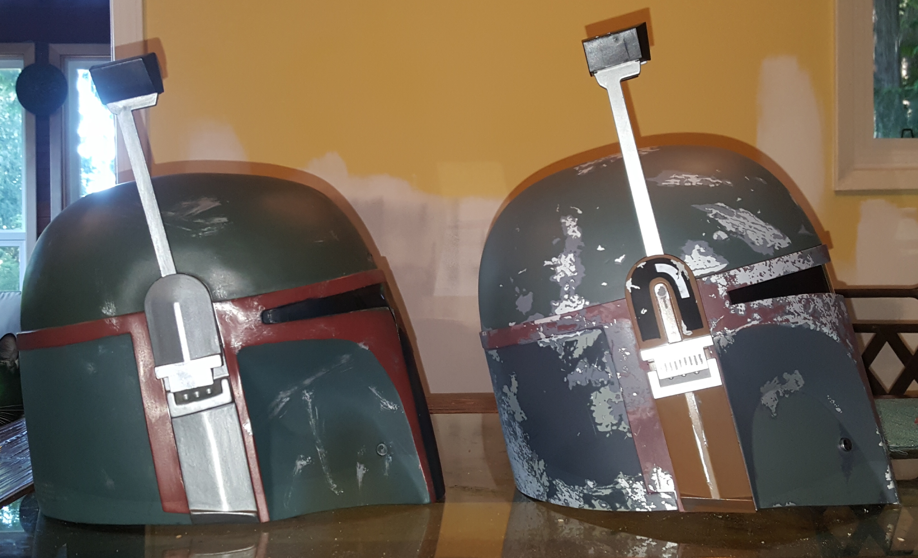

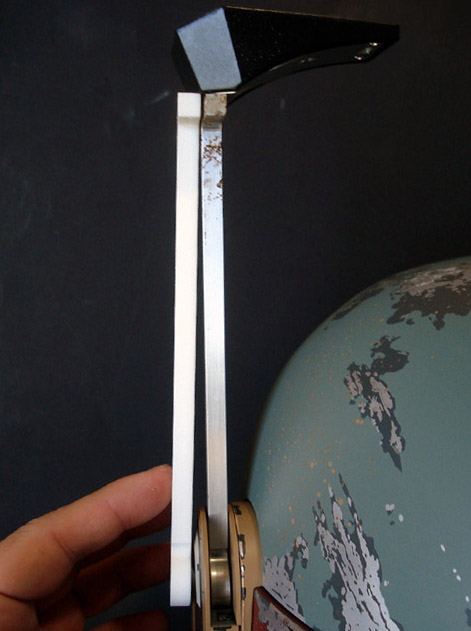

Comparing Rafelworks' stalk kit to EFXs' stalk
The Rafel's stalk is about 3mm shorter at the ring base otherwise rest is same size compared to EFX
The Rafel's Range finder casing is about 1mm overall size bigger, compared to EFX
The Rafel's Lens frame is accurate compared to EFX
If one wants to upgrade Hasbro's Ranger Finder pieces, I think Rafel Works is the best option.
I will post updates if I ever upgrade my Hasbro's RF to Rafel's
Comparison pics
Rafel Works vs EFX
Hasbro's stalk is shorter and slightly different shape and RF case design is slightly different compared to Rafel's works.

Regarding the rangefinder assembly, there are three things going on with the r/f stalk.
- The stalk itself is ~5mm too short.
- The stalk is seated in the upper earcap housing ~5mm too low.
- The upper earcap base is a couple millimeters too low on the helmet -- I'm presently deep into sorting out how best to address this.
I figure it's only fair that for how effortless the rest of the thing is to work with, there has to be one major headache.

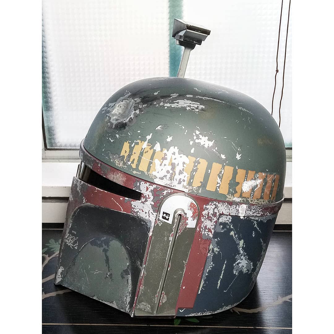

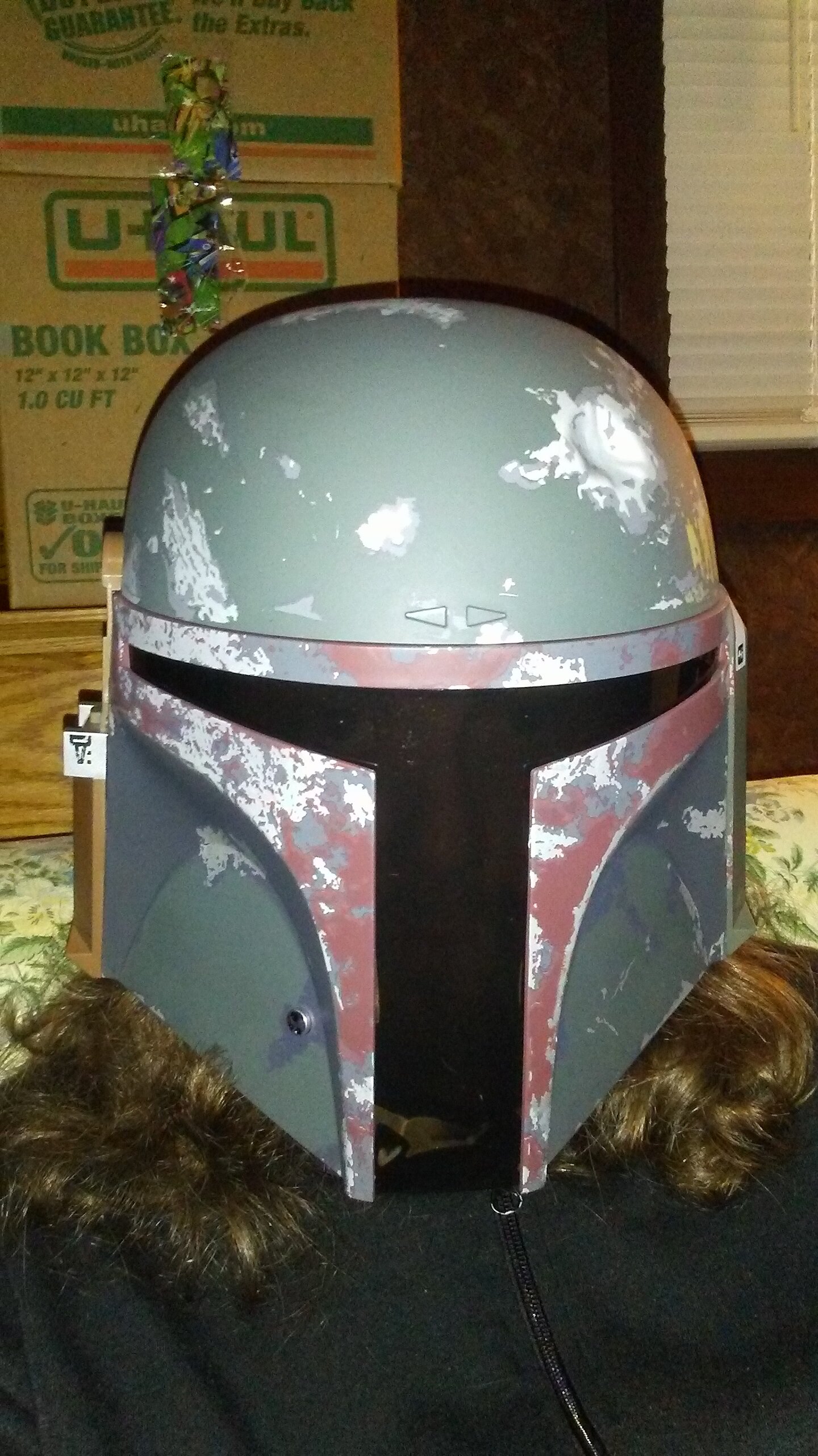

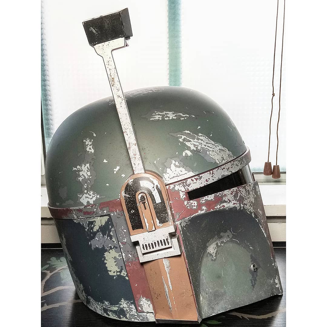

Found about 8 at a local Walmart. Second one I opened had straight yellow lines so I bought it. I think the rest of the paint apps turned out pretty well. Happy with the location of the "cat scratch". And the connector sticks out pretty far.

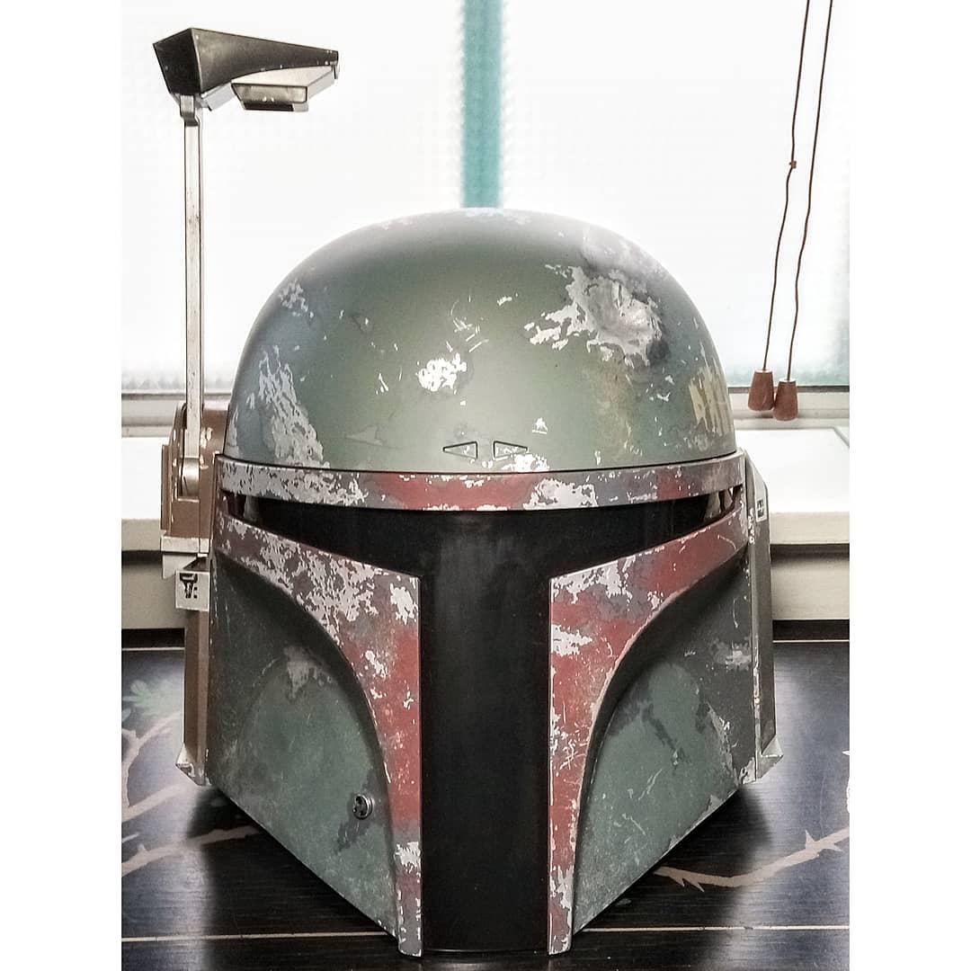

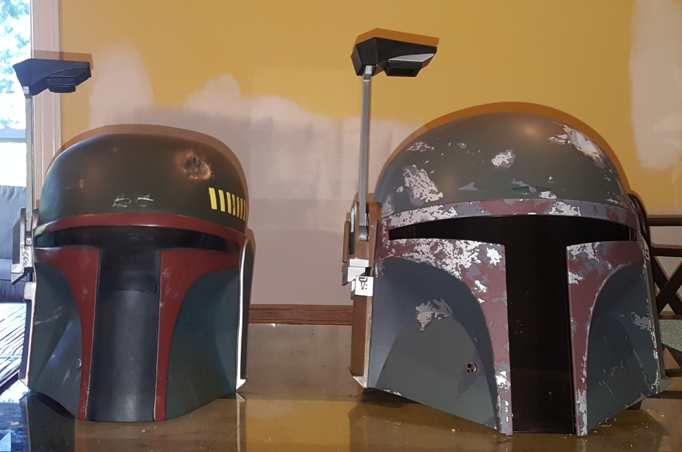

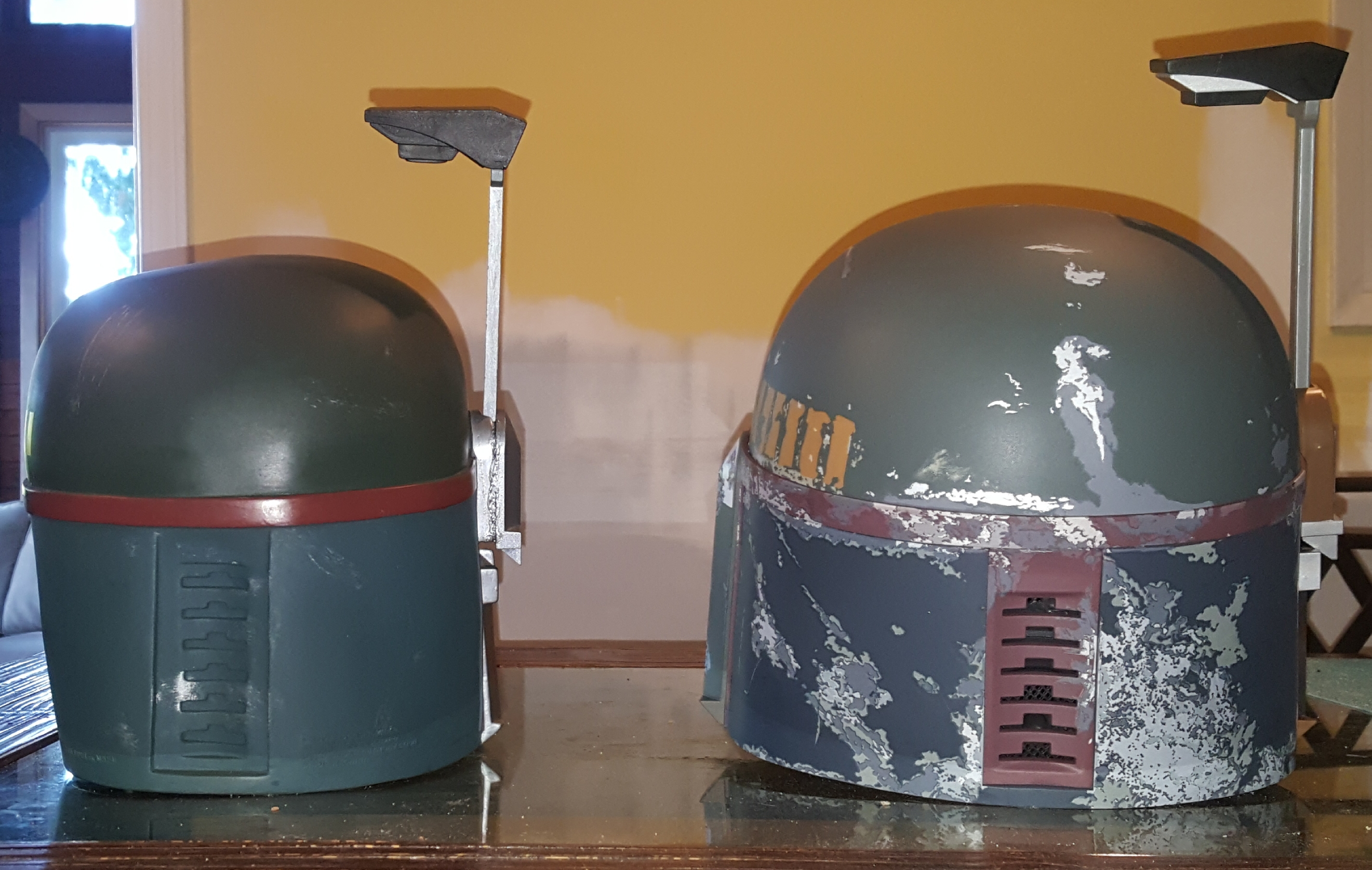

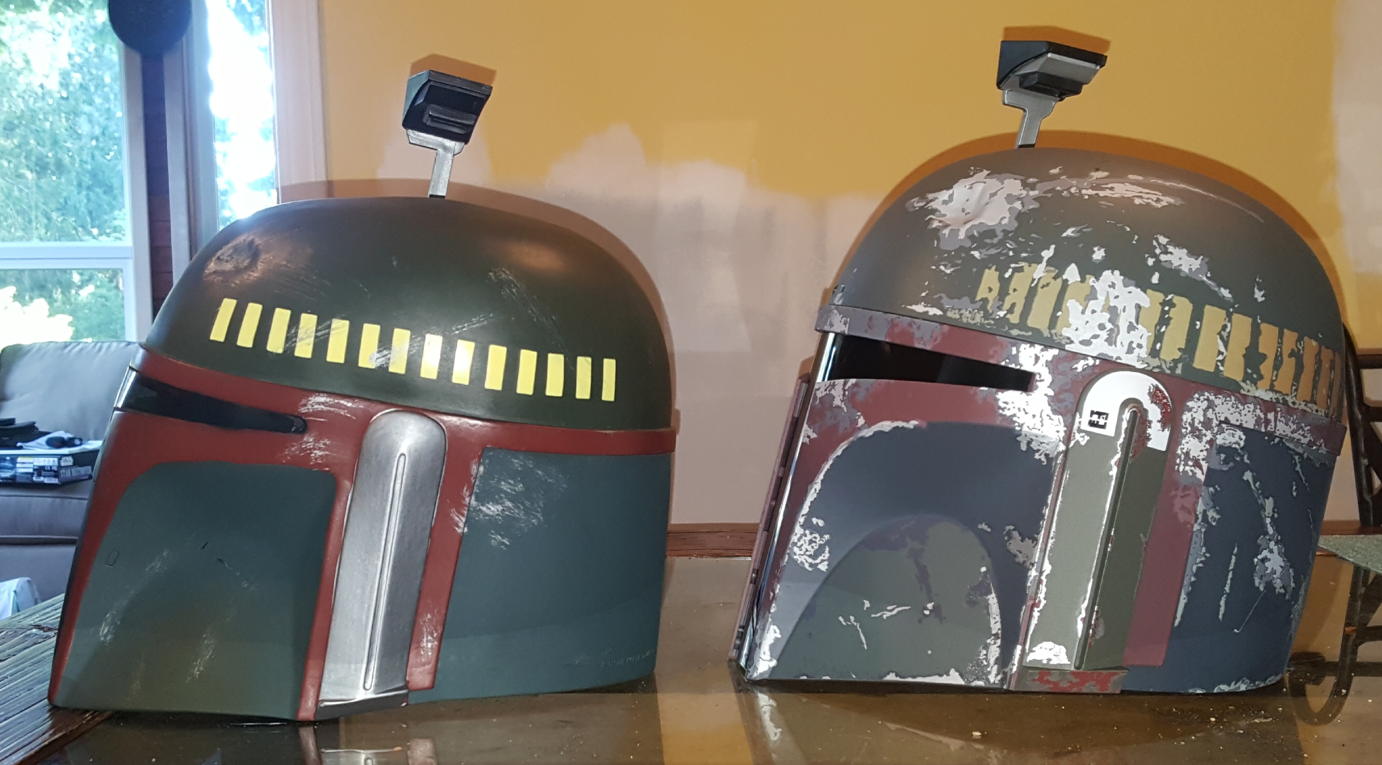

Finally, FINALLY had mine arrive yesterday. Paint is all more or less where it should be, stripes are more or less straight....ish. instead of boring "helpful" comparison pictures though, I thought I'd post tragi-comic ones instead. Amazing how far we've come since the mid '90s for the same price point. Anyways, only mods will be silver paint pen (just remains to be seen if I can match that sweet, attention-to-details Don Post paint application) and removing the hard hat liner...because it's terrible. I've got a tiny pin head, and it still doesn't fit right. Only question now is what to do with that DP standard...apart from maybe drop-kicking for distance:unsure:
