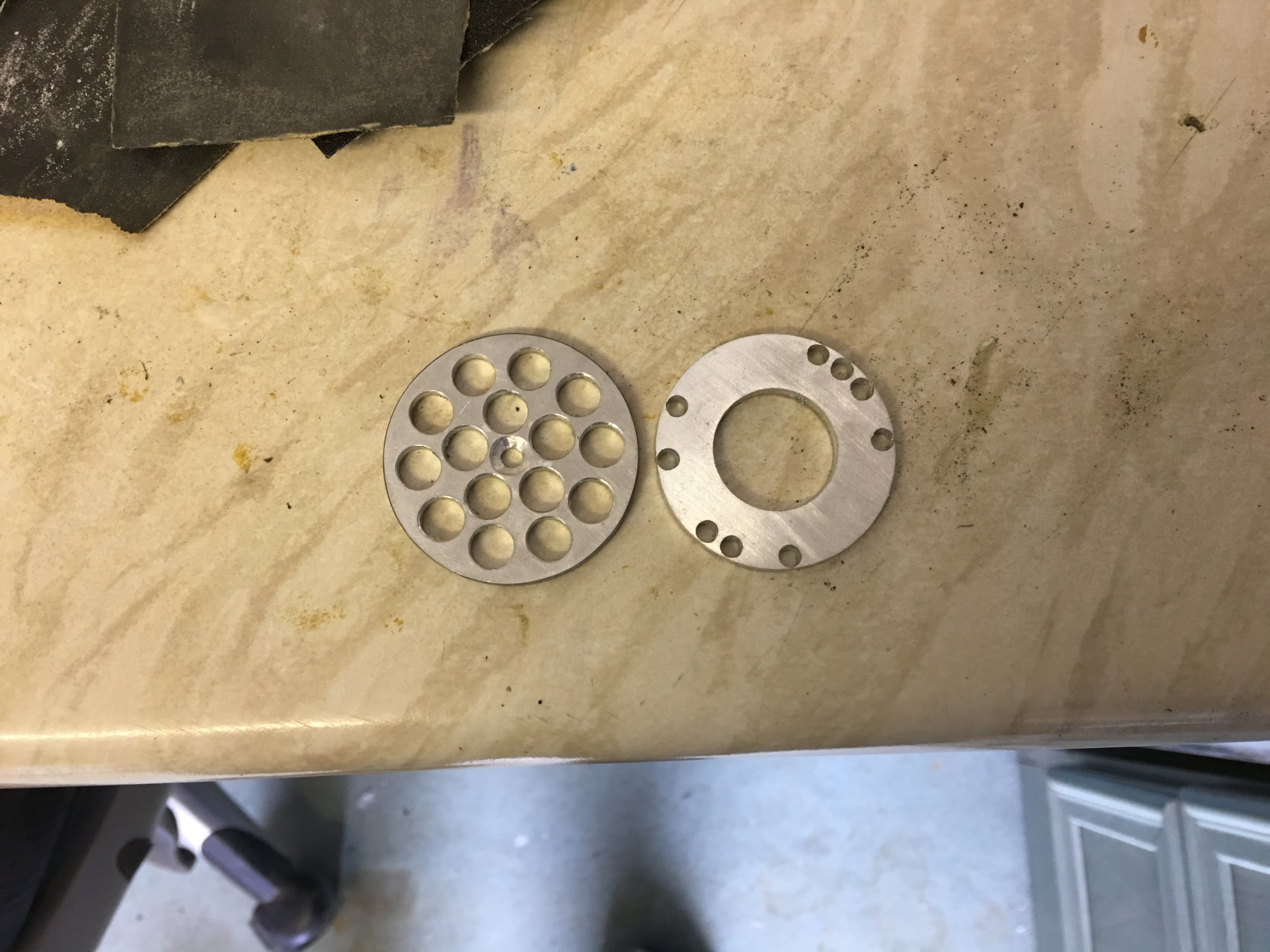

As soon as I start to refine a couple of pieces, top disc and second disc on my lathe it breaks down
As soon as I get the new part I will show what I’ve done

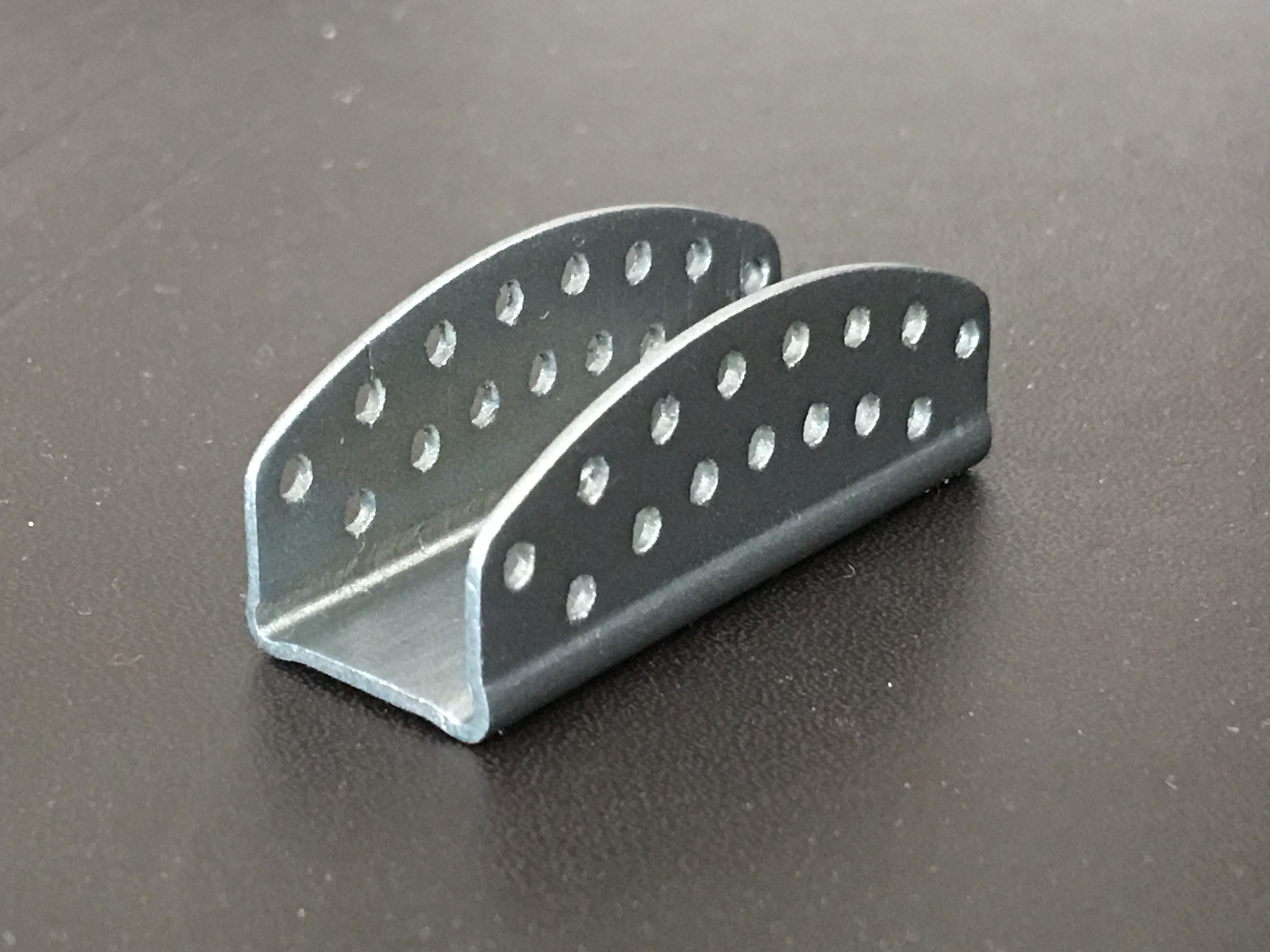

Also I need to get the collar grill off to be photo etched next week

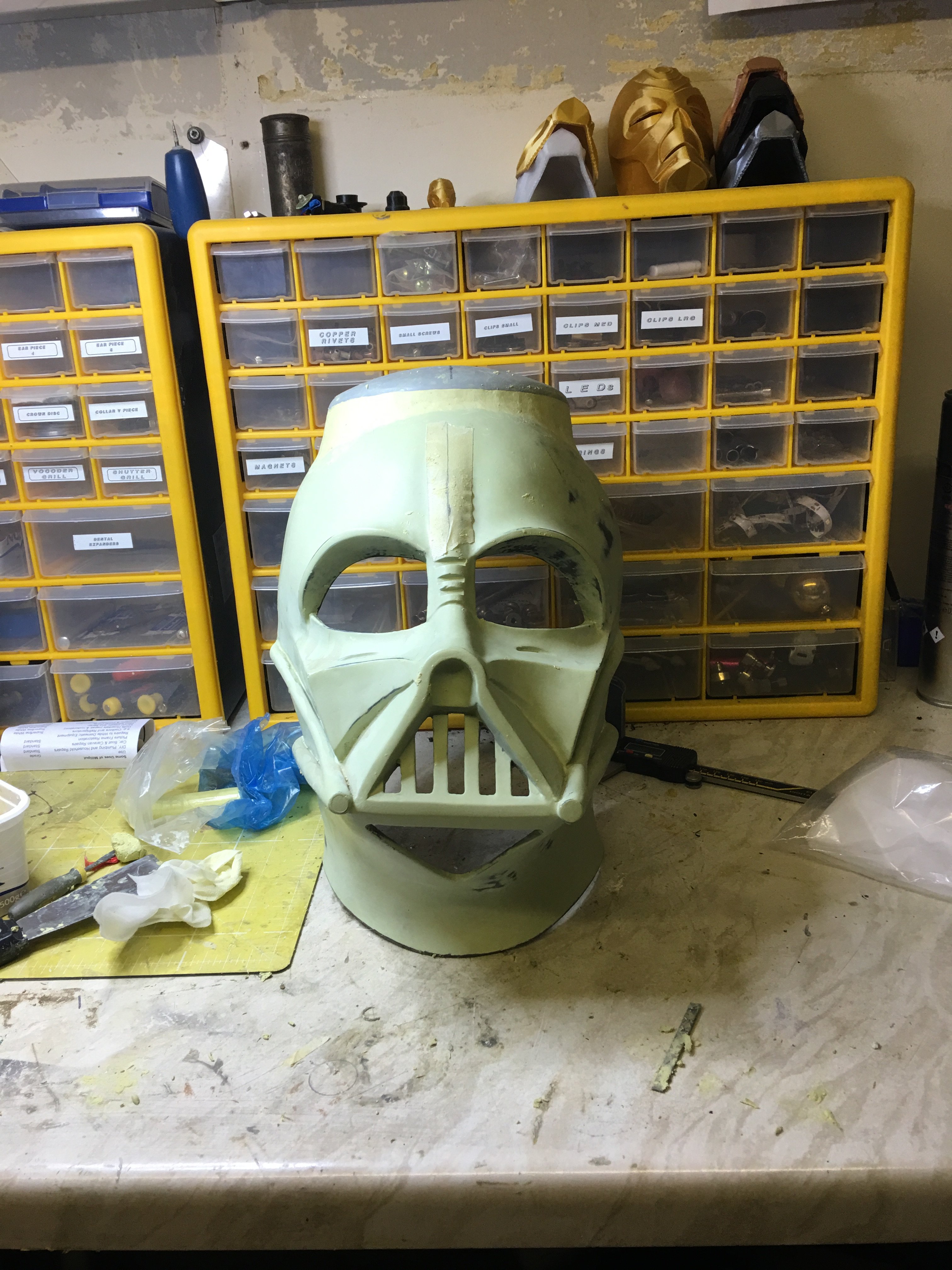

I’ve got a bit of a gap in my 3D printing jobs and also waiting for paint to dry, so I Bit the bullet tonight and started back on my Vader reveal, I’m going to try and fit more Vader work in between the other projects I’ve got on the go
So this is probably the first of many adjustments I might do to the crown before I cut off the lower jaw
So this is probably the first of many adjustments I might do to the crown before I cut off the lower jaw View attachment 1049222
