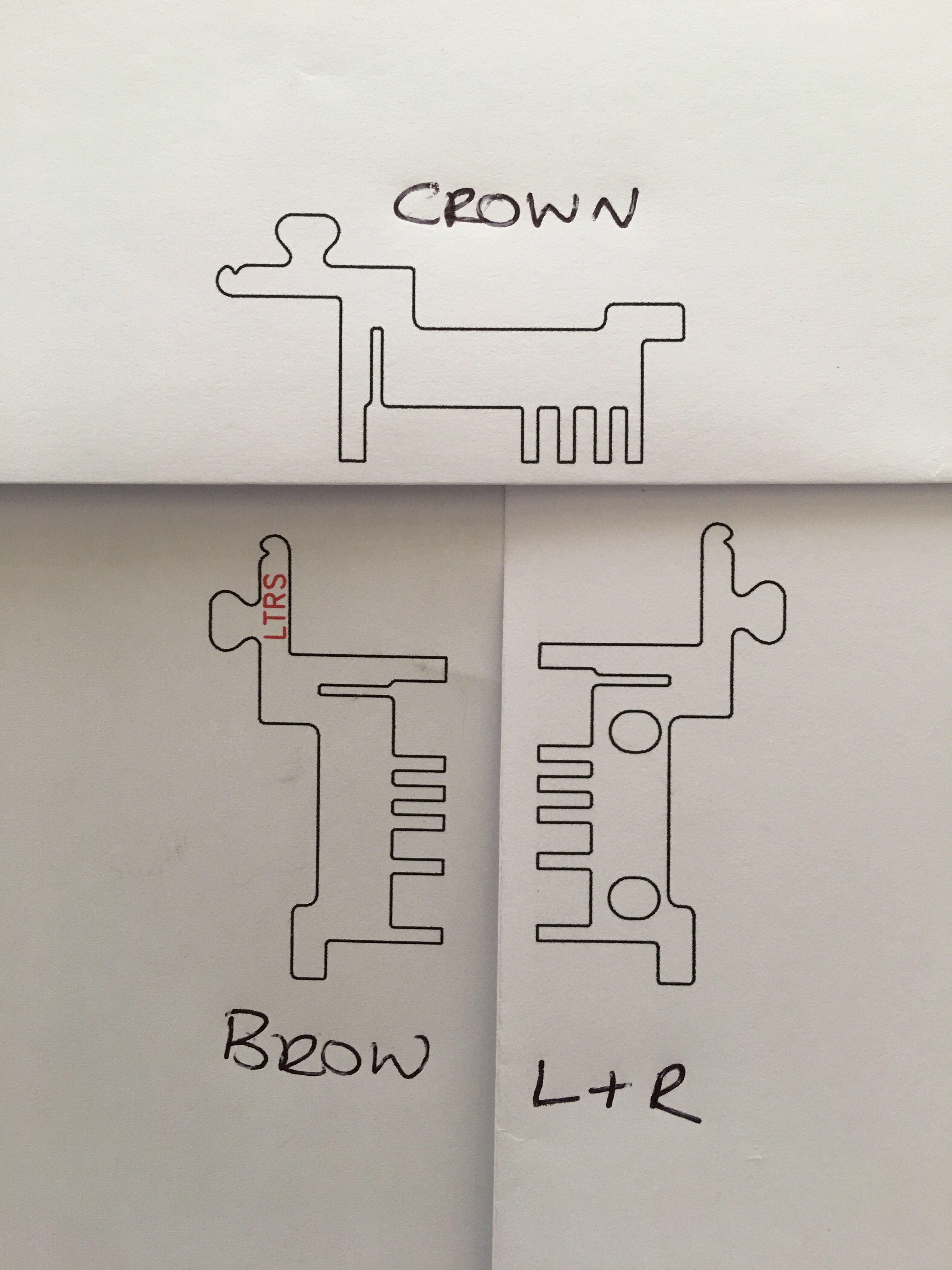

i wanted them 1.2mm but the etchers said because of the width of the legs/stems/gaps they could only do 1mm for the etching process
the other brow linkages with the holes and the top crown linkage will also be cut in 1mm and be sold as 3 per set as they are all the same size just different legs and spacing

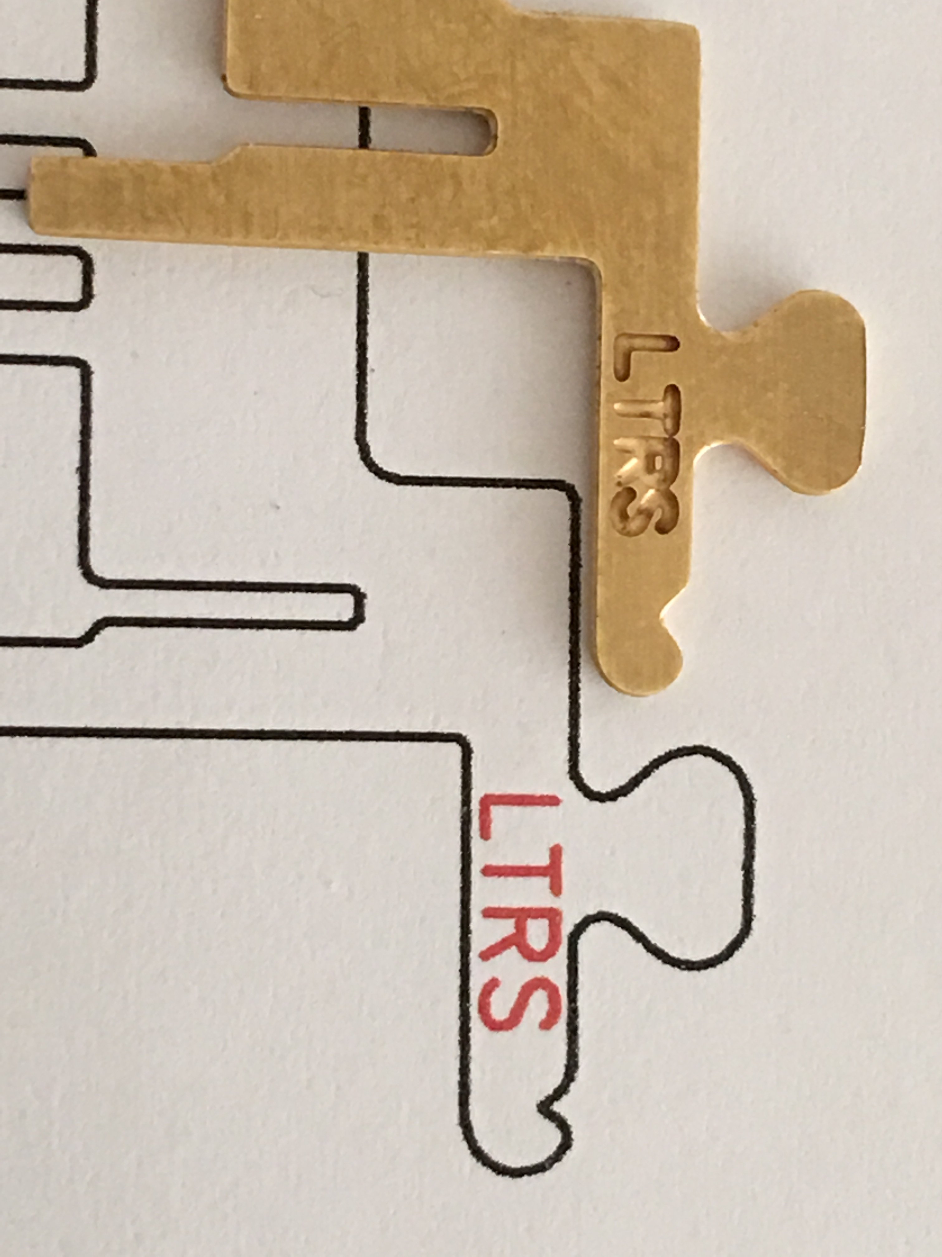

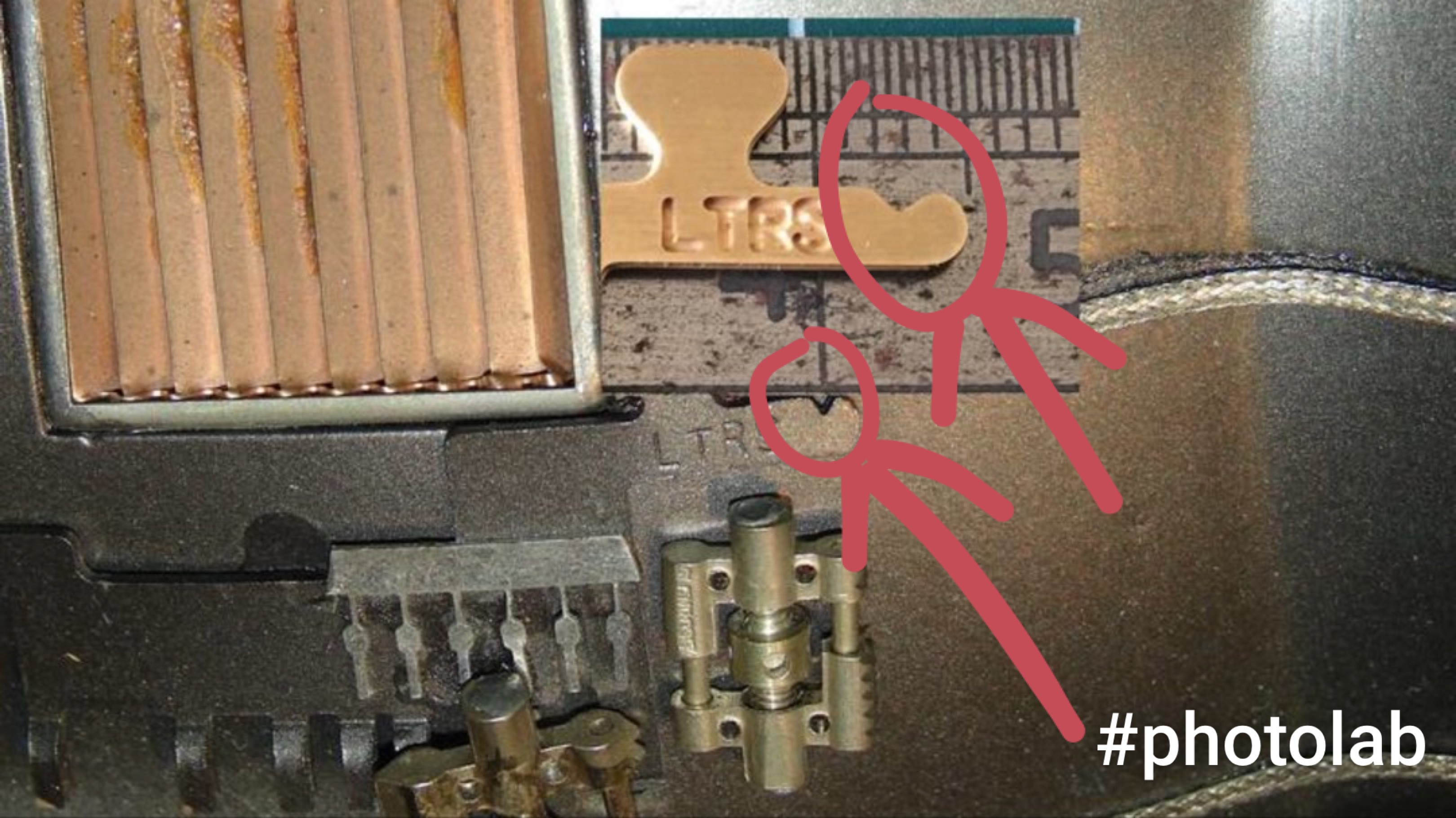

They look nice...the only thing that I see is,that the "LTRS" letters are a little bit too thick.They should be thinner.

Etching on this next
Also a new vocoder fine grill is on order.
What was that did I hear Kroenen77 cheer :lol
What !!! What !!! WHAT !!!!!!!!!!!!! OMG I've got them wrong again :facepalm
remember this post Mark !!! You know I publish scale pics before it goes to cut couldn't you say something then OMG My OCD is kicking in now, I have to re-draw them, print it out, double check it, post it on the RPF for you all to see , send it off lots of emails money out the bank AGAIN !!!!!!
Oh oh wait a minute !!! I think I might have taken the ever so slightly wording into account ( I thought ahead ) "why" I hear you say because a while back I had some pieces engraved but the engraving was just not deep enough and when I test painted them the lettering was virtually non recognisable so I made the lettering ever and I mean ever so slightly increased in size as not to loose the look when painted BUT if they still don't look right when painted then I will just have to get really OCD on it :lol:wacko
its only money and you can't take it with you
Oh no...that was not a bad intention!!!I have not seen all the work for this letters because I´m not reading everyday here on board.:$:$:cry
But please look...the letters are too thick and to near.Thats sadly a fact.
Did I not sent you a copy of my parts?I would say my letters are ok...but not the shape of my part.Mine are made with a laser.

I´m really sorry about that...but he wants to make the 99,9% perfect accurate parts.And I wanna help him on this way!:)

Haha..my own wife hates me for my hobby...so I think I can handle the hate of yours also!Haha!:lol;)
Do you now understand the words "Work slow" that I said to you at the beginning of your project?I lost so much money over the years with this mask and other project because I was too fast.But thats the hobby...if we all would build perfect props in the first attempt we would not need this board.:)

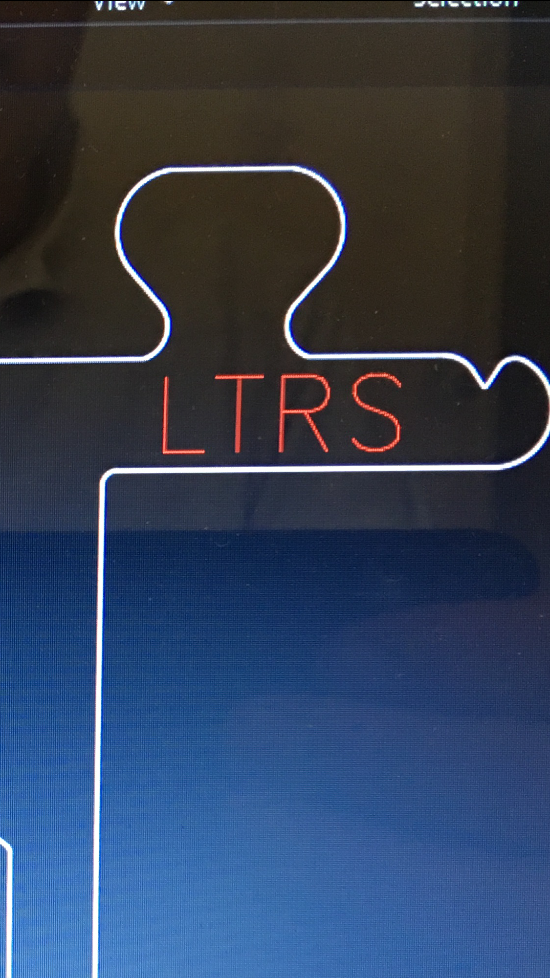

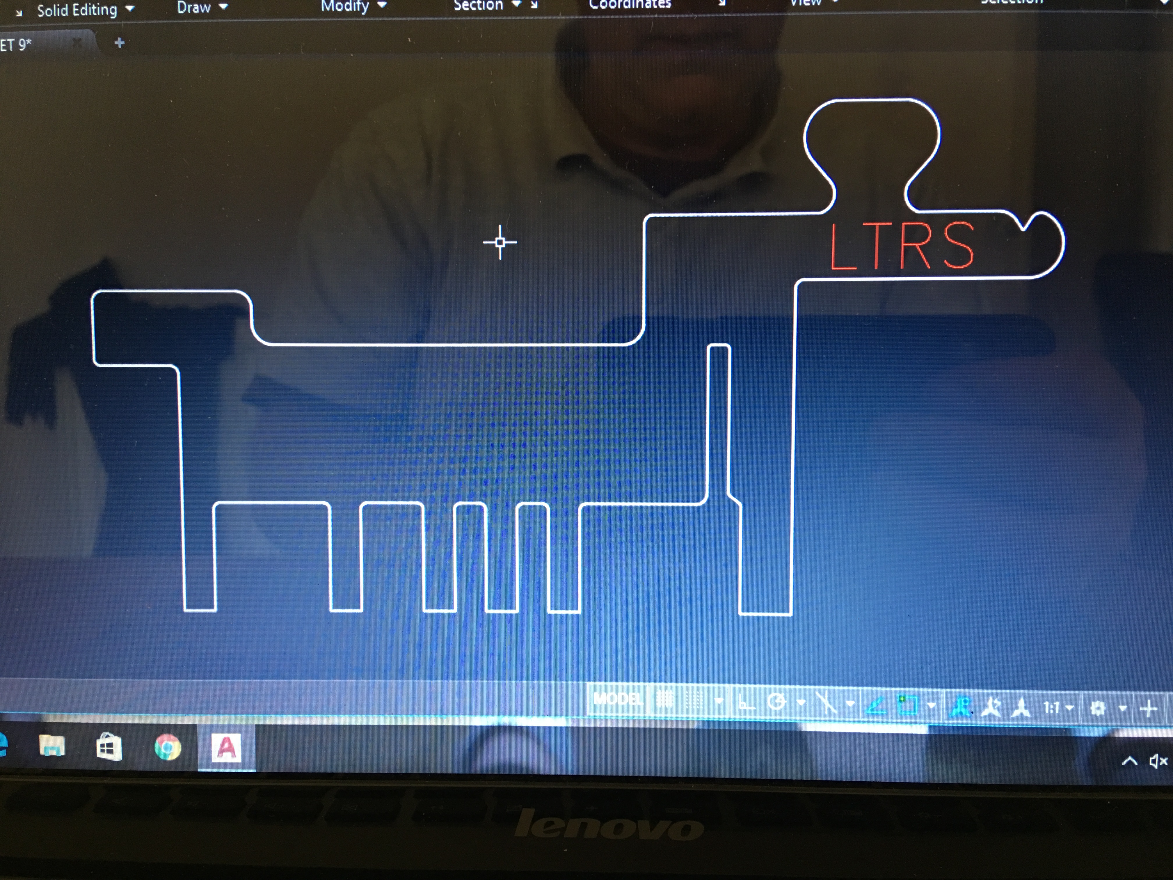

Update again!!!!! :lol

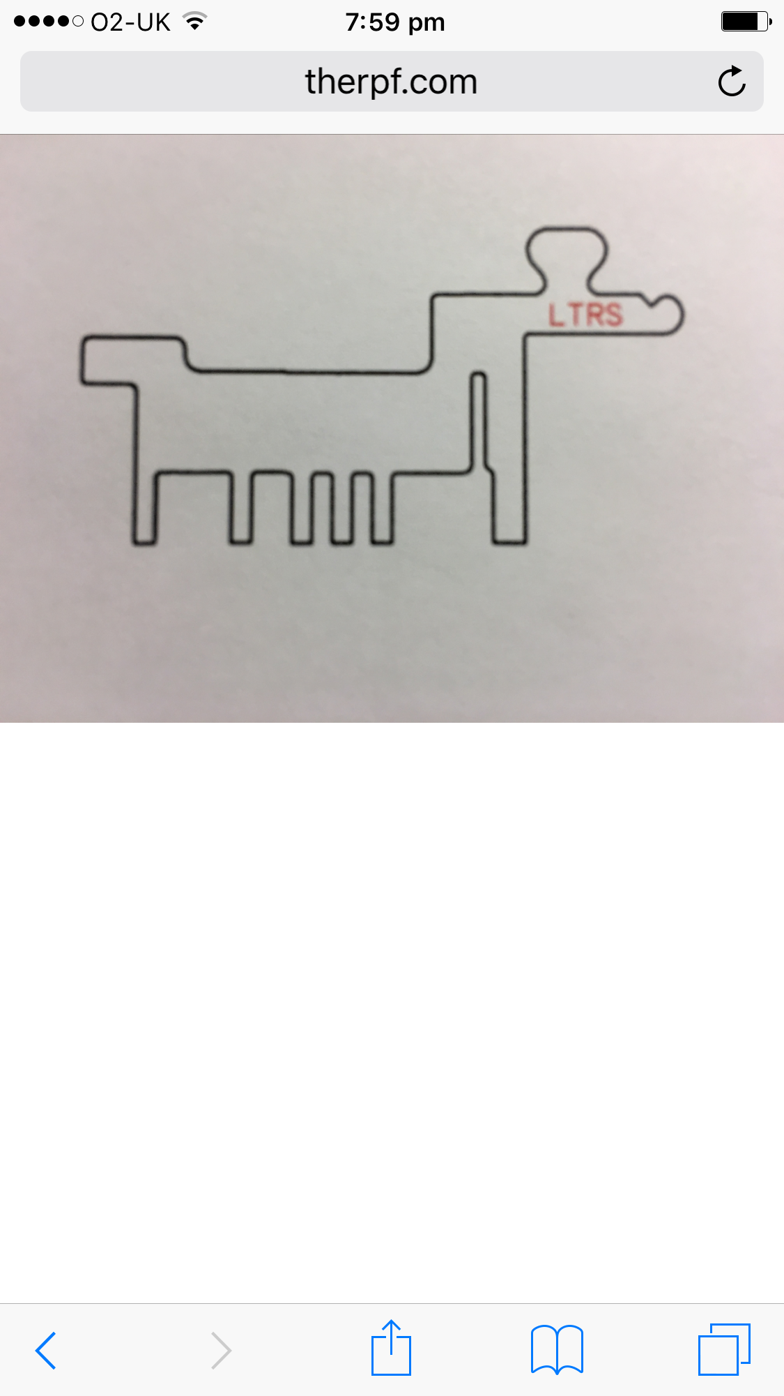

Ive altered the lettering and the little cut out at the end I've also altered all the cutouts on the other brow linkage and top crown linkage all are still matching
It's a thinner text and spaced slightly wider as the first attempt the S was to close to the R
input input input
I need at least 3 different comments all confirming the same if I get 3 good to go then I will send to cut
the shape is good it's just the text, I'm a lot happier with it but what do I know after looking and looking I've gone Vader blind ( fresh eyes please )
Much better..but I would make the letters a little bit smaller.Only a 10% I would say.Look at the distance to the edge of the part.And the R has a smaller arch on the Original.
