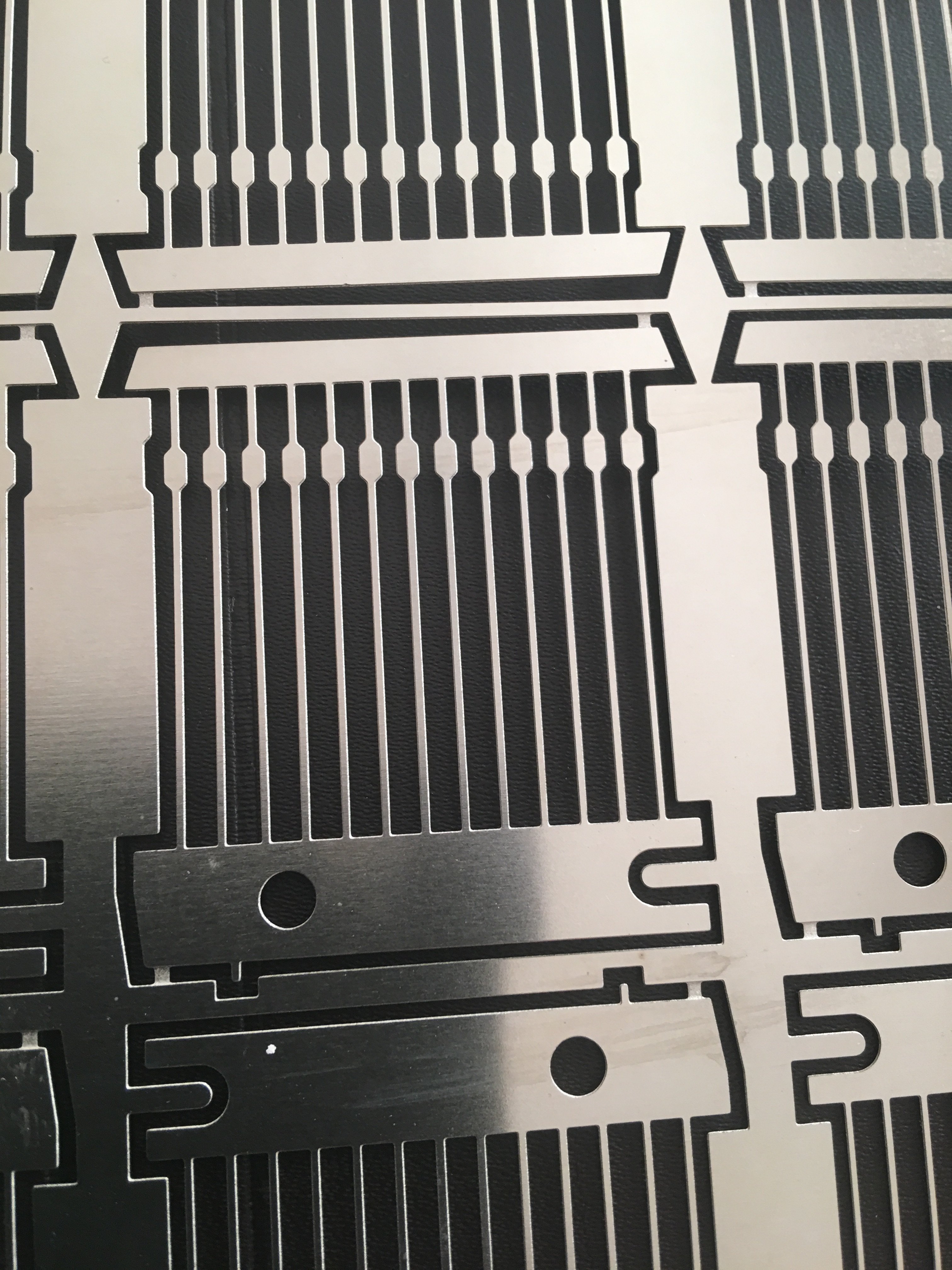

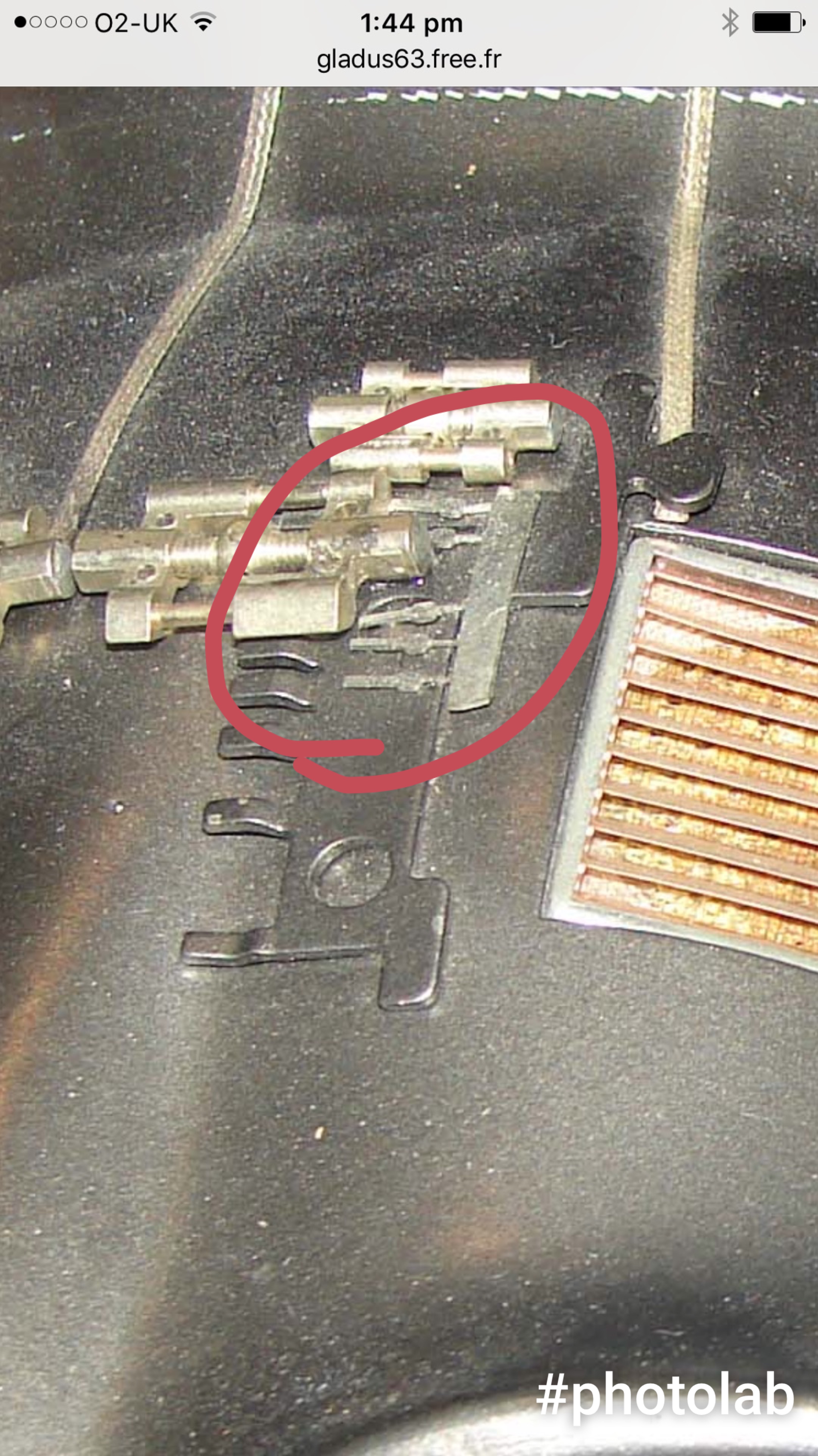

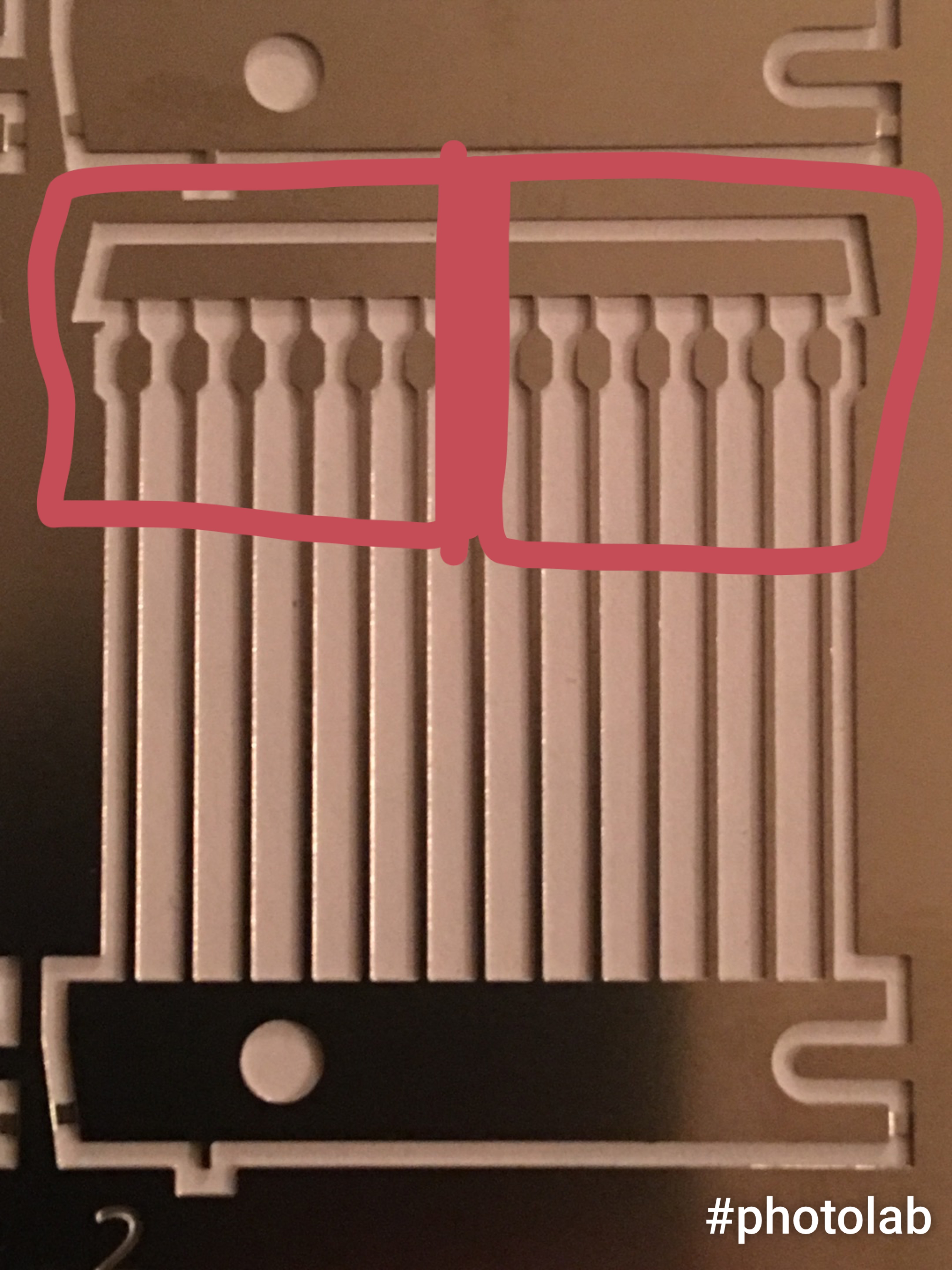

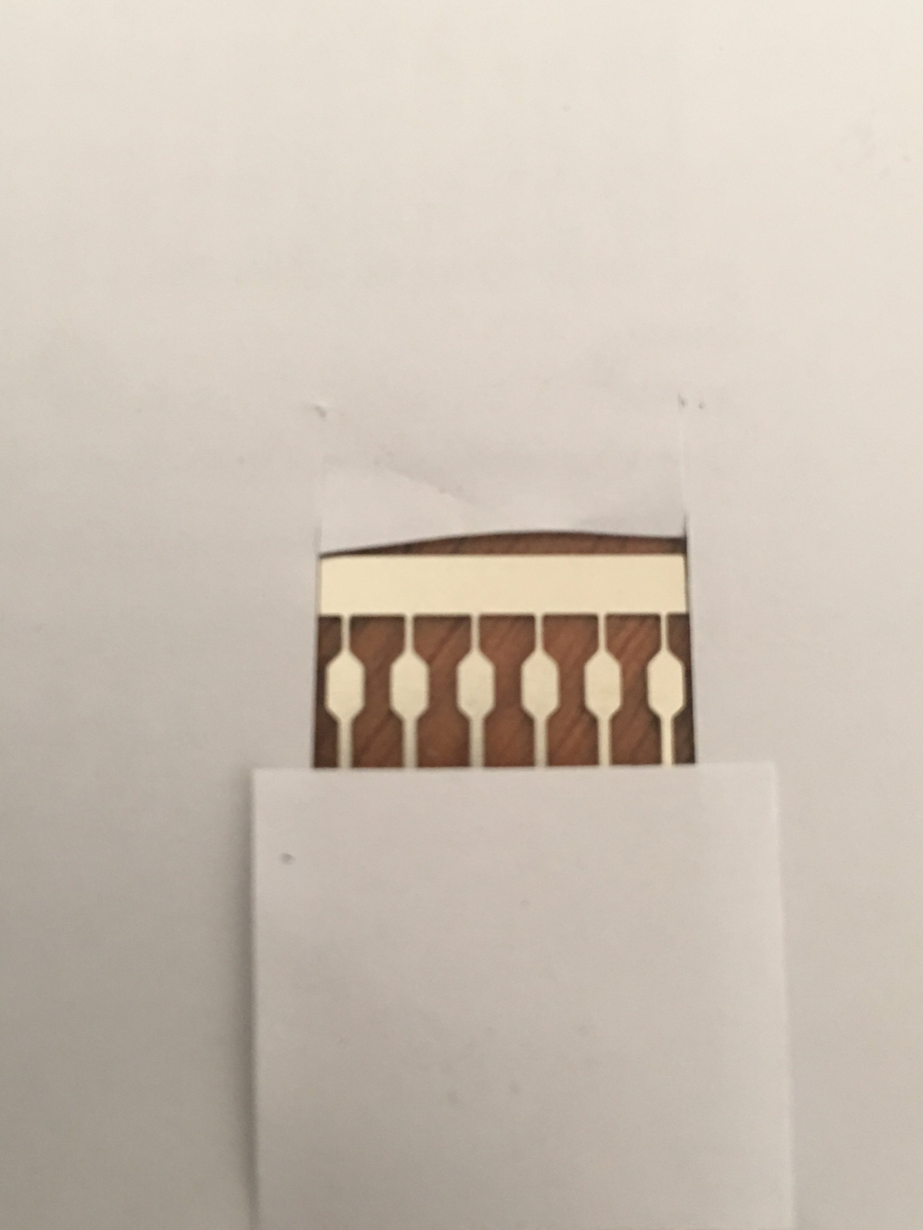

As you can see the mistake I made on the first vocoder wire
old one
The new one. The blobs on the strands are much closer to the top also the small strands after the blobs are thinner than the first
They can also be cut down and used as the cover piece on the brow linkages

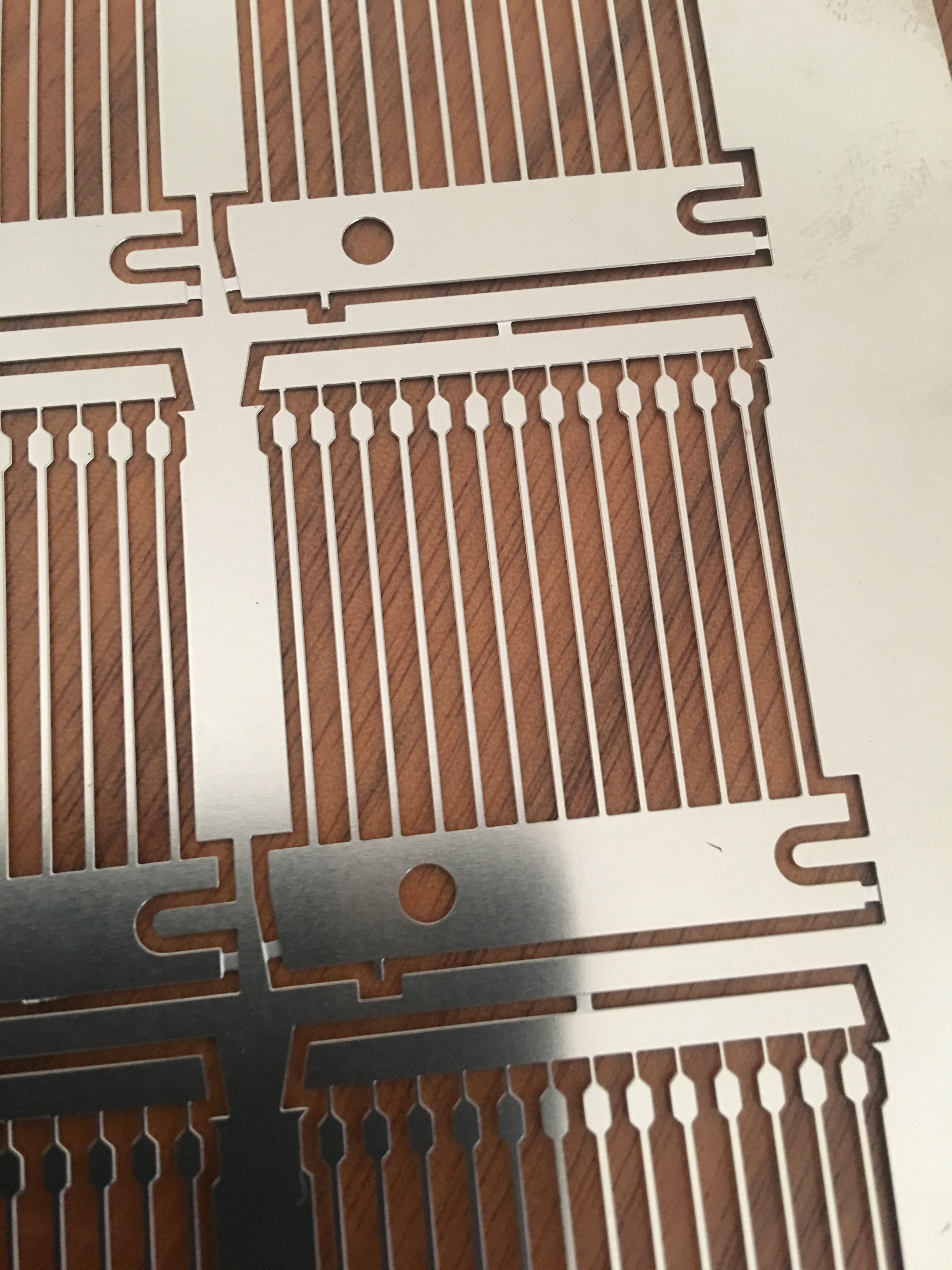

Just one part, when cut into 2 you should have 6 strands on each brow cover and there are13 strands on 1 full vocoder piece, one brow cover has only 5 strands as 1 has been cut off

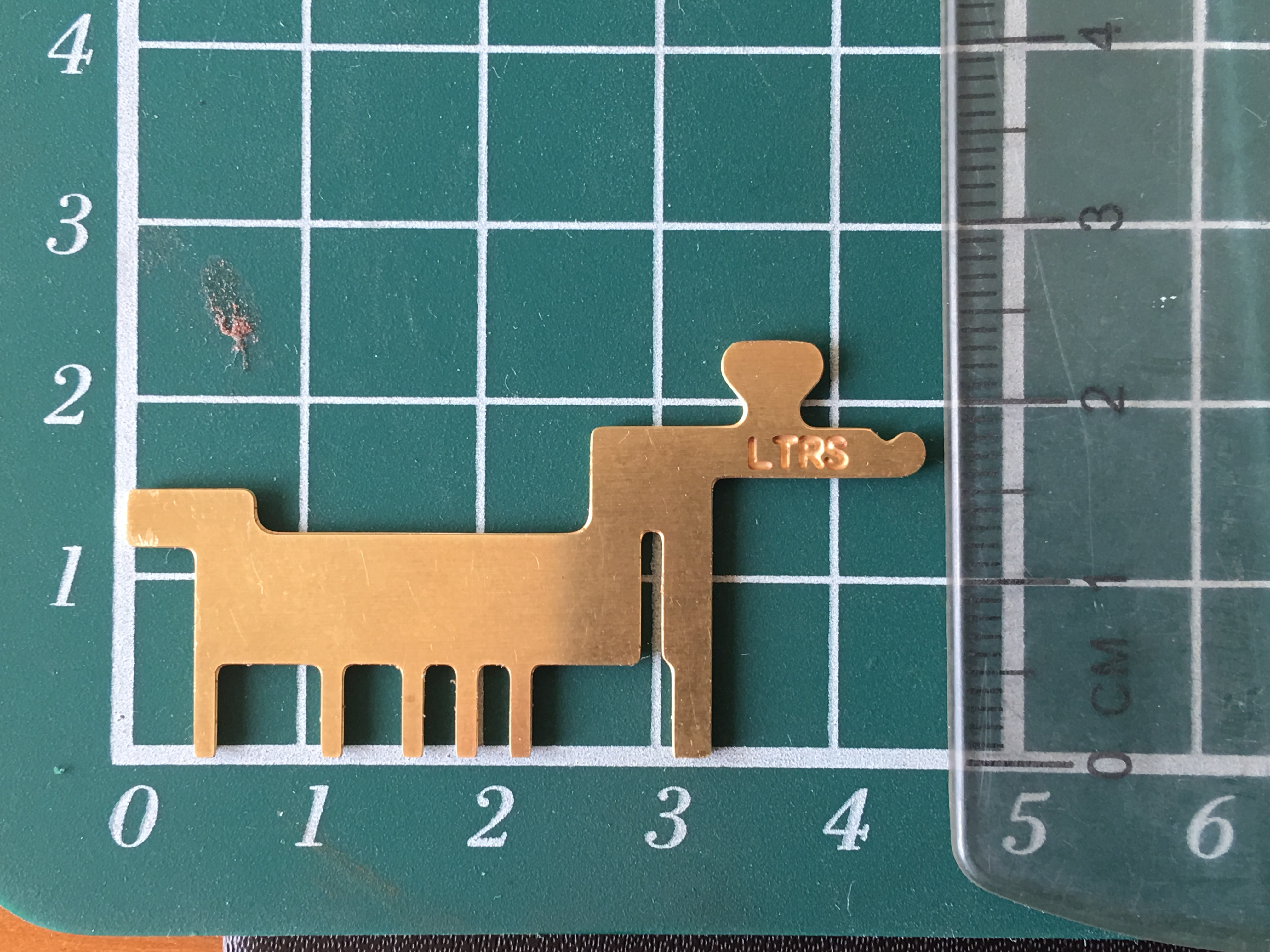

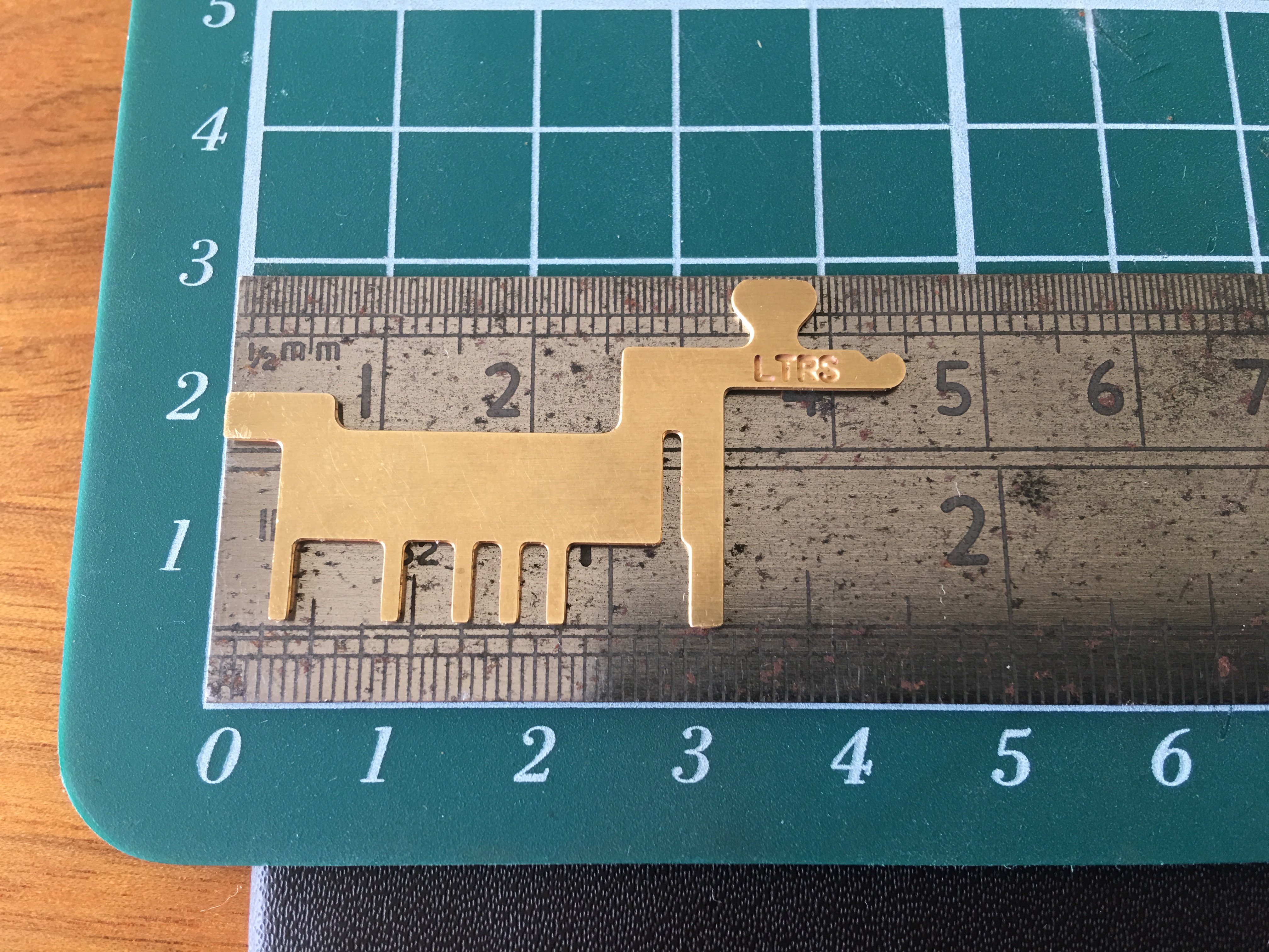

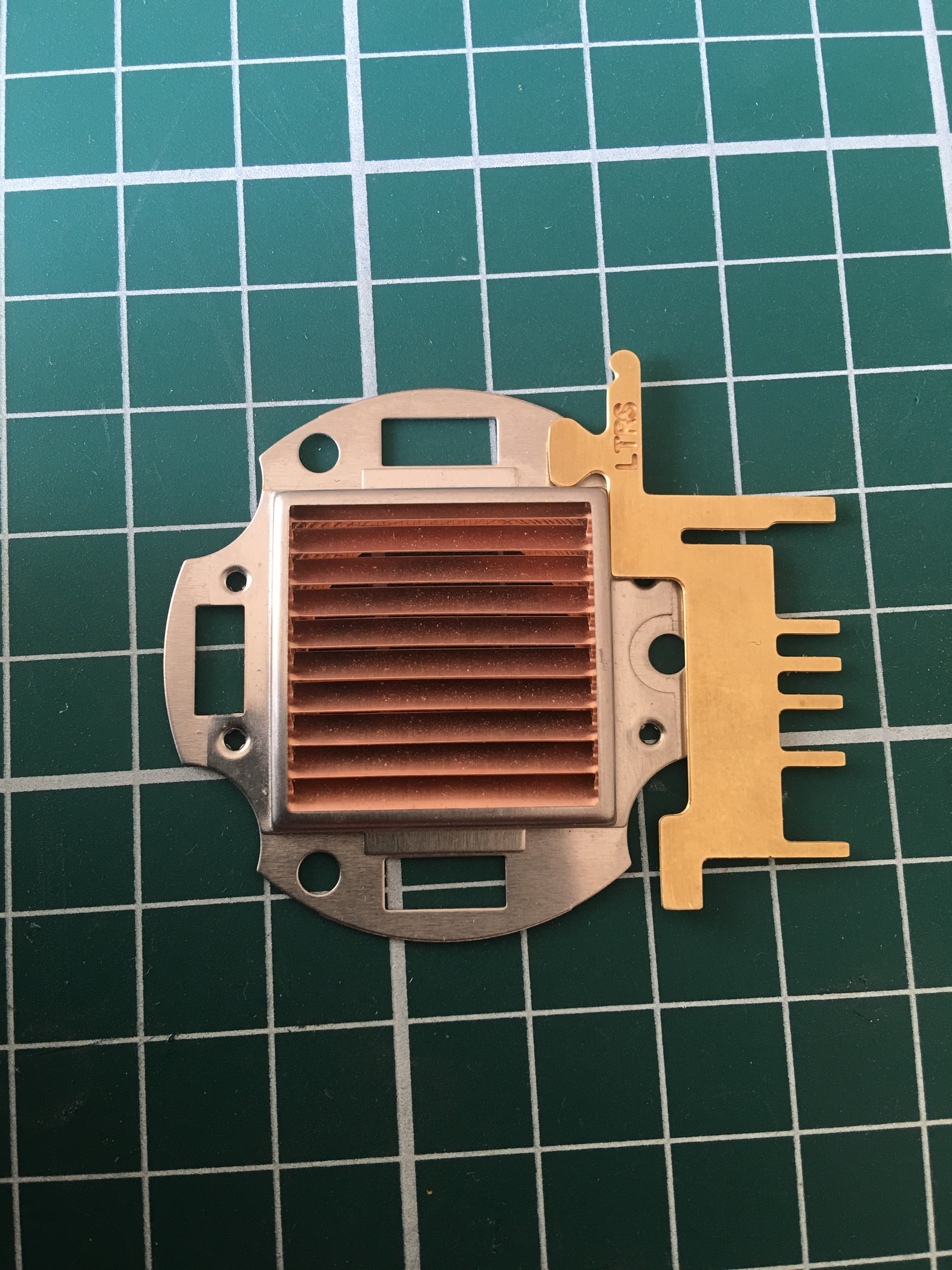

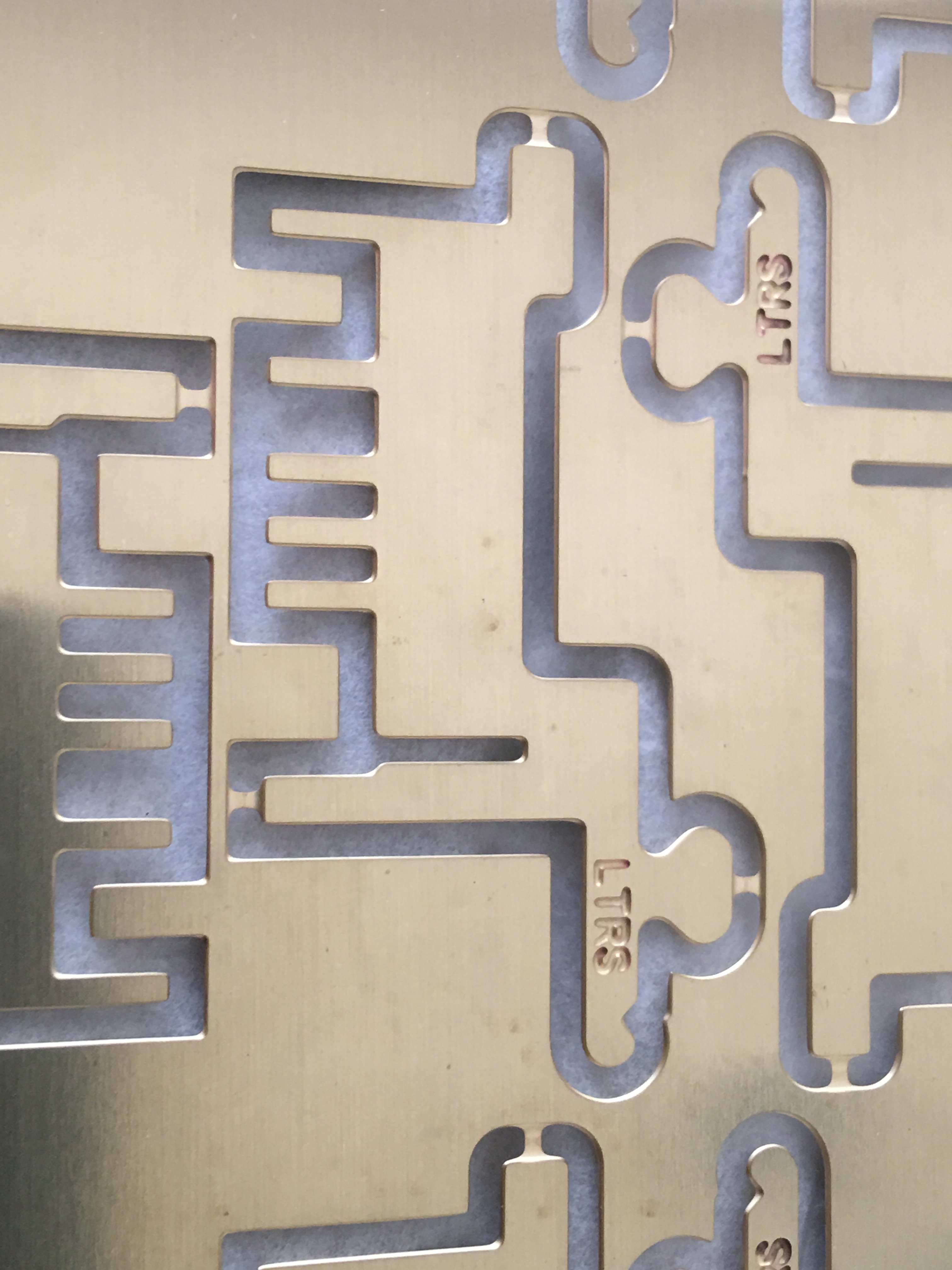

Looks nice...how big and thick are this "LTRS" parts?

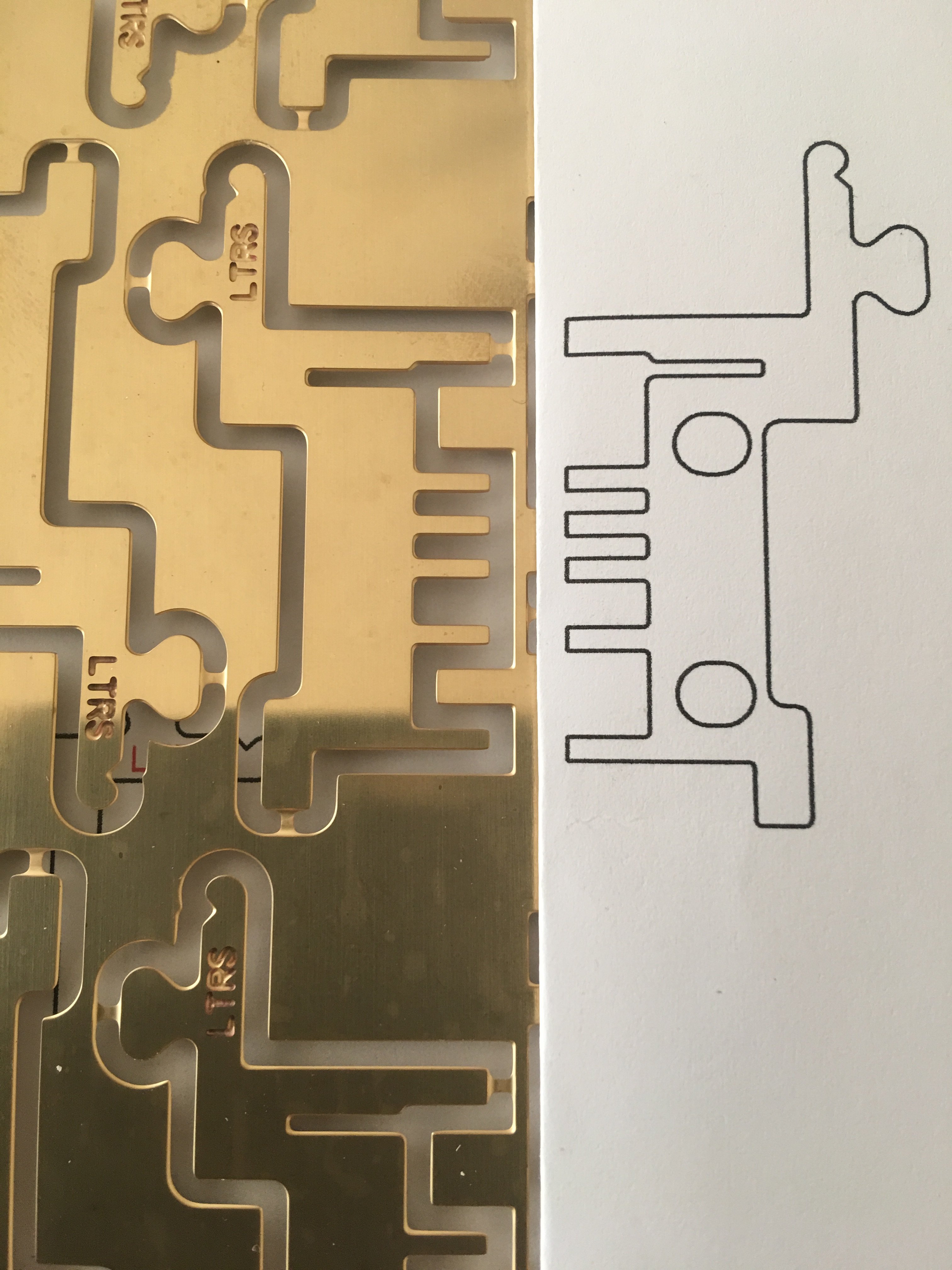

After 6 attempts on these I finally got this size by scaling them from Paris expo photos as you can see
i wanted them 1.2mm but the etchers said because of the width of the legs/stems/gaps they could only do 1mm for the etching process
the other brow linkages with the holes and the top crown linkage will also be cut in 1mm and be sold as 3 per set as they are all the same size just different legs and spacing
View attachment 725168View attachment 725166View attachment 725165

That's awesome work Ben, they're looking great!
For my own prop I scaled these forehead parts, (as well as the '1-4' linkages and the clusters of layered up little bits on the sides right at the back) all at 1mm thick anyway. I'm not at all suggesting I'm right but I don't think 0.2mm would make much of a difference so I don't think you've had to compromise too much, they look terrific :)
