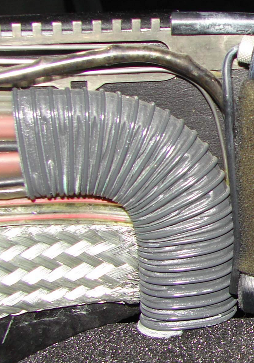

Trap Joe I've just had a look at your Vader build to see what I have to aim for but cannot connect to any photos :thumbsdown do you still have any photos you could share with me and other members reading my build ?

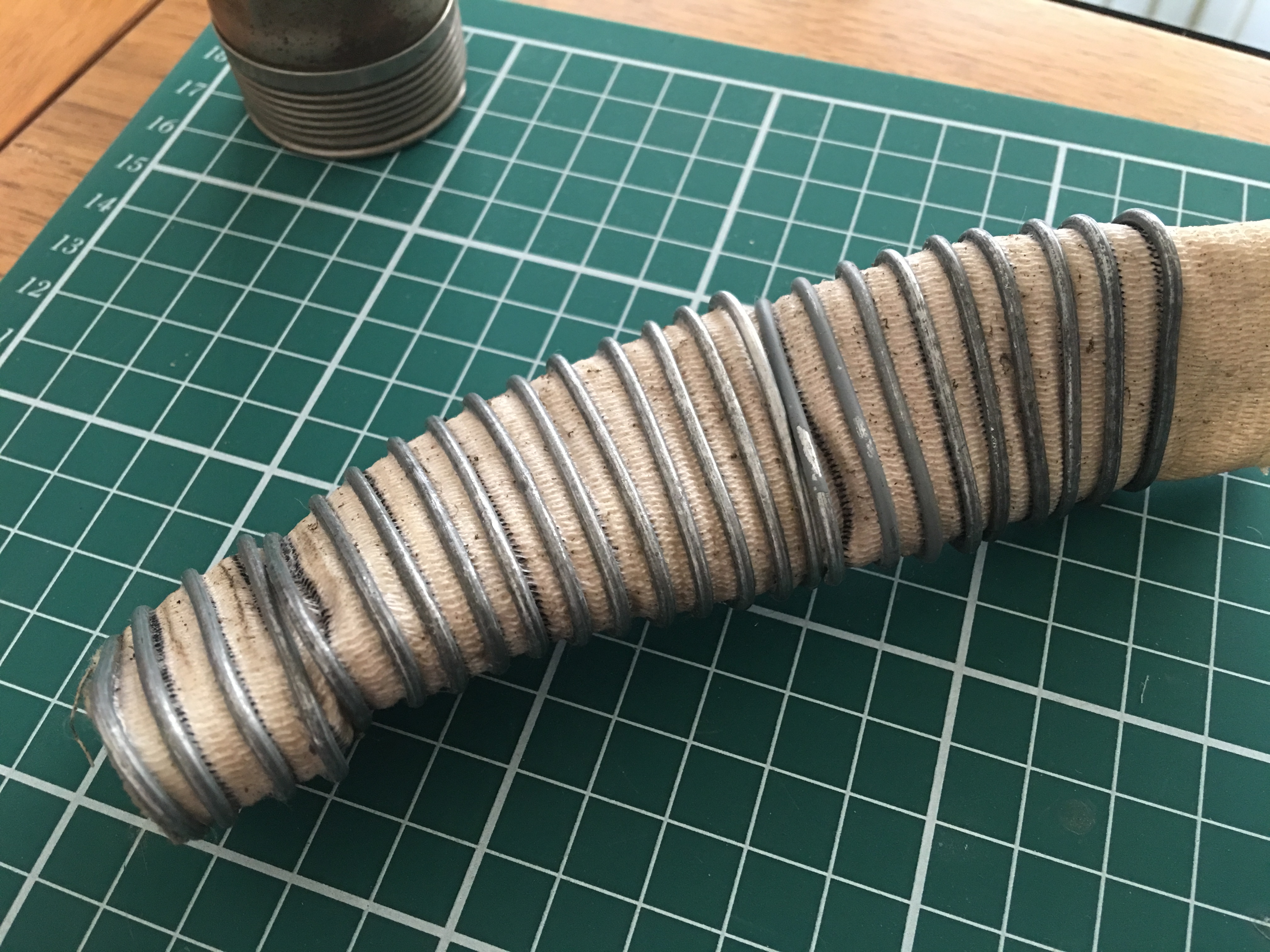

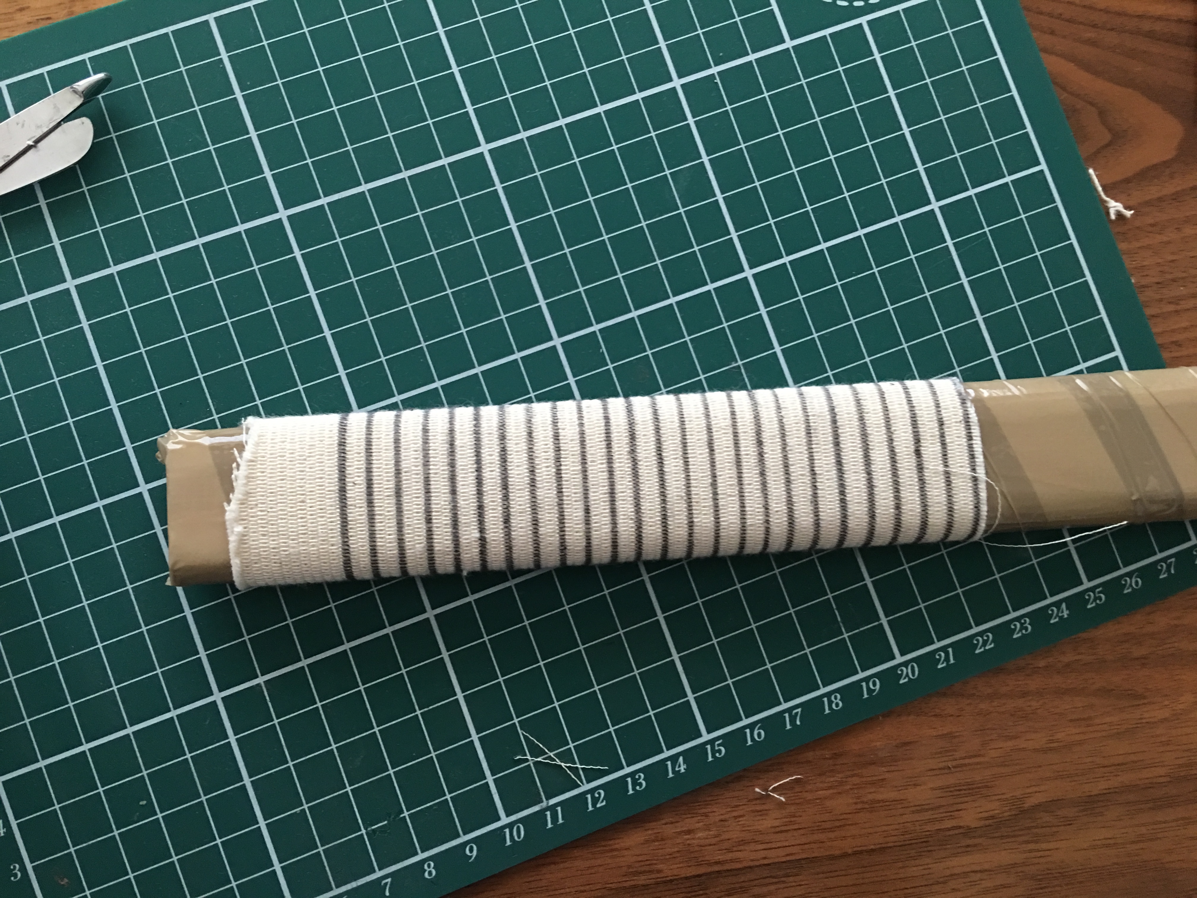

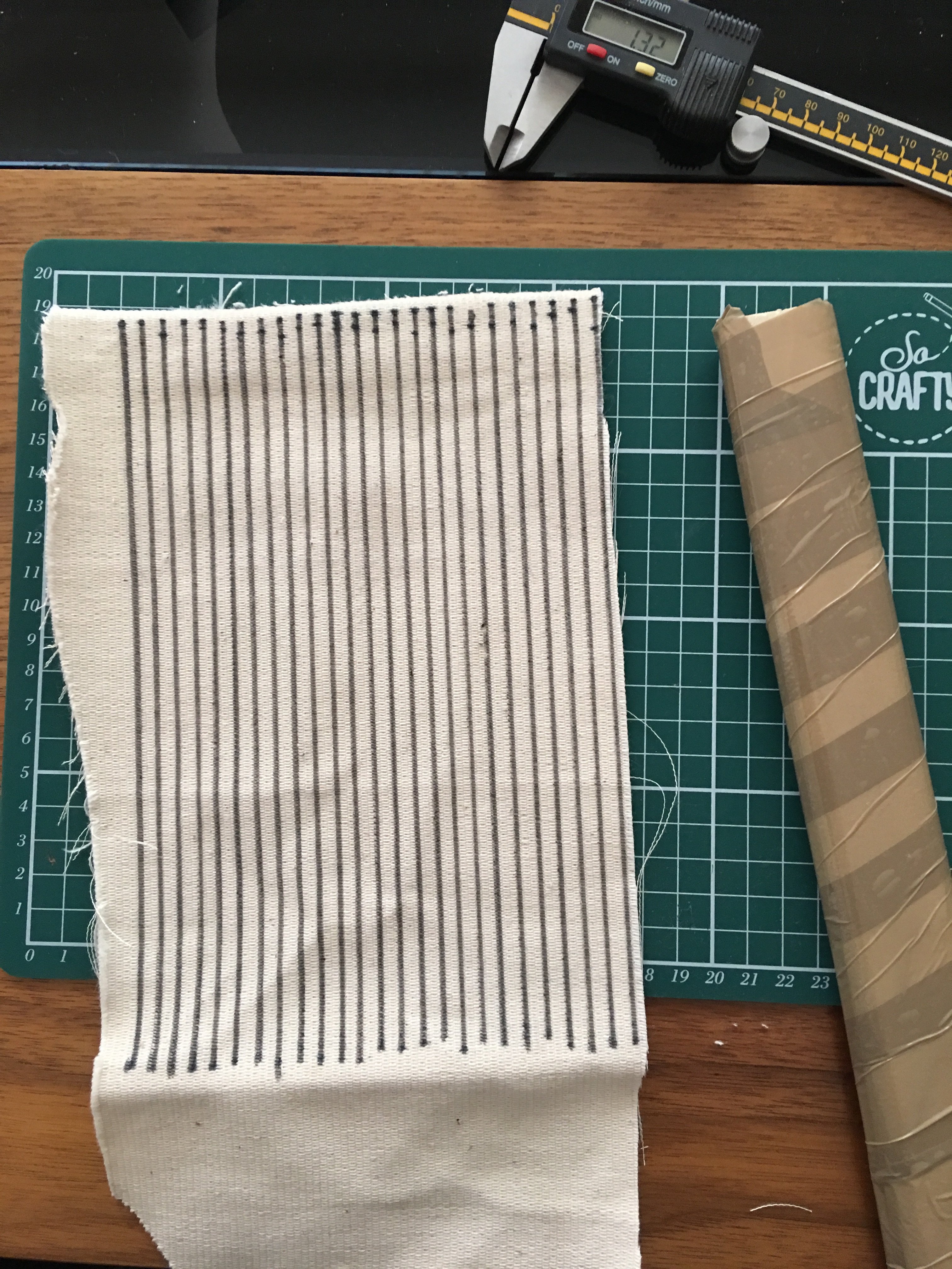

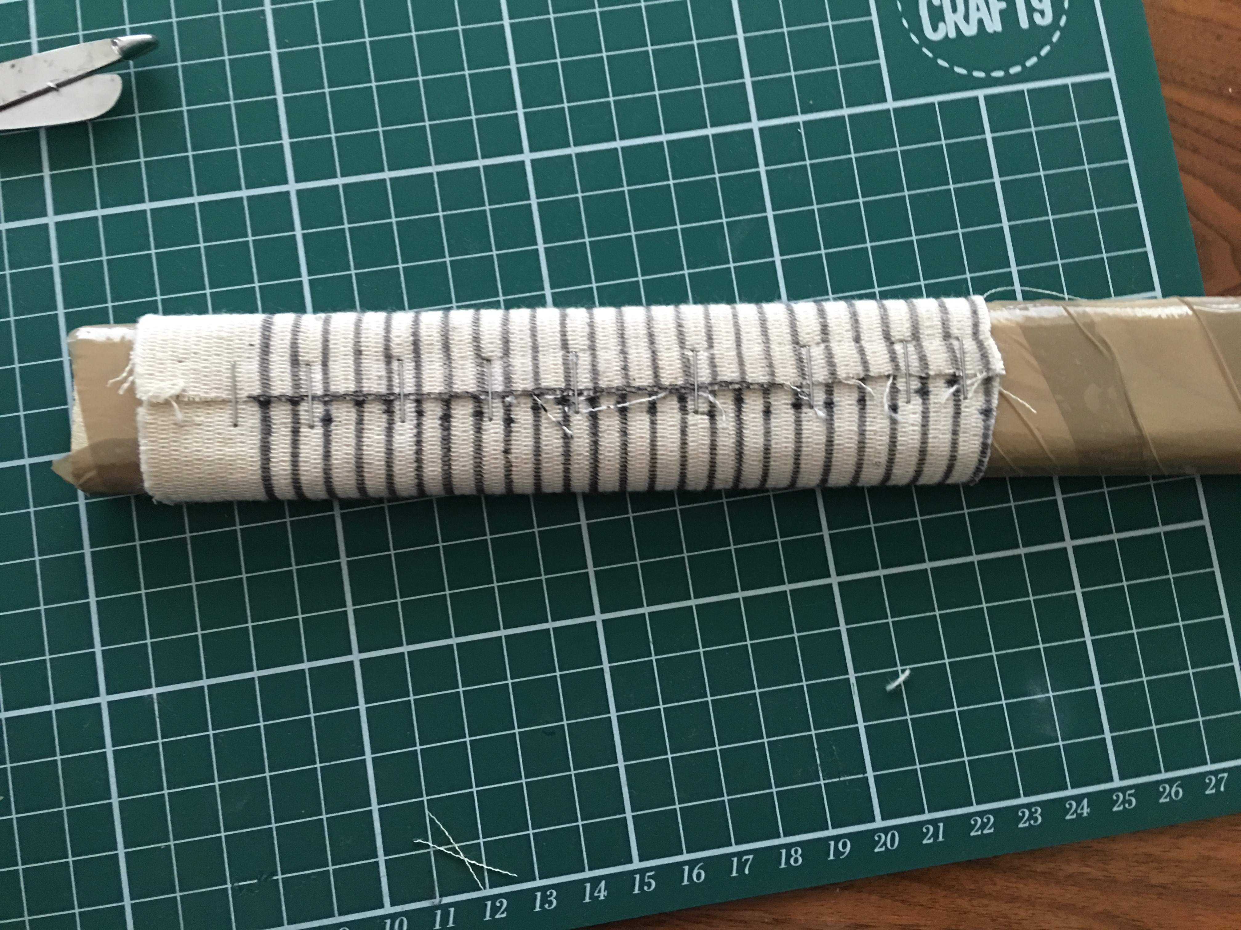

Excuse the roughness of this test piece but it's just a first attempt, not as neat and tidy as it's going to be but I just wanted to see if my idea had any weight behind it !!
First a piece of canvas cloth and a wooden dowel shaped to approx size, the cloth was marked up with lines for the wire, the wooden dowel was wrapped in packing tape so not create an adhesive surface.
The cloth was then wrapped around the dowel and stapled to keep in place, they will be remove at a later stage.

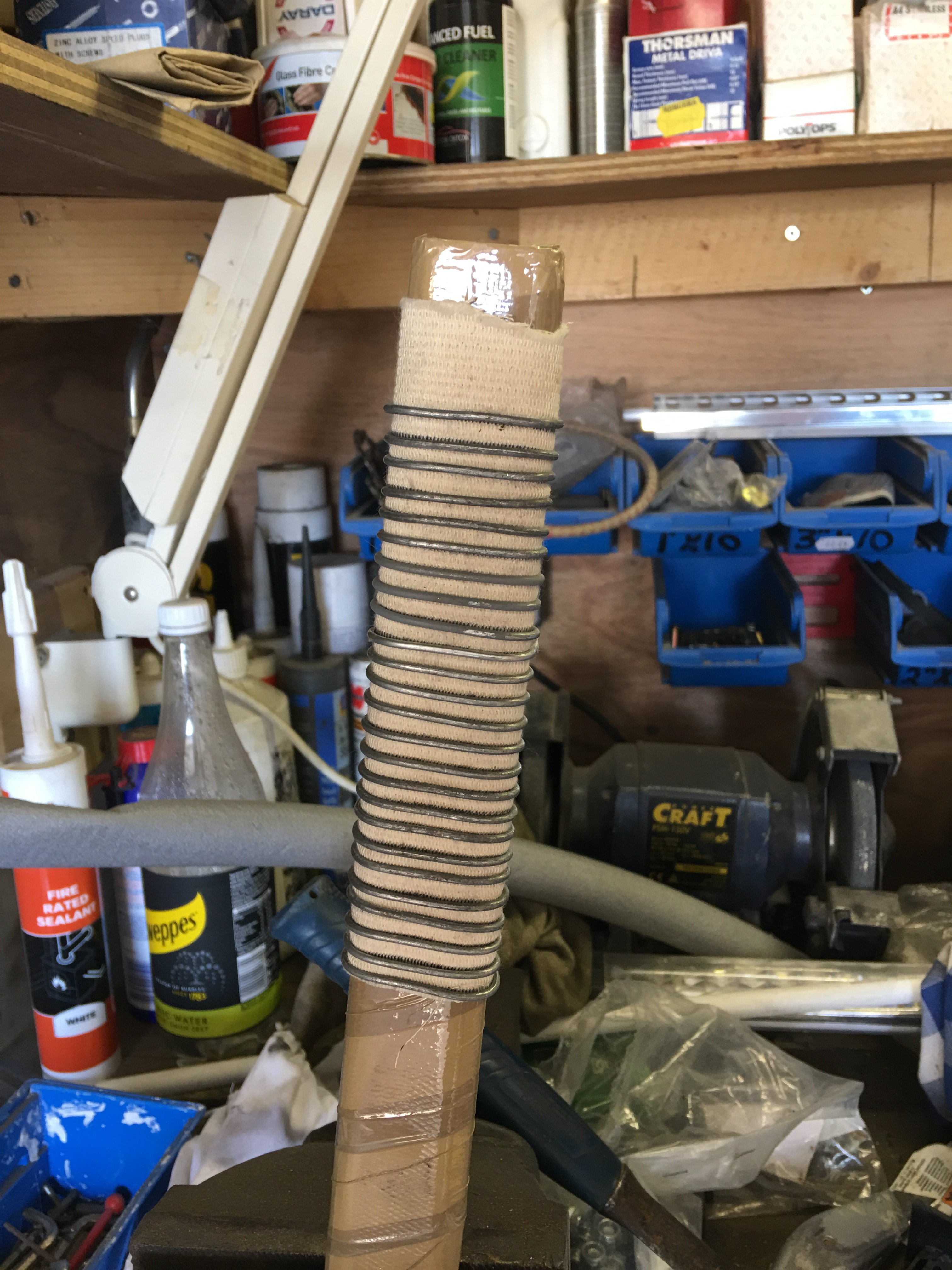

The wire (very stiff suspended ceiling wire )was then wrapped around the dowel following the lines ( ish )
Now that it's wrapped I've straightened up and spaced them out, please remember this is just a test piece so accuracy is not my main concern, I've now started to coat it in a very very thinned out latex solution, I will give it a few coats to adhere the wire to the cloth, more pics and progress tomorrow
Please remember just a test piece

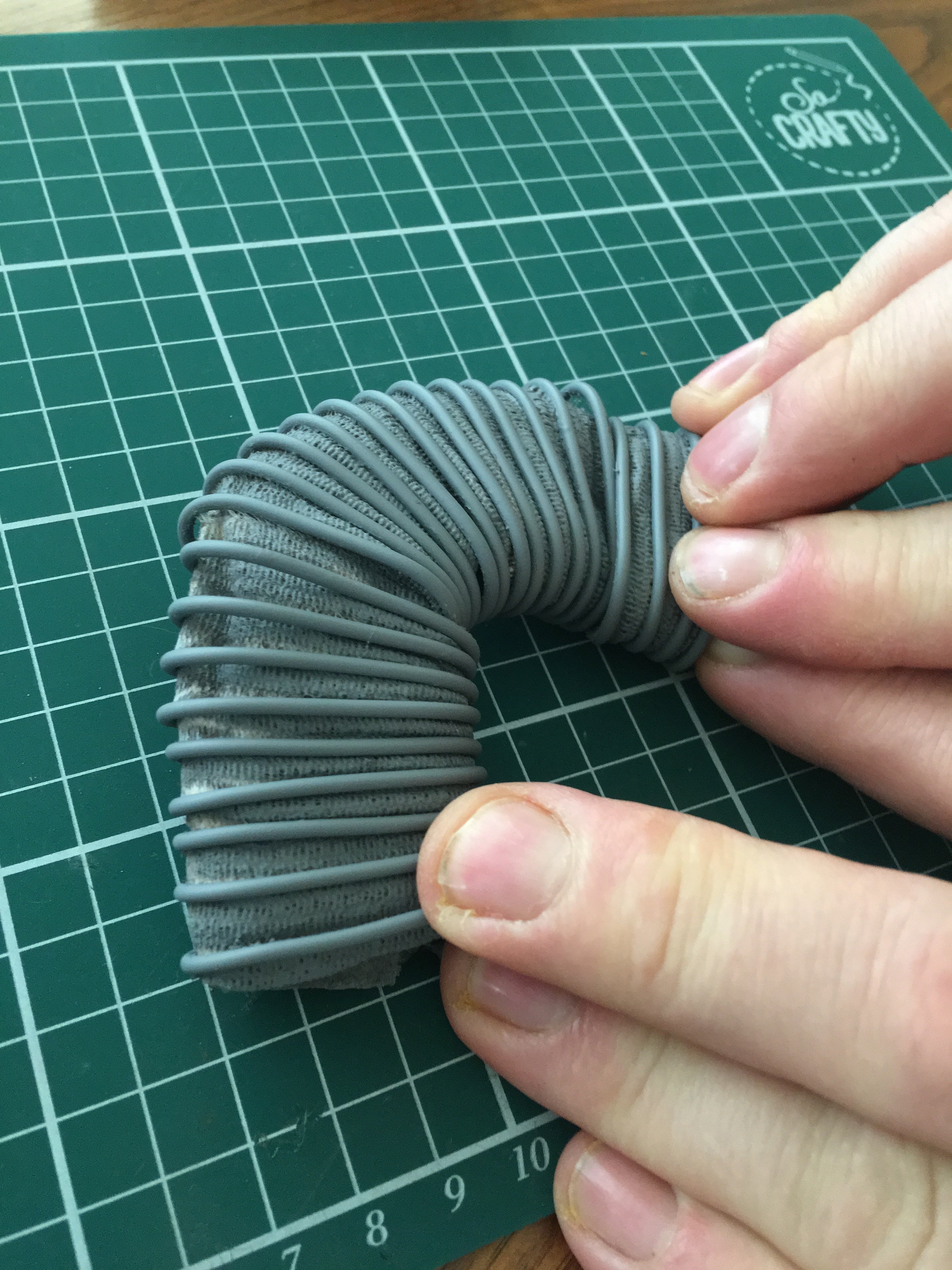

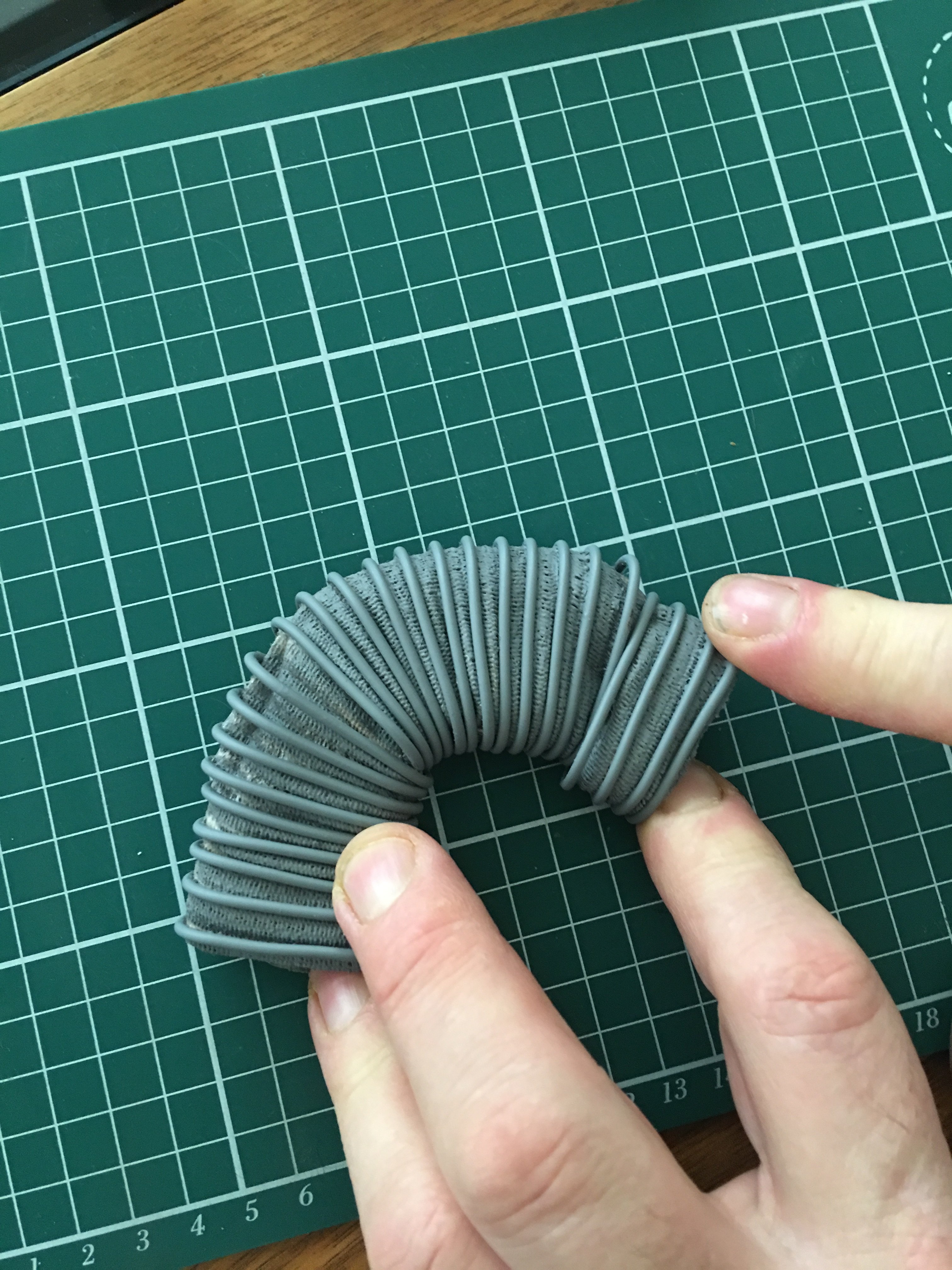

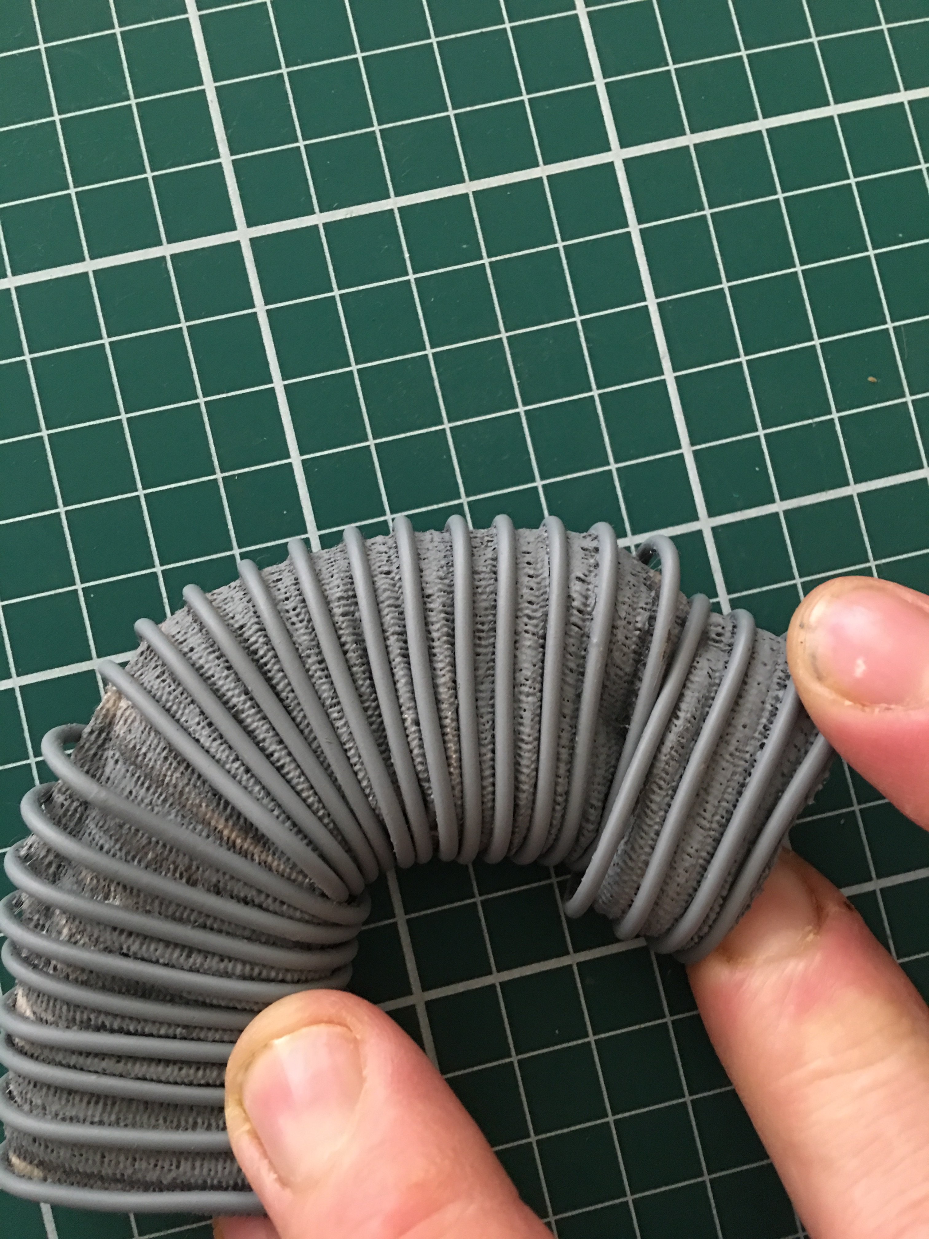

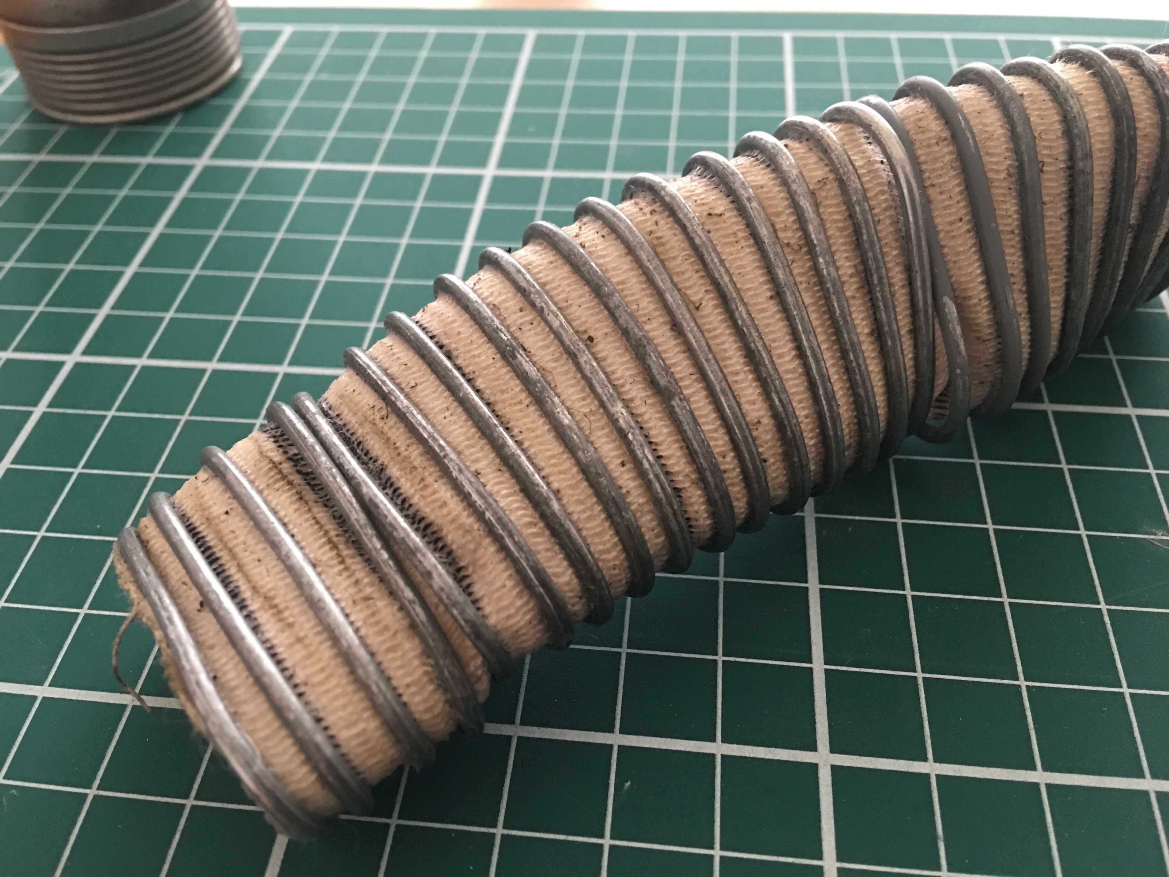

Update on the grey pipes
please don't be disappointed with the results that you see !! I'm not at all, in fact I'm very encouraged by what came out after only a couple of hours work

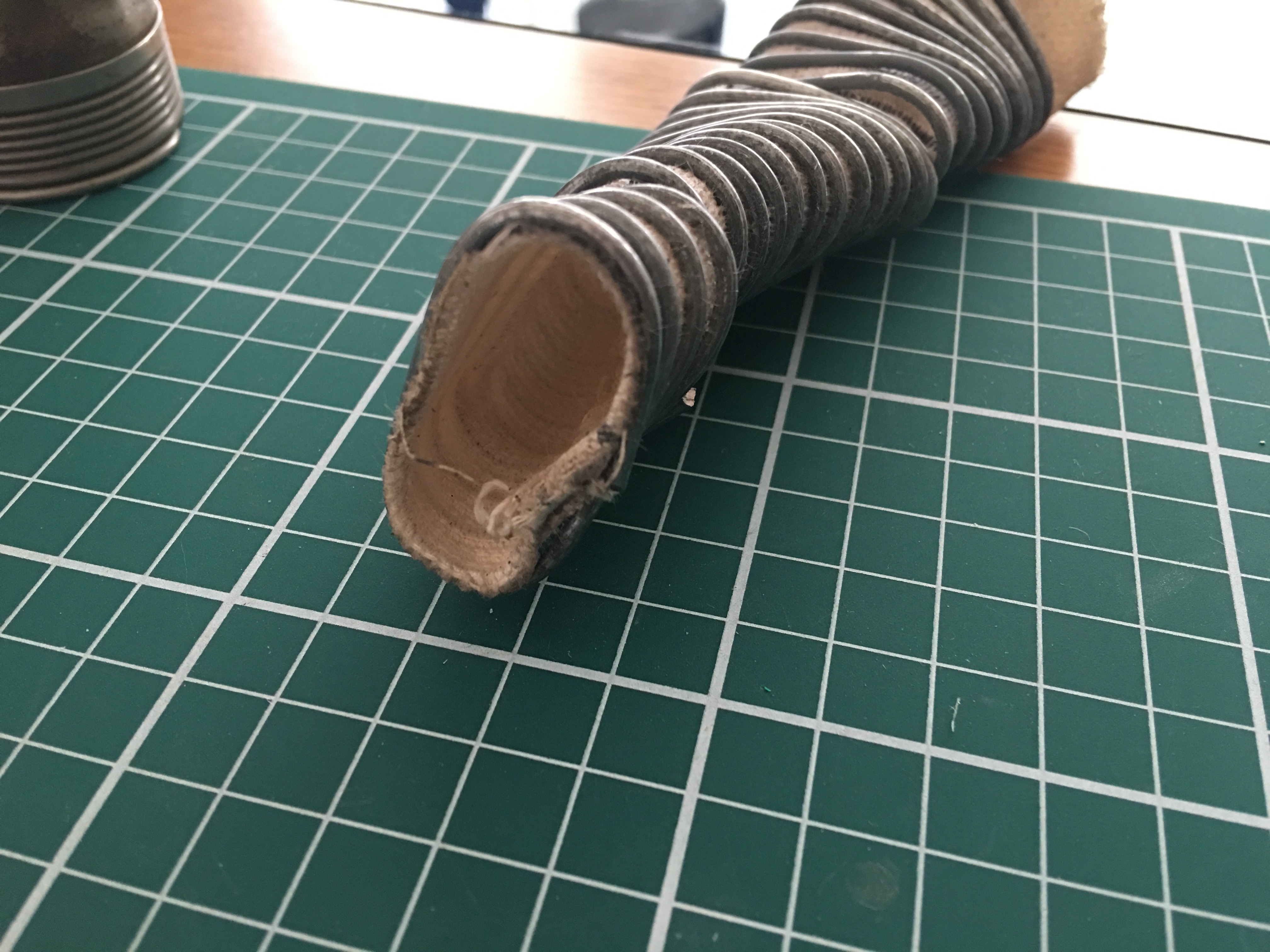

I removed the inner wooden dowel after only a couple of thin layers of latex and 80% of the wire had adhered to the cloth and because of the wrapped wire around the dowel it had caused it to twist like a spring, so I now know the wires need to be cut into individual rings
I gave it it a coat of primer just for a coloured look and gave it a quick bend, as you can see it has some sort of similarity to what we are looking for and you can still see the cloth pattern effect as the original ( maybe I need a tighter more heavier canvas )
Next test piece will have thinner wire, all cut and bent individually the stiff wire I used was 1.9mm ( to big for the correct scale ) but it was quite ridged, next test will be 1.5mm copper wire, softer, more workable and I can solder the ends together for more rigidity
the cloth will be covered in a layer of thin latex before it's put on the Woden dowel for easier removal later, I will also hand paint or spray the whole thing with a rubber based paint, 1. so you don't see to much weave from the cloth and 2. To give it much more rigidly when it's bent
im happy with the failed results as they are positive results in my mind, I'm sure this can be achieved
Looks good..but you must find a way to attach the fins permanent on the cloth if its bended.
I pulled an old one apart a couple of weeks ago at one of my cousins work shops/ garages ( to big to use ) and it was only held together with rubber thats what gave me the idea on the original one, but I will get there
Back when I was a lad, there used to be plastic covered electrical wires used for connecting a blasting detonator to the charge. These were quite flexible, but held their shape rather well when first bent into shape. I think copper will work better than steel for the tubes.

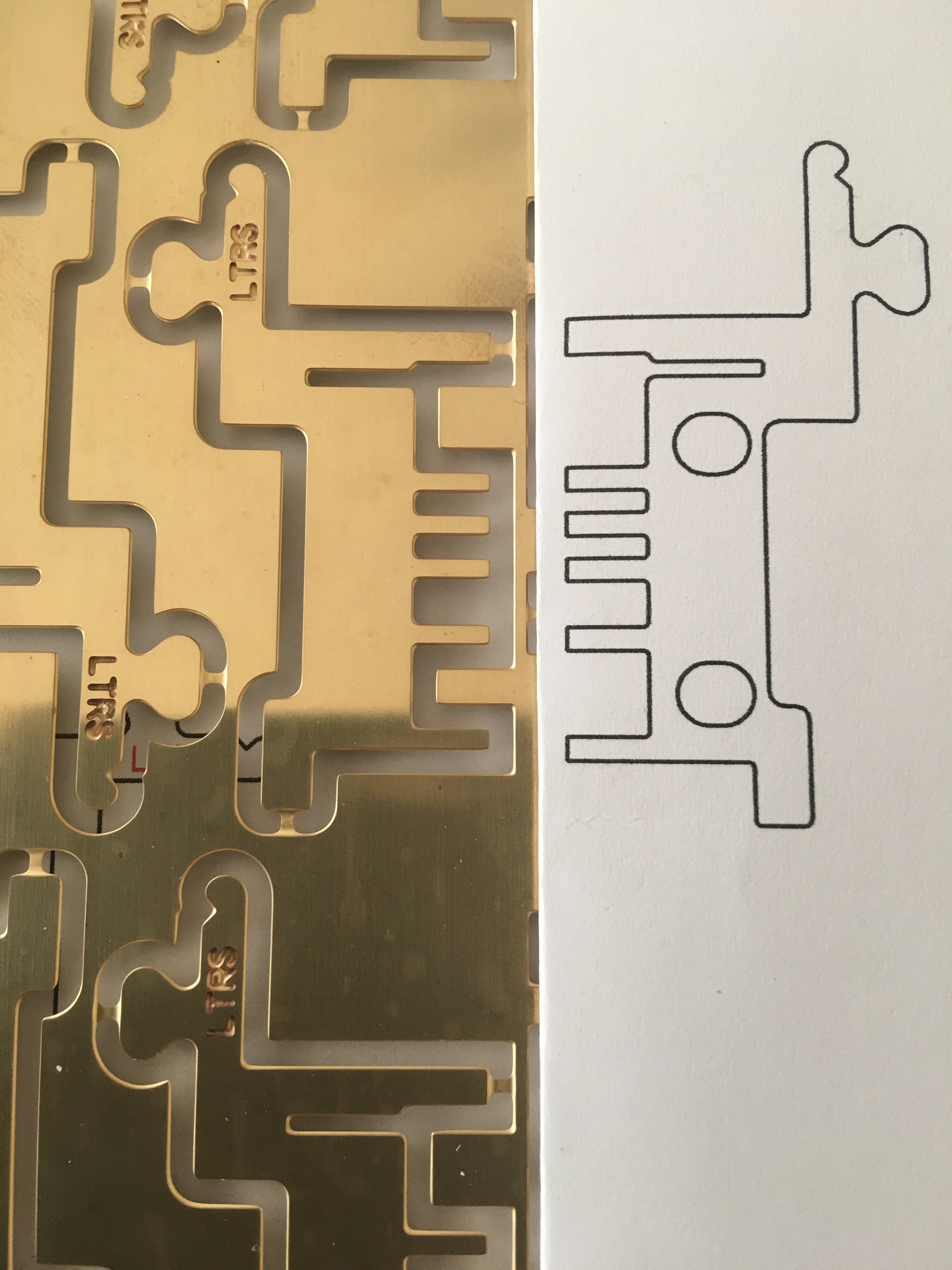

photo etched parts are back
the new vocoder wire

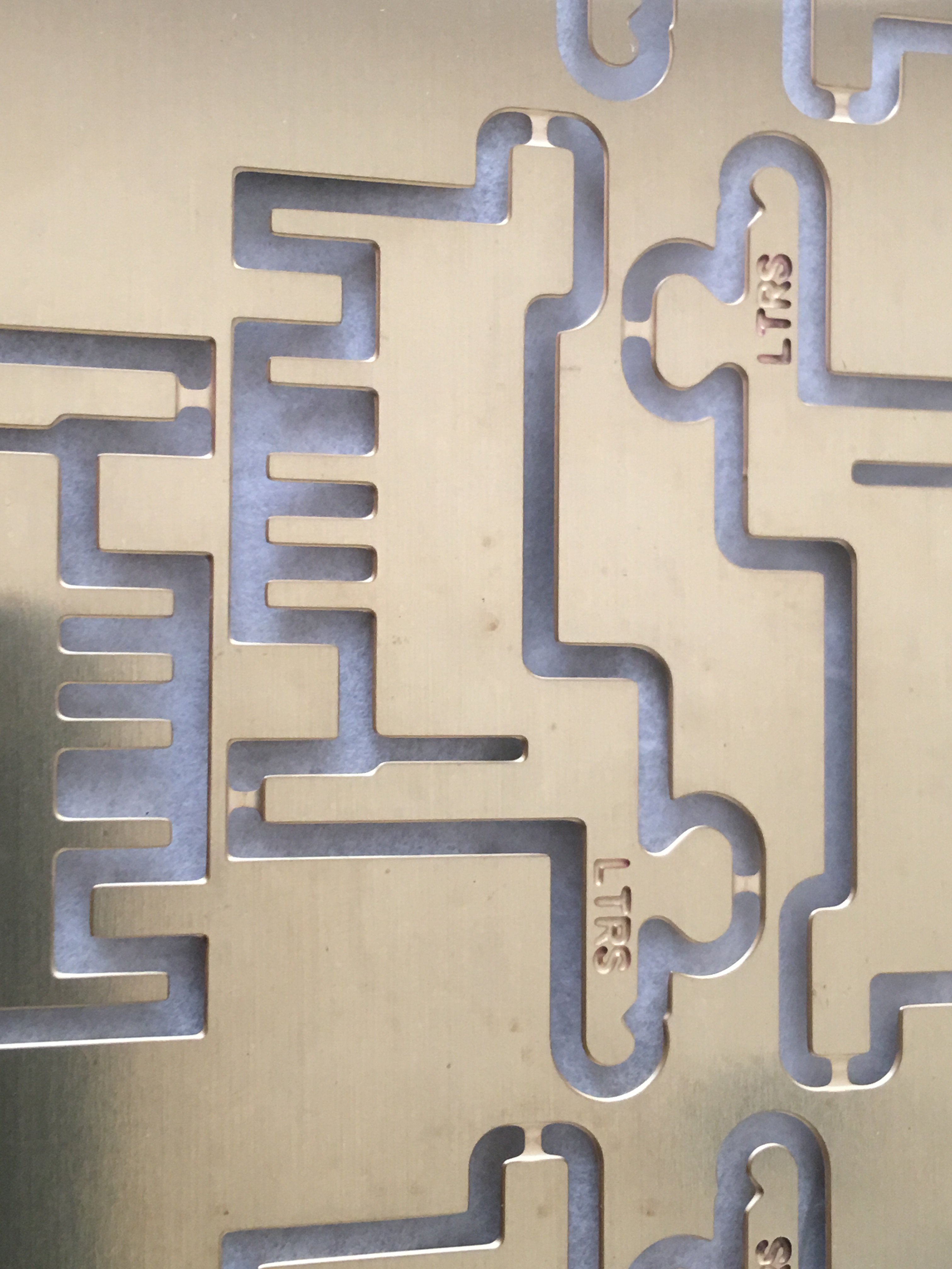

The new brow linkage with LTRS etched ( nice )
Both brow linkages together, need to get some LH side ones cut now
Had them cut in brass a bit cheaper and they are being painted
