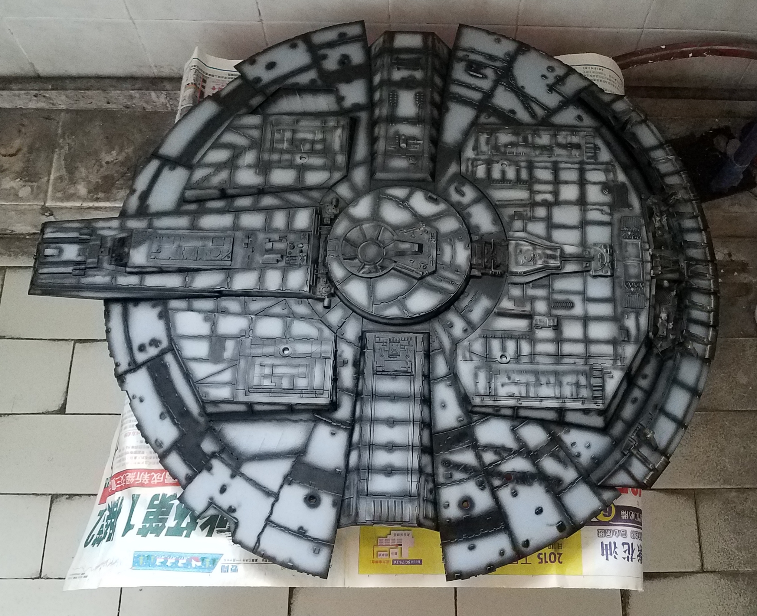

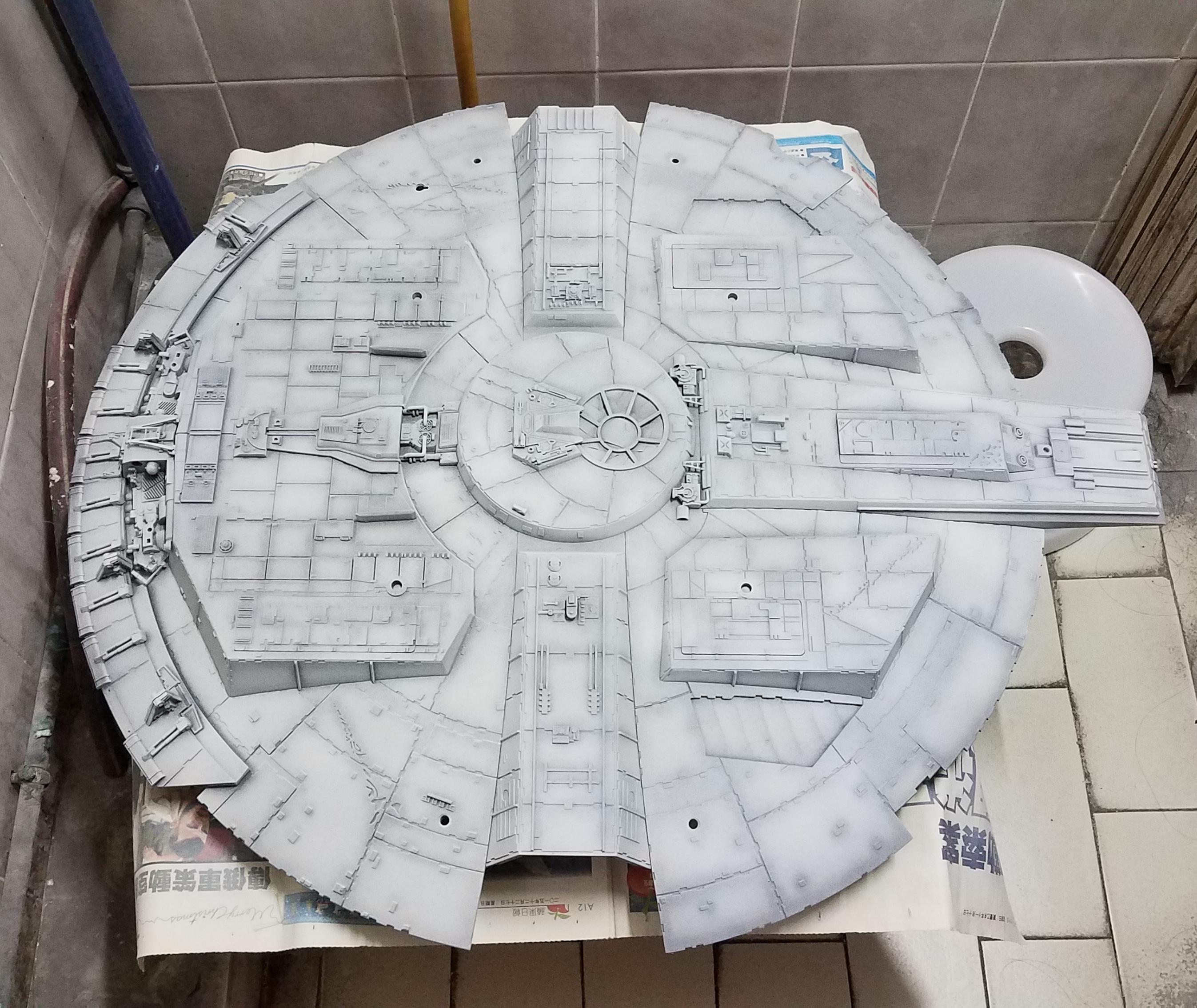

Interesting. Are both the top and bottom photos painted using an underlying black primer with insignia white on top? if so, is the tonal variation a result of different lighting?
I always prime after assembly with a darker color than the base color. Than the base coat (top coat) gets frosted over creating very nice shadows, depth, and variations.
Did this on 1/144 Bandai Falcon, here's an example
Not black but a dark grey, in this case Tamiya XF-66. the topcoat was a custom mixed Tamiya Insignia White.
Another name for this technique is called "black basing" or "pre-shading". There are YouTube videos out there.
I'll often only cover recessed and detail areas rather than a full dark coat. I also put it on thin and can get into tiny recessed areas.
The topcoat of white is applied lightly and built up in layers to get the desired effect. This creates nice shadows and variations across the surface adding to a weathered and faded appearance.
Here's a pic of the dark grey pre-shade.
Done a little more subtle on my Snowspeeder.
