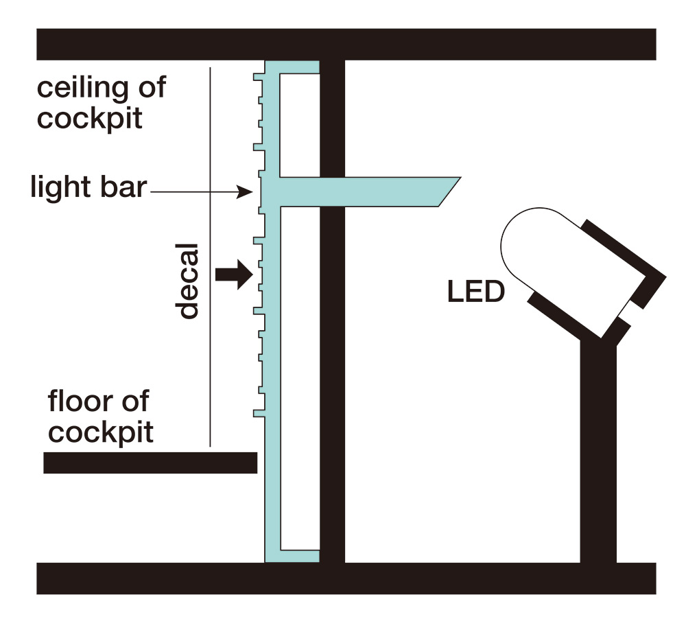

I have to say I'm still confused on how the lighting works in the cockpit.
It's like this.
The decal is transparent where the light bar is.
The way they have done it is optimized for modellers who shall paint, and by doing so, can maximize the wall details with a sense of depth. The lights from the light bars shall emphasize those engraved details.
They have included decals for casual modellers, but those shall ruin the engravings.

I don't have a problem with the cockpit back wall as it stands. I'd simply paint the side of the wall facing out gloss black, lightly sand off the paint on the details without removing the raised detail, and put the decal over top. With enough decal setter, the raised detail should be fine (similar to putting a decal on the raised detail on a plane instrument panel).

This is a really great idea. Im going to do exactly this but also run fibre optics for various colours and sequences.
