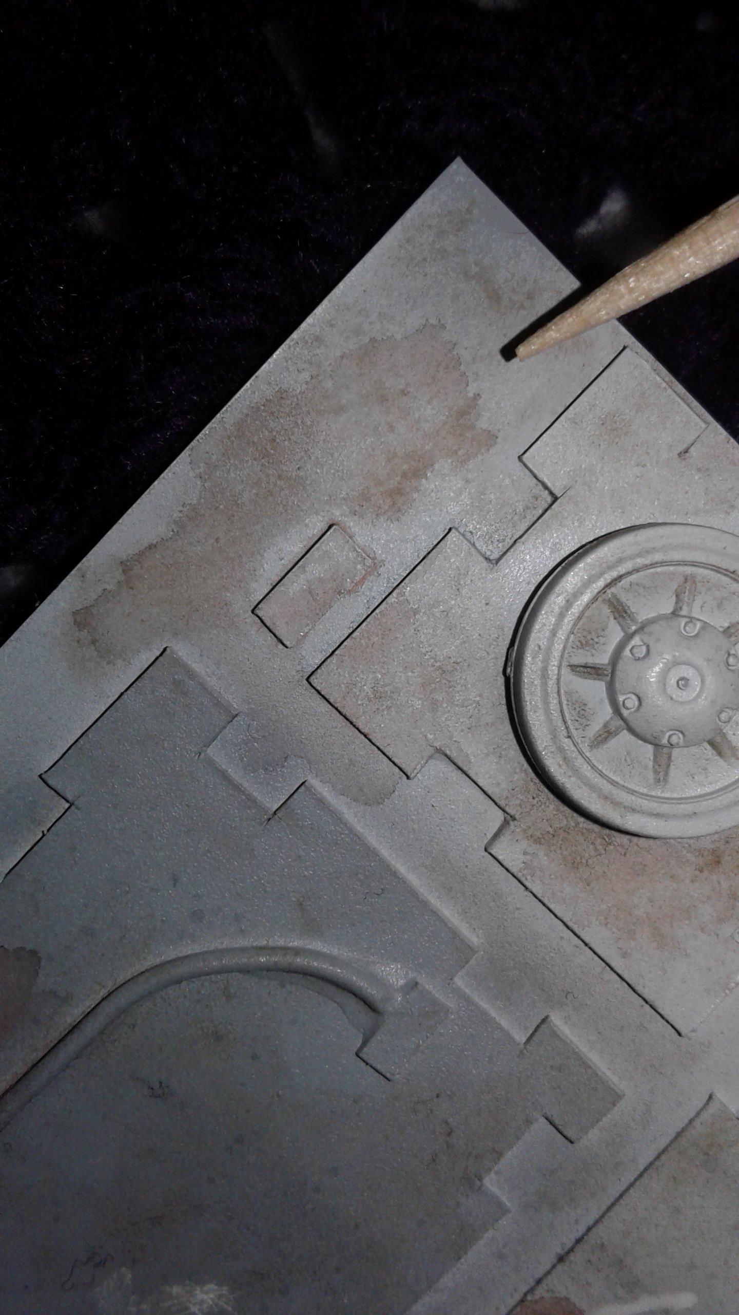

Here's what I came up with for streaks
I think 1, 6, and 7 is basically what I'm aiming for, except I'll use dark gray instead of black.

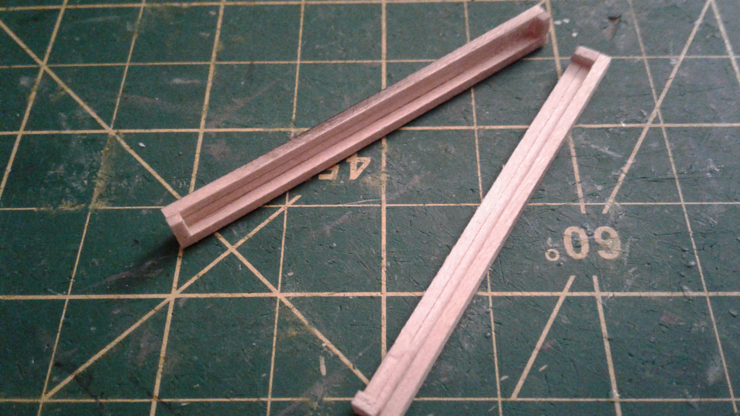

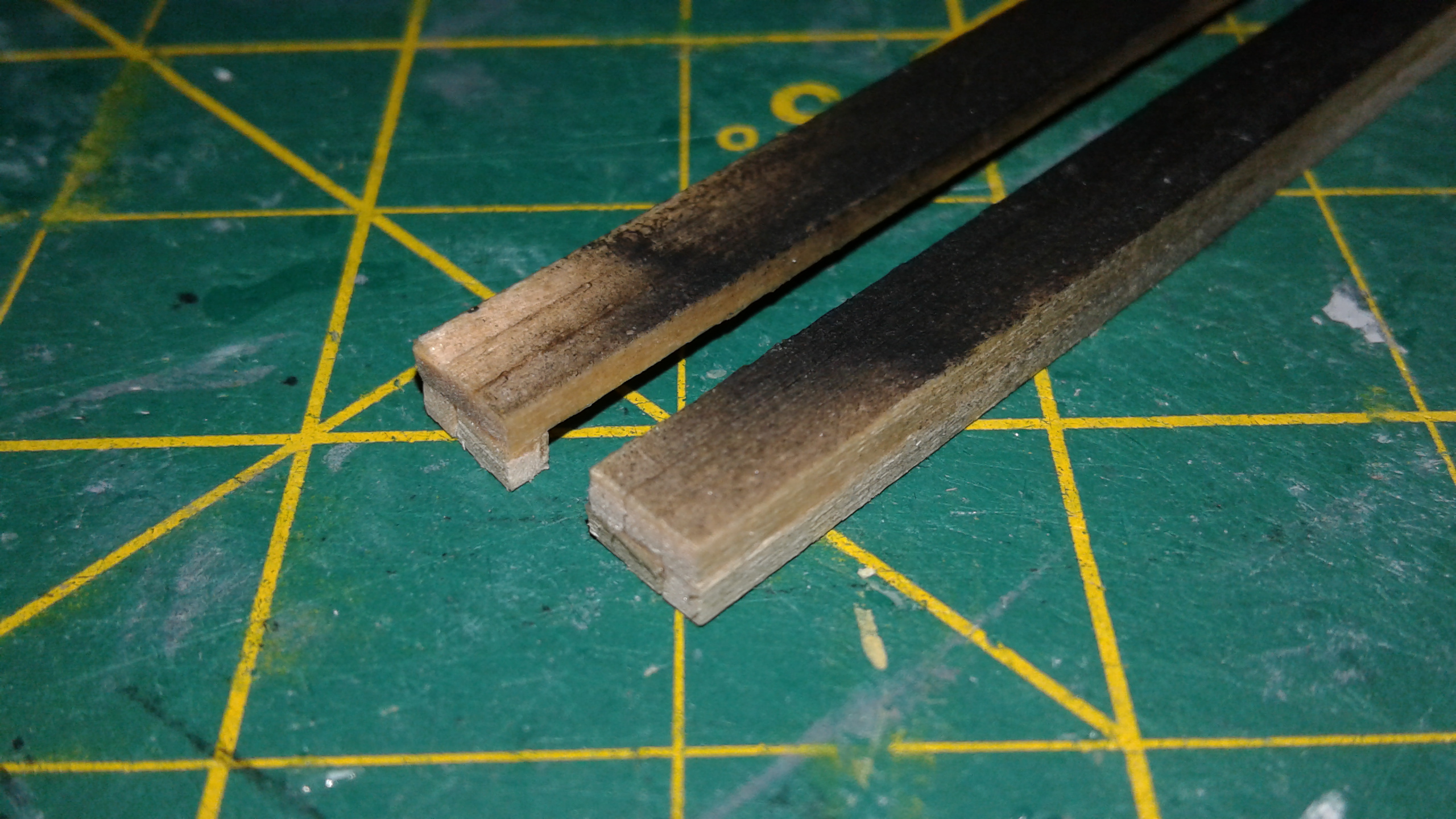

Bingo! Nailed it. So what's this tool you used? :D
Literally as simple as it gets - just L shapes made out of 1/16 inch strips of wood. You put them pretty close together and airbrush over them. Also, put a little piece of tape where the streak starts so that you can airbrush that splash. I'm sure Darth Saber's rolled up tubes of tape method will get the same results, I just wanted to test what I had in my head to see if it would work

This is awesome.
The other trick I plan on doing is to use a laser level to make sure the lines all perfectly line up with the centre.

I've used sausages of Blue tack (poster putty) in the past too for this sort of work.

Lol, nice! Sometimes simplest solutions are the best. Thanks for info and pics. Might have to try it.

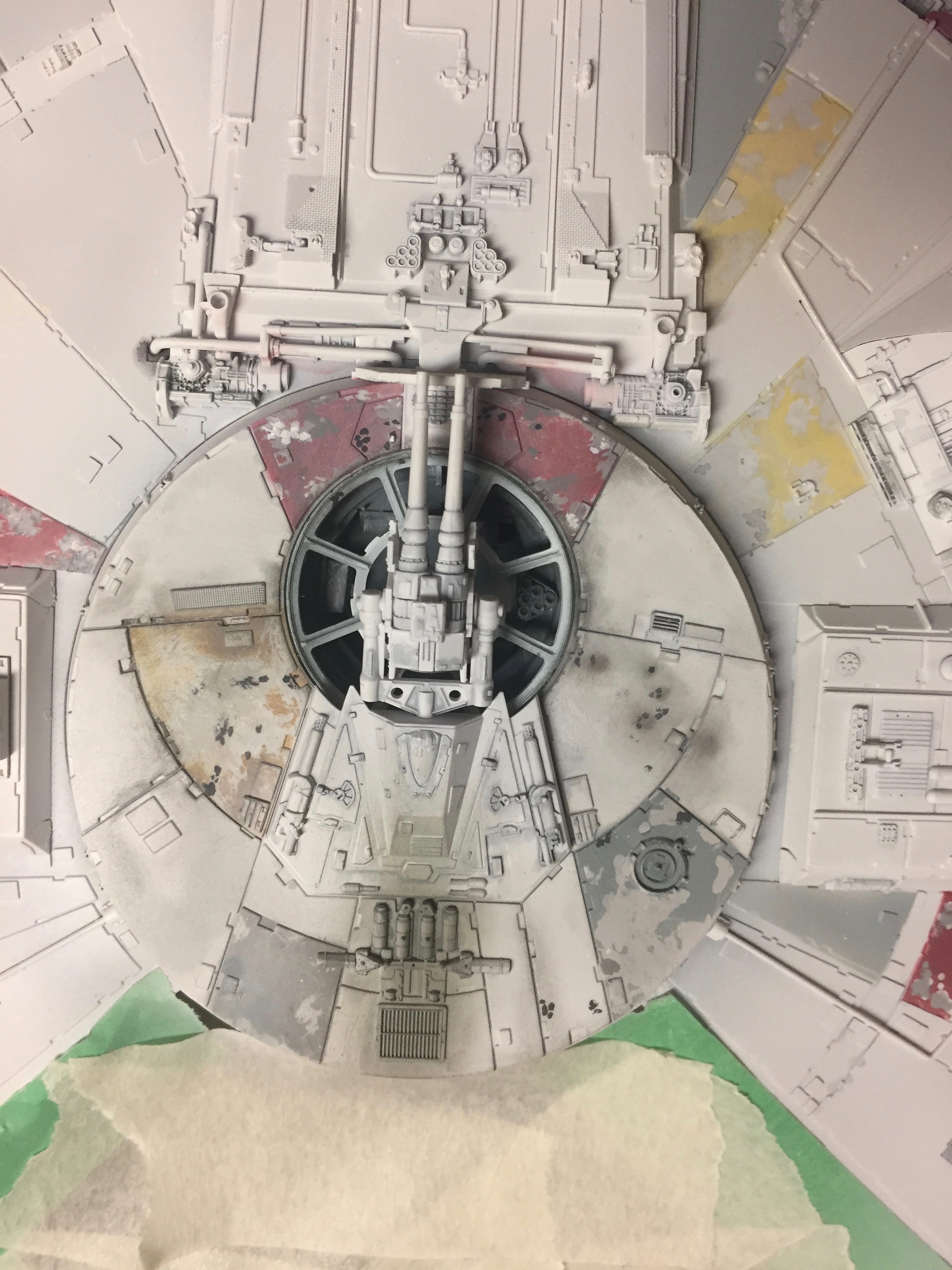

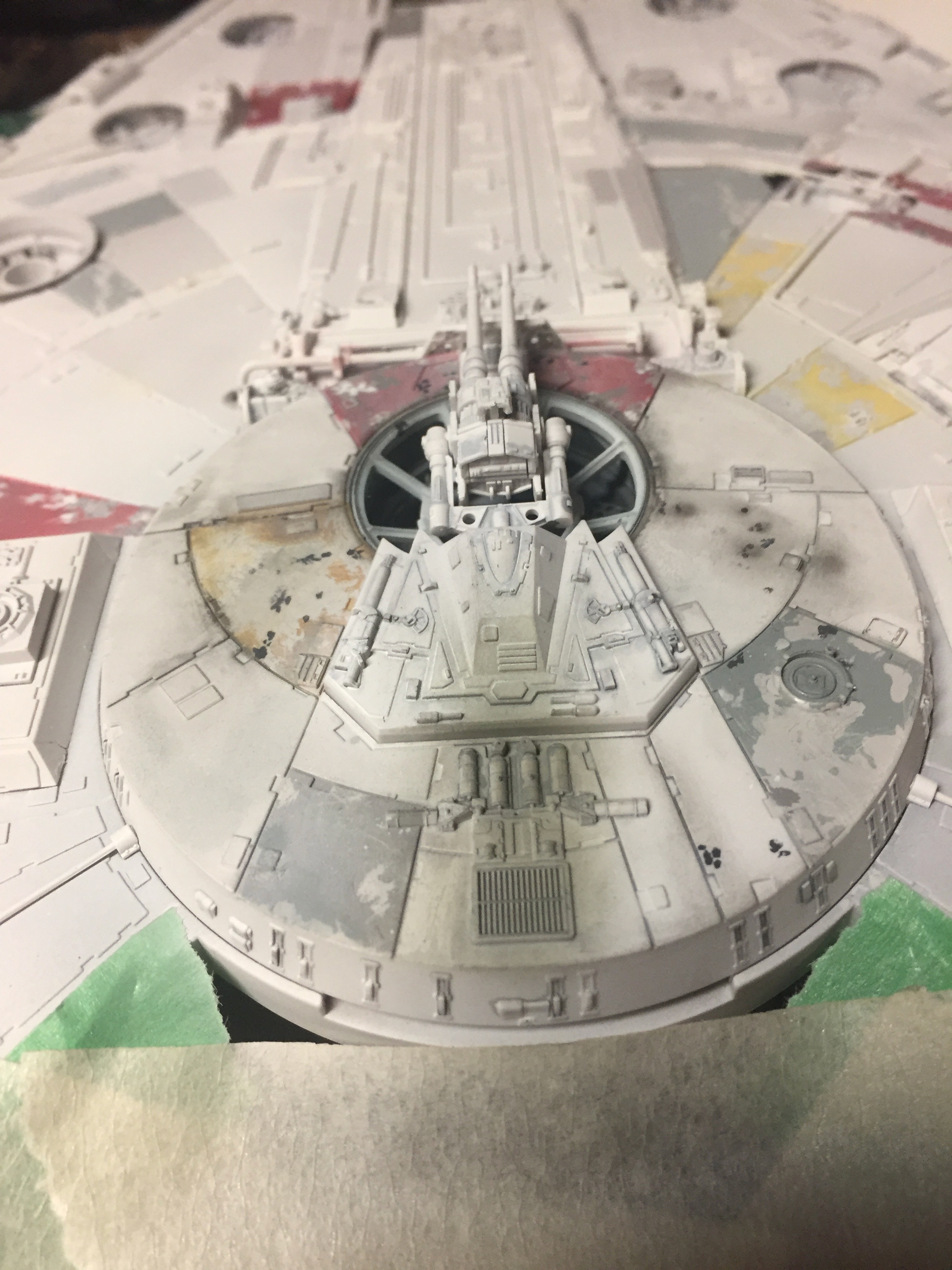

Here are a couple shots to show my progress. Finished the panels and started on the upper gunport disk. The cannon mount piece isn't pushed in all the way in these photos. Still needs some tweaking.

Dang that looks absolutely incredible!
What is your technique for the red and yellow panels around the Quad gun turrets?

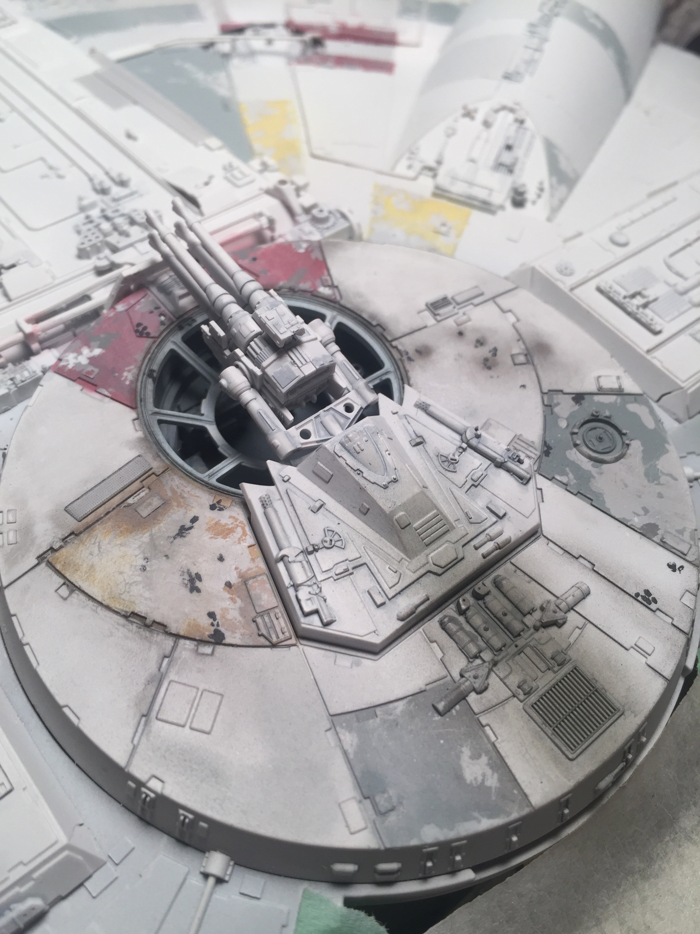

Looks spot on so far! I was messing around with acrylic washes on top of enamels to get that dirty look that's on this area of the falcon

Thanks man. You mean the chipping? I used a combination of liquid mask, scratching with an Xacto, and painting on the chips using gray and white. I added the slight tone variations on the white surfaces by dabbing on Grey Tamiya panel line ink, letting it seep into the paint like watercolors, then blending it down using a Q-tip. The darker shades around the window and edges are pastels. It's too easy to go dark with the weathering and I had to sand back some of it using a very fine paper.
Looks good! My base is acrylics, so I'll have to play around and find a similar technique.
Well done Joe. Love this method and looks like the best way (for me) to do the streaks. I've been considering different approaches but this seems the best to control both the colours and the width and length of the streaks.

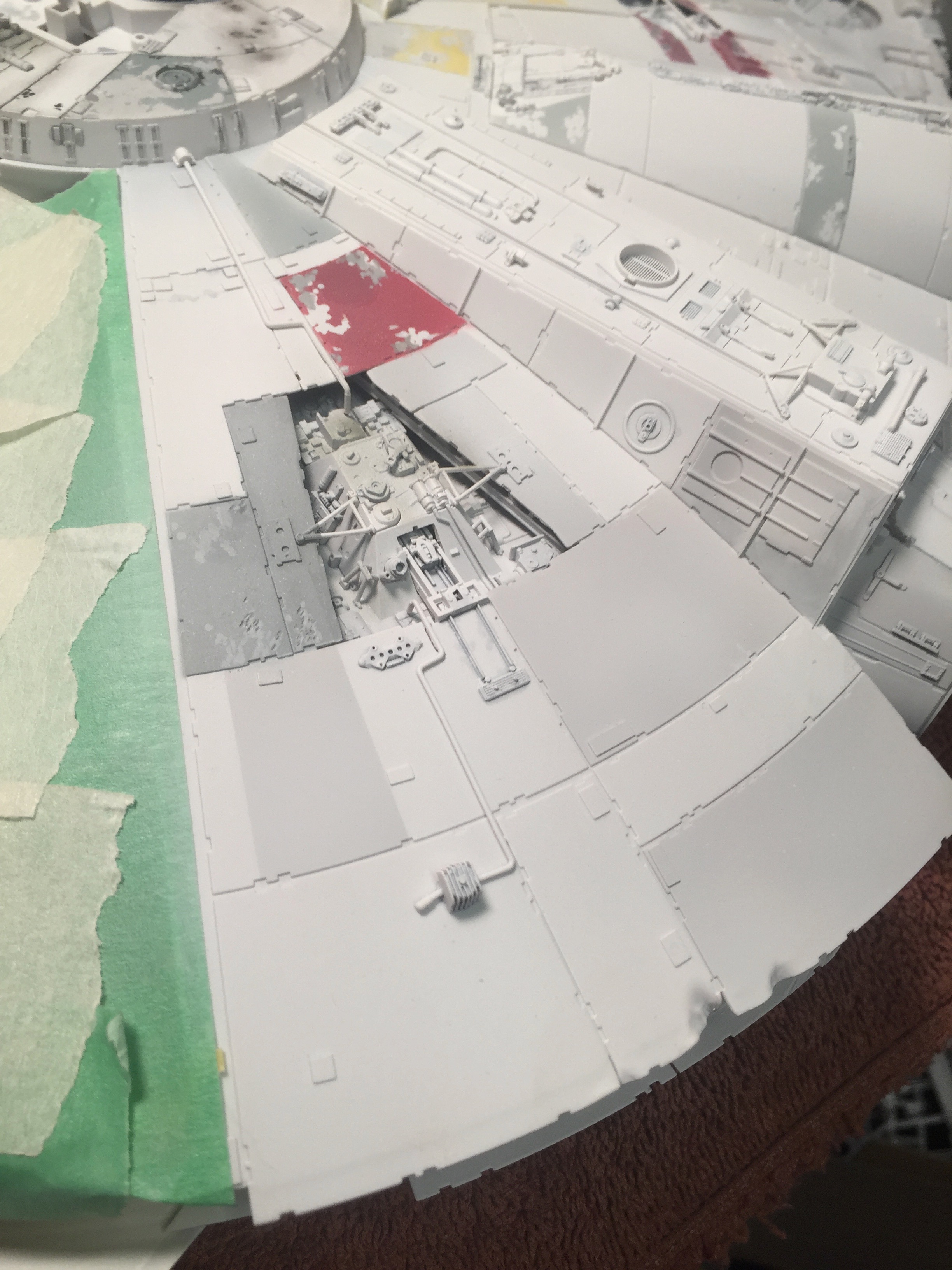

Interesting coincidence that I have been painting that same part as well.
At last I am almost done with the panels and primary dusting.
As with the underside, I have used zero airbrush.
Only rattle cans.
