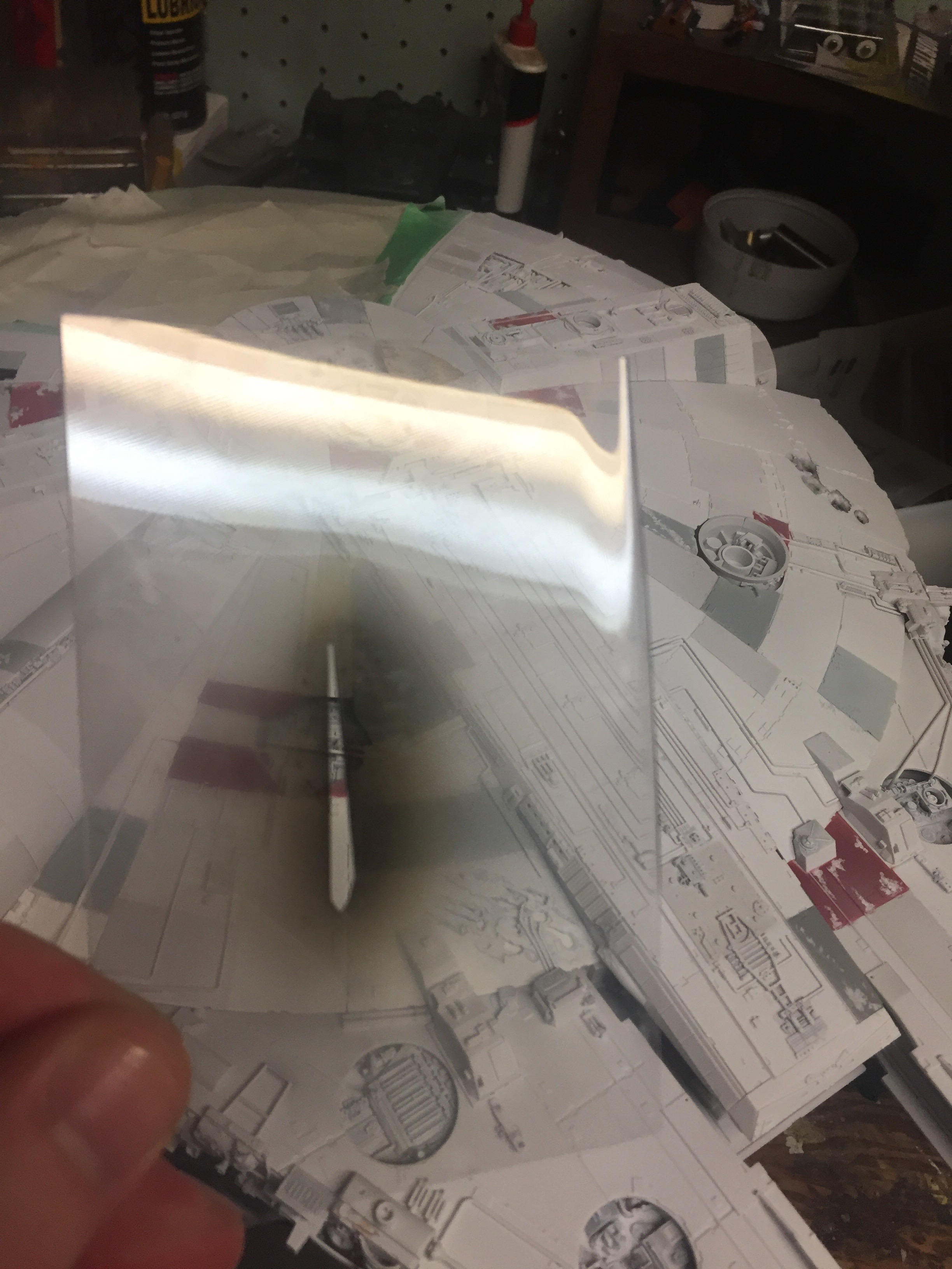

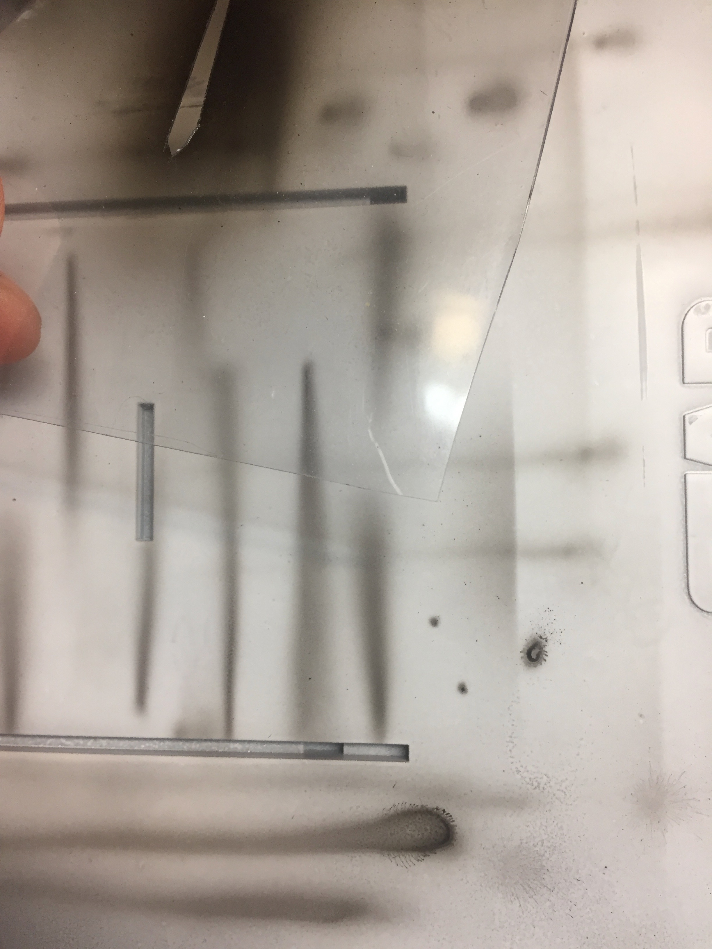

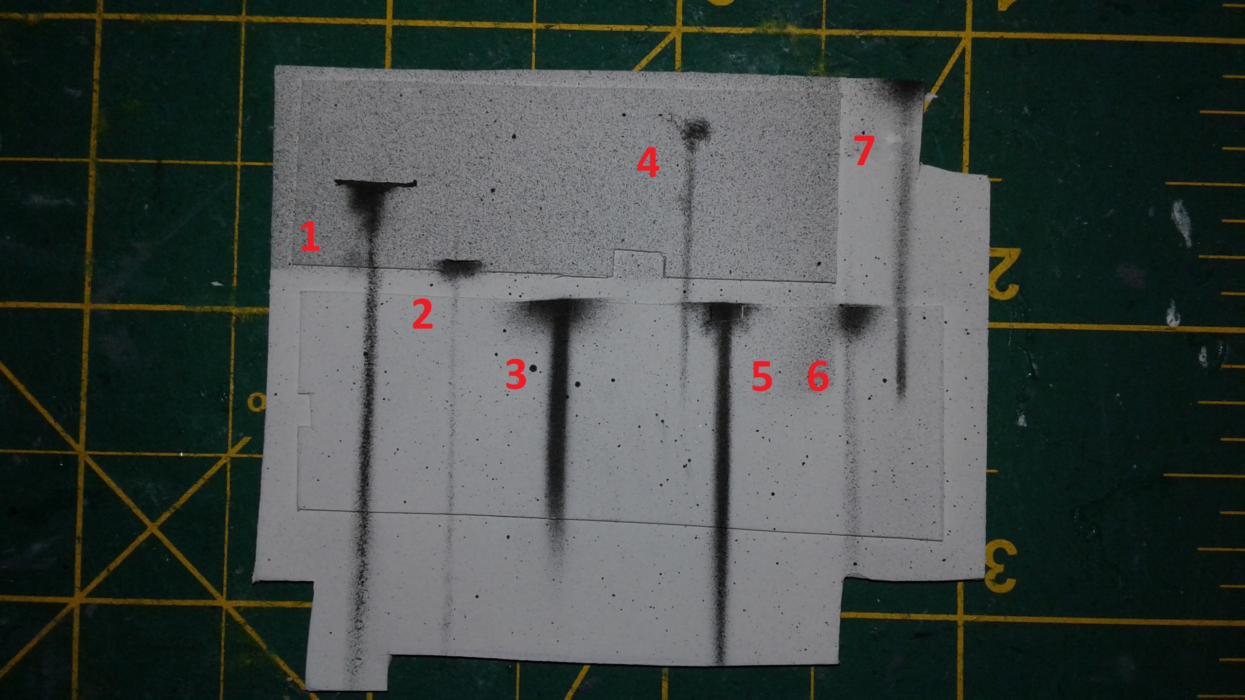

Hey guys, this may be a good time to bring up this technique I've been experimenting with in order to get fine airbrushed streaks. On my previous Falcon, I mostly did the streaks using oils, brushes, and even illustration pencils. They look okay, but don't quite match the 5-footer. I really want that soft airbushed look, but can't get my airbrush to spray a really narrow line. So I made a mask using clear sheet plastic and played around spraying streaks holding the matte a few millimeters off the model surface. Using the clear sheet allows me to position the streak exactly where I want it. The results look pretty good so far, but I definitely need to keep experimenting and practicing. What do you think?

I made a little tool to help with the streak marks. If I get some time tomorrow, I'll test them out and share the results. Basically the same idea though, a slit that is elevated.
Bandai 1/72 Millennium Falcon
View attachment 788986View attachment 788987
Looks good!!
I dont think I could keep my hand still enough holding the stencil while using the airbrush in the other hand.
I made a few tests using the rolled tape technique I told you about.
Standard soft edge...sharper edge just press down on the rolls.
Wider streak, or a taper on one end, just adjust the placement of the tape.
