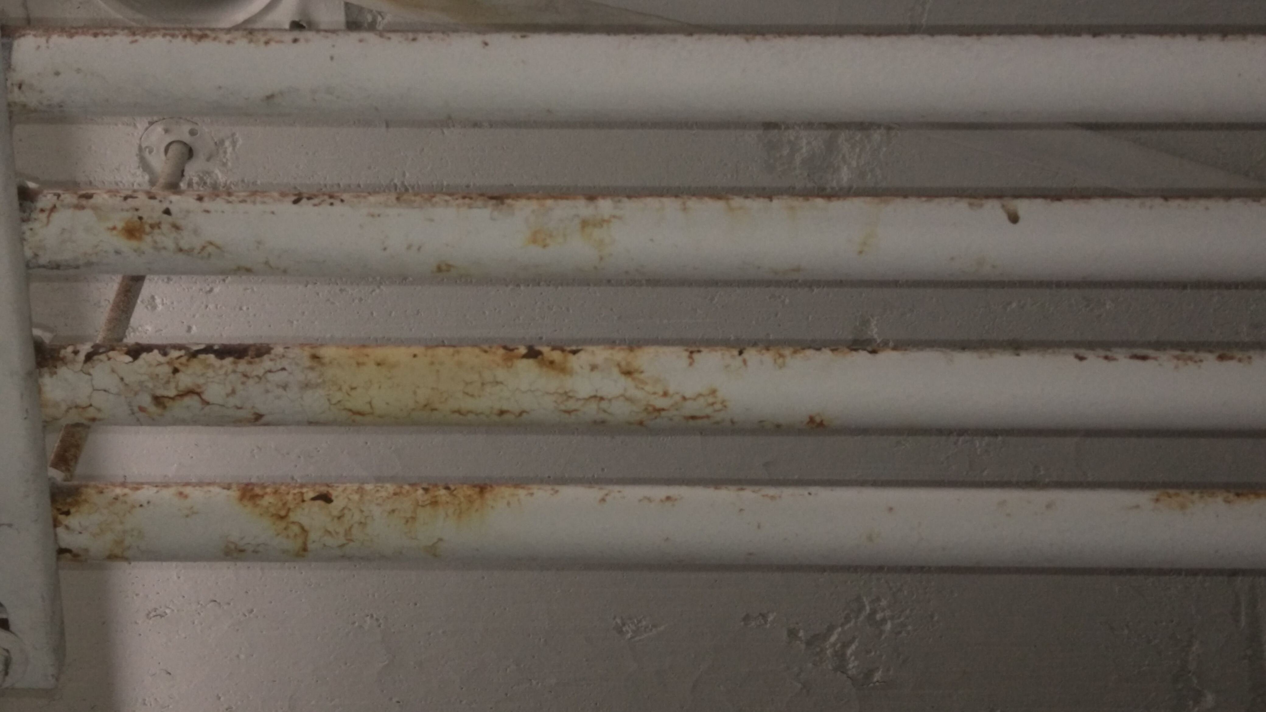

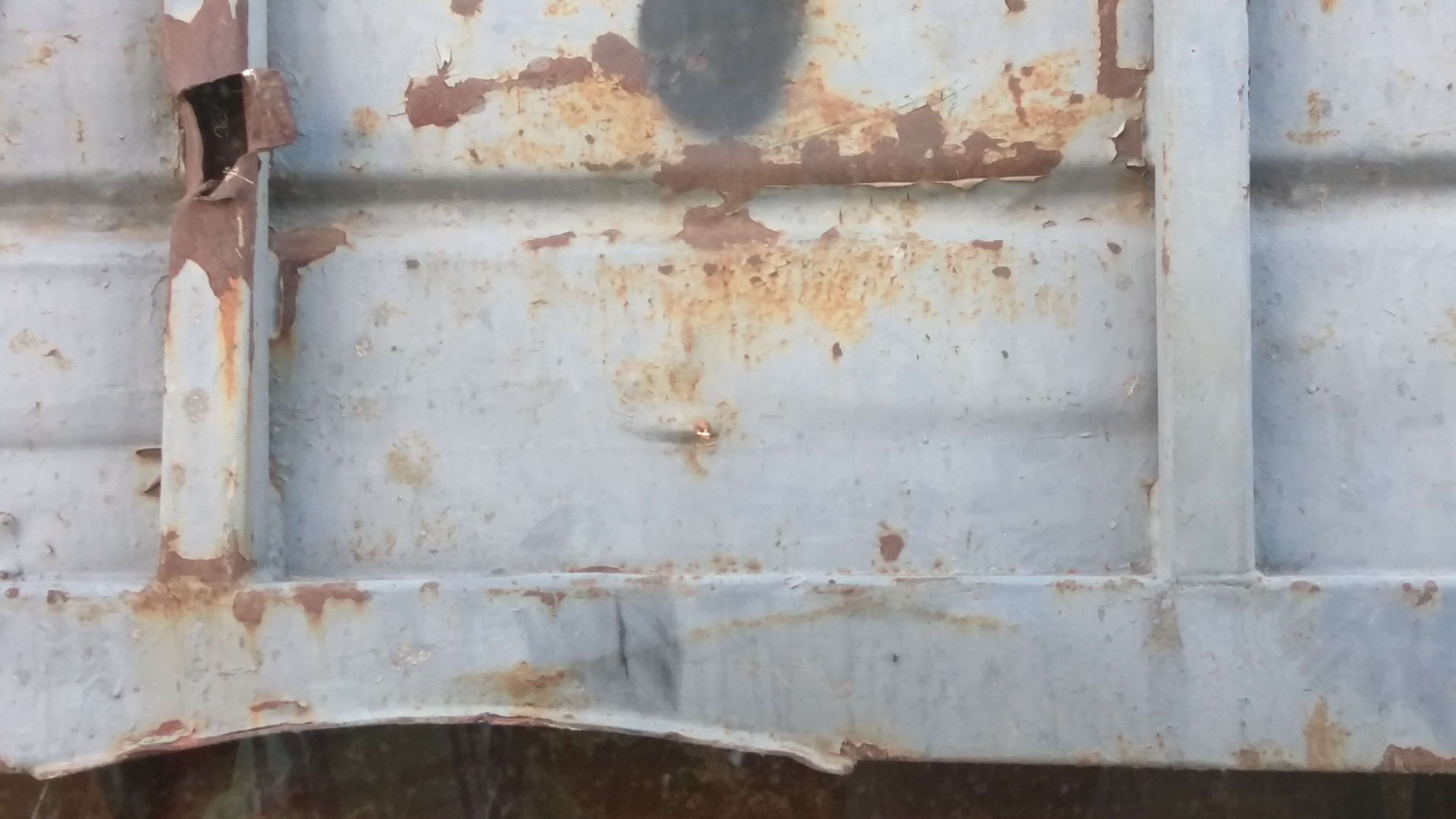

The part stiles me as most fascinating at the moment is the weathering, corrosion, rust (did they really use iron in the alloy?). Weathering wears a surface down from the outside. Corrosion/rust will cause damage emerging from the surface including the separation of any surface preparation. Anyone ever play around with that idea? If so, what techniques did you use.
And, if anyone has any favorite references for weathering / painting: distressing / building these types of model, I'm all ears.
