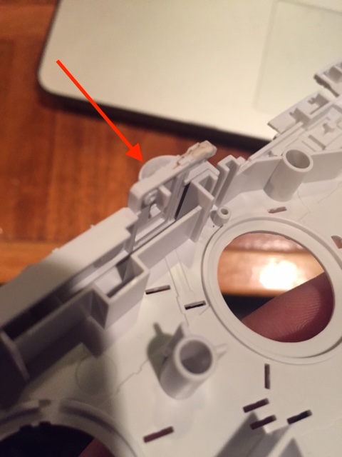

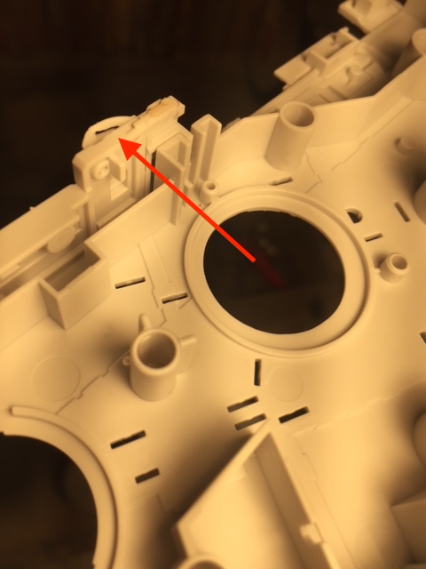

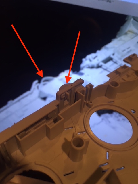

BTW, I think I found the first Bandai "error" worthy of a small modification. On the front starboard sidewall, the greebly from a DML/Dragon/Revell 1/9 Kettengrad kit (part #8 indicated on the donor I.D. chart) needs to be thinned and the top rectangular shape needs to be drilled out. The series of vent holes below should also need to be drilled out, but I think I'll just fill those holes with some panel wash and call it a day. However, that rectangular hole is visible when looking over the top of the starboard mandible.

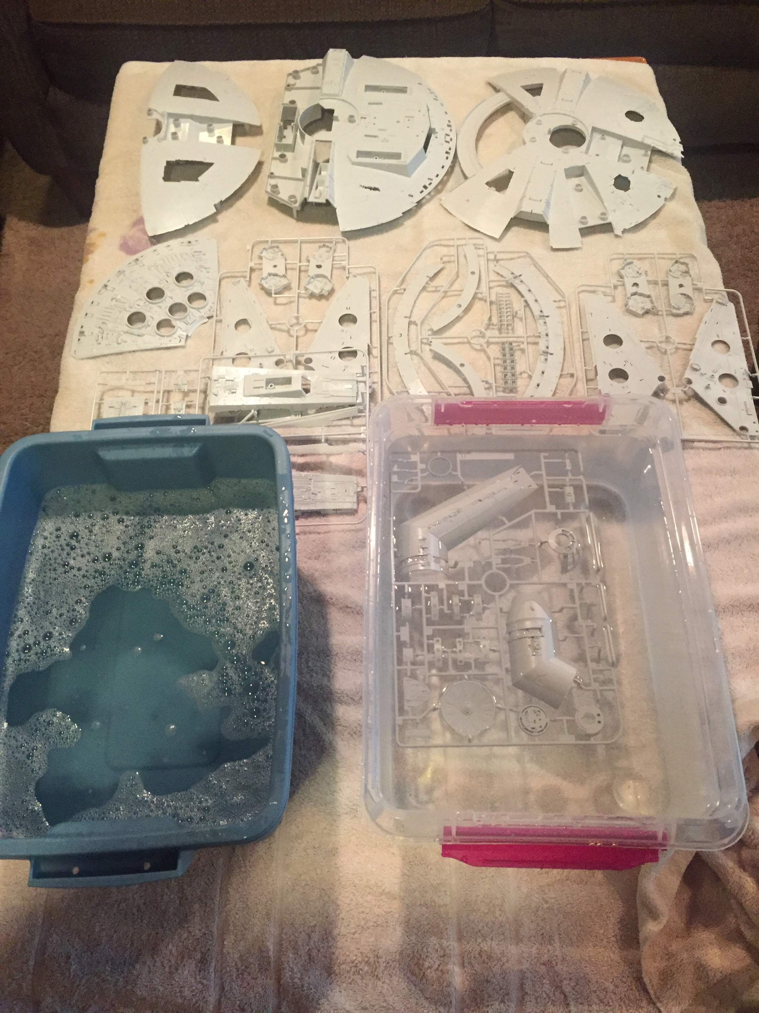

BTW, I took Jaitea's advice and ditched the black primer coat. I did a test using vallejo black primer on the landing gear sprue followed by Polly Scale Reefer White over the top. As I feared, the white looks too blue, even after multiple coats. By itself, however, the Polly Scale is a perfect match for the Bandai plastic. Assuming Bandai's research on the color is as good as the rest of their research, the Polly Scale is a close (enough) match for Floquil.
Since I'm not using a primer coat, I started by washing all the sprues in mild detergent and letting them dry overnight. I'm using black and brown Tamiya panel line accent on the bare plastic to pick out the fine detail and then airbrushing the reefer white on top. That tones down the panel accent and leaves a nice white basecoat with the detail popping out.

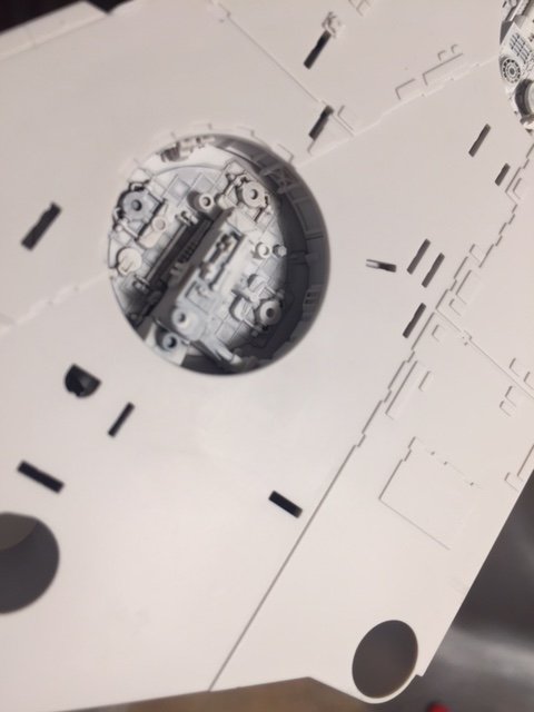

Here is a quick color comparison between Bandai's color vs. Tamiya AS-20 Insignia White on top of black automotive primer.
Shot only using the light through the window. Pretty close, AS-20 is a little more green.
Grill is not painted at all. Rest is AS-20.

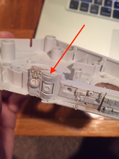

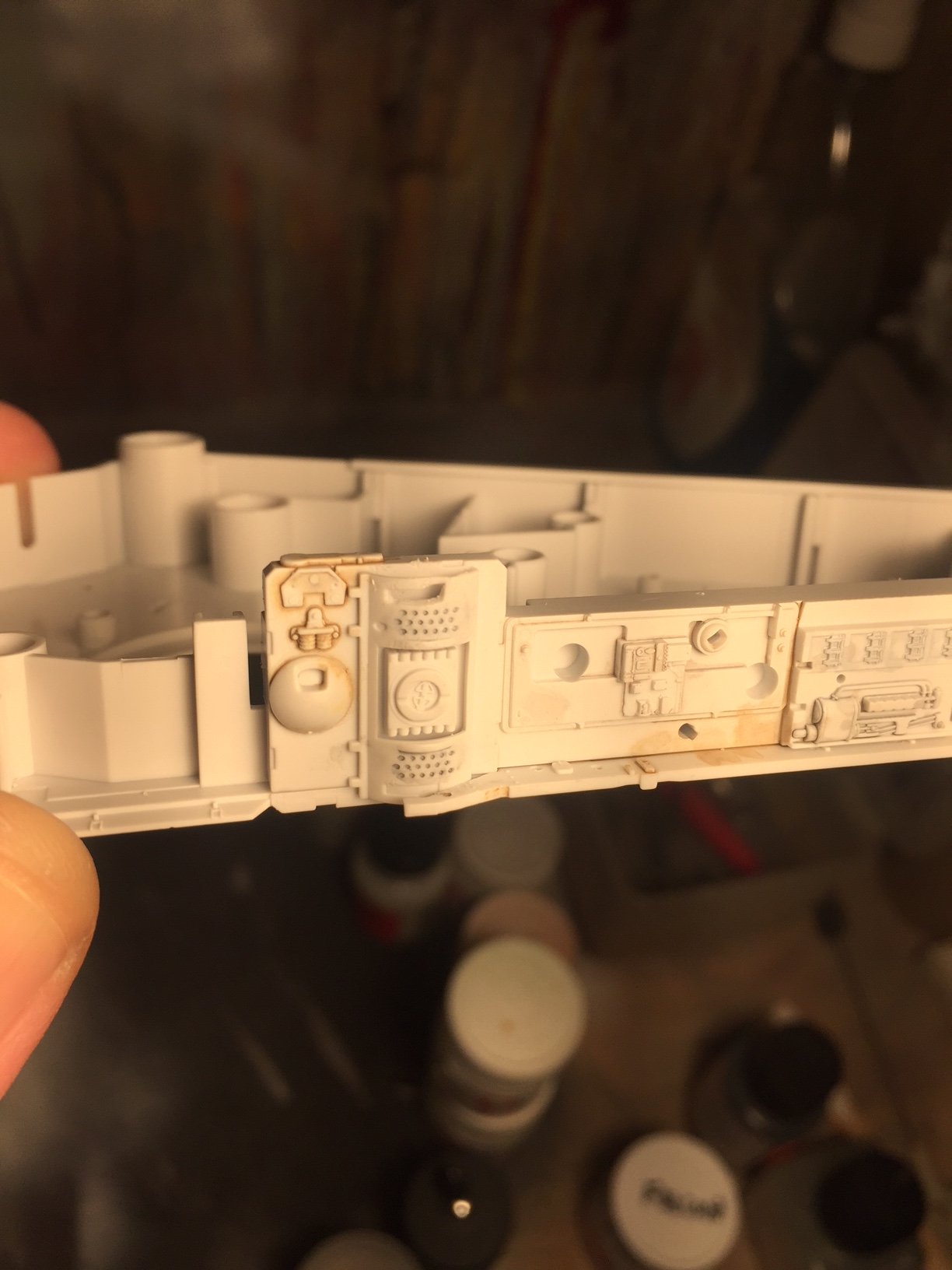

View attachment 774662View attachment 774660
You might be well aware of this, but just in case.
Applying Tamiya's accent colors directly on bare plastic could be harmful.
http://www.tamiya.com/english/products/87131_133panel_accent/index.htm
Especially snap-fit kits (the plastic near the pins and sockets become pressured after assembly), especially thin parts. They have been known to cause cracks.
It is better to prime/base-coat with lacquer, whether black, grey or white, if you are going to paint/wash with enamel. And Tamiya's accent colors are enamel.
For panel line washing, it is said that Mr. Weathering Colors are safer, because they are oil-based and not enamel.
http://www.mr-hobby.com/en/itemList.php?cId=29

Thanks for that.
I wonder how close the AS-20 would look if it wasn't over black primer
When I did my 1/72 X-wing and Y-Wing I used it straight on the plastic and it was really hard to tell where I had missed areas when spraying it since the colors were so close
Although I really think the black primer underneath helps the details pop and create some natural shadows

Thanks for the heads up! Hadn't considered it, but I'm not flooding the parts, so I think I'm okay so far. I'm only working on the mandibles at the moment just picking out some details here and there before top coating. To be on the safe side, I'll check out a few other options before continuing. :cheers
