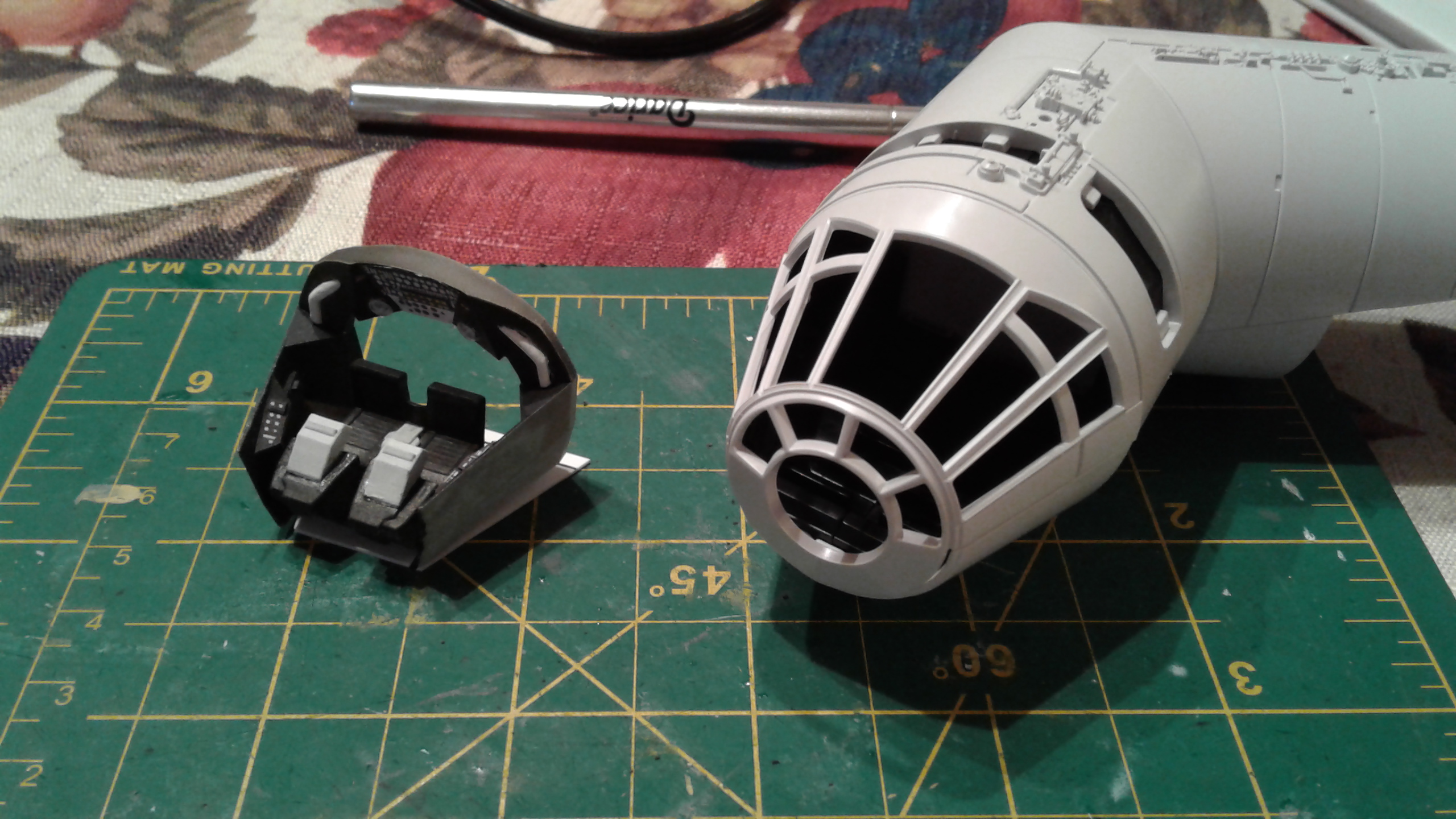

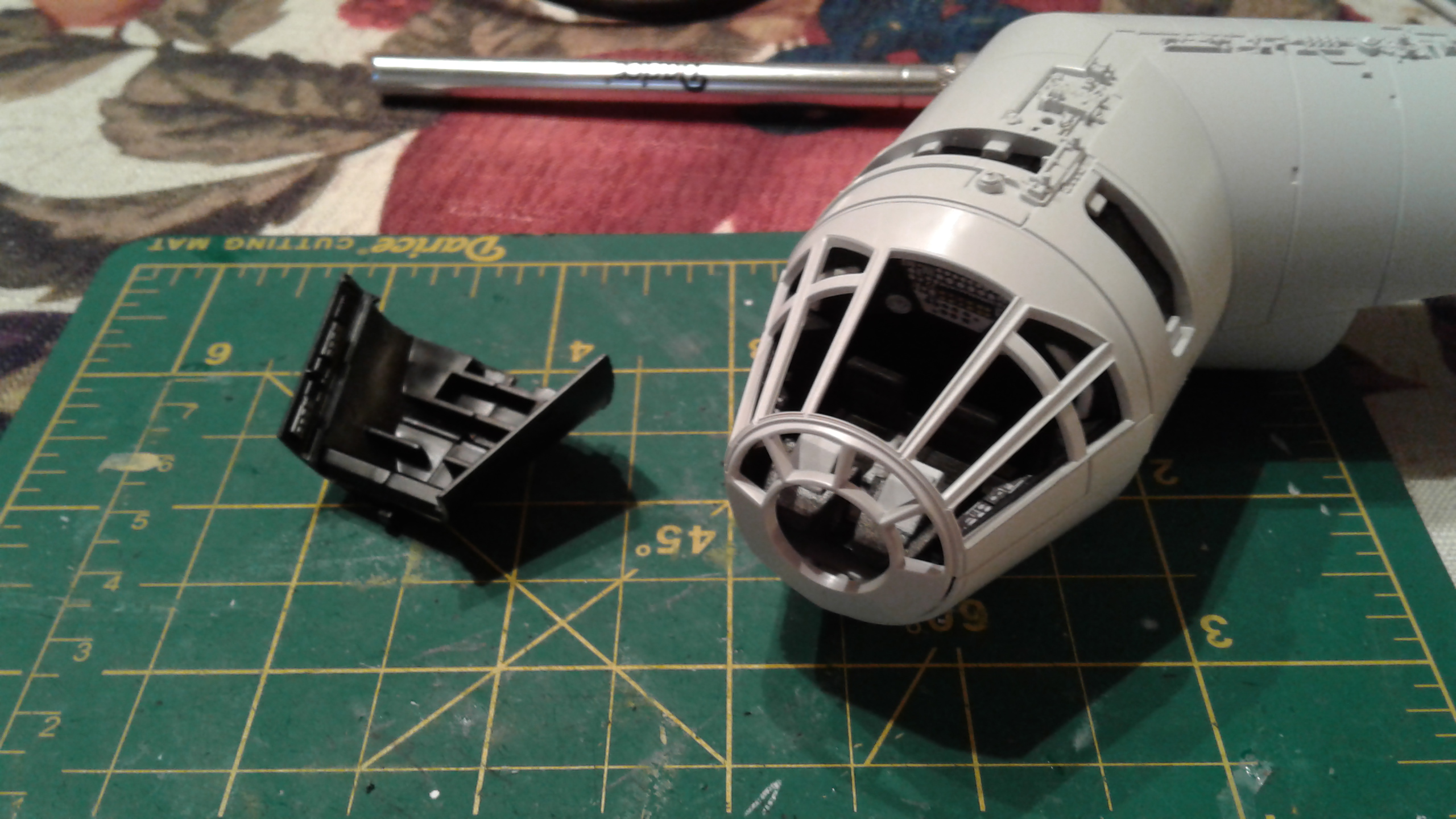

Just so I'm clear, the cockpits can be swapped out by just pulling off the canopy? Or do you need to pull the two halves apart?
Sent from my SM-G955U using Tapatalk
Just by pulling off the canopy. The back half of the set interior will remain inside the cockpit tunnel regardless of which cockpit interior sits beneath the canopy cover.
I basically just pressed the saw against the front edges of the side walls and carefully sawed straight down (hopefully that makes sense, you can kind of imagine it from the image -- I could also post another image showing exactly what I did). It really does not change the aesthetic of the set interior.
