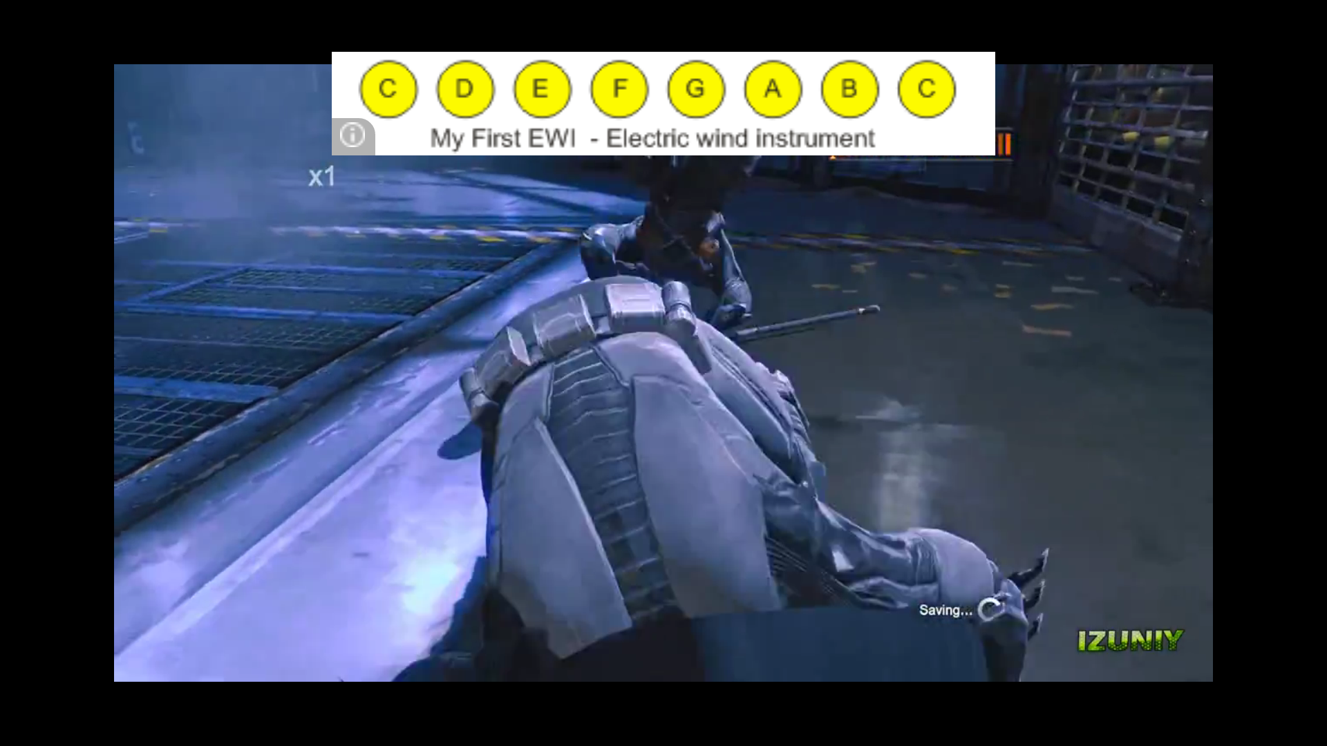

i think i can help with a reference photo on his back. it looks like an armadillo's back with a more stretchy feel. if i could just post up the pic......im having trouble with that since im new here.

Screenshot_2014-02-19-19-30-03.pngach]
Screenshot_2014-02-19-19-30-03.pngtaken from a vid on youtube. i slowed down the vid and watched carefully as he was in the slade fight......thats the only time that i saw his back

View attachment 288588taken from a vid on youtube. i slowed down the vid and watched carefully as he was in the slade fight......thats the only time that i saw his back
Thanks. Yes you are correct. I am considering this part of the under suit design and hope to integrate it into the final design. Even though nobody will ever see it under the cape. ;)

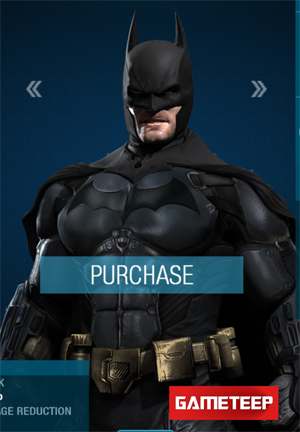

Depending on the images you see, the belt sometimes appears to be a bronze colour. In game play it's mostly grey/black I think. Anyway, tried out both options. I like the bronze personally as it will break up all the greys and black in the suit.

Nice work with the belt, however I was at the belief the belt was a light grey colour?
I think you're probably right in game play. I've just seen different images online (that may or may not be doctored) that show different schemes. Nice thing about the material these are cast in is it accepts paint really well. ;)
