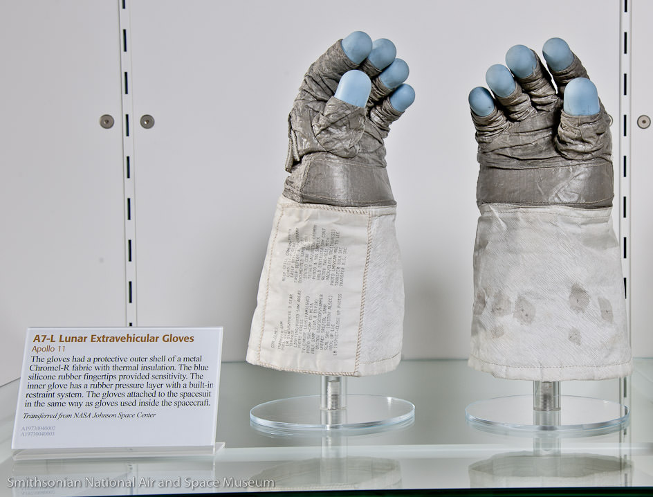

I know some of you have used fingertips that were actually made from silicone, but I'm wondering if anyone has spray painted their 3D printed tips and if so what spray paint and color did you use?
I got lazy hunting for the correct colour and went with something that had too much green in it. I need to repaint when I find the time/correct colour.

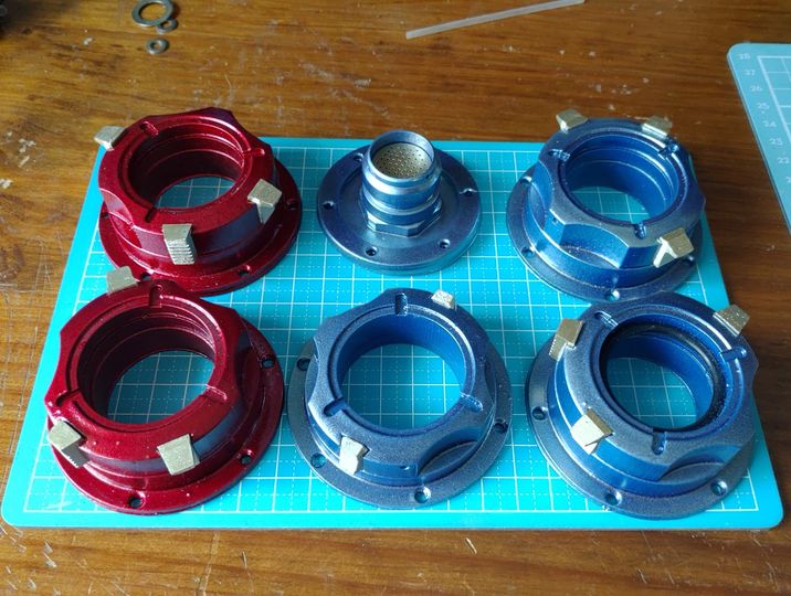

I have started making my own suit. Im kinda upgrading a regular costume shop EVA suit as well as making my own at the same time. and have printed many of the parts you have modelled here, but also made some modifications, particularly for resin printing. One thing however, have you modelled the front metal brace for the LEVA helmet you have in this photo, as it was not included in the files.

I have printed the connectors as a bit of a test for the costume store suit upgrade, these are just printed on a photon DLP resin printer so no need to sand, just good primer, They are more textured than I would like so was going to remodel them in Fusion 360 or maybe just smoothen them out in meshmixer.
I was wondering, it wouldnt take much to make the top part rotate slightly, is this something that the originals did?
The other issue I had was finding the correct size o-ring, the ones I found are too thick to fit into that grove properly
Also has anyone modelled the plugs that plug into them from the hoses?

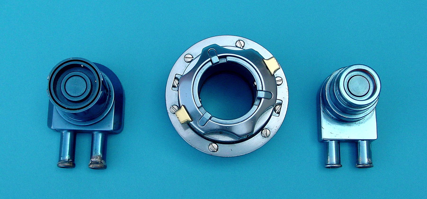

The ID of the O2 fittings look a little on the large side. Here is a photo of my coolant loop fitting (real one) the ID is around 1.300" if memory serves.
As for O-rings, 2 options: McMaster-Carr sells o-rings in a wide range of sizes, and in (orange/red) silicone like the originals. Option 2, make your own, by buying o-ring material and gluing the ends together, Cyno should work fine for this application.
