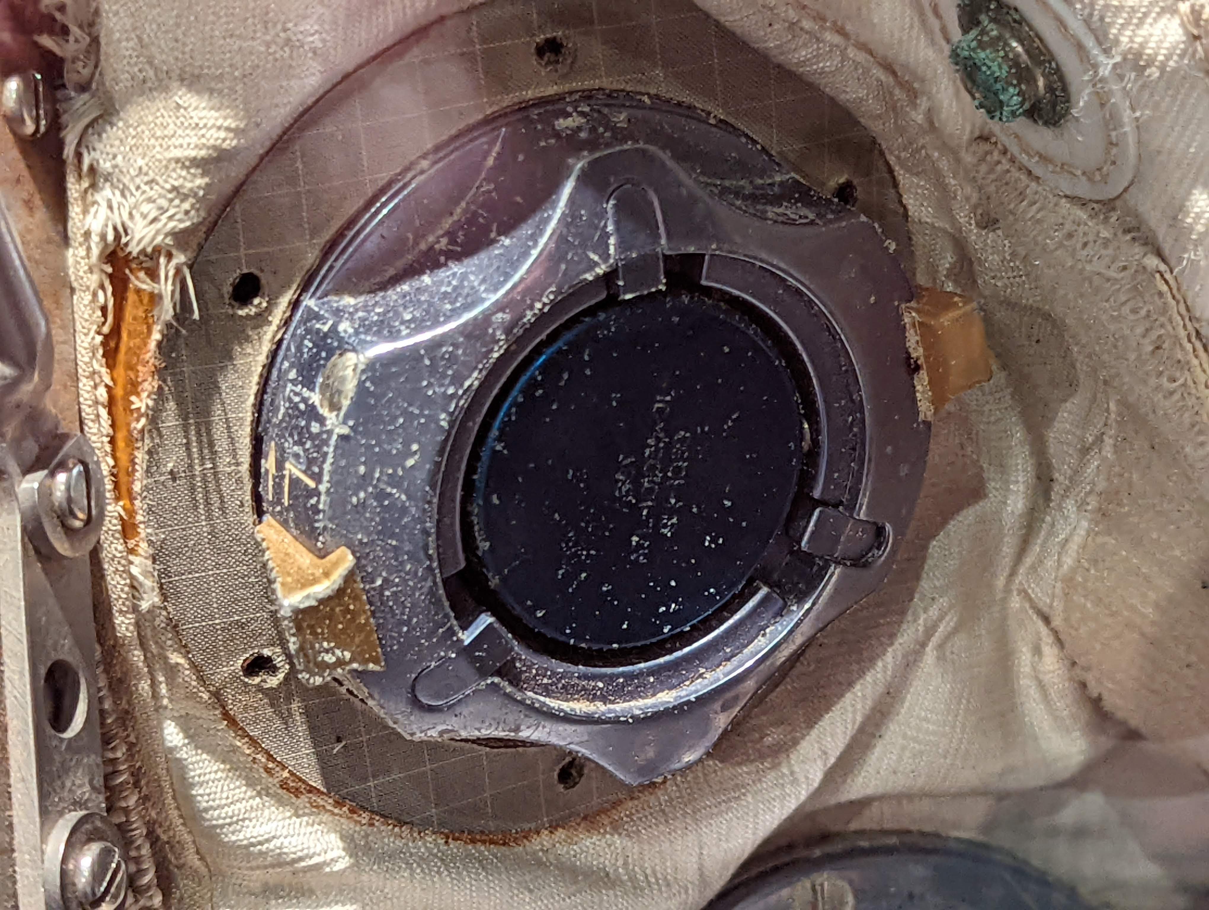

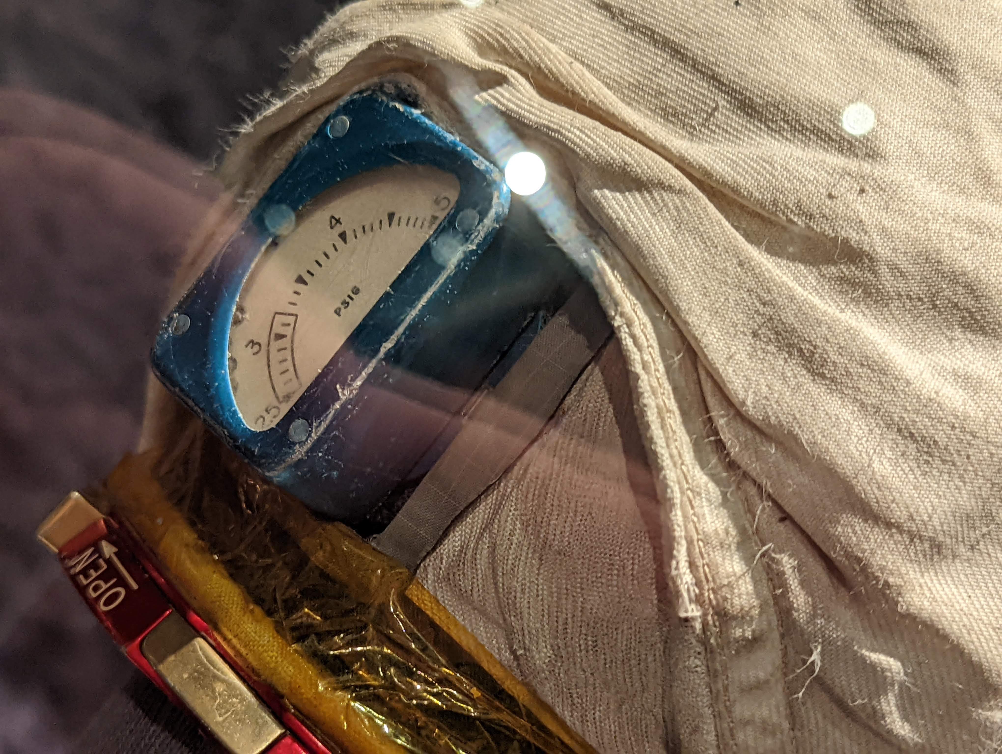

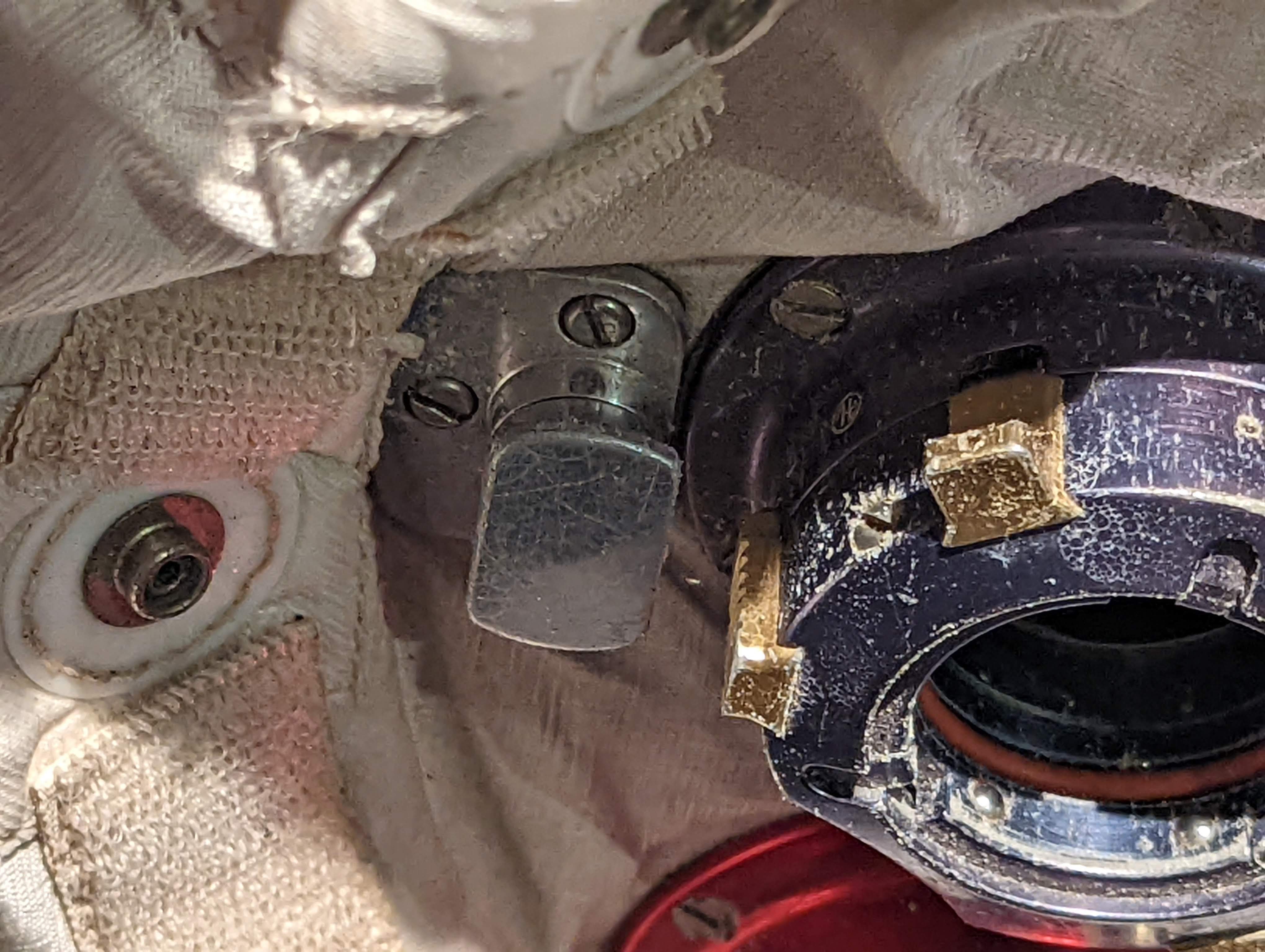

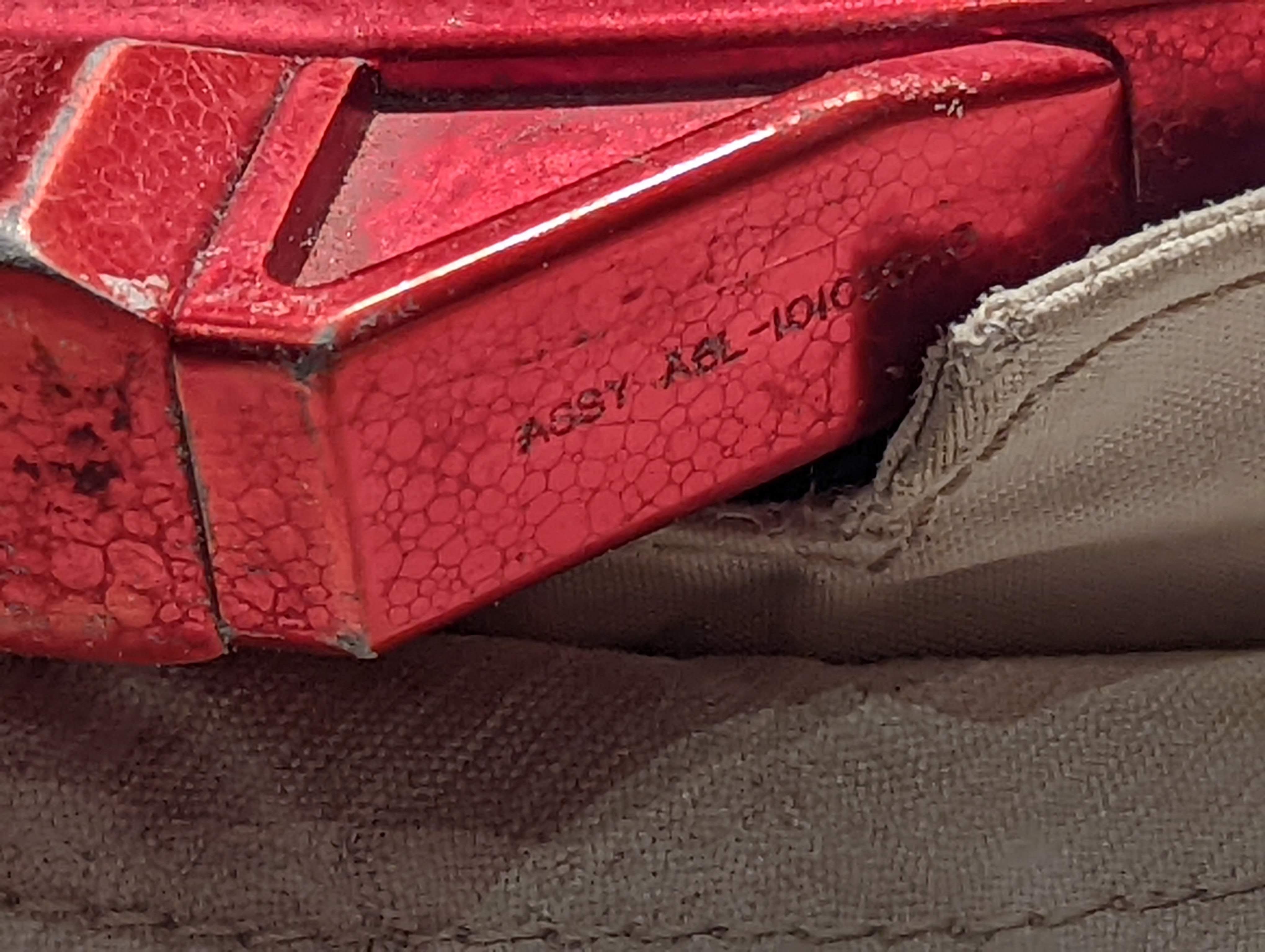

Where are these pictures from? I don't believe I have seen a suit with such damage. Where is this? It looks to be an A6L suit? It has an A6L pressure gauge. The bubble and the LEVA shell are also early.

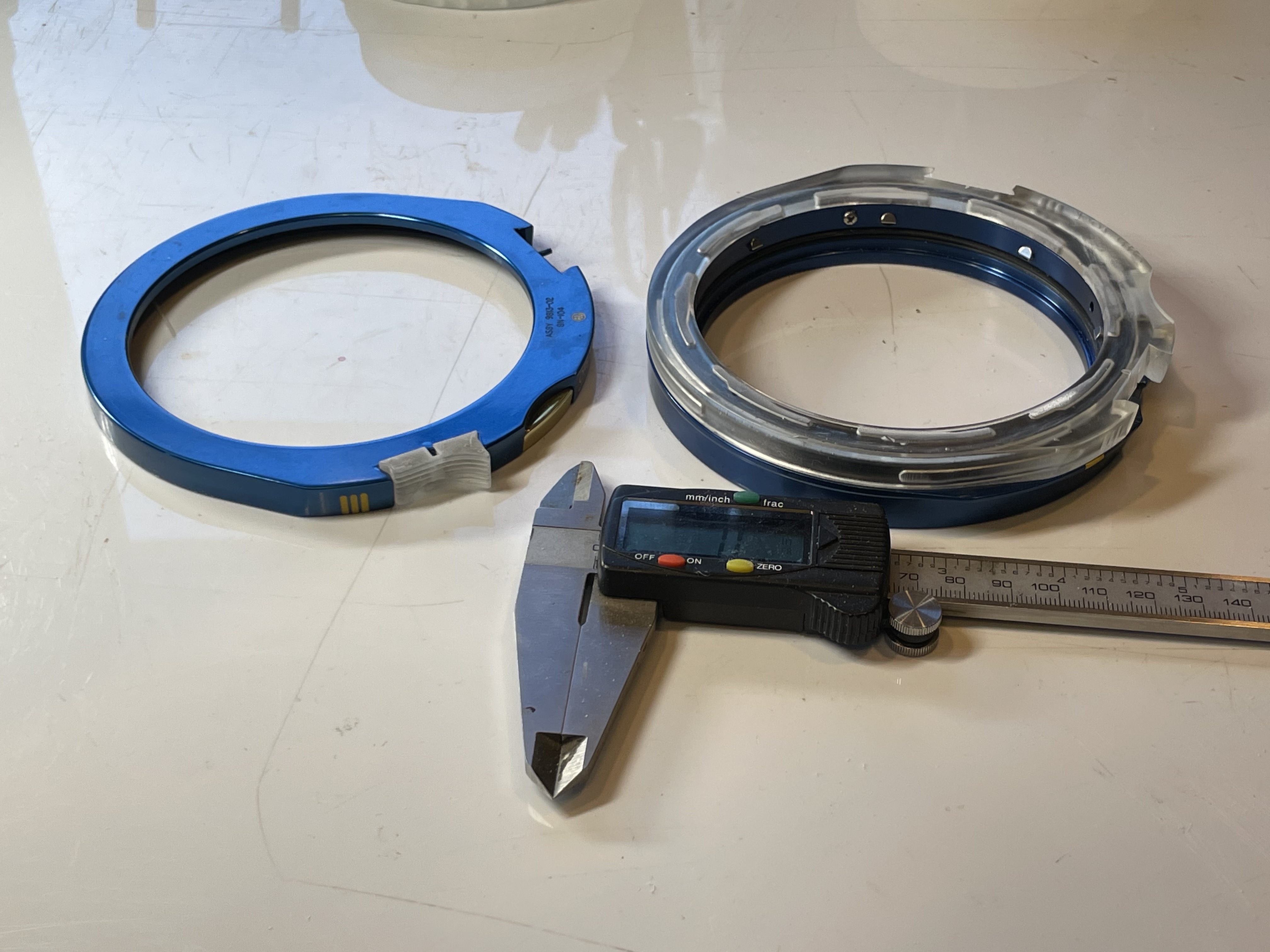

Some of my latest work on fittings for Apollo. The A7l and the A7Lb glove disconnects were very different sizes. The A7Lb being 1/2" larger in ID.
This is a 3D print on a real A7Lb left disconnect.
I'll be offering 3 different versions of Spacesuit fittings;
Plastic copies; molded off high quality machined copies Which I call "Class III".
Non-functional anodized aluminum versions designated "Class II"
and finally, working replicas, in polished/ anodized aluminum, that replicated the real fitting in dimension as well as function. "Class I"

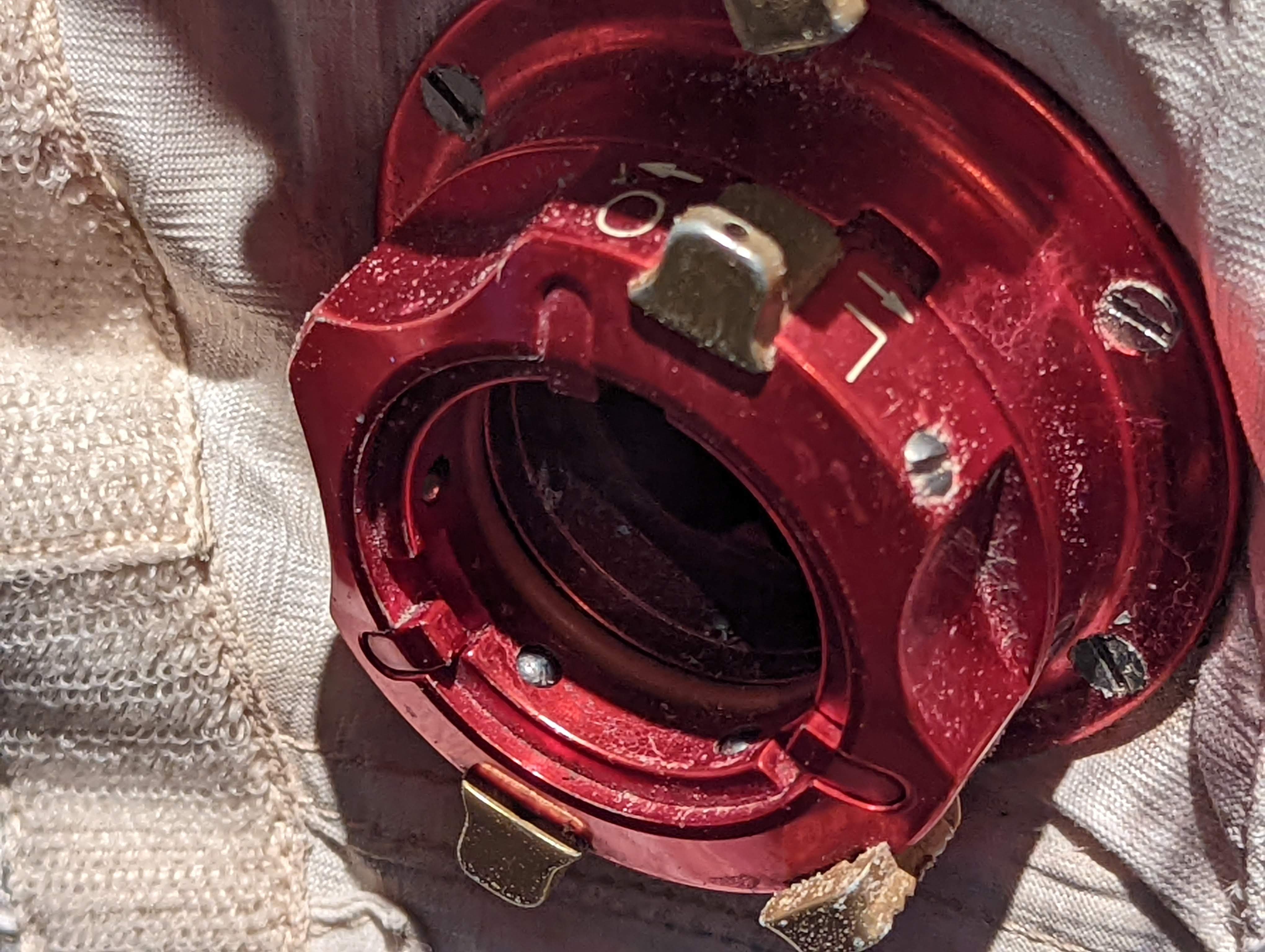

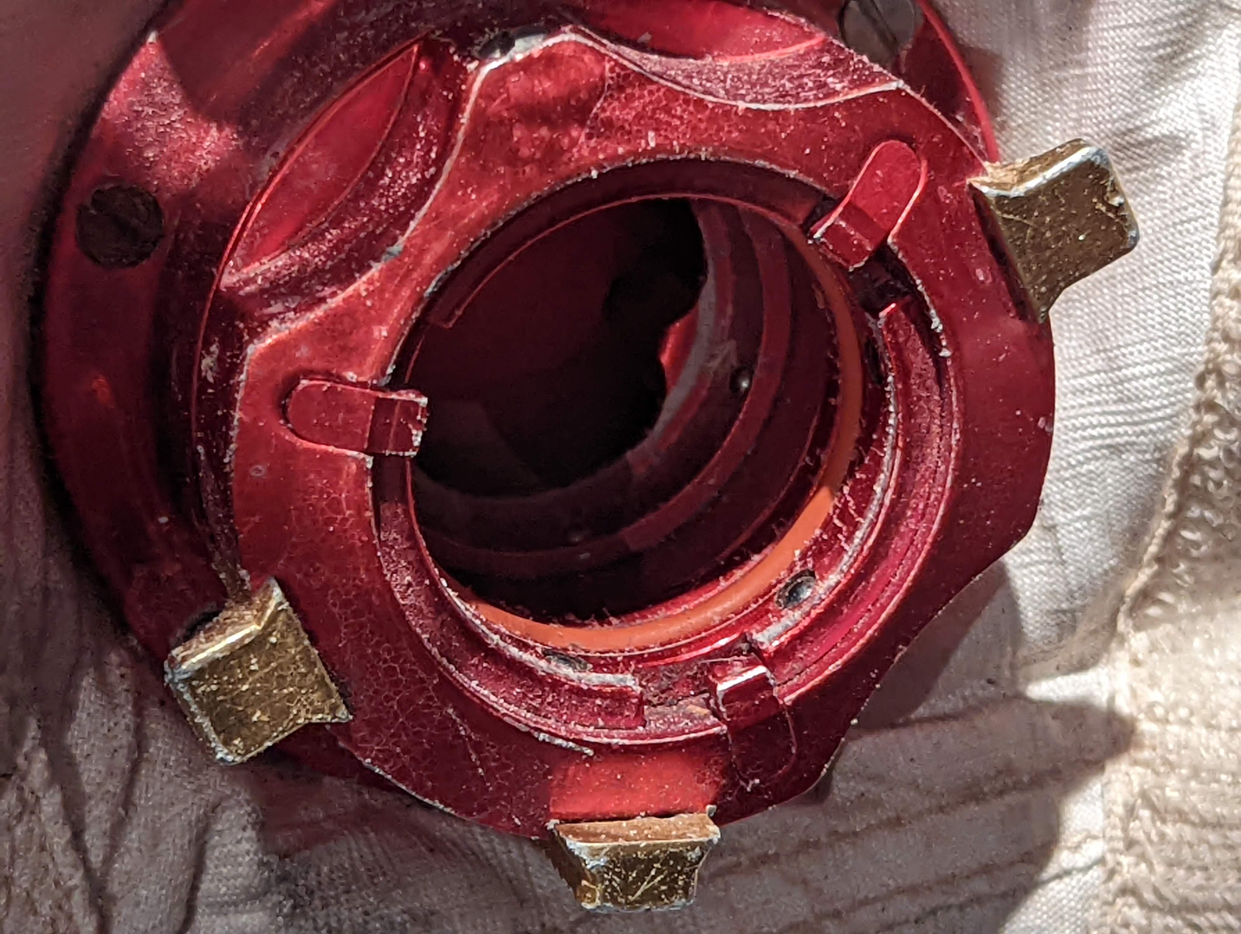

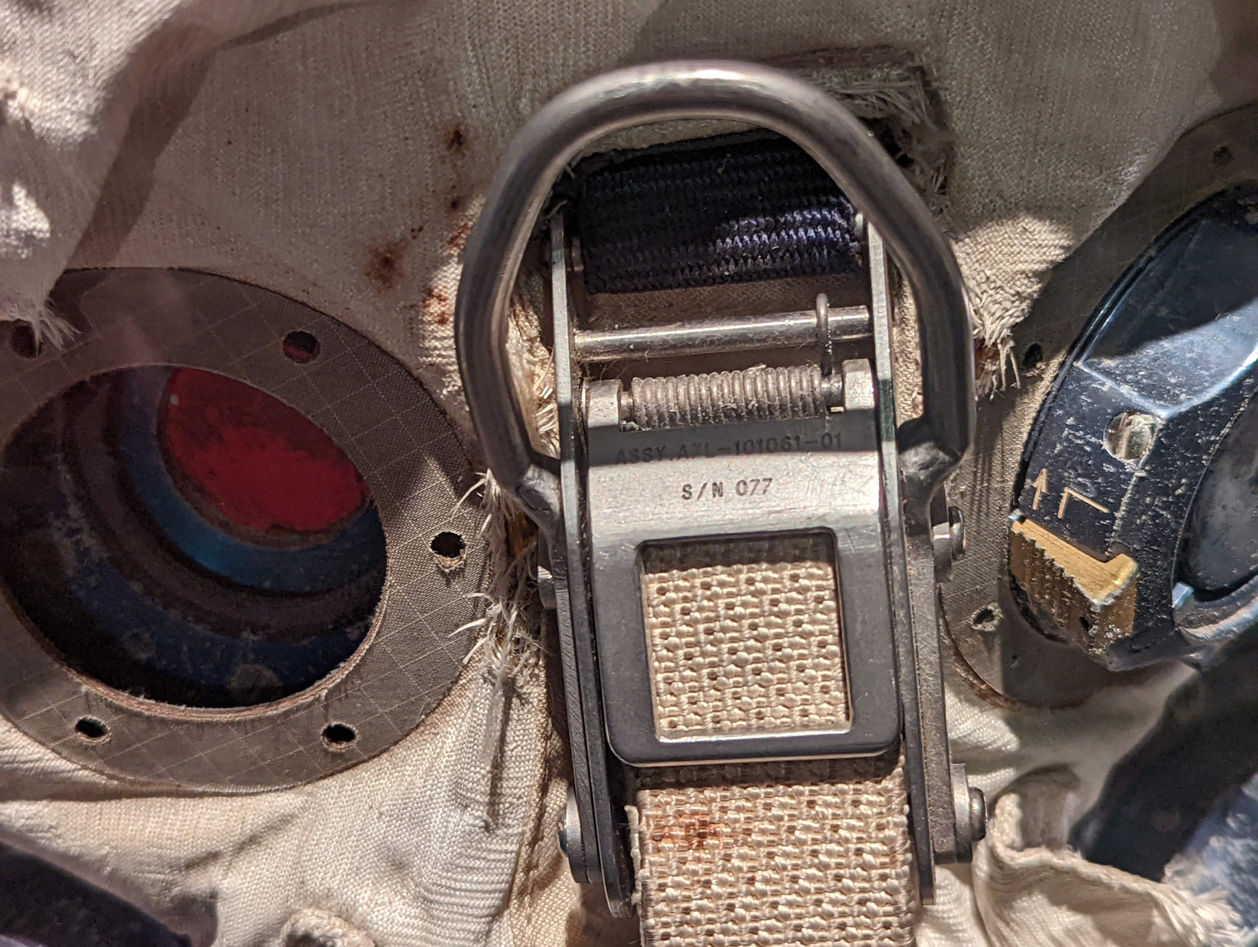

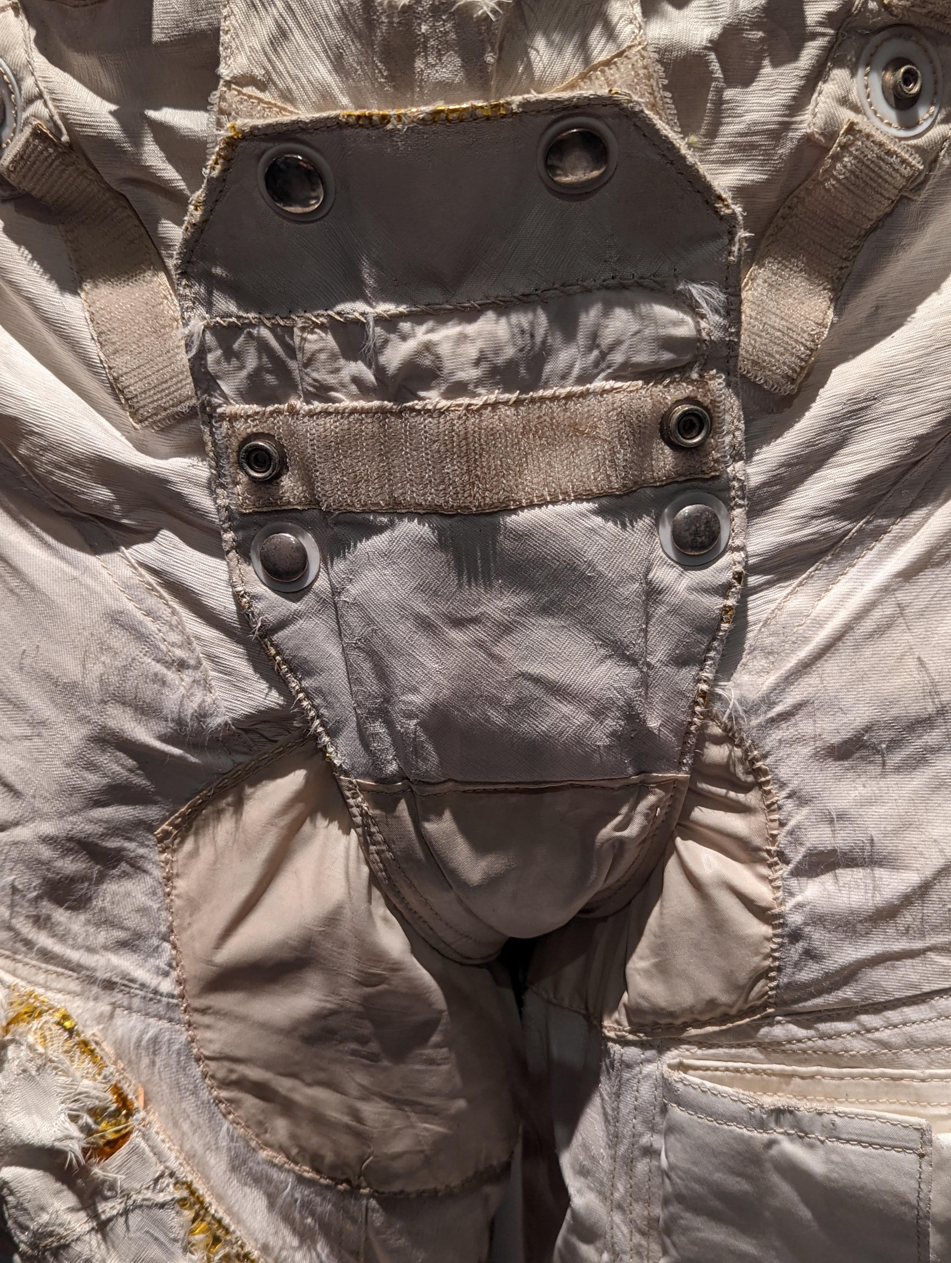

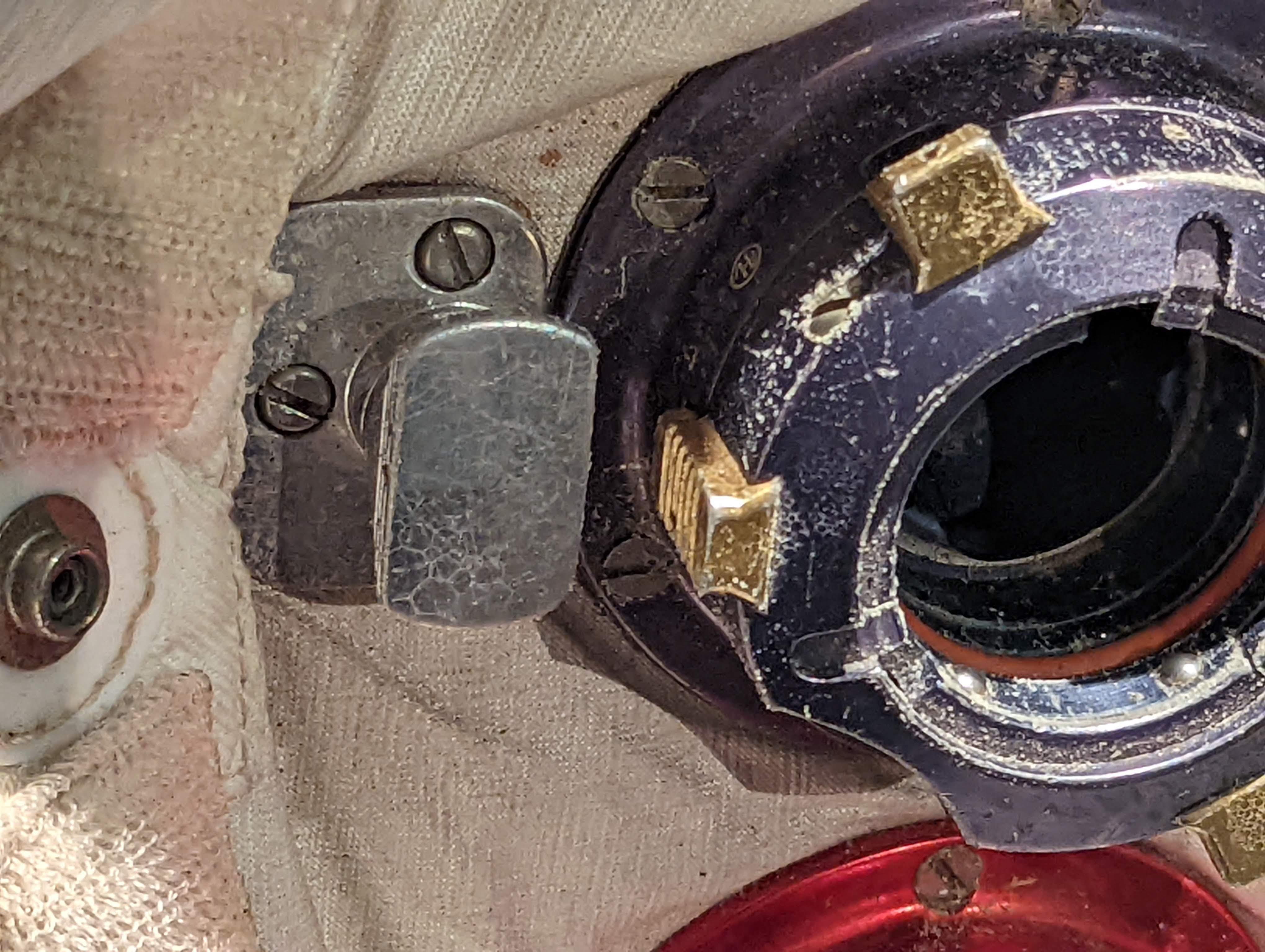

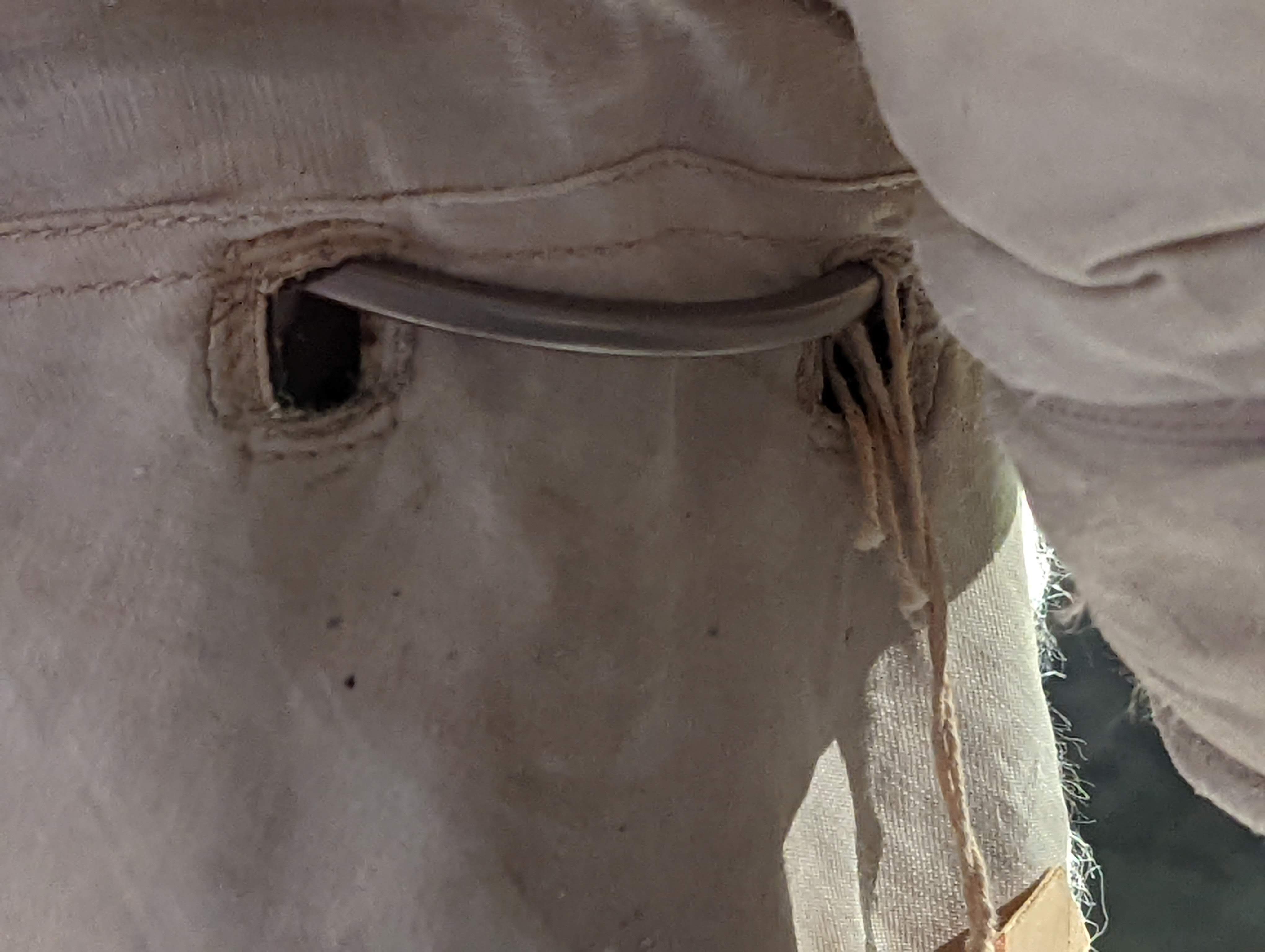

These were taken last year at the Edmonton TelusWorld Science Center when they had a space exploration exhibit on display. This suit was billed as "Neil Armstrong's Spacesuit" if I recall, and knowing where the actual suit is, obviously the first thing I did was look for a tag to confirm what it actually was.

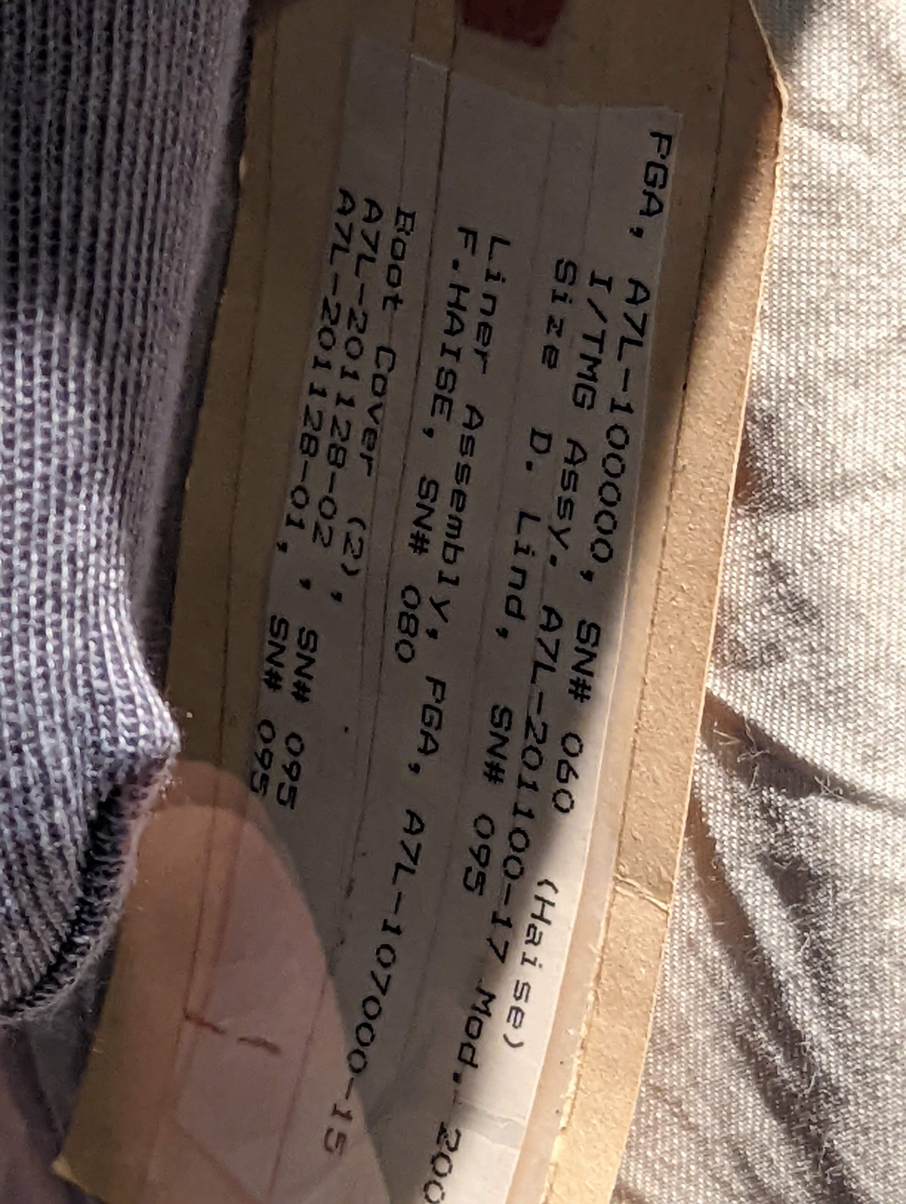

It's an A7L, serial #060 which from what I have found it is
"060 - Haise: Apollo 11 backup crew primary suit and Apollo 13 backup suit"
There are a mishmash of parts on this, it's obviously been heavily repaired, and potentially used as a training suit?
More photos to follow.

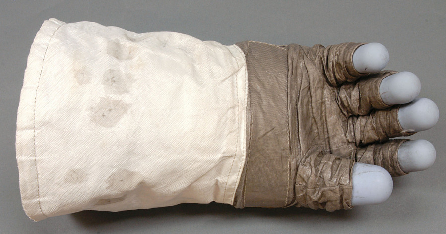

For making the hands how would I go around stiffening the glove fabric? Do I need some kind of under fabric to thicken it

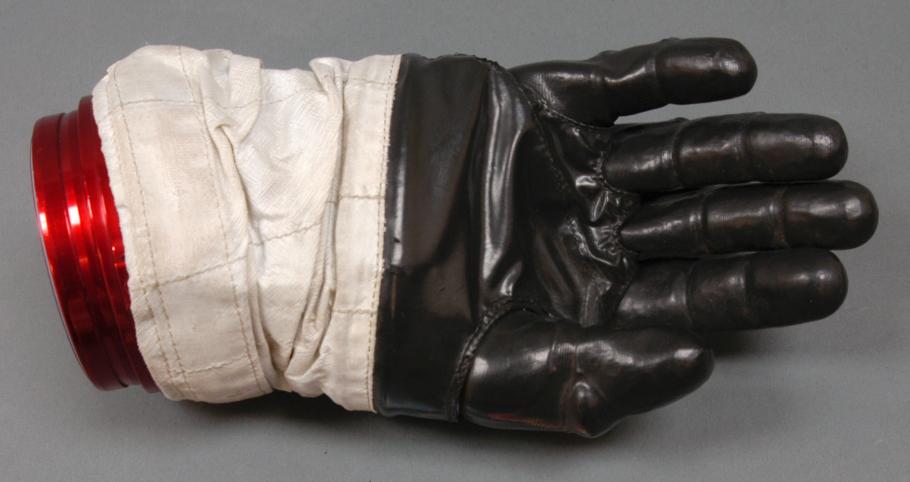

if you used any of the silver fabrics I suggested or the RFID fabric then yes, probably. IRL the Moon gloves are just the outer covers, they also had rubber pressure gloves, which is why they look so bulky. Same with the moon boots, they're just outer covers as well, with fabric inner-shoes that actually hold pressure.
The Apollo inner glove,
-and the outer glove.
I didn’t stiffen the fabric at all on mine, partly because the stuff I bought is pretty stiff to start, but also because I made inner and outer gloves, like the real ones.
