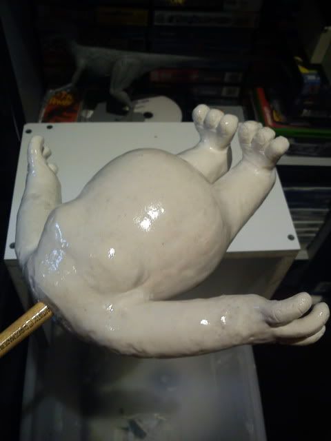

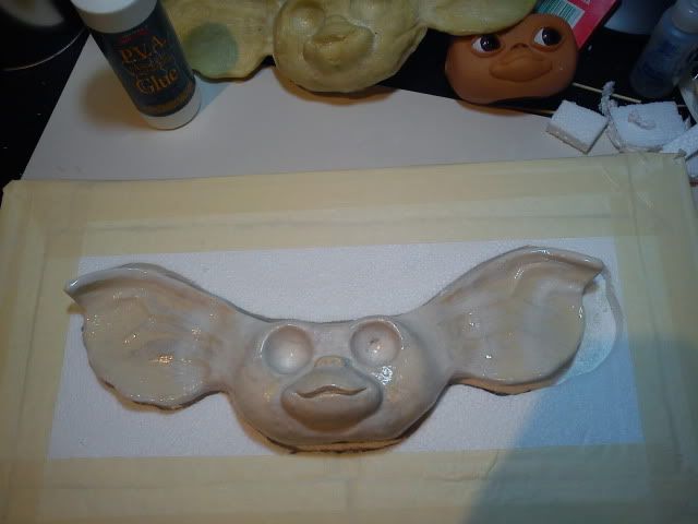

Finally making some progress again. I've gone ahead and clear coated the model, probably 20 coats or so. Nice and glossy and sealed now. Been prepping my foam for the molds. Clay is ready, plaster's ready, but I'm still waiting for my silicone. Had to order from the importer. Doesn't seem to be any local sellers.
Anyway, here are the models awaiting their molds.

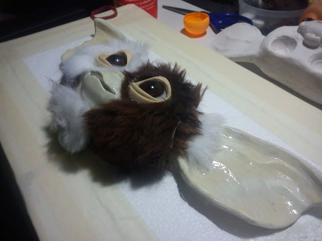

Ok. So I've been messing around a bit and I think that I finally have the eye situation sorted.
I've held off any molds yet as I wasn't 100% sure that I wouldn't have to alter anything, and I'm glad I was patient. Turns out that I'm going to amend the eye region of the head sculpt to actually include the eye assembly.
Here are some photos with the eyes, lids and fur all just sitting in place to give the idea of how it should look once all together. Yeah, his fur's all messed up and what-not, but he'll be all nice and combed when I put together a proper build...
As always, appreciate any feedback you might have.

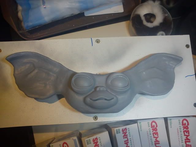

Ok, lazy update. Finished the final coat of primer over the model, now ready to mold this week. I hope...
Here's the little fella all grey and stuff. Can't wait to complete this project once and for all. Knowing my luck though, will probably still be months off because of some nonsense I'll end up creating for myself.
*For those interested, if you work with plasticine, you'd know that not much likes to stick to it in the way of paints, but, after much trial and error, I eventually came across an amazing primer by 'White Knight' called 'Rust Guard - SLS Etch Primer'. Really did a great job of staying stuck. It's designed to prime metals and such.

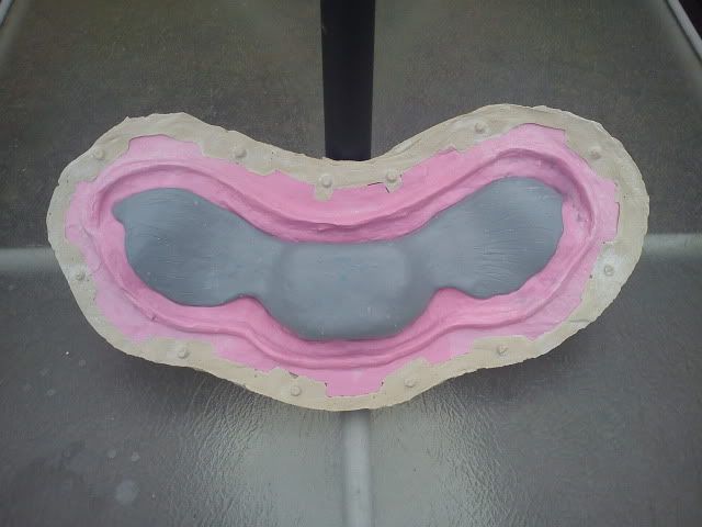

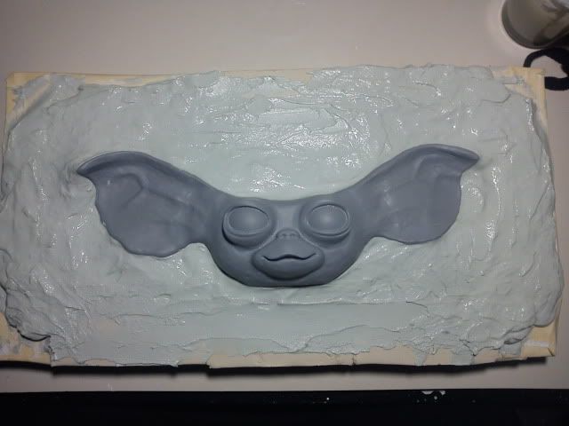

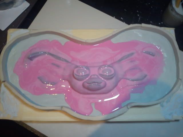

Since having the little bugger primed and ready, I've since made some progress on the molding. Again, this is my first time, so things are probably a little less than pretty, but so long as it casts fine, I'm going to be a very happy little vegemite.
Started with the clay base over a foam bed and carved out a key in the clay.

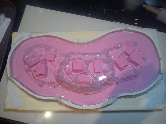

Poured the first coat of silicone.
Then put another layer of silicone, after which I used plumbers silicone to build up some areas and create dams to catch the final layer of silicone in the appropriate areas. I later stuck in some silicone pieces to help bed the silicone into the plaster later on.
*The tube silicone worked beautifully for those interested. Very handy.

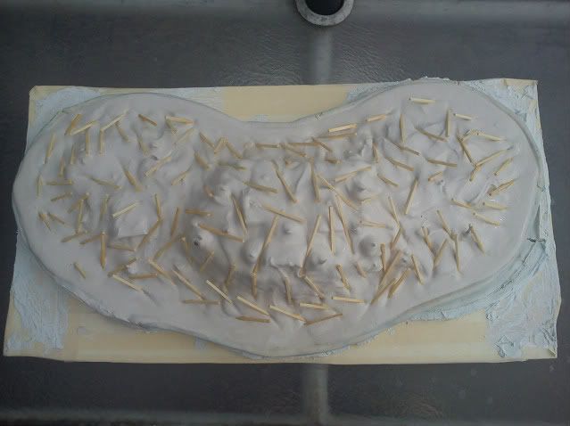

After applying the first coat of plaster, I didn't have any hemp strands (as recommended in the tutorial I've been following), but I've had a big bag of match sticks kicking about for ages, so I figured I'd put them to good use and jamb 'em into the plaster while it was still wet to hopefully act as a strengthening 'grid'.
Once I'd done the final layer of plaster and all was dry, I turned my heavy chunk of mold over and removed the clay and foam. Gave it all a good clean and now I'm ready to move onto the next half...
It's not perfect, but it appears to be coming along ok so far. As always, any feedback is much appreciated.

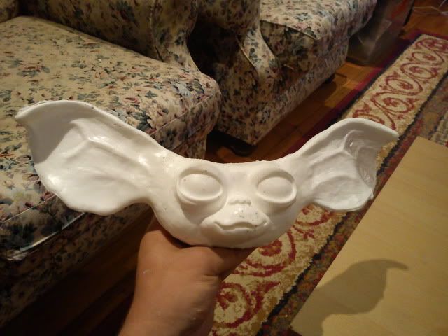

It's all been a learning experience, some good, some not so good, but it's all proving to be successful enough to keep me reasonably pleased so far.
Sadly the plasticine model didn't survive the demolding :( , which I was hoping to keep, but the mold has done ok.
I'm still yet to mold the body (time and money...), but I finally created my very first cast tonight! :D Really feels like a bit of a personal milestone. Almost thought that I messed up BIG at one stage, but I managed to recover. Been working hard at this for too long now and I'm glad it's beginning to pay off. Still a lot to do, but it's coming along. I hope you can share my cheer in my newly met goal.

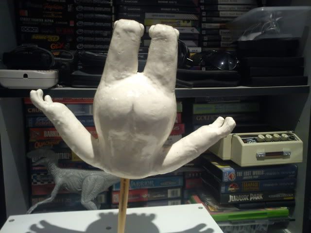

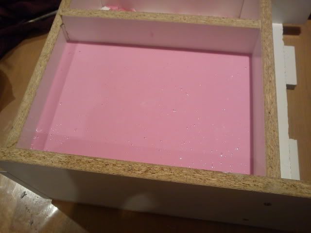

Life can get busy at times, not to bore you with the details, but I have made it a very personal mission of mine to finish this guy once and for all.
I am making my best effort to get this project on track again and hopefully have him finished as soon as possible.

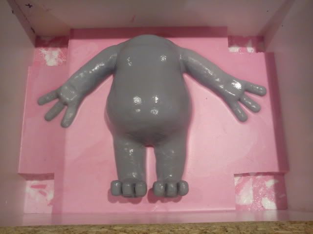

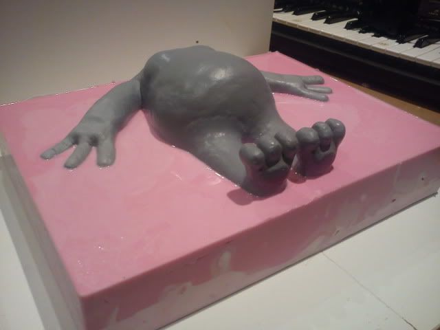

First on the agenda, the body has now been molded. Will demold tomorrow after work...
First half.
Keys cut in corners (white marbling seen in cut corners is due to mixing in cut up silicone to fill some space and save on the new stuff).
Second half poured and awaiting demold.

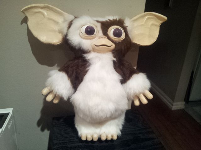

Anyhow. Molds have been done for a while, been toying with casting materials. Looks like I'm going to be going with Smooth-On foam. I'm committed to having a finished product through the Christmas break. Already have an airbrush on the way. As the whole project has been so far, I'm learning all this as I go, but it should be ok.
Anyhow, the following is a foam cast with fur temporarily pinned on him and eyes crudely drawn on. Hope you like the progress.

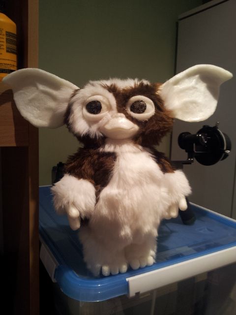

As far between my updates usually are, I am finally close to finishing my first Gizmo. I've done some work recently and this guy is only a few appointments away from being complete. I do plan on making more as I would like to believe that I've learnt a few things along the way that would help me put together something a bit more polished than what this will end up being, but it's all been fun anyhow.
For now though, here's where he's up to at the moment. Thanks for looking. Cheers - Chris
