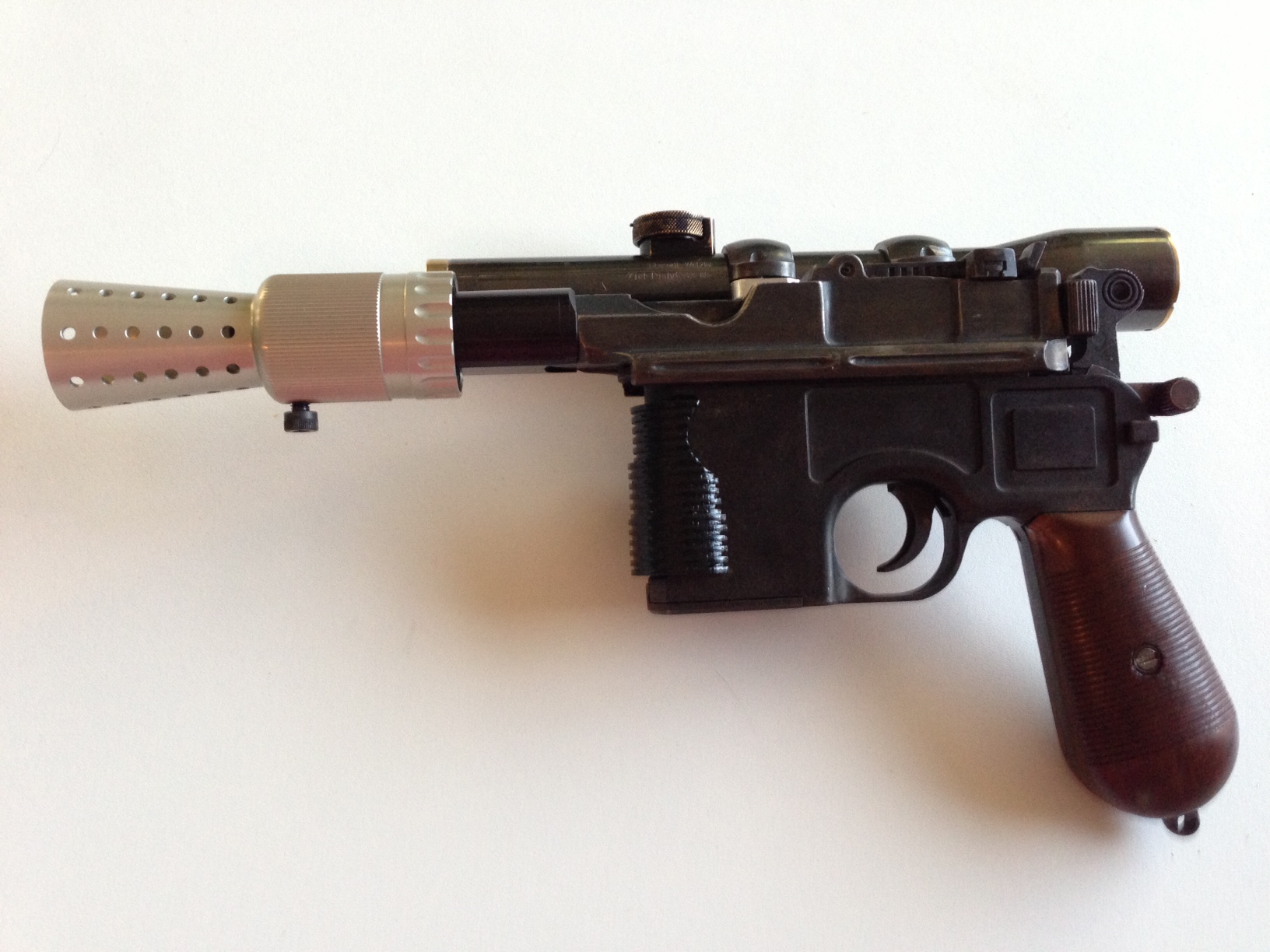

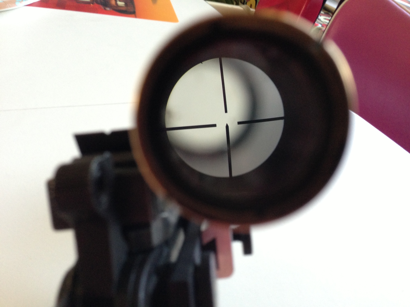

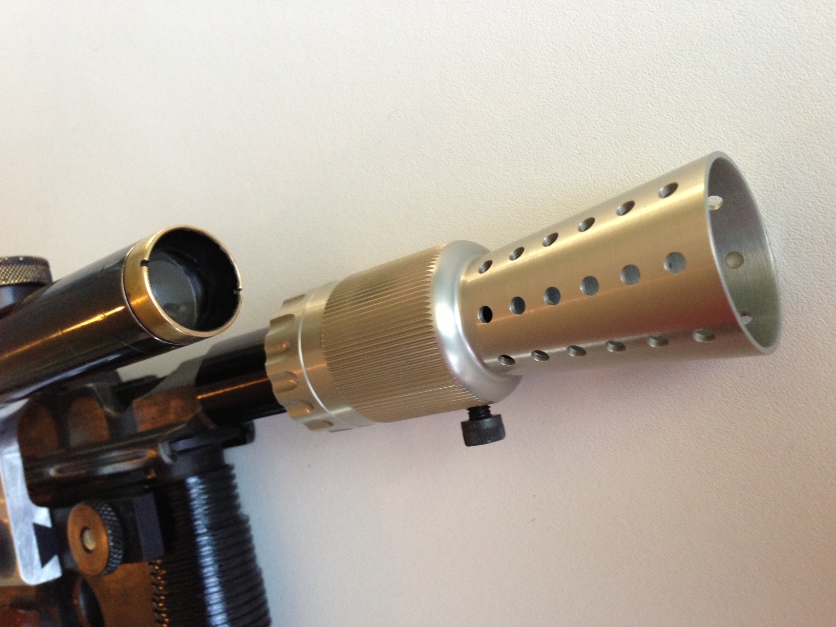

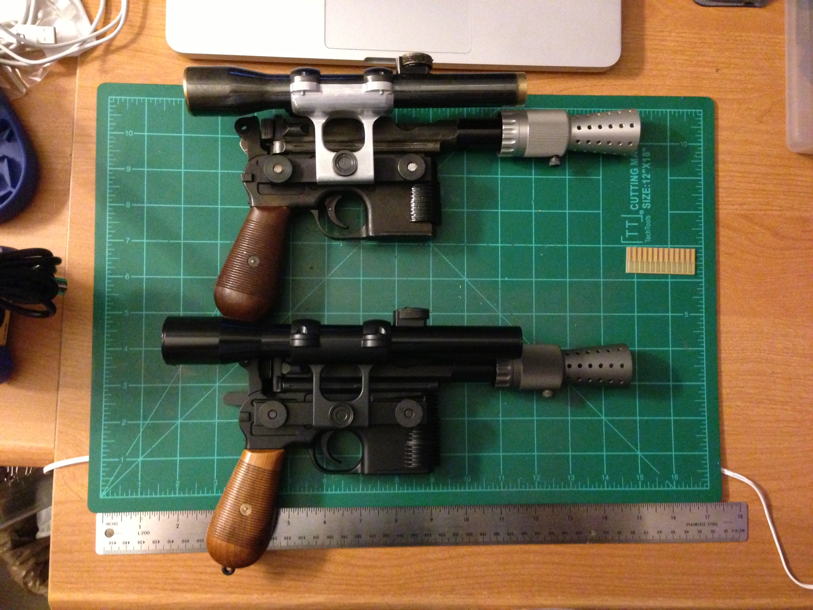

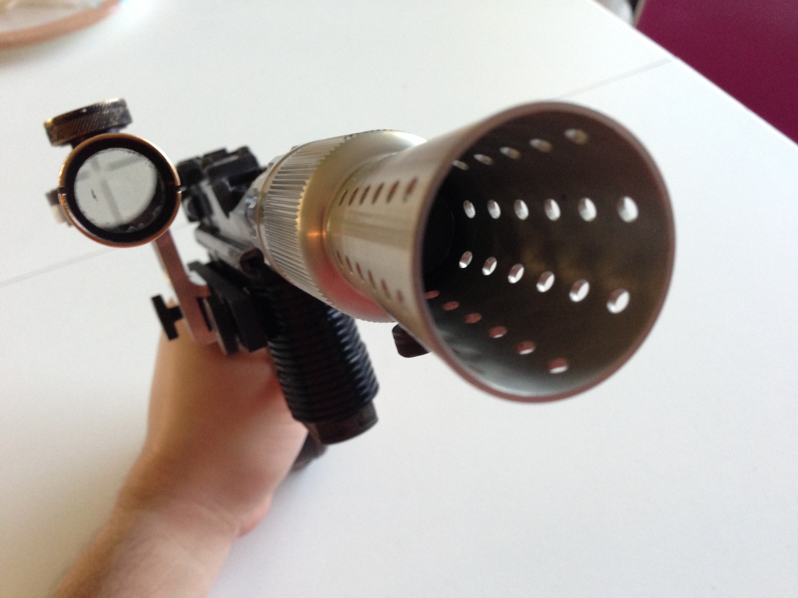

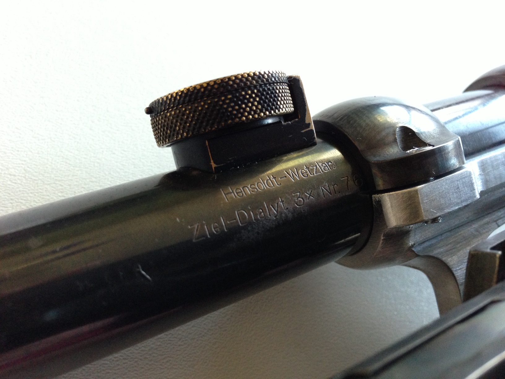

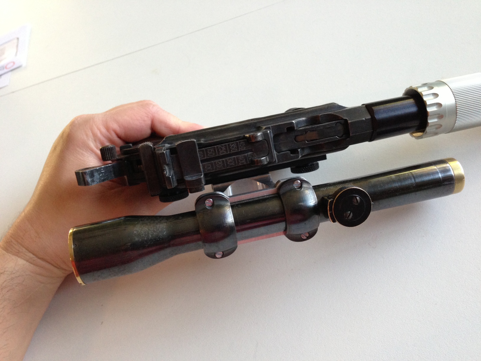

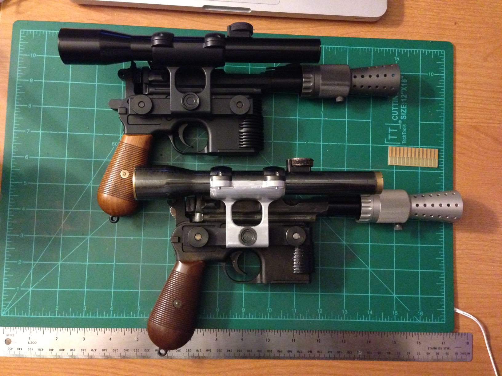

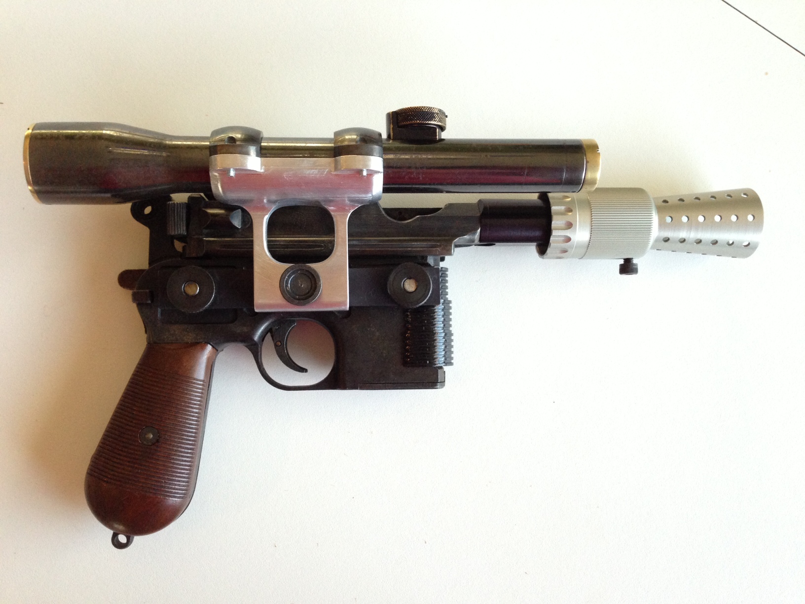

Here's mine. I was lucky enough to get some leftovers from the run, and my bits are coming together.
So I lucked out with a rough scope mount (needed smoothing and filing), with steel top rings, an aluminum sleeve bull barrel, aluminum flash hider (I sold the inaccurate holes steel version I picked up), and for now I'm using a correllian exports resin grill.
So in the future from run 2 I will get whatever parts I'm missing in steel I think, and a grill to replace the resin one.

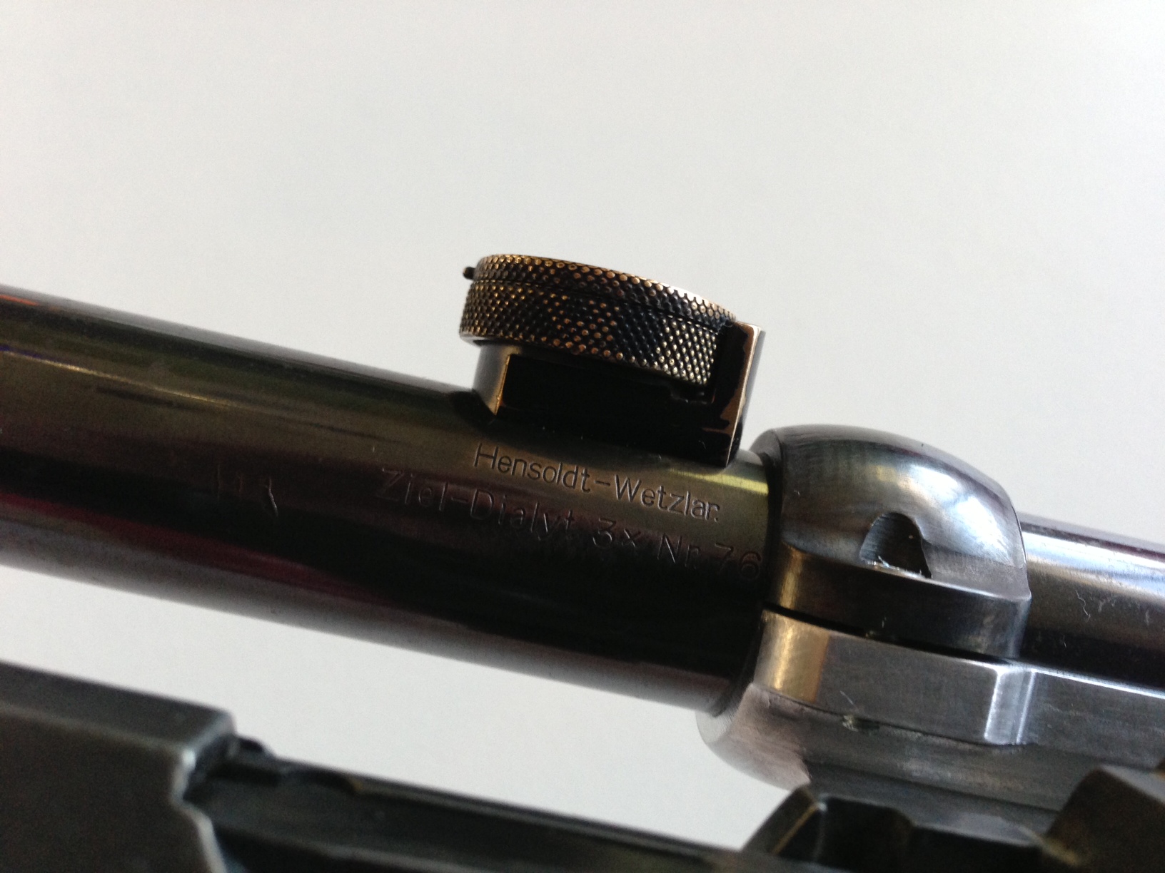

My real scope is the one I got from MR Sparkle, and while this variation isn't 100% accurate to the prop, for me its perfect for now. The front brass ring is thicker, and the Hensoldt Wetzlar text is on the opposite side. It IS the right scope and the knob has the correct knurling, but no numbers on top.
Its looks awesome, and all that's left now is finishing the scope mount and stripping and blueing the bottom of the MGC, and seeing what I can do to get the bull barrel to match.
And next to my MR Elite Version
I've got a steel correct flash hider on the way now, so I will swap that out with this aluminum one, once I blue it and weather it.

Looking good, scottjua! Great work so far. :thumbsup
-Carson
Re: ANH Hero DL-44 Discussion - Three ANH Greeblies FOUND, Update in 1st Post
Looking good!
Is that a sleeve bull barrel?
