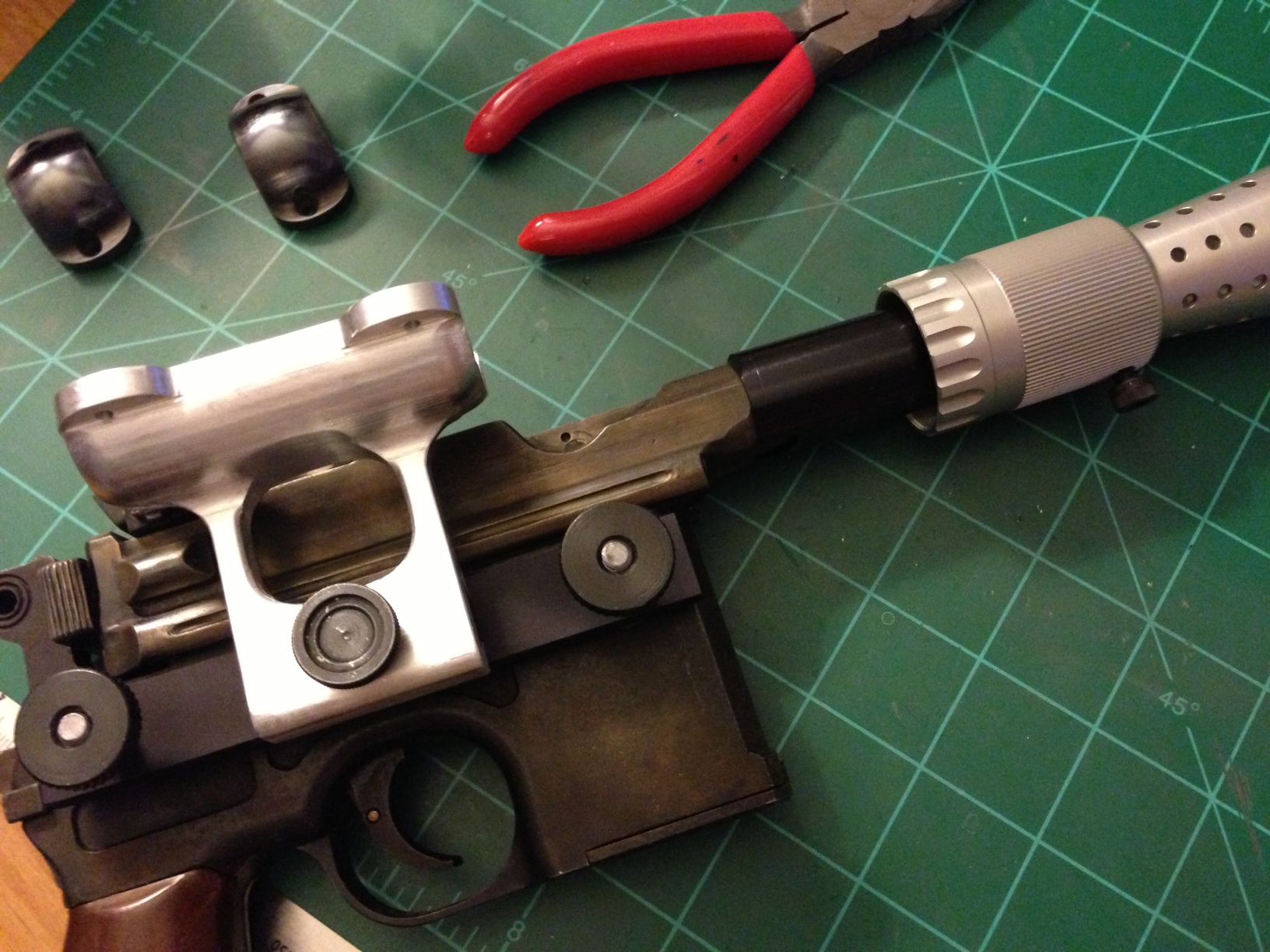

I have a mix of leftover parts... so my lower bracket is bare aluminum, and the cross bar and knobs are as per the run I think and are black. But I need the bracket to match... if I can figure out how to make them the same.
edit:
here's mine for now. I think the center knob is black oxide... as It comes off on my hands.

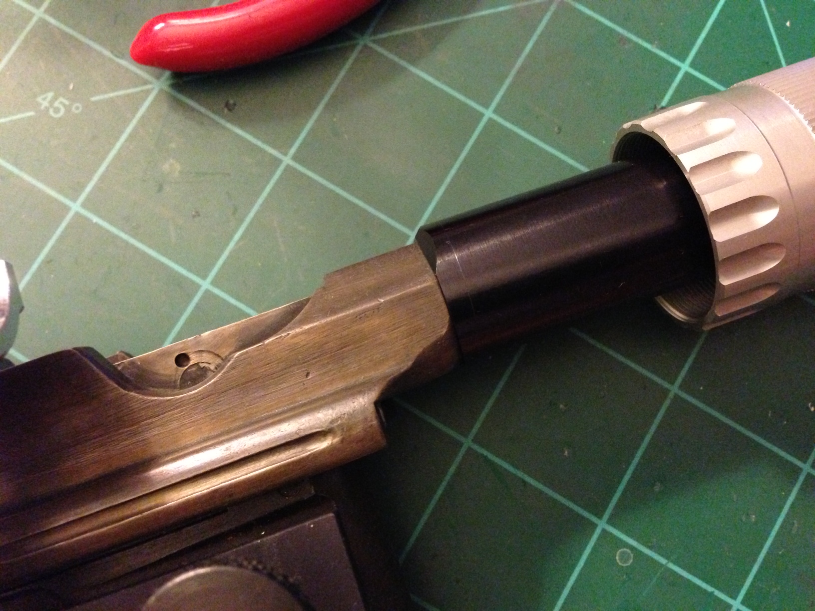

Here's how my sleeve bull barrel fits. No trimming, modifying. It's a great fit.
Oh and the MGC upper in the pic, has been sanded lightly and blued with perma blue. A couple of applications of the liquid type. Not very dark yet... kind of grey/brown.

It fits great, but it is too far forward due to the MGC's thickness. Any good advice for mounting the bracket?

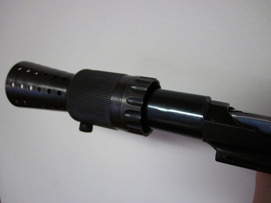

No idea. I stripped the powdercoat off of everything and plan to paint with semi-gloss black and weather. Just blued the flash hider:

SO... does anyone know the thread size and pitch for the scope mount!????? The bolts for the knurled knobs and that thread into the body. I don't have the size... so I need to go buy it.

all aluminum parts if not raw are anodized
all steel parts if not raw are black ox.
if you are going to paint anyway, you need not strip the parts completely. use the color as a base/protective coat. Clean and degrease the parts , scuff up and paint over. You can look up black ox finishing. they put lacquer over it.
The two mounting nuts/threaded rod are 1/4-20 I think. The center thumbscrew may be the same.
The blued FH looks nice! Will you steel wool it to lighten it a bit for weathering/wear?

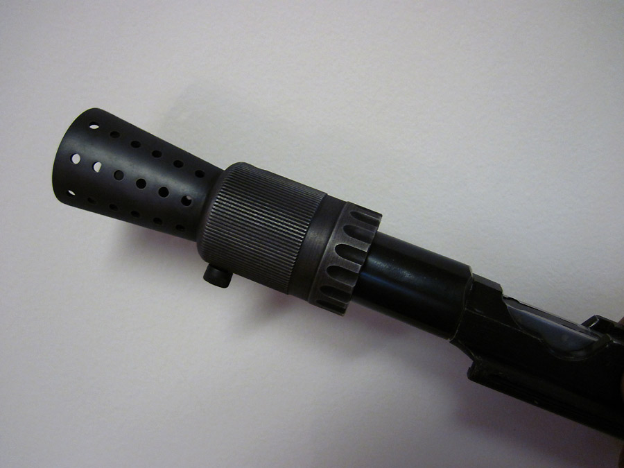

Finished. I redid the flash hider several times. First I discovered that it has thousands of grooves in it. If you blue it and then weather, you'll end up with a striped one! I got the mouse sander out and sanded out 99% of the grooves. I also cut the Birchwood Casey with water because I didn't want it to be that dark. As a final step, I sealed it with Testor's dullcoat.

By grooves I guess you mean the lathe turning machine marks and not the FH knurls :lol
Good idea to sand the parts slightly with emery to smooth it you like.
Nice job with the BC bluing. Good to know you can thin with water.
It really looks good with the dull coat too.
Finished you can really see that the shapes and knurling are perfect.
That pic is a great match for the promo pics.
Re: ANH Hero DL-44 Discussion - Three ANH Greeblies FOUND, Update in 1st Post
Thanks. Yes, I meant the marks from the machining process on the cone. Had I not already blued it, I would have sanded the rear a little too, but they are not as noticeable.
