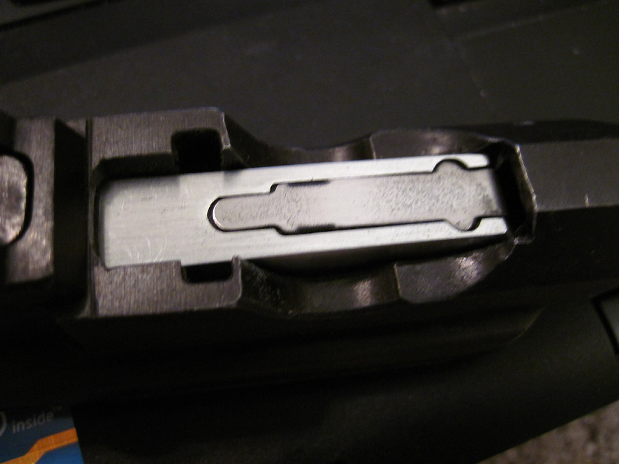

I removed the bolt. It really is simple. The only hangup I had with the MGC is when I rotated the firing pin, it wouldn't pop out. I had to pull the bolt out some and push the pin out from the other side. This was accomplished by pushing it with a screwdriver on the open side of the bolt.

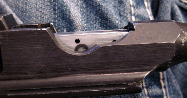

MGC really funked the bolt up where the extractor is. It is pinned to the bolt which leaves a nasty hole. There is also a nasty seam down the middle of the bolt. I sanded as much as I could, but there are still some deep areas that wouldn't sand out. I'm gonna experiment with some solder to see if I can fill them.
The bolt would look really good like this or blued some, but in all those Solo pics, it looks BLACK. :(

I used solder to fill the holes. This stuff is a complete bezotch. It does not want to stick to the metal. You have to play with it and scoot it around until it stays where you want it to. It also doesn't completely fill the hole. You can still make out the faint outline of the circles.
Also, if you sand it and have to retouch an imperfection, it will screw up your previous work. :angry
I sanded a bit more and this is the best I can come up with.

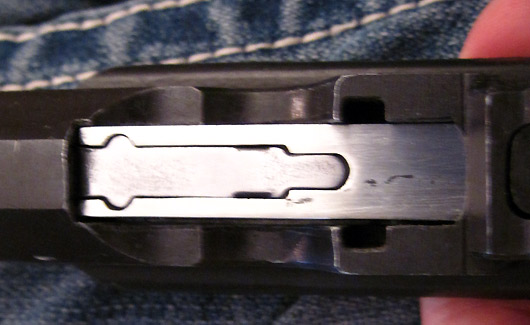

Thanks for those images! I was planning on bluing the extractor tomorrow. I think that the dark extractor occurs naturally on some mausers as seen in this pic. (Edit: re-read your post. I thought you meant the dark extractor was due to black paint.)

The extractor is prob blue because it is tempered harder. The bolt is just raw steel since it is being rubbed constantly in the slide channel.
With the soldiering thing, it will stick nice but you have to use flux and get the surrounding metal hot enough. I use a HD soldiering iron rather than a torch to be sure the temp does not got up to the melting point of zink. about 780 F
Use low melt soldier that can be blued (if you want/need that) Some melt at 300f-400f but the frame metal in that area must be that temp too which...takes some time and patients.

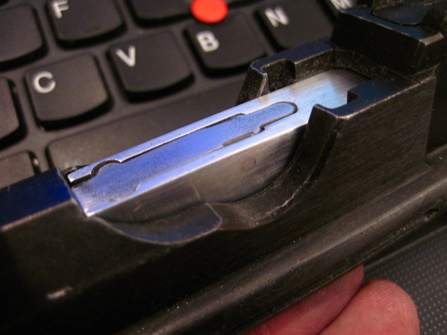

Good to know. Thanks. Here is the blued extractor. The cheapo metal makes the bolt look too shiny. Might have to dull it down some. I should have taken before and after pics. JH, care to snap a pic of your bolt? :lol
Re: ANH Hero DL-44 Discussion - Three ANH Greeblies FOUND, Update in 1st Post
looks good. you could just wipe it with some 000 steel wool or something to age if you want but looks like you know what your doing.

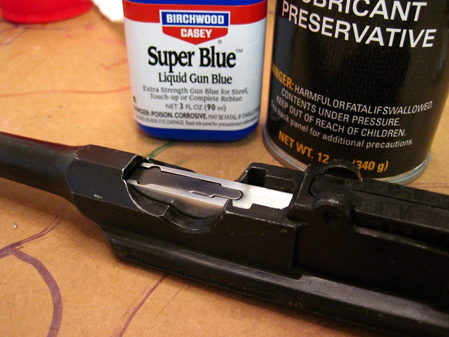

Hows that super blue work on the frame? Does it work on the soldier?
Just tried a few spots on the frame. Didn't blue the bolt, so I don't know how the solder will take to it. People have been using this stuff on their Blade Runner blasters with good results, so I figure the mgc and denix are no different.
