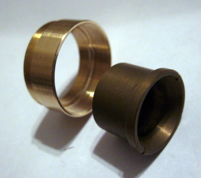

Got my parts today :) Very impressed with the workmanship (y)thumbsup
I couldn't wait and mocked things up a bit. The barrel piece slides in place very well and the set screws hold it in place quite nicely:

That looks awesome, Dave! Very cool to see a mock up of the parts with your real Mauser and scope. :love
-Carson
Re: ANH Hero DL-44 Discussion - Three ANH Greeblies FOUND, Update in 1st Post
that sleeve barrel fits pretty sweet there Dave. Great modeling by Carson and great machining by DEC Dave.!
DEC Dave added those three set screws so you could easily center the bull barrel. Glad it fits so well!

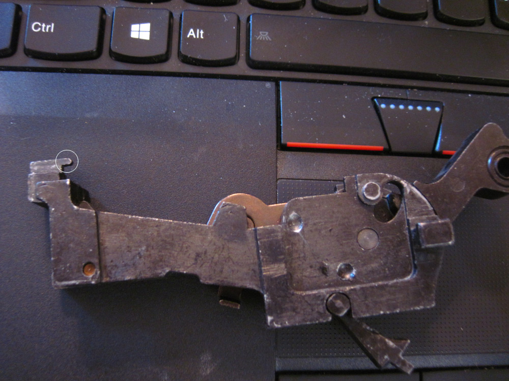

I finally decided to break mine down. One thing I noticed is that you don't have this little tab on yours. It makes it impossible to assemble it the way you did. With mine, you have to 'hook' it into the upper first and then push that one tab back with a screwdriver to get the other to set in front of it.

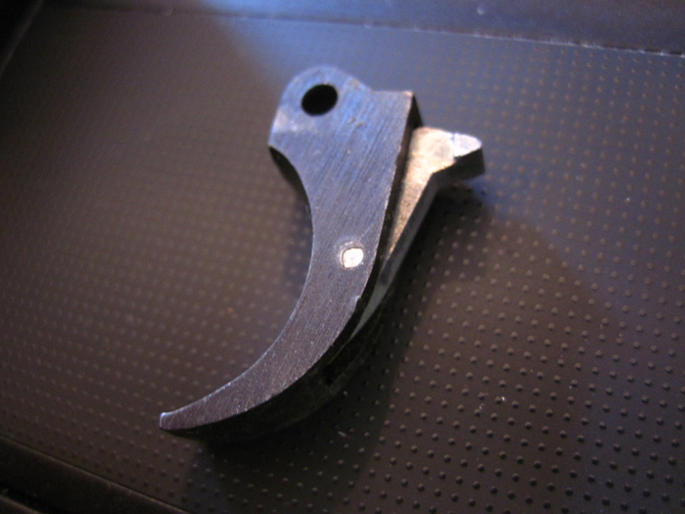

I'm also wondering about the trigger. I can see no reason to have this spring-loaded sliver piece.
I'm thinking about filling all that in and resculpting around it. I'm also wondering if anyone has replaced their trigger with a real one? It sounds good, but I'm not sure if it would line up correctly.
Good question. I have a real trigger here I was going to try with my mgc when it comes.
Interesting variation. I wonder if yours is older or newer than mine?

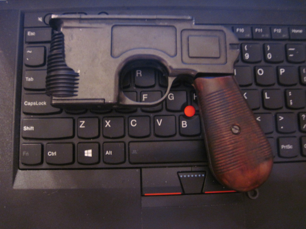

Probably no way of knowing. I can't see what purpose that hook serves. Does the grill look low enough now? I've also added the wood grips. Don't know if I like them or not.

...as far as the grill goes, it looks pretty good. I think the best way to position it is to use the disk sticker to place the grill.
The top edge of the disk should just overlap the bevel on the lower receiver and the center be at about the 4th fin from the top and the left edge about 1/16 inch from the grill edge.
Test it to see how you like it. You could also use a dividers or compass to find the center.
the grips could be nice if you fit them better. Gotta reshape the metal a bit.
They came off a denix. They are thinner than the MGC grips. After I re-finished and sealed them, the ridges kind of filled up a bit too. :(

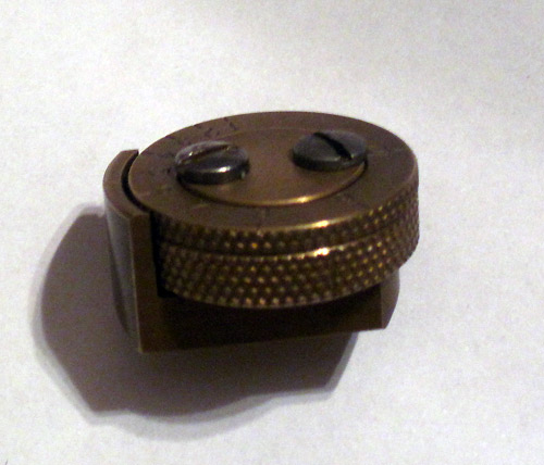

Another thing you guys might want to do before painting is age the brass parts. I put mine in a sealed container of ammonia around lunch time and took them out after dinner. Rinse and give a final polish with fine steel wool. I managed to find some screws that set flatter than those supplied as well.
Un-aged vs. aged. (This was before the steel wool polishing.)
Dials. Photo makes them look darker than they really are.
