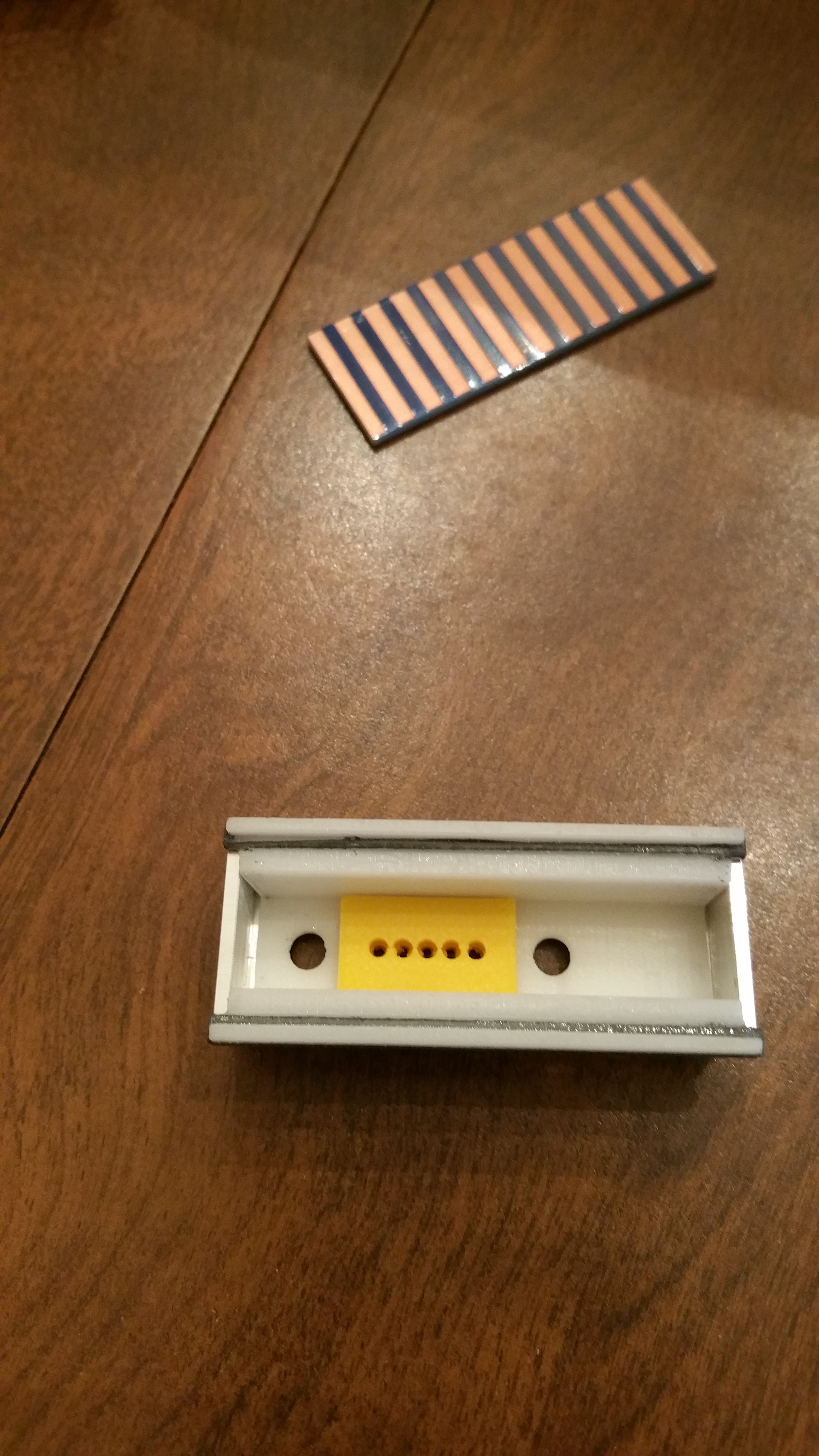

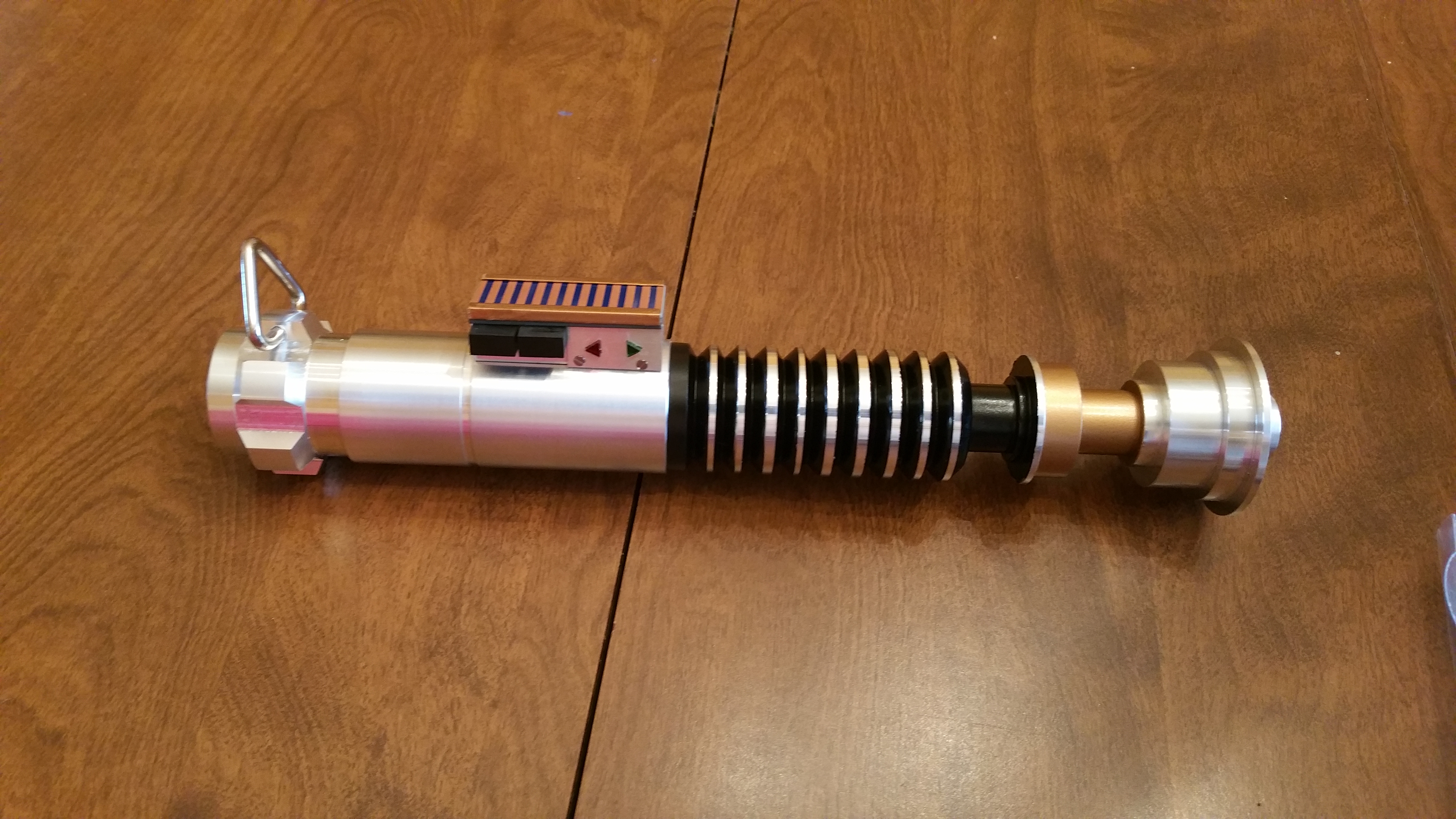

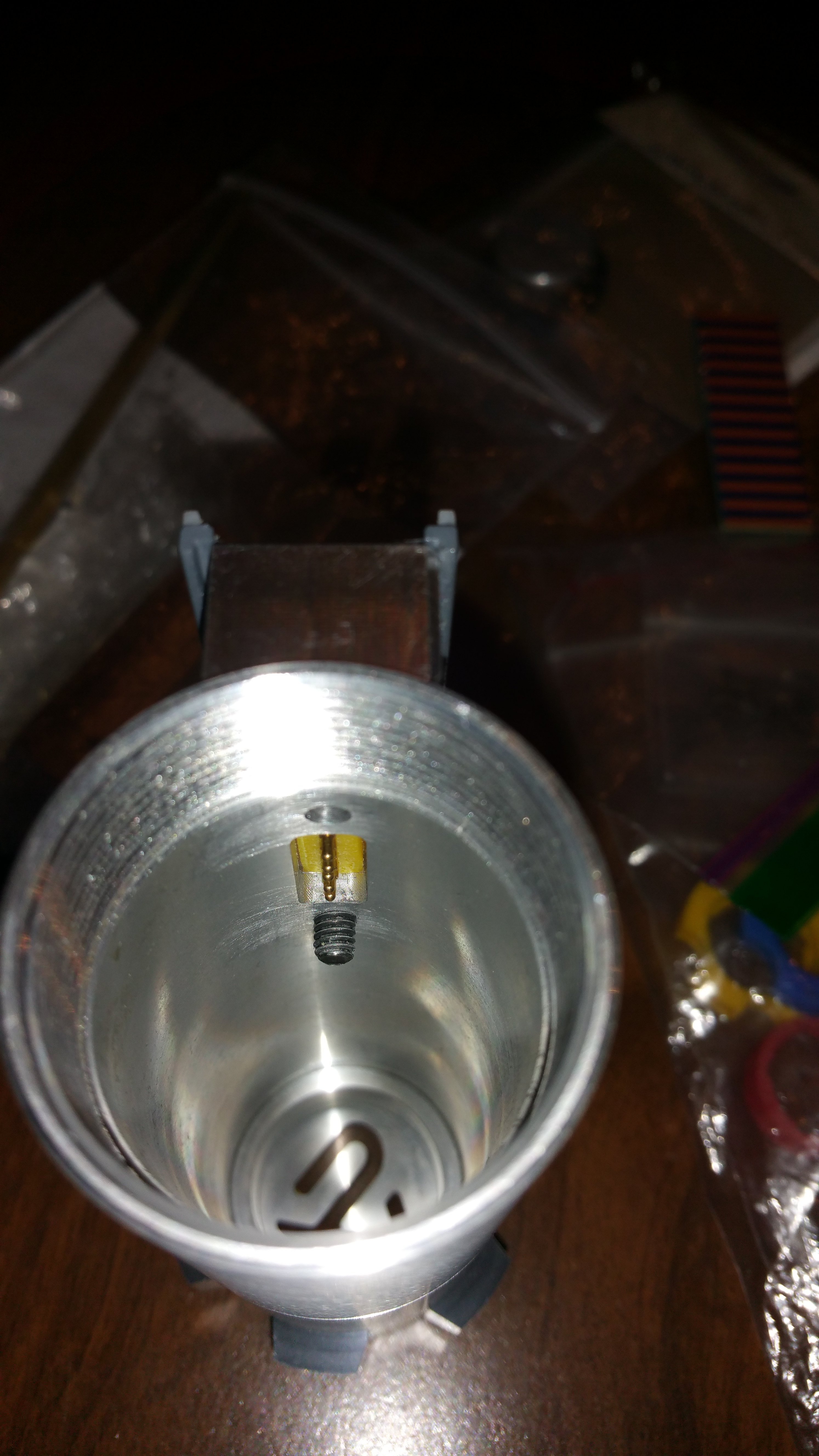

Static done! Now to the fx! Thanks Halliwax for the videos and writeups. I've been working on making the boxes interchangeable. I have a spring loaded contact pin holder stl for printing. It mates to contact pads on the chassis. The box to hilt screws are going to need a trim.

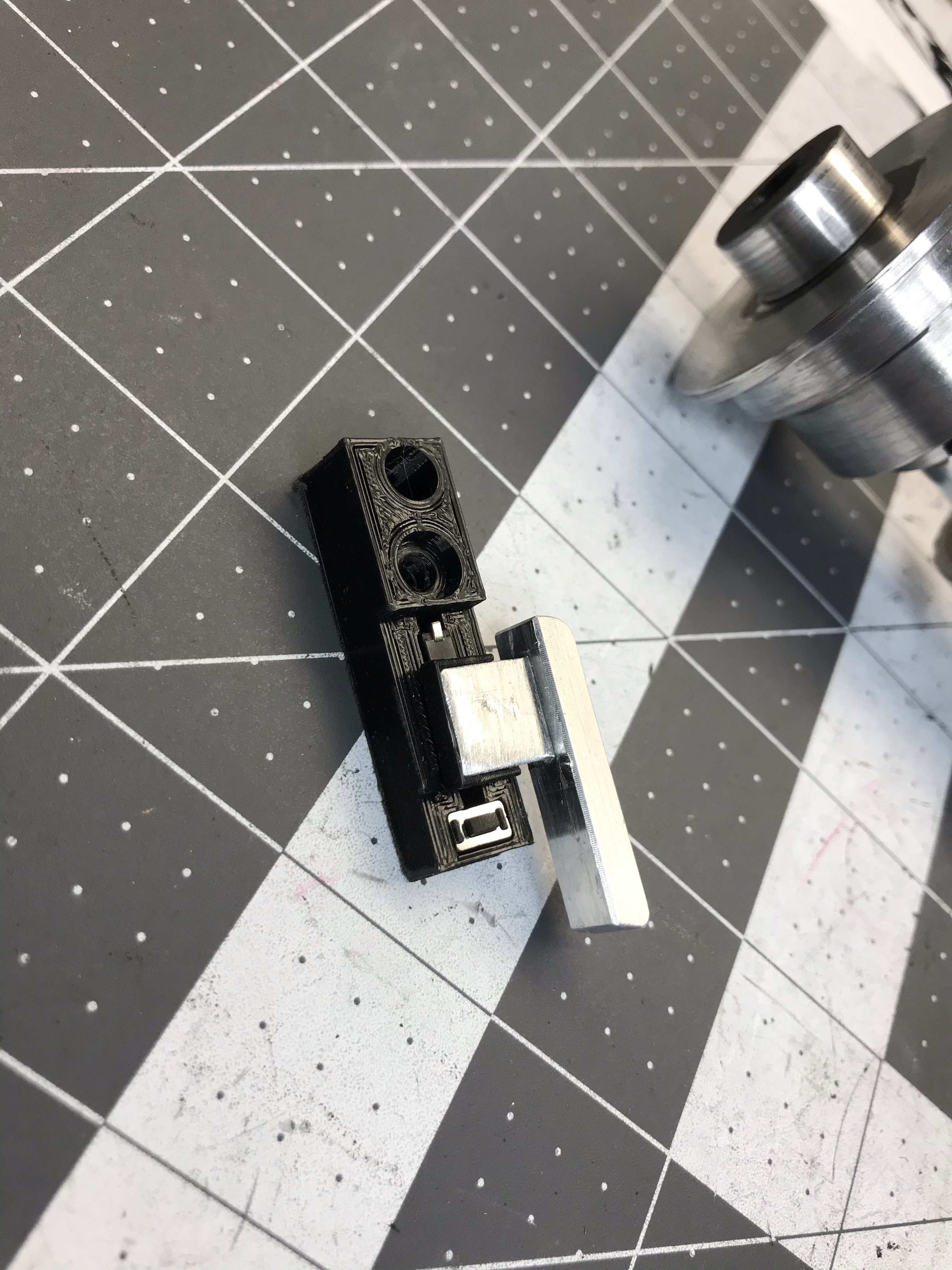

I'm working on my yuma lever right now. I got the thing almost filed down enough to be a slide switch. Still stiff. I'll try to make a stl for the yuma adapter that houses switches needed and a 3 contact pin adapter-I think halliwax already did this. The slide switch is the tough nut to crack. I think I like the graflex slide switch solution-very similar.
The big difference between the two boxes is the pin out. The Hero in my configuration has 5: capacitive touch button 1, 2, common positive lead for LEDs, Led (-) red triangle, LED (-) green triangle. The yuma only has 3: common ground for the switches, lever switch, screw switch.

I can send you my stl file of my slide switch box
