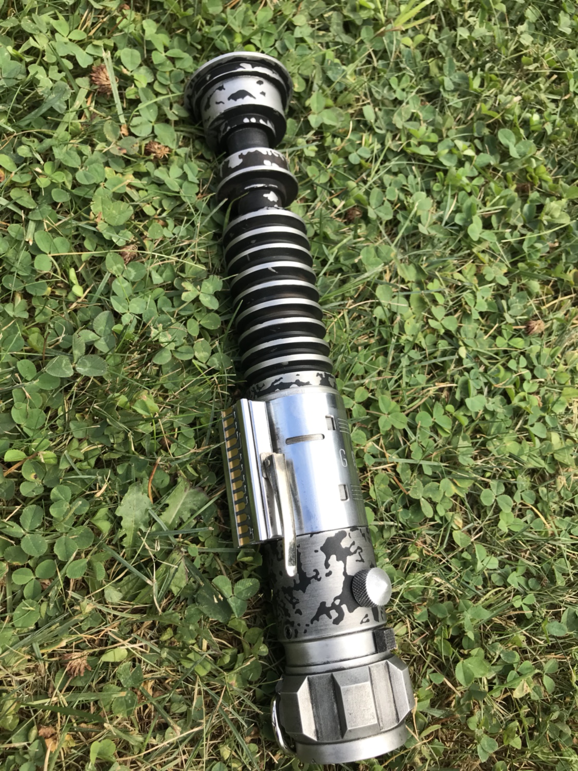

It’s kinda tricky at first, we’ll not really tricky it’s time consuming. Because you do baby steps taking pictures with the flash all the time
It’s very soft when looking at it with the human eye, but with a camera flash you can get it to look exactly like Brandon’s Facebook picture. The stuff works awesome

The top of the lever I weather lightly with sand paper and I mean very lightly, I then buff it with 0000 steel wool, then lightly tap it with a nail to make some chips/dings in the top area near the pin
I then blue it with super blue, I use very little because this sucker blues deep blue quick.
Take it down with steel wool, I also blue the underside
Then I rub it all down with Tamiya weathering product to get it in all the cracks.
You can see the top of the lever (near the pin) is a much deeper color in the pop culture quest video
Knock down the Tamiya with water to get the lever you want
I give a light spray of hair spray, Then I blow some grey and brown/red fullers earth on it and call it down ;)

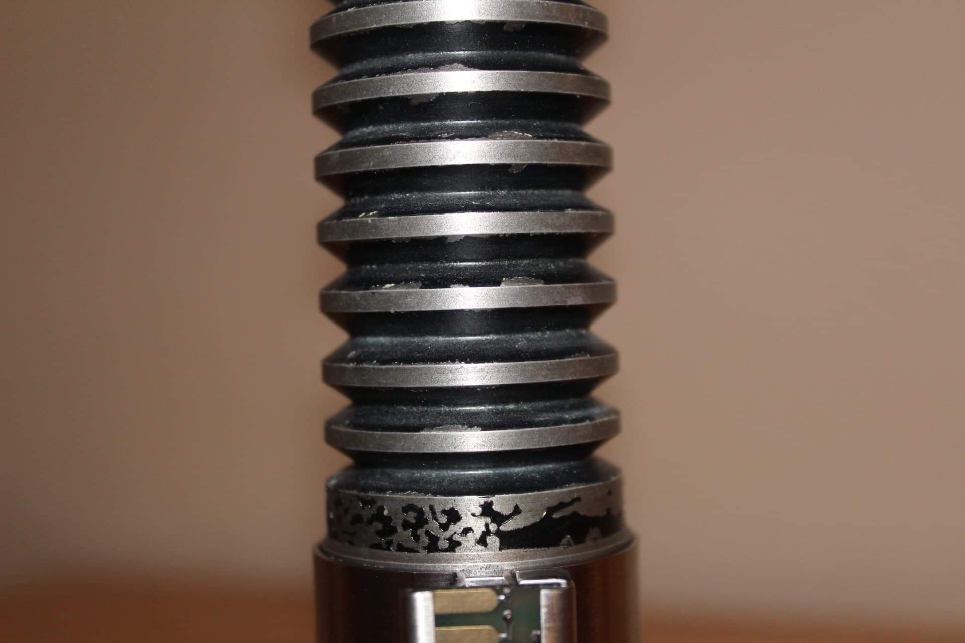

I've just realised I've totally overlooked paint chips on the underside of the emitter... Can't believe I've never not considered it and left it black, it came to light looking through the thread (it's a slow work day in the office and it's genuinely the only time I have to look through here as life is super busy with the kids). Are there any reference pictured for the V2 from the underside up or is it a 'go with your gut' kinda weathering? Though I'll certainly be using this pic of yours.
Yeah is there an officially collated stockpile of reference images?
Between the celebration 7 photos and the pop culture quest video we have a ton of reference
None of my chips I make are random, each one is from a reference photo. Even in the ring section, they are all suppose to be there
