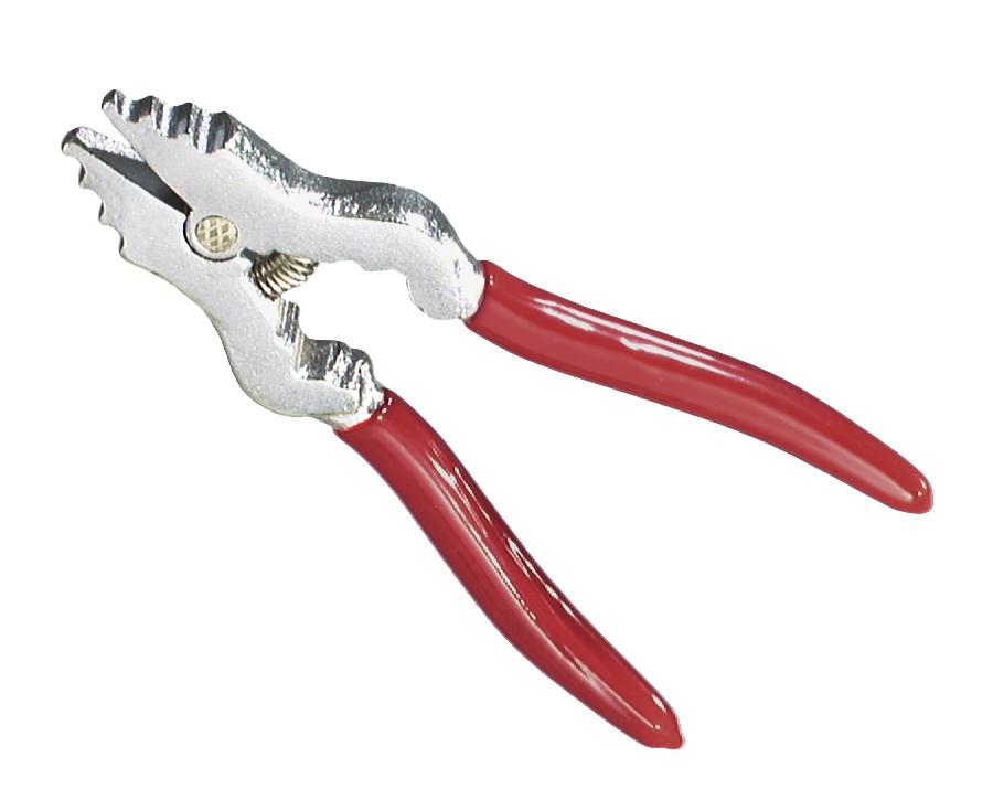

Another member shared the easiest way to do d-rings WITHOUT having to cut them or otherwise damage them: chain link pliers.
A HUGE improvement in the D-ring process.
I am installing flawless D-rings in under 10 minutes with these.
Good ol' link spreaders! I've used the heck out of mine at work. When I was working on Constantine (the TV show, not the movie) I put up so many hanging light fixtures I drove myself crazy.
No self respecting set dresser would be caught dead without his/her trusty link spreaders!
And yeah, they're great for D rings, too!
I should probably get myself a second set to keep at home for prop stuff.

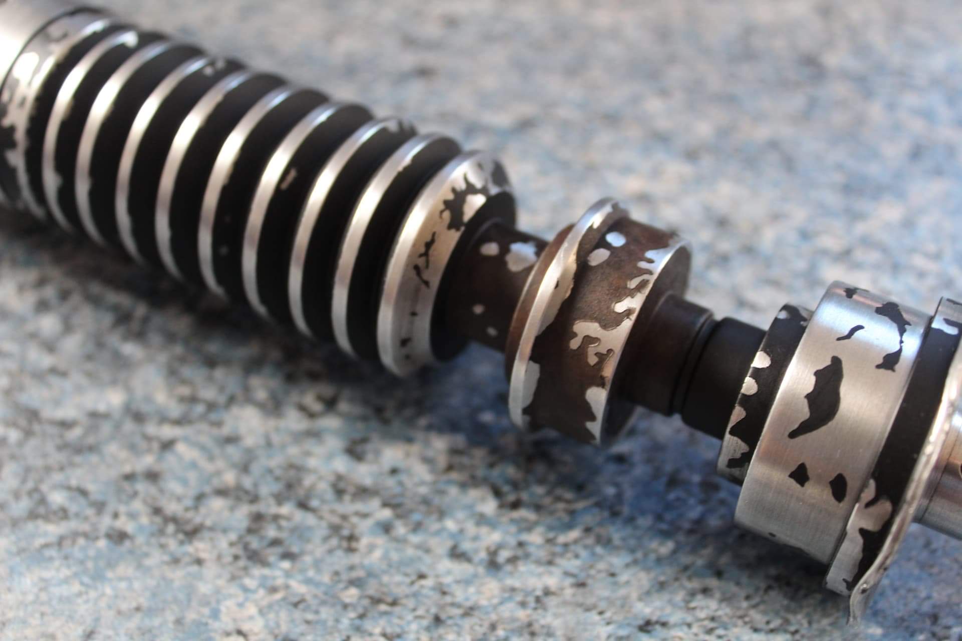

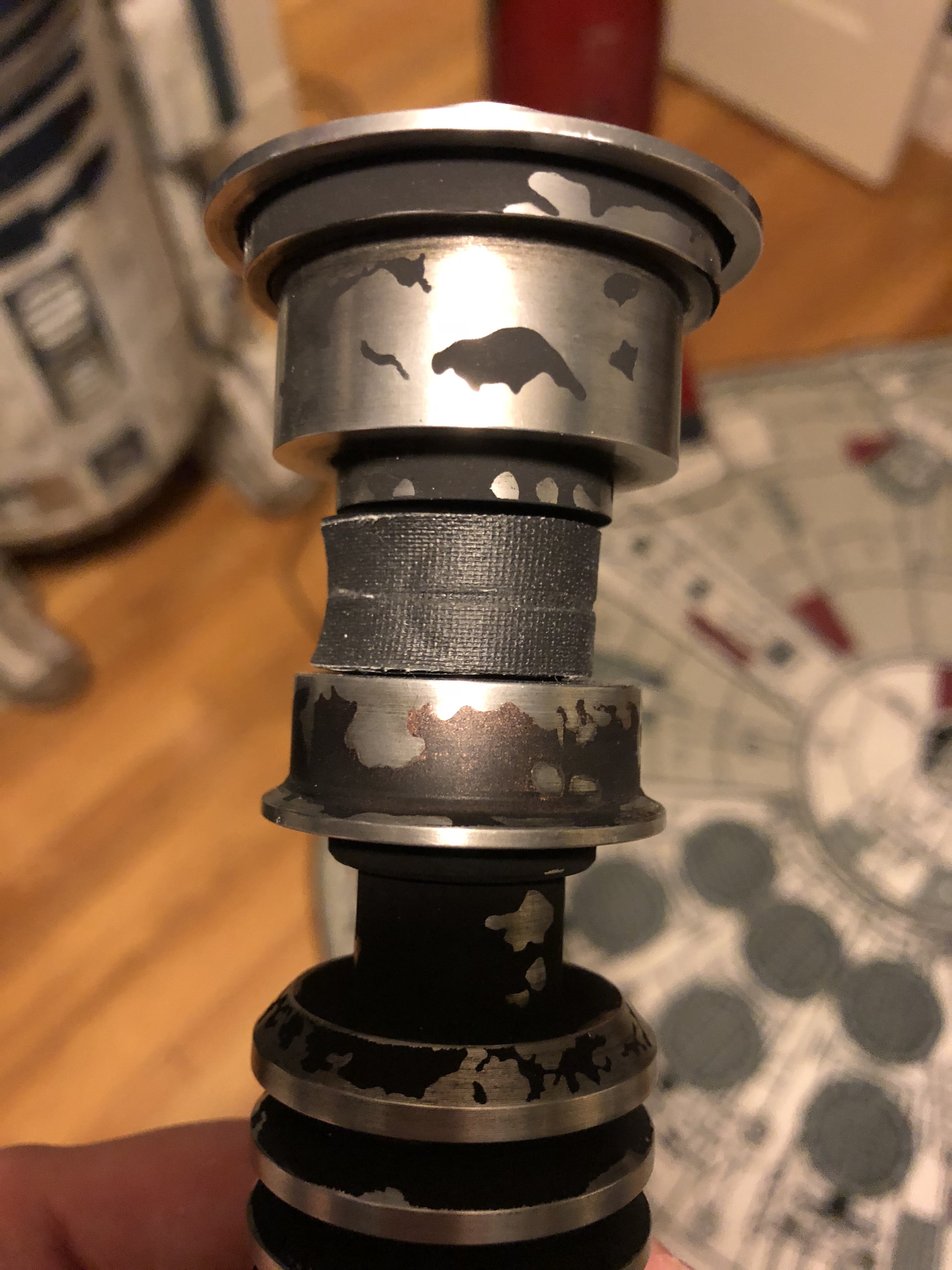

Finally finished my V2. Still waiting on my lever from Wannawanga, but I'm happy how it turned out, especially the neck. It looks black until the light hits it then it's got a copper sheen. Used Trents stencils and neck part for the gaffers tape, the A14 technique that Halliwax posted, Romans clamp and Slothcard circuit board.
The link pliers suggestion was a lifesaver; 2 minutes and it was installed with no problem.

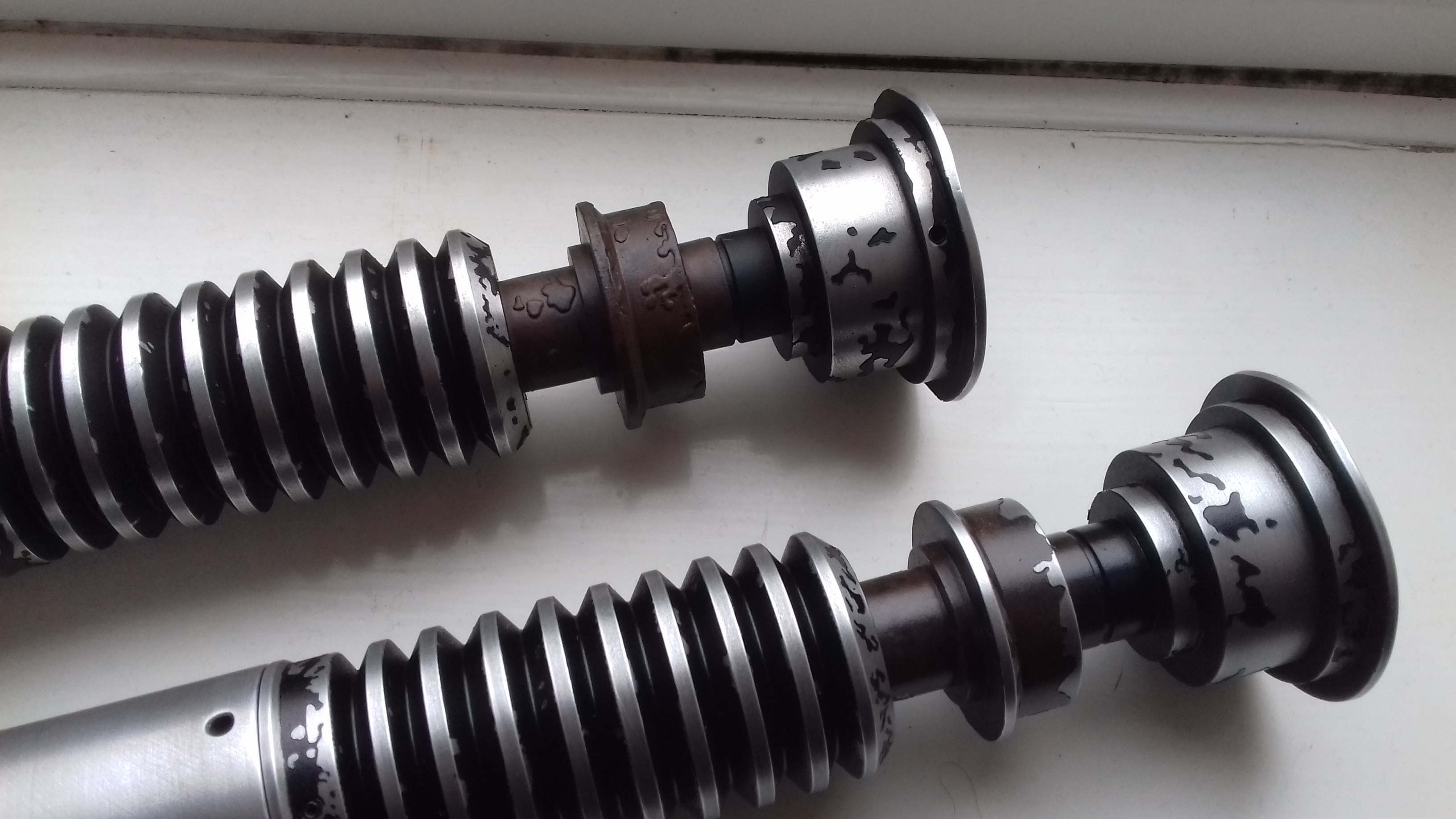

Thanks you again for this thread and your you tube videos. I never paint so actually seeing theach process is so helpful and really gives me confidence to have a go. UK based so don't have access to much rustoleum so bought some model kit brown enamels. The camera pics up the browns well but it's much more dark and subtle in person.
Post pictures, I like the different levels in the patina, it gives it a more realistic look, and even on the real prop it looks like there is different shading in the patina

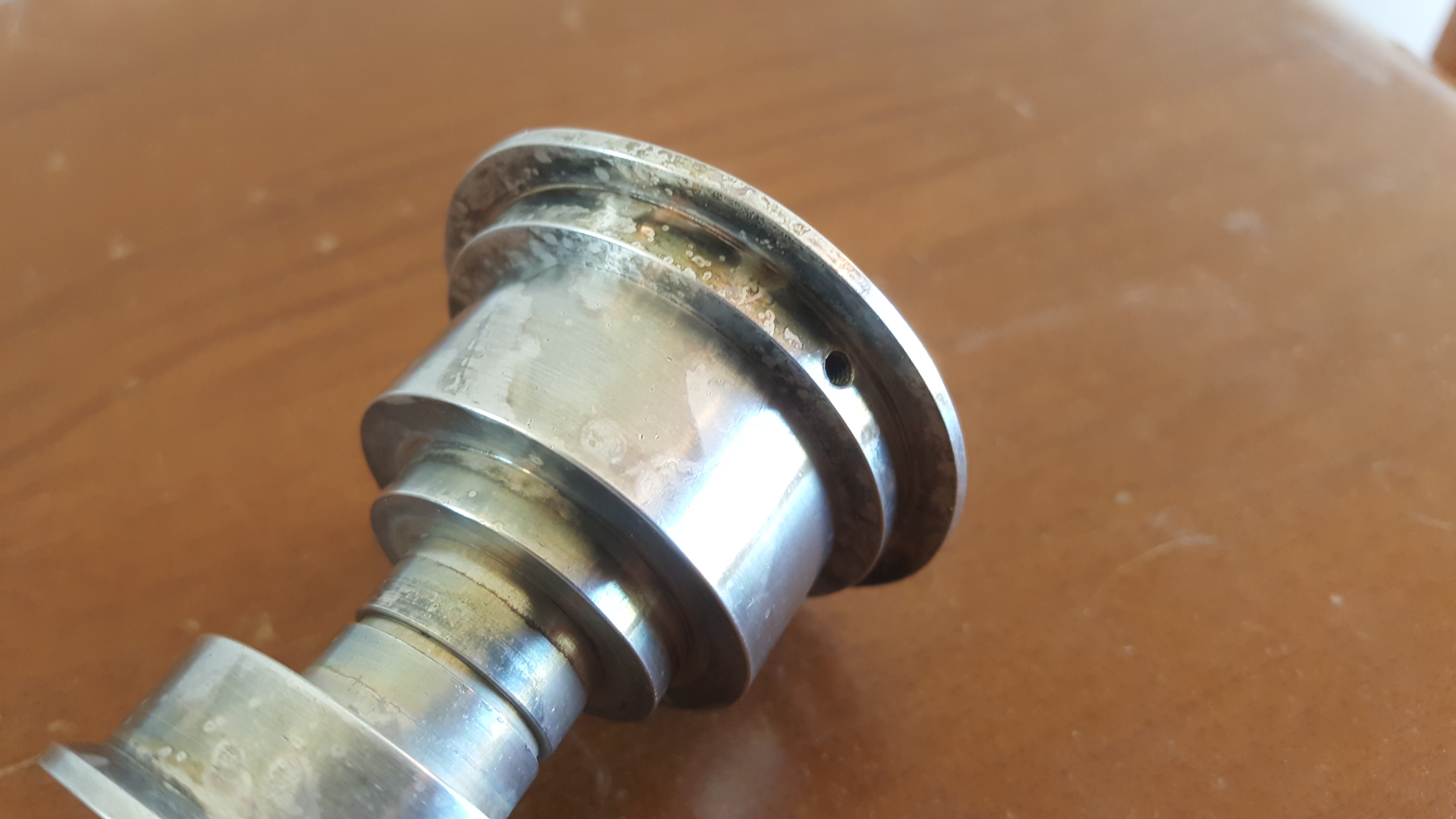

Silver lining, if someone wanted to do post-Mustafar duel Obi-Wan saber, this might be a cool technique.
Anyways I'm hoping to do a round two, and this time with distiled water, hopfully it will even out a little bit.
Oh man! I can tell you followed the instructions to the tee!! Really really nice out come!!

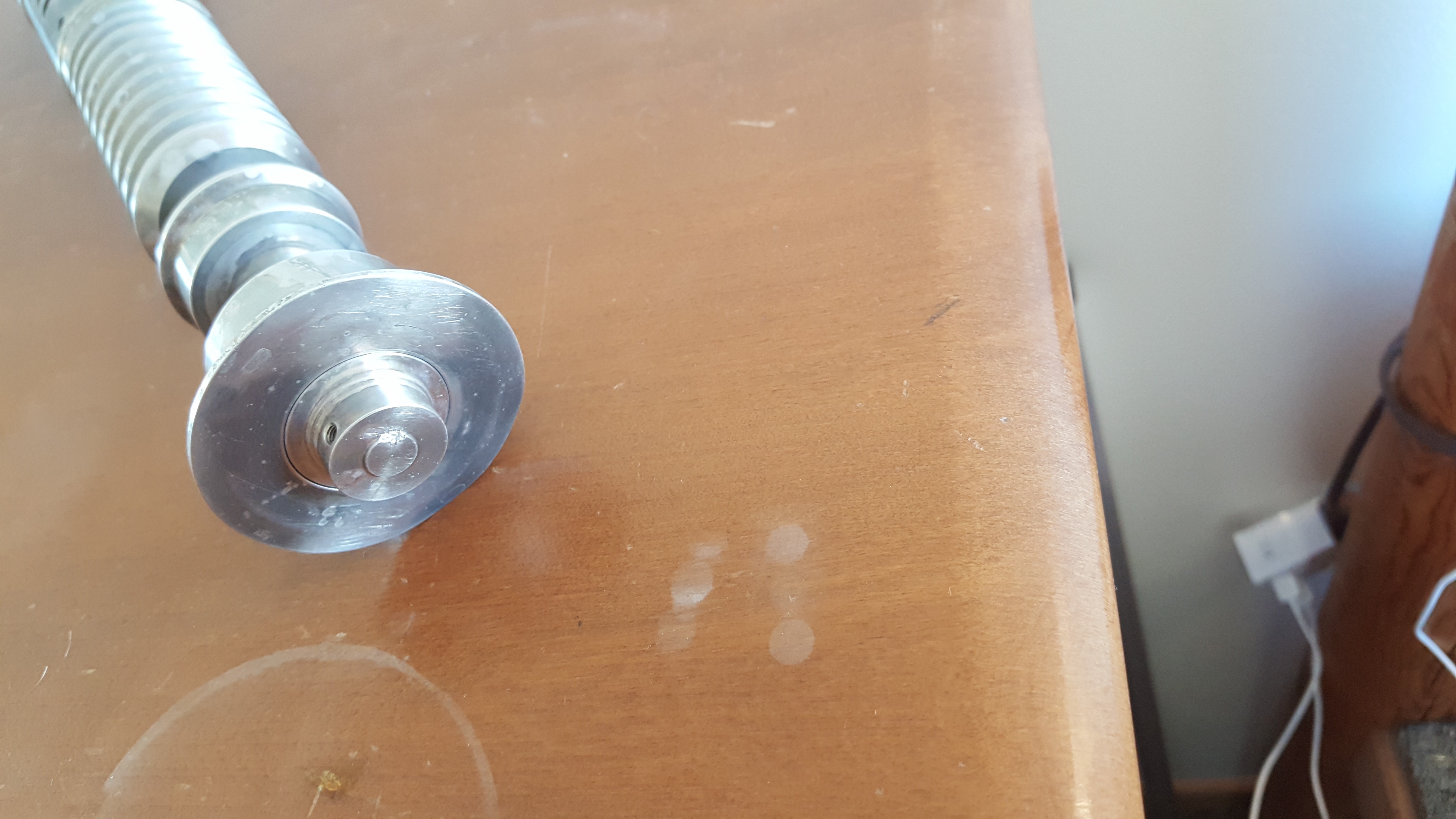

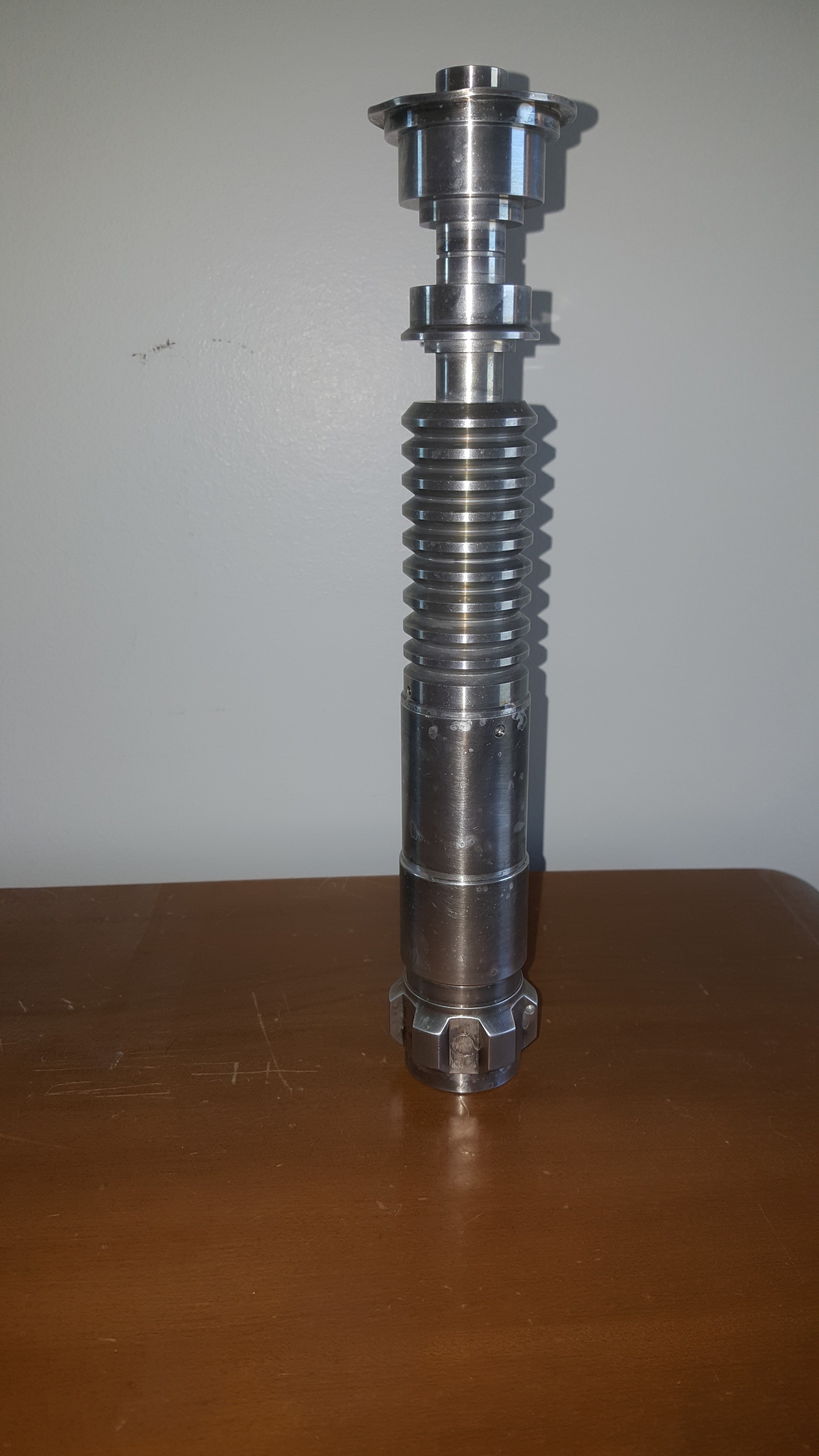

Finally got around to taking some pictures.
I present the calico V2 :lol

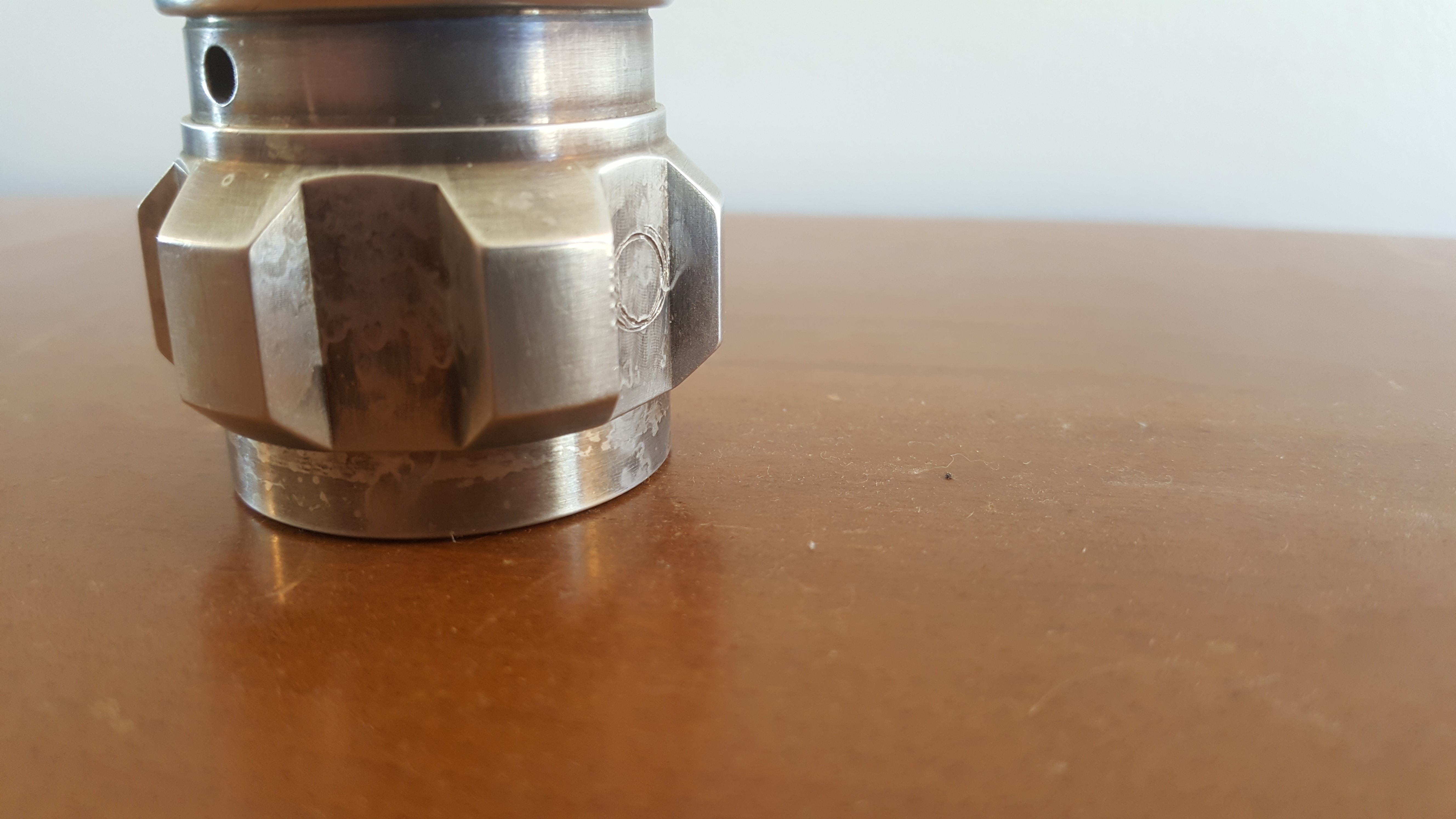

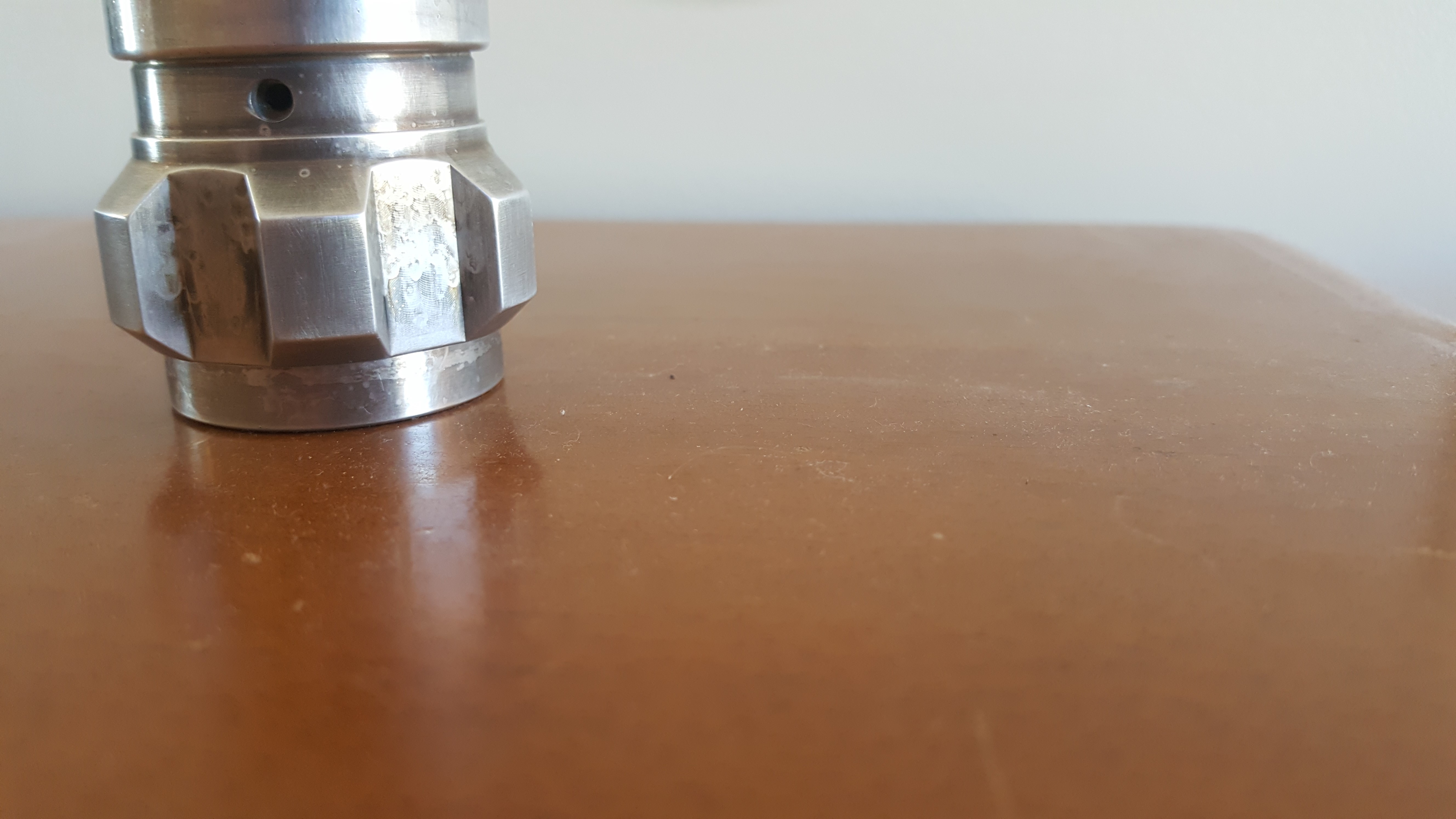

Have you tried taking steel wool and Scotch-Brite to it? Mine came out of the bleach looking like that too, but I was able to smooth it way down with about 45 minutes of work.
You can see some of it in this post. These pictures were taken after the steel wool, so you can't see a great before-and-after, but you can still see the splotches between the rings, and trust me, they were elsewhere too: https://www.therpf.com/showthread.php?t=293302&page=9&p=4524287&viewfull=1#post4524287
The bleach and steel wool method worked really well for me. The trick is building up depth with several treatments, and going slow and steady with the steel wool to keep the tonal difference subtle-yet-distinctive. I spent a dollar for a bottle of bleach, which can do wonders if one doesn’t want to go all-out with expensive A14.

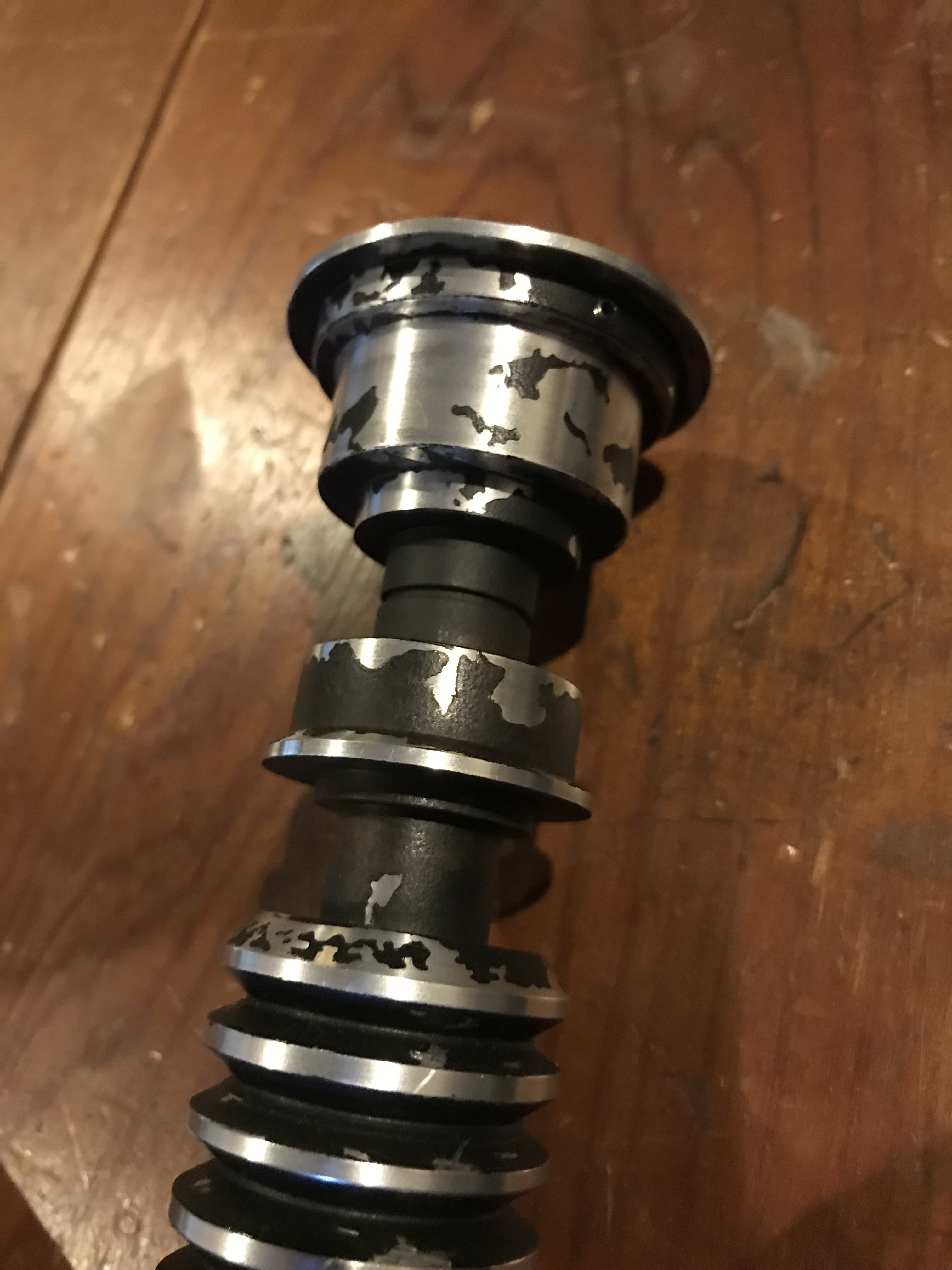

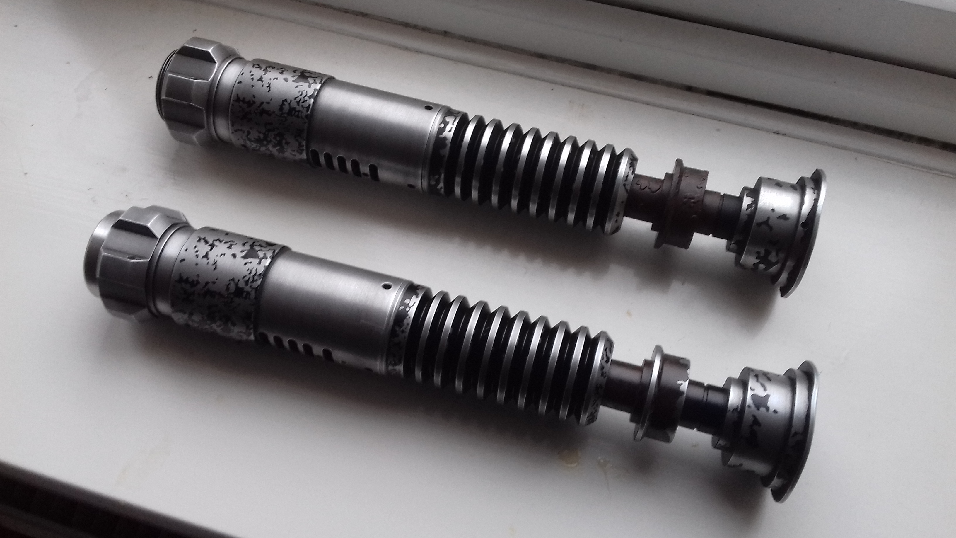

Working on kr sabers v2. Tried out satin lacquer which looks loads better on the pommel, not sure about the black paint, may make it look too shiny (bottom one has a bit of lacquer on). I found Matt made the aluminium look too flat.

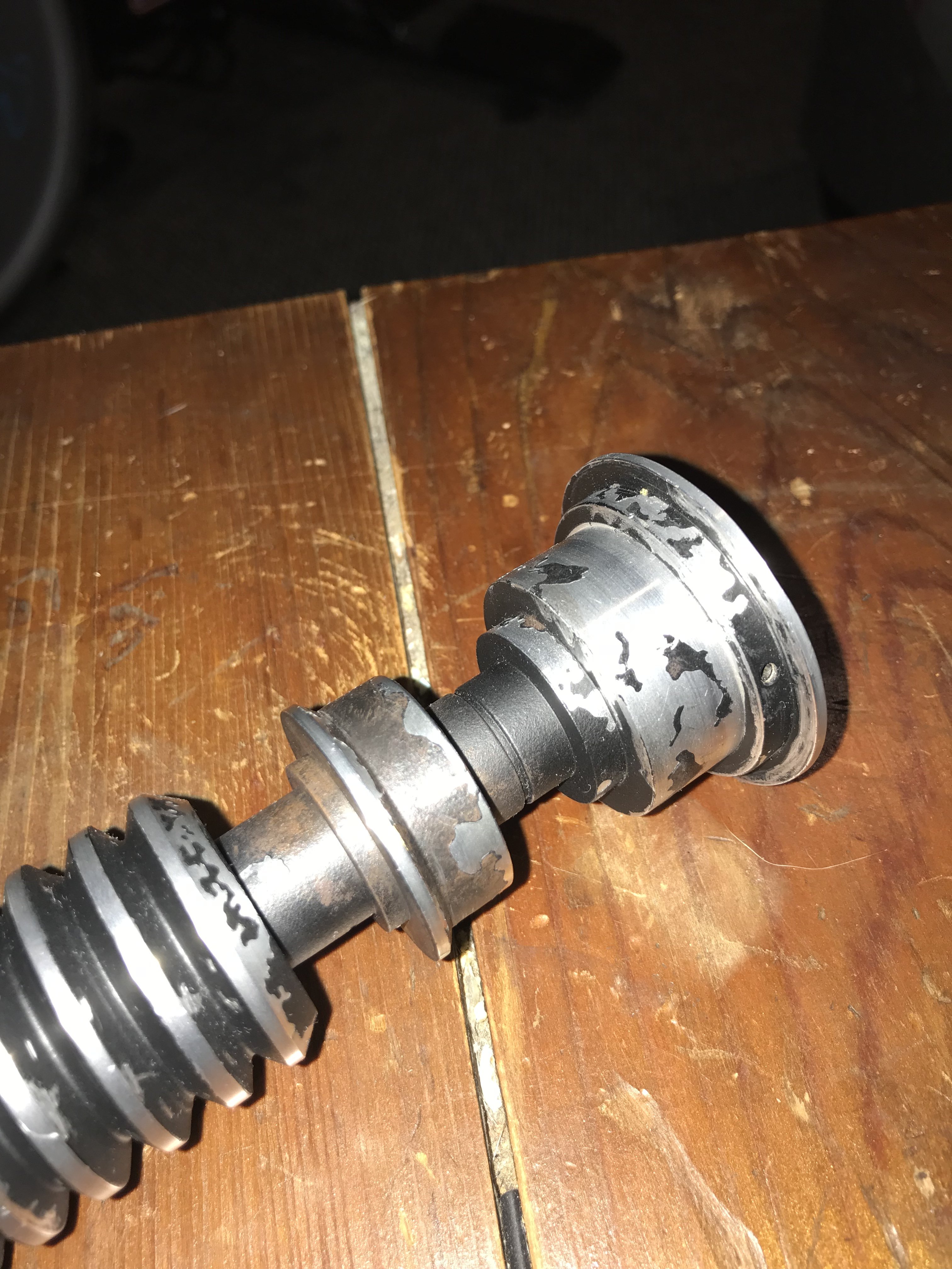

The windvane color is tricky, I usually do 3 days of fooling around with it. I do my initial setup like in the video I made
Let that dry over night, then take photos with the flash on
With the flash off you want it to almost look black, but it’s got a glossy finish to it
With the flash on you want that to look a reddish brown
Here I am fooling around with one
And here the same exact thing except flash off

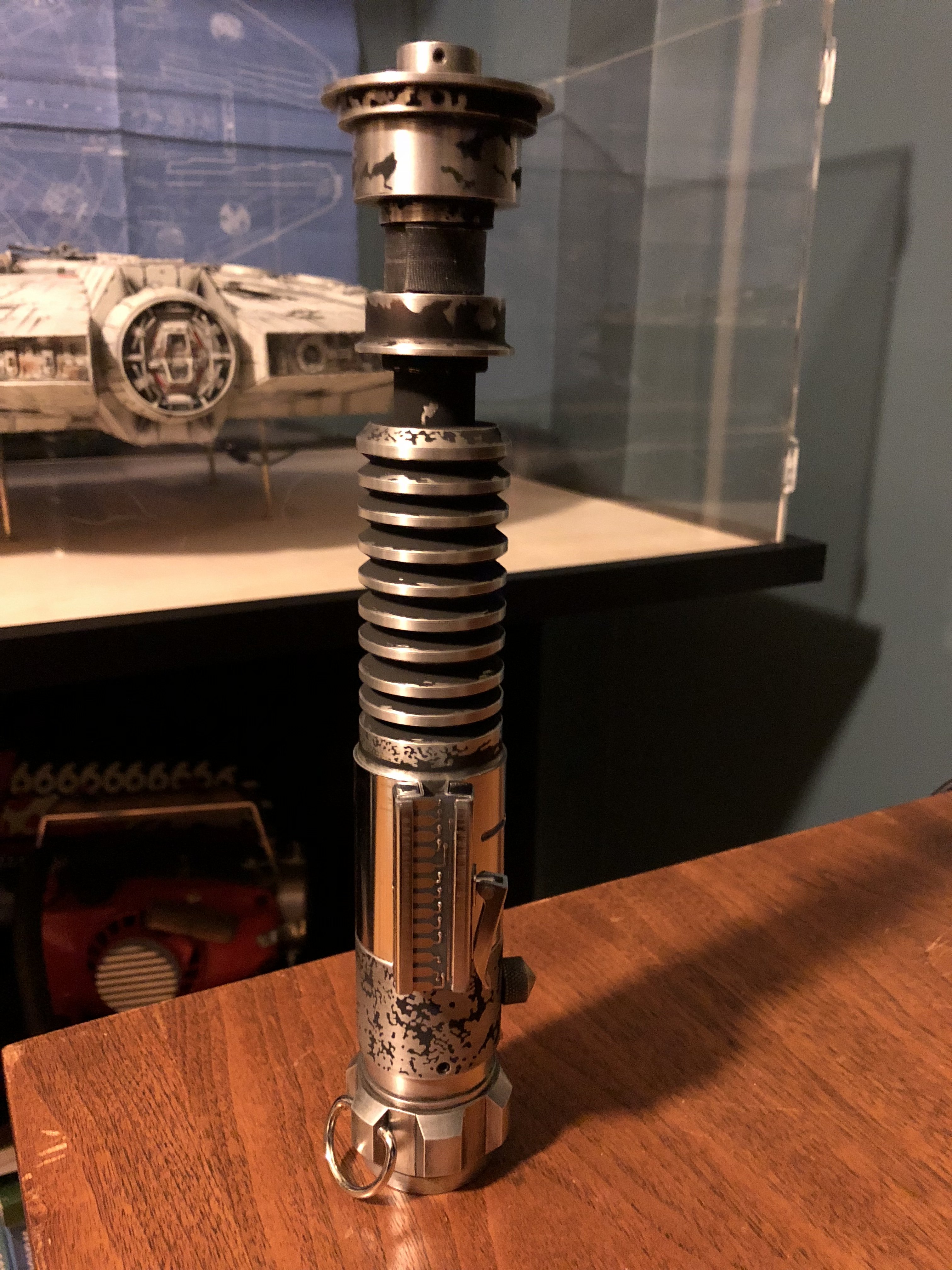

Ha, understood. I’m at that stage now- chemical treatment done, need to clean before stenciling. Been following the guide, very happy with the results thus far, don’t want to mess it up now. Just the info I was looking for. Thank you sir!
