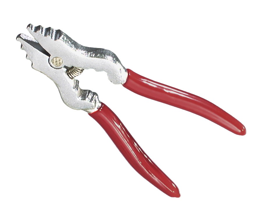

A bit late to the game; just started my V2 and wanted to see if there's some trick to getting the D-ring on. Tried prying it apart and squeezing it back together and ended up trashing one already.
Another member shared the easiest way to do d-rings WITHOUT having to cut them or otherwise damage them: chain link pliers.
A HUGE improvement in the D-ring process.
I am installing flawless D-rings in under 10 minutes with these.
Alley where did you purchase that, I can’t find them anywhere

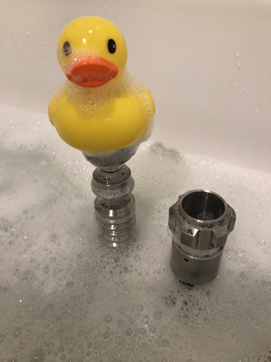

I initially tried BC aluminum black to crate some patina, but it was slow going. The dishwasher trick works MUCH better. Although, oddly, the booster section—of all things—seems to be having the most trouble darkening. I’ll have to give it a few more dishwasher treatments, then start fine-tuning the tones via buffing with Scotch Brite and 0000 steel wool.
Now, I’m just thinking about how to bring down the shine on Roman’s clamp to make it look less brand-new.

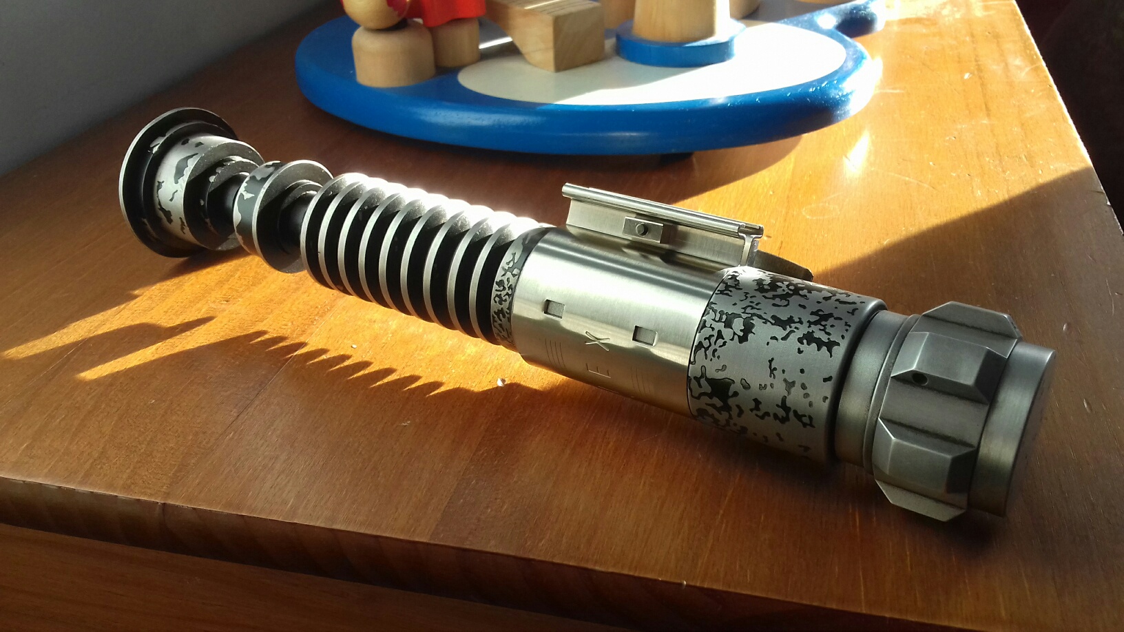

Post pictures, I like the different levels in the patina, it gives it a more realistic look, and even on the real prop it looks like there is different shading in the patina
I always heat the pieces with a hot air gun and then slosh the bc alum black on multiple times. Will turn it pitch black pretty quickly. A green scotchbrite pad will knock the black down to a good patina.
