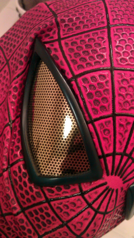

For anyone else struggling with Joelai's lenses. Here's what I did, and it worked like a charm. No need to reshape or recast.
If you don't want to use a full face-shell, just use a half shell. Like Joelai said, you can even use a store bought plastic mask and cut up in half. I used one of McLean's shells (which are beautiful).
Use a dremel or exacto to cut up a slightly larger eye socket by tracing the frames on the shell. It has to be slightly larger so the top portion sinks into the socket while the bottom rests on top of the shell like so:
The end result is a flawless countoured fit. The beauty of this is you don't have to keep readjusting the lenses for the right look. They will stay in place every time.

I have followed your thread closely and your work really inspired me to tackle this project. Thank you for the advise. Honestly that thought never crossed my mind. I would hate to have joelai009's lenses ripped off. Would you suggest I remove the previous post? Brilliant idea using only part of the face shell. I wish I would have thought of that!
To those asking for more pics of the lenses, I am going to refrain from posting them. I would hate to get banned from this awesome forum!
Upon further review the right lens is definitely higher. Unfortunately I think it is too late for this suit as I have already glued them to the mask. :( I was going to try some acetone to remove the glue but I am afraid of what it will do to the color of the print. I really need to get a custom mold of my head. It is way too difficult to put these on in a mirror. The mannequin head I have does not have the same contours as my face.

No need. As long as people are aware to not try to reproduce and sell the frames, its all good. Whoever ends up doing it, probably already is familiar with the process. I just didn't want you to get in trouble over somebody else doing something like that because they saw it here and thought it would be OK to do so.
As for the acetone, just use a little bit and tap the inside of the mask where the frames are glued to. Do it a couple of times. The fabric should be fine. If the glue has hardened way to much, use an exacto knife to help you out. Just be carefule not to rip the mask or go over the "safe-zone" for where the lenses end up covering the holes.

A guy I know who makes masks and sells them gave me this advice and it worked well. Make sure to glue the lenses first. This way the fabric has no way to rip further. Then after glued and set turn the mask inside out and snip out a little more than a quarter size or whatever your comfortable with. To make sure you place the lenses correctly you can do what i did and put the mask on and point to where your eyes are and have someone mark a small dot where both eyes are. Hope that helps.
