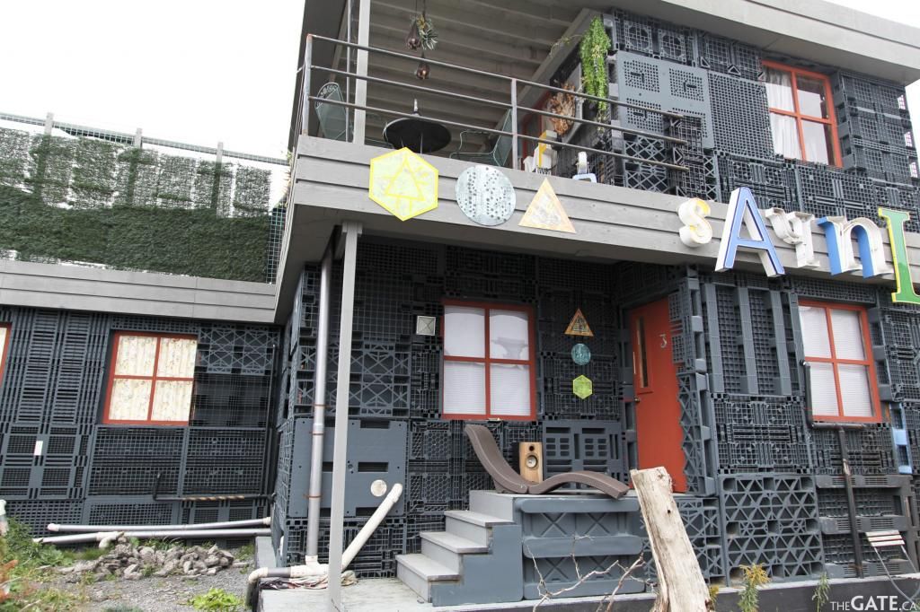

I am starting to feel the way you do....so much discussion , but we are never getting any results in cost effectiveness , so it may end up people ( LIKE ME )getting plastic pallets and making modifications to them , in order to obtain a close development ....been trying for years to locate one , but hoping one day....
Wouldn't happen to be any of these would it? (I saw this photo and thought of this thread... :D ) From Defiance.
Now that's different! :) HEY... are they just left of the window on the left side of the image? Maybe not...
