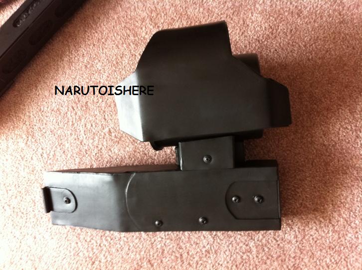

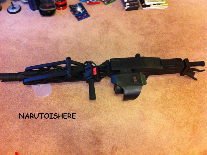

Originally I was preparing to make a Wolfenstein gun, but after seeing some guy made a quirky smart gun on youtube,
I decided to quick-build a similar version with $20 budget and any material that I could recycle during the past weekend.
I was going to stay home through the whole weekend watching world-cup, so the timing was perfect.
I didn't have those fancy tools like dremel or a well-equipped workshop with motorized sanding.
This time I documented every step with photos as I finished the whole thing within 2 days.
The foam "gun" turned out rather "ok", and I brought it to the Toronto RPF prop party on Saturday.
It would be better if I planned a bit carefully before I started. I forgot the most fundamental thing about construction -
center of gravity. It became too heavy on the drum side and the front handle could not support and it broke off,
even though the total weight was less 5 pounds.

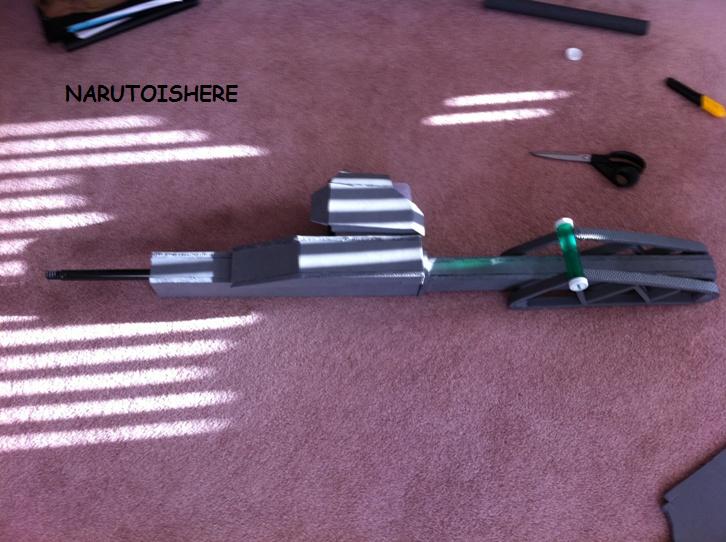

I improvised the size and made two rectangular tubes with foam which were long enough to fit a plastic bloomstick through
them as backbone and handle bar. The length was about right in comparsion with the pulse rifle. I then patched them with
craft foamie. Details were stripped down to minimal as I made reference with some photos that I have googled. The two
triangle racks were made with leftover sidetrim from the large foam sheets. For both handles, I used a pair of foam bicycle
handles bought at Dollarama. As with the brake, I made it with foam. The magazine drum was a DVD holder; I made the cover
with foam. The muzzle was cut from a calendar tube and covered with foamie. The front handle was the bottom of the bloomstick
and its support was a plastic center-stick cut off from the DVD holder. I added "fins" to the stick to make it look like
somekind of supports.
The cocking-handle was a paper-towel tube filled with paper-towel and wrapped with foamie and I placed plastic caps from
old medicine canisters on both end (and I had a lot of empty pill canisters that I had been keeping for the District 9 gun).
The ammo counter was the same one that I printed for my pulse rifle sometime ago; I just added one more digit to 395 instead
of 95. I brushed the entire thing with a coat of mod podge and I let it dry for 2 hours in the backyard (mod podge smells
quite pleasantly actually) before I spray-painted it to black. I bought most of the materials at Dollarama (a local dollar
shop), except the large foam sheets and spray paint that I bought them at Walmart next door. I don't shop at Michaels ever;
Michaels overprices everything.
From shopping to completion (including drying and painting), it took me a weekend to finish while watching world cup.
About foam sheet, I don't understand why people would need to use hot knife to cut. Foam is so easy to cut with a pair of
sharp scissors
