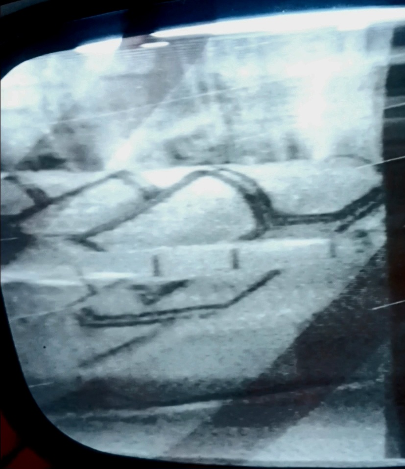

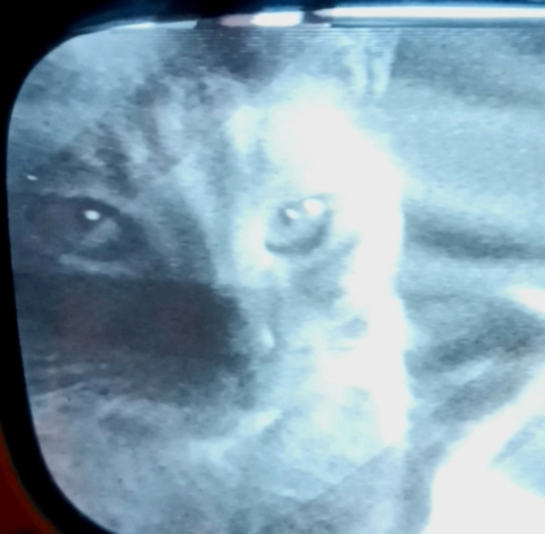

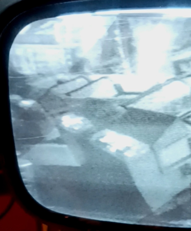

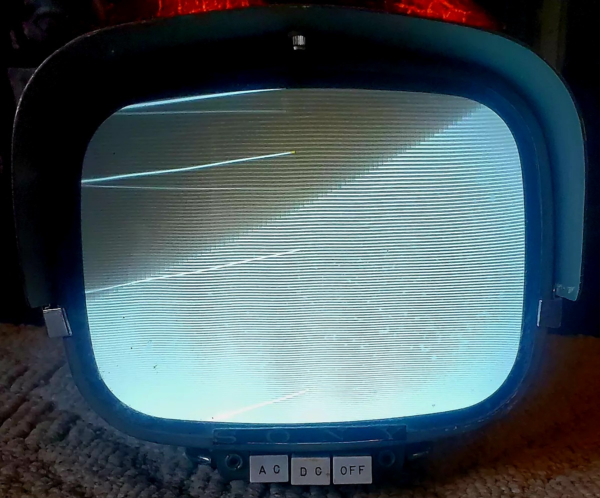

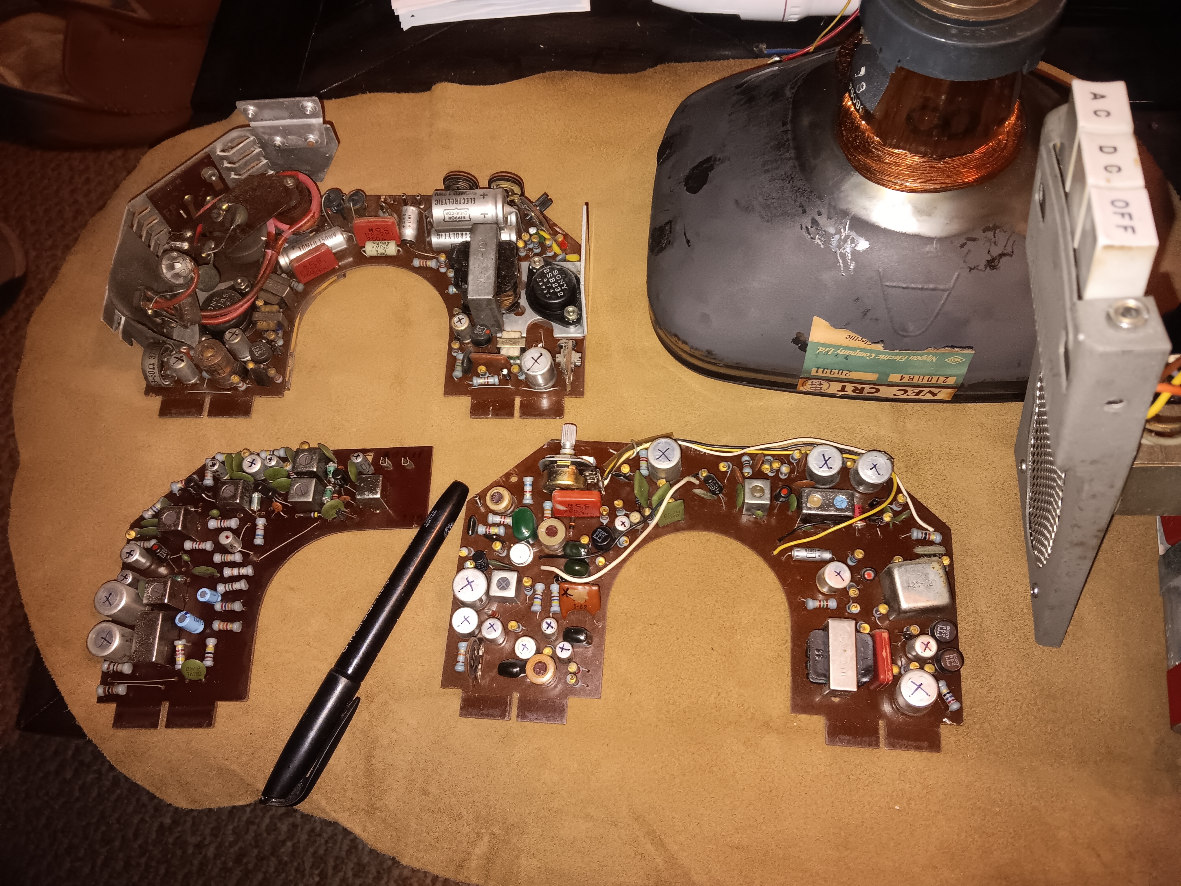

Well i kinda got a bit of overtime in and i managed to track down a additional 8-301w set so now ill be able to repair the initial one i got and the one thats coming in
But so far i gotta replace some power capacitors and horizontal control regulators cause the image was very spotty at times

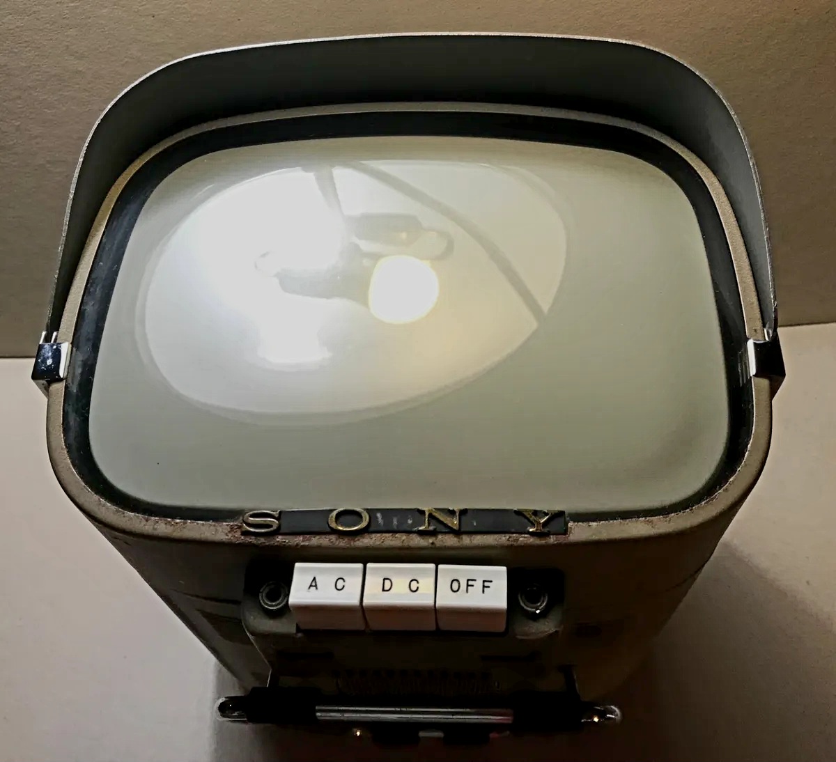

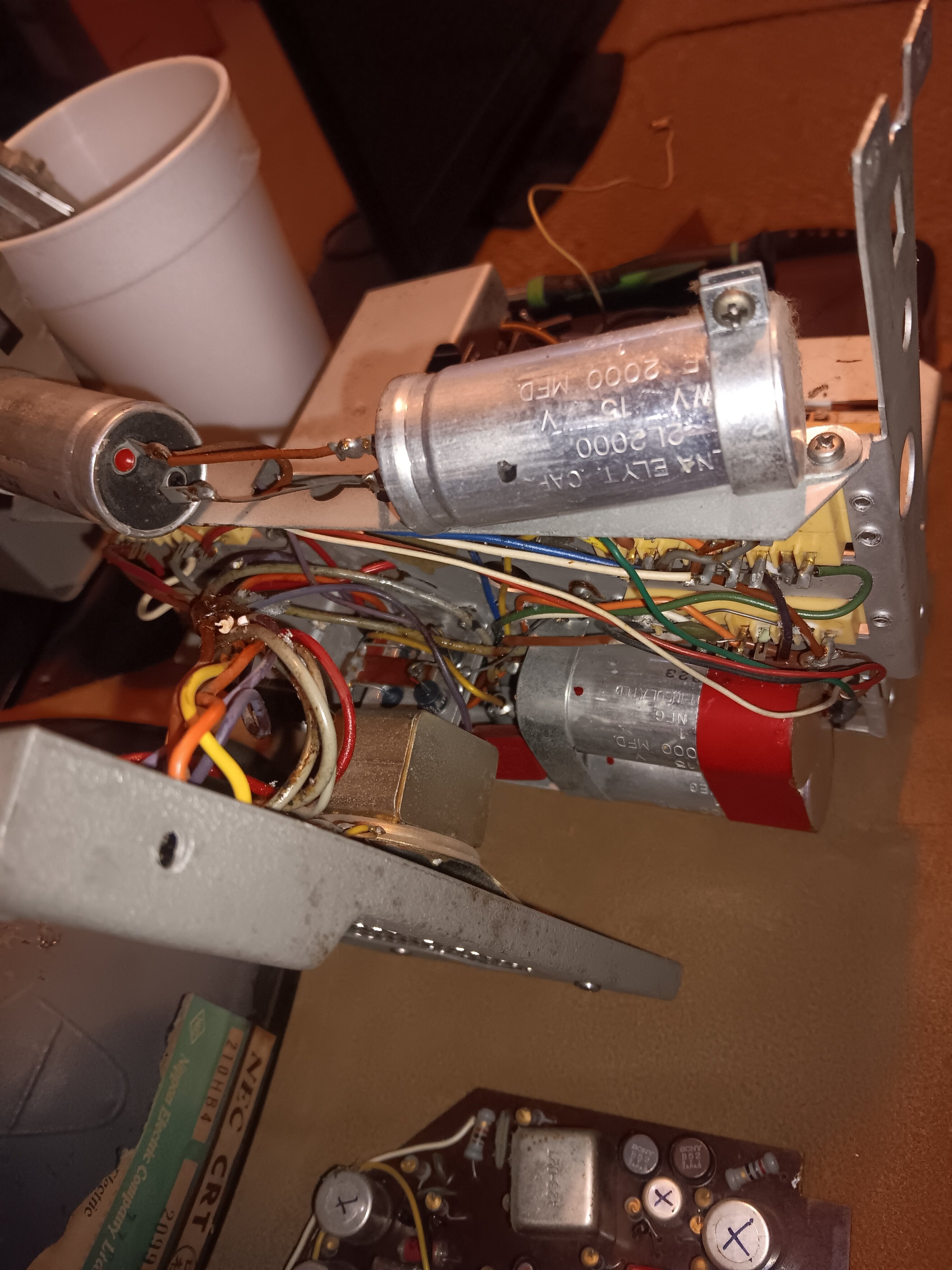

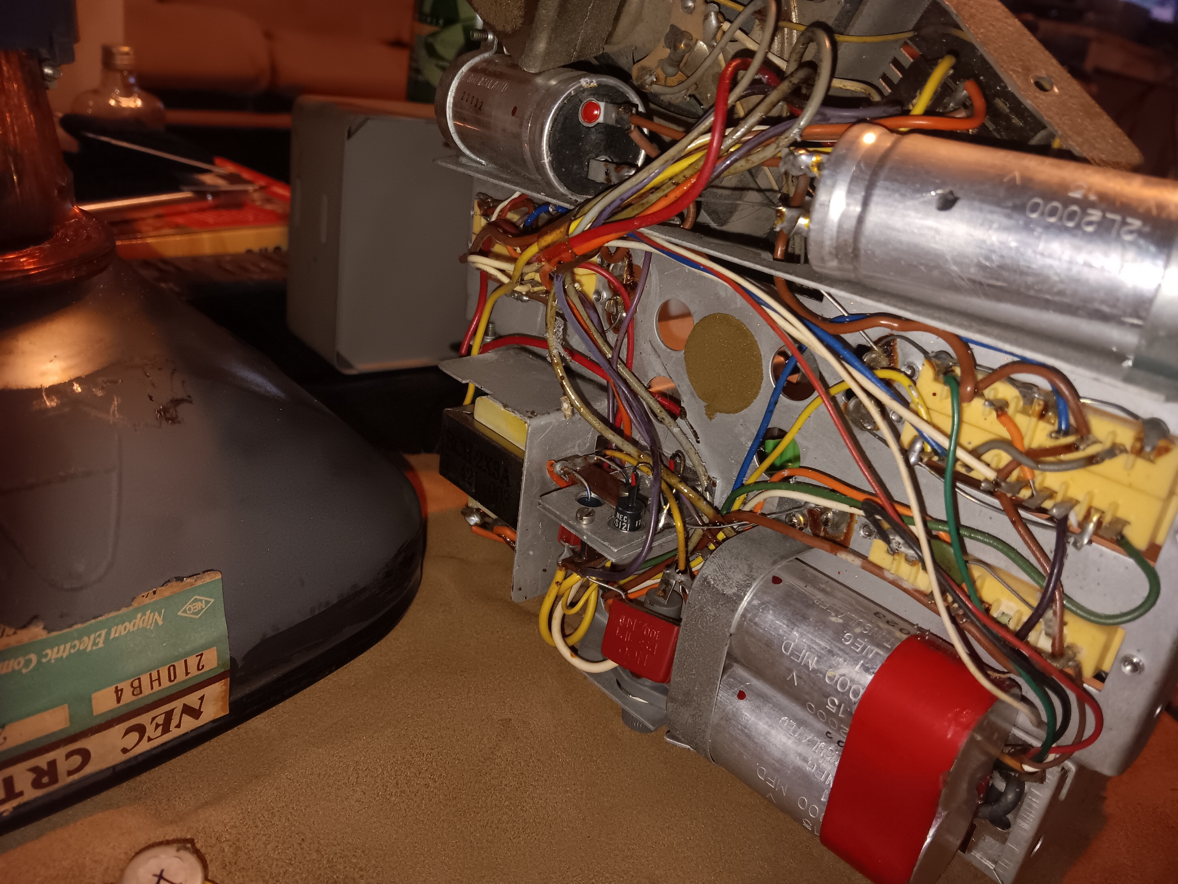

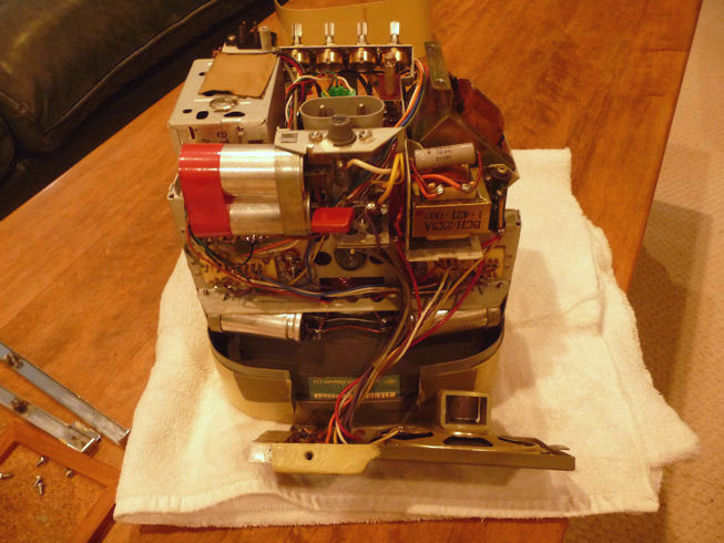

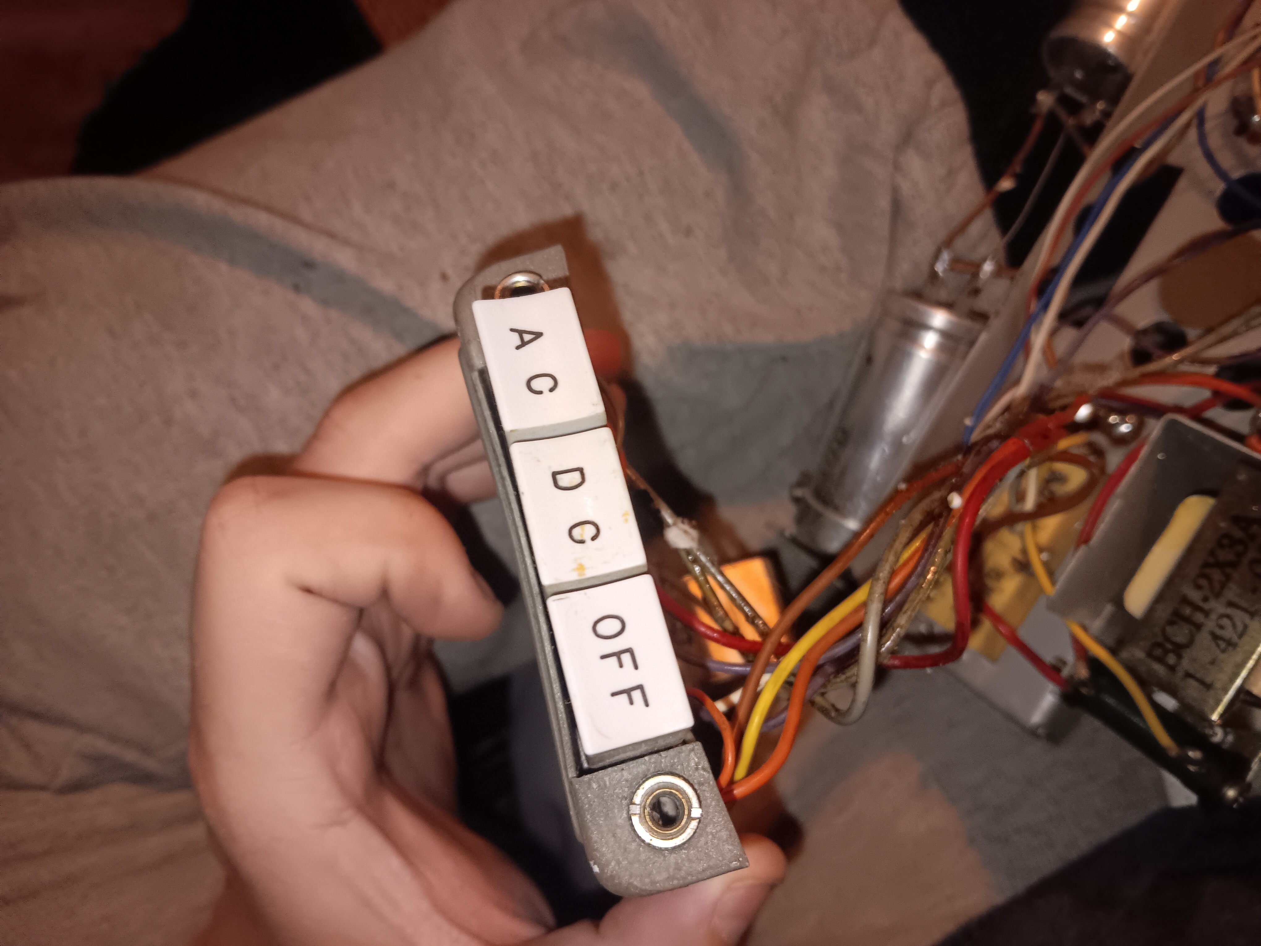

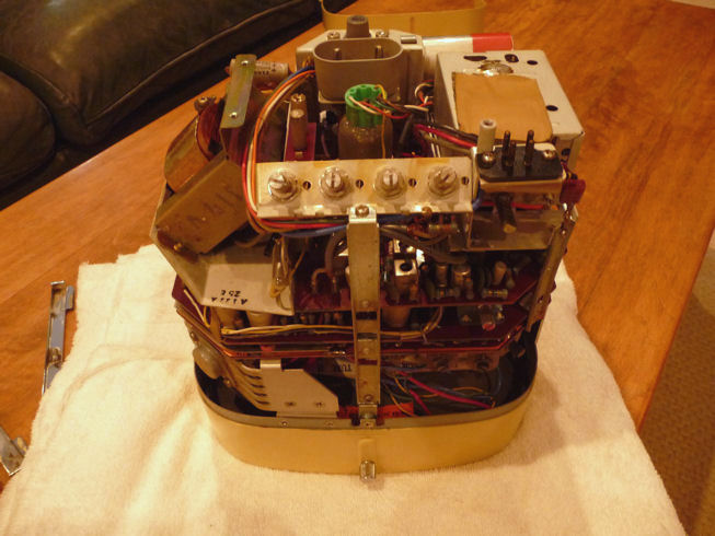

Well finally had a chance to get the 8-301w apart and look inside
Seems they liked modular designs for these and on the back of the screen ill need to apply a few coats of "Slip Plate graphite" spray as the aerodag has flaked off 90% of the tube (simple fix)
Aside from that its replacing pretty much every electrolytic cap and foil/oil caps
Transistors are a secondary as i dont believe any have failed but anything could happen
Also the set is flat out filthy and will need thorough cleaning (and some paint weathering once i have a chancetorepaint it)

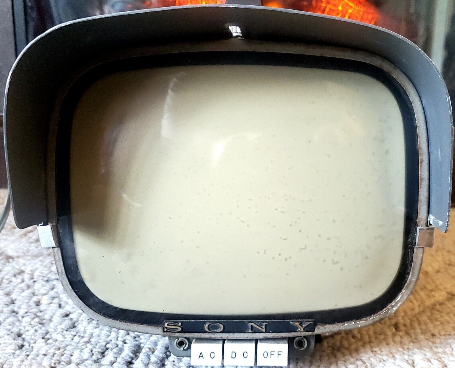

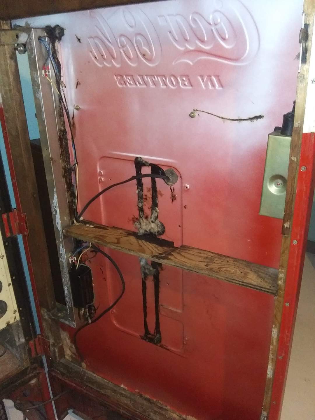

Well im going to be making 2 posts here soon as a follow-up for not posting anything for a while
So first off i did get a second 8-301w set and it had a very fun surprise (STILL NEEDS REPAIRS!!!) otherwise itll self terminate from cap leakage and corrosion
But still after nearly 64 years its good to see it withstood the test of time

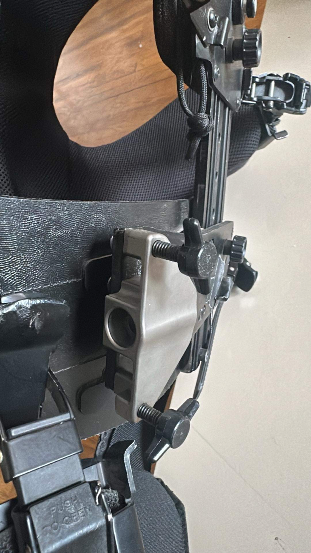

As for my second post this is a update on the metal situation for the AR-125 brackets for the smartgun (and a possible flash hider as well if i can find a good machine shop)

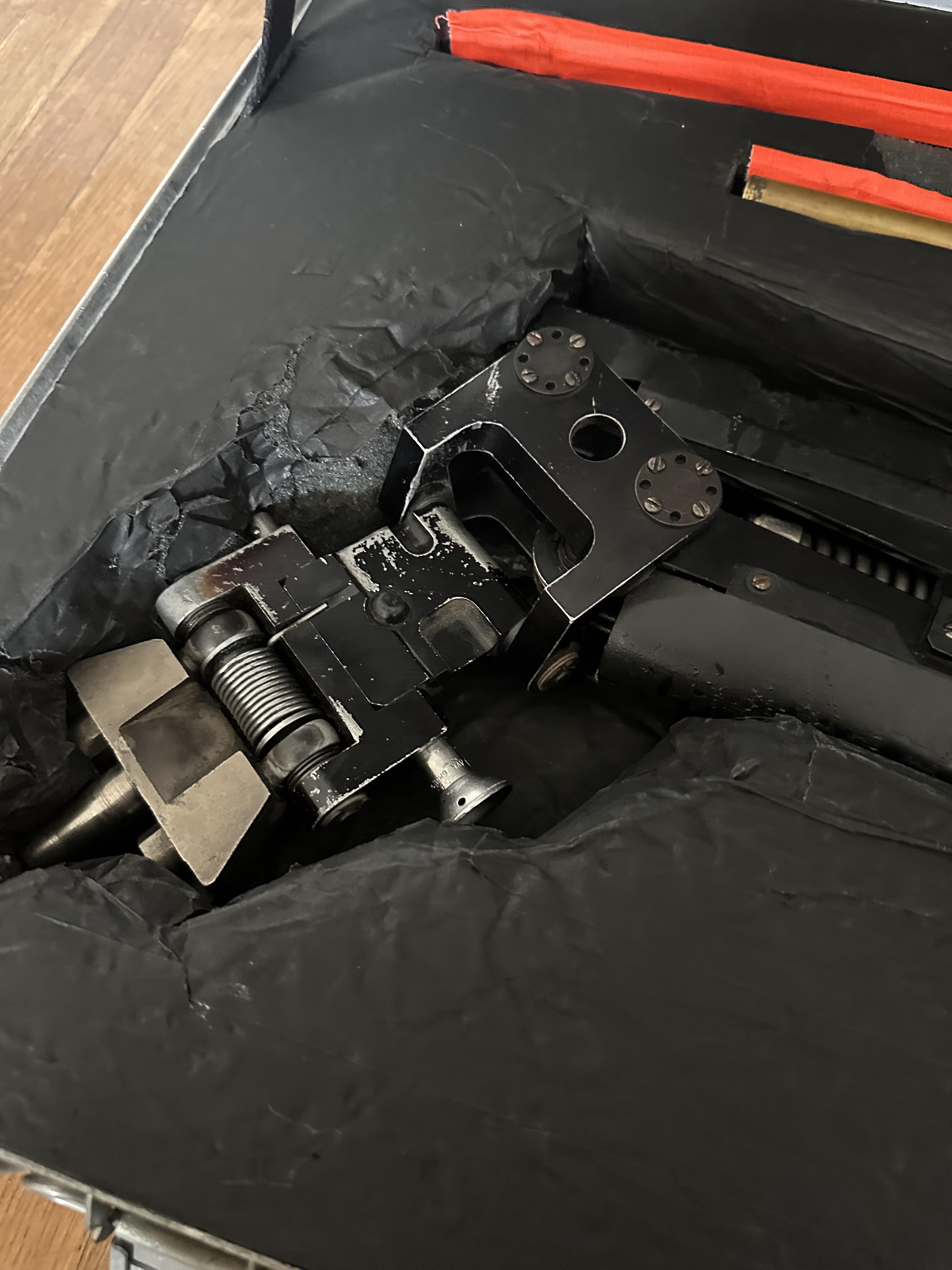

And some updates on the MG42:
So the MG42 is going to come in a little later than expected but thats due to one buying these tv sets and 2 because im currently in transition to a new job location (not a new job but a transfer) and it will pay more but its taking a long time to transfer due to....*ahem* "managers not giving a F about employees"
And the fact that one of our managers got fired due to being rude to a DOD agent didn't help either (ok im done rambling)
But the MG42 is in fact not ww2 stock but instead its a MG42/59 and its a little different but not by much (and yes its still gonna be full auto fun)
It looks very good for its age for sure:cool::cool:(y)(y)

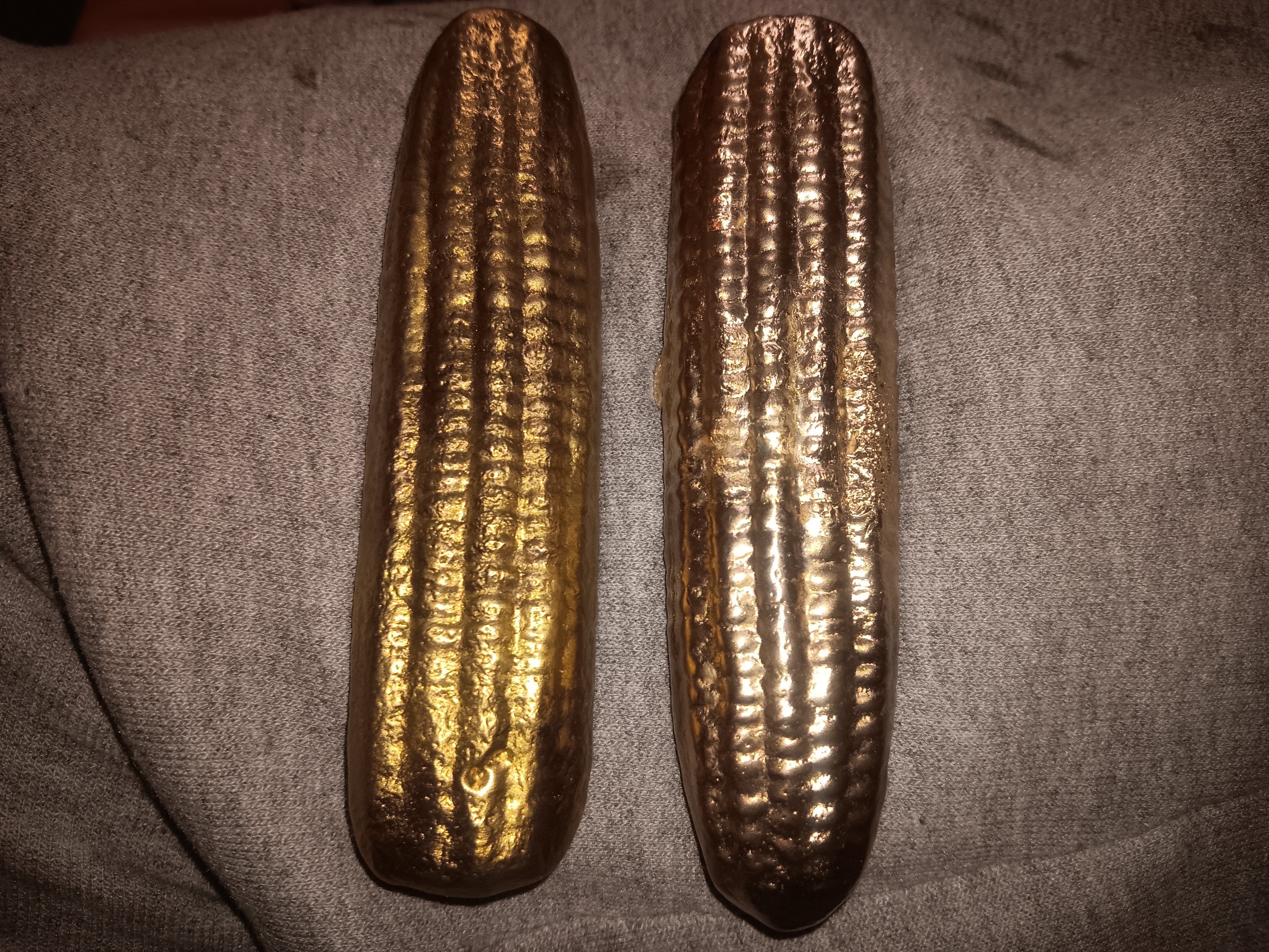

Well the brass (left) and aluminium bronze (right) appear to be casting quite well
For those who dont know theres aluminum bronze which is pretty tough and easy to mix, also a lighter shade
Then theres regular bronze which has a more brass like appearance but is also darker slightly but ages with a nice patina
Aluminum bronze i would love to mix more but this is purely for a test casting using some tin mixed aluminum (amalgam) and it made some very good results
Weight is a little lighter than i thought and i wanna say for those wanting a more unique set of components to your smartgun i feel i can deliver it once i can get some custom molds mixed up for recasting (prefer to try getting a set of molds machined out for quicker pours)
But as for using more exotic metals i believe i can put out a set of silver brackets every once in a while should one want to be a bit more exotic with their components but shouldn't come as a surprise the more exotic the metal the more the price will be

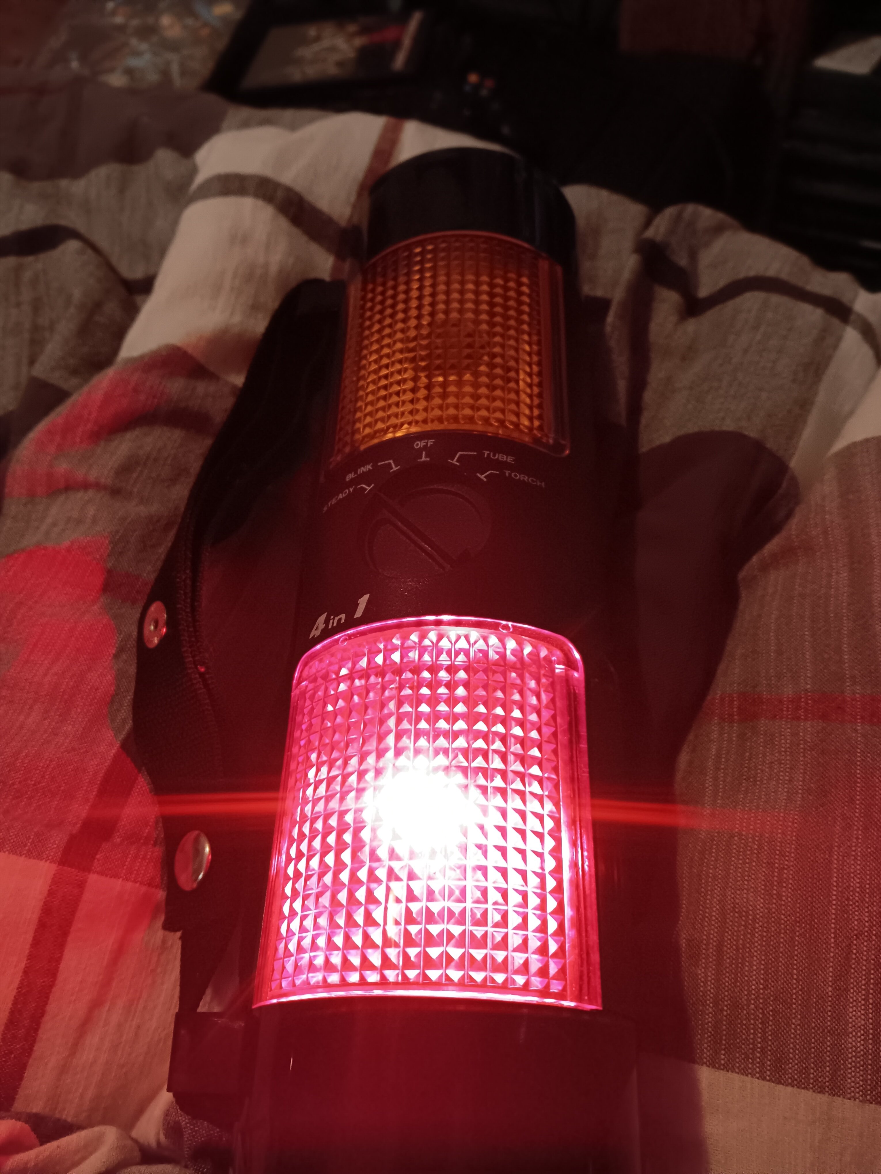

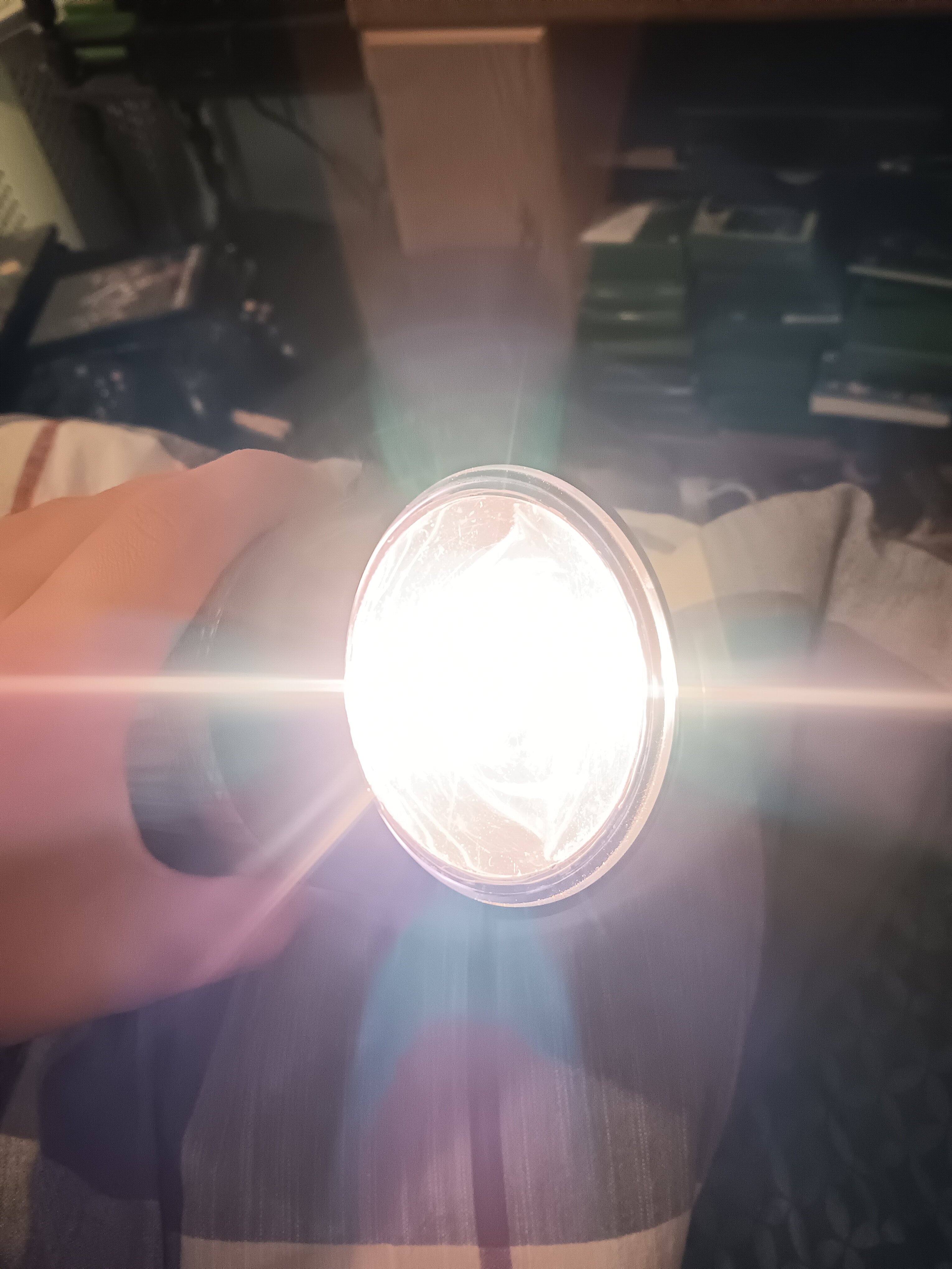

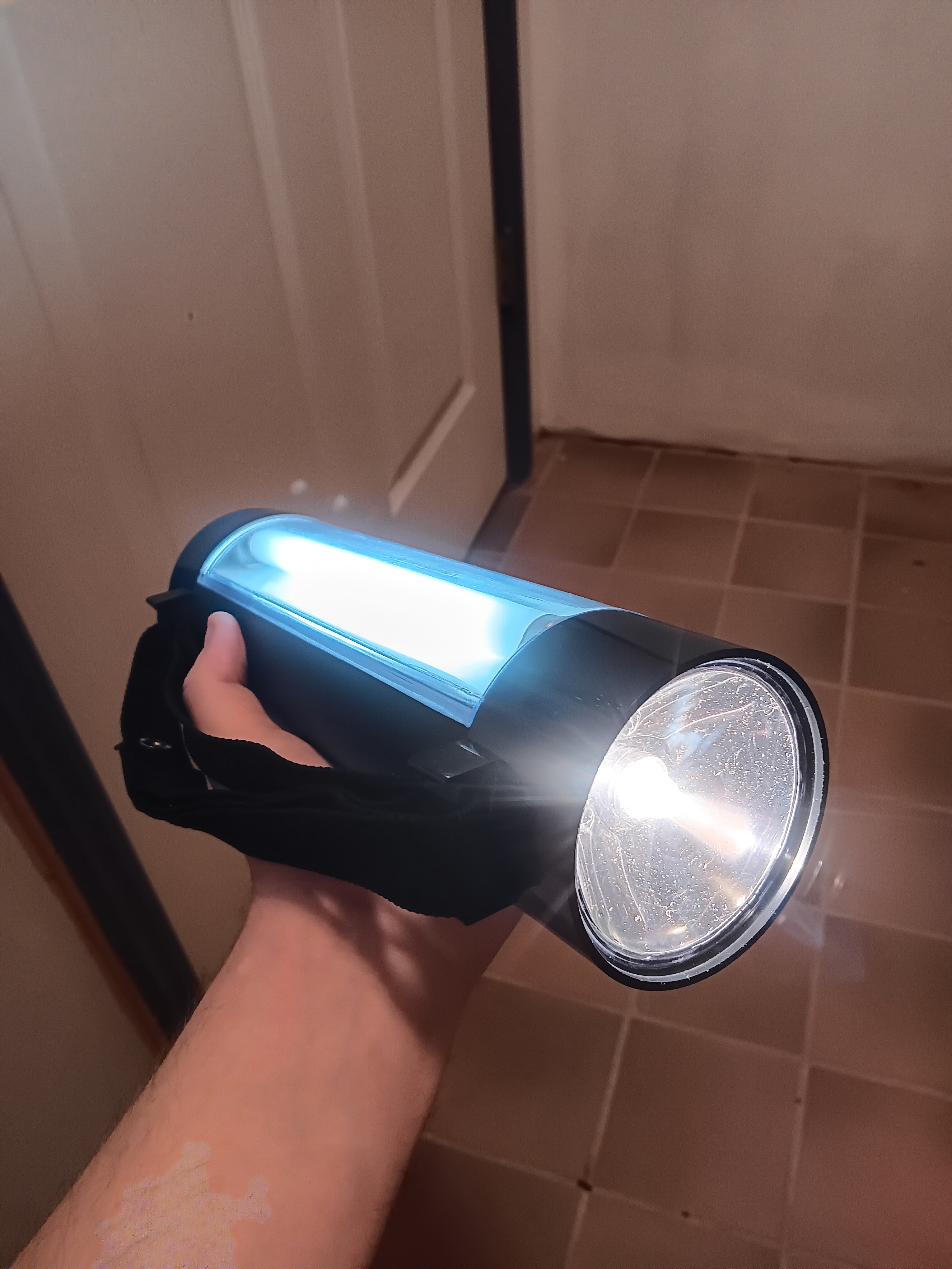

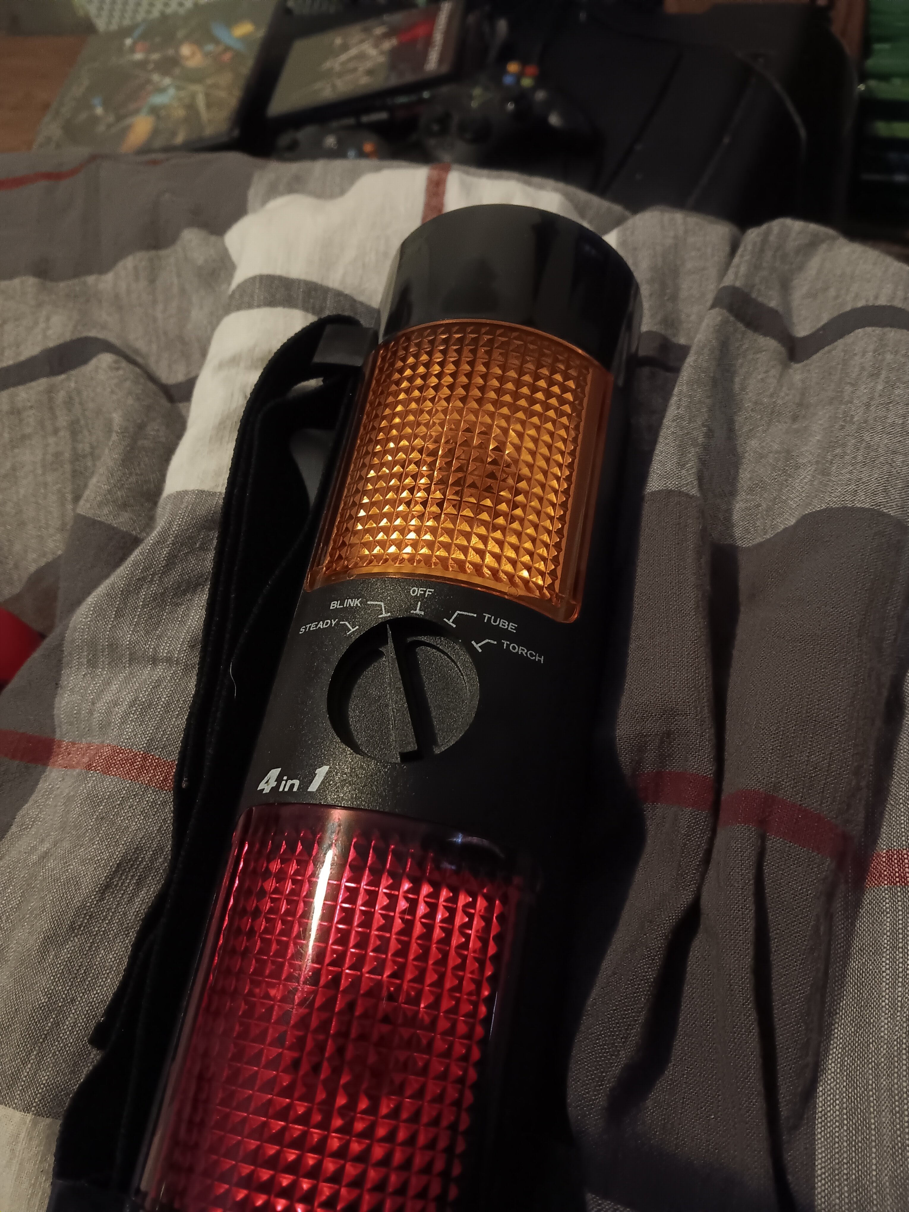

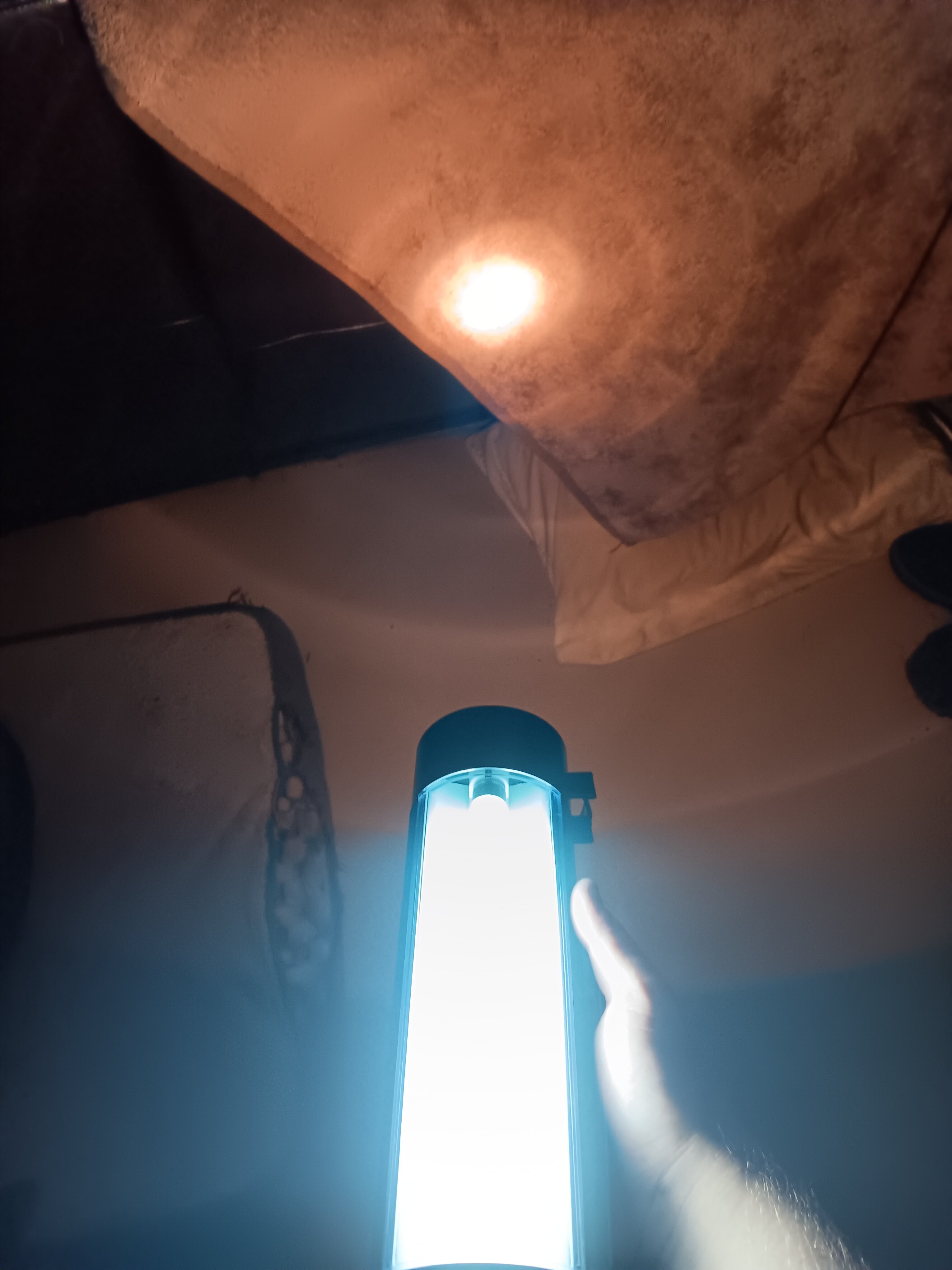

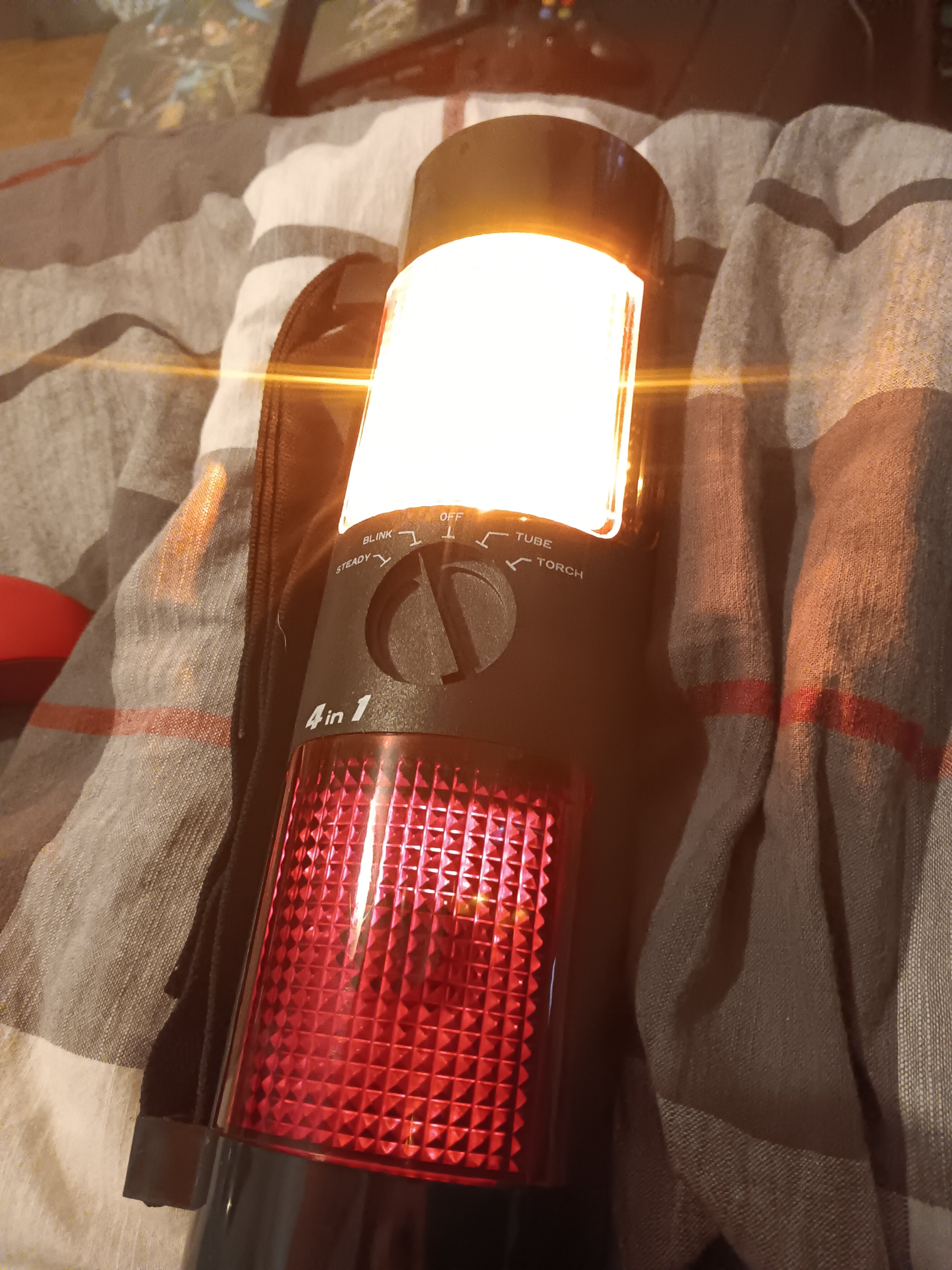

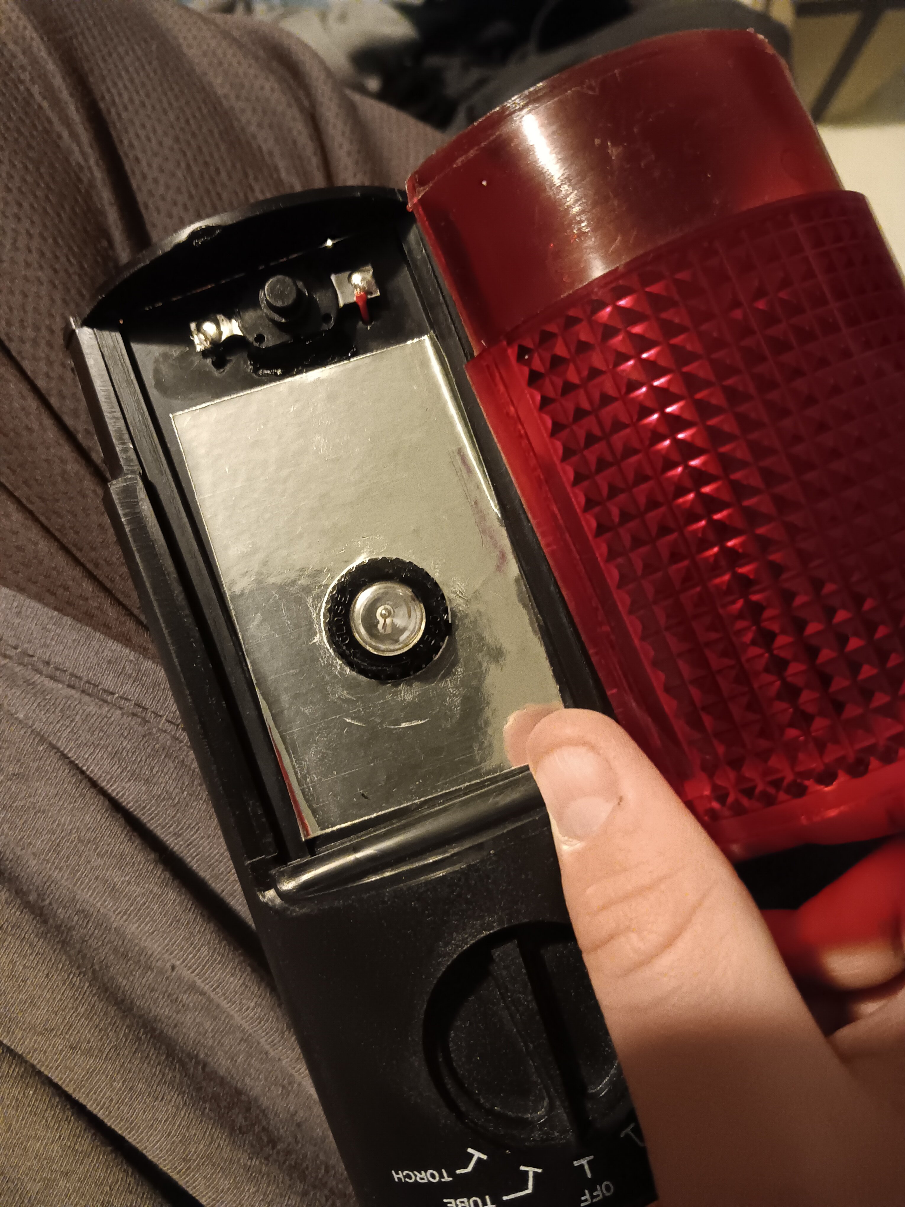

Well finally managed to find one of these 4 in one lamps (the mg42 is currently underway and will be in by late next month and im excited about it because ive been waiting nearly half a year to get it)
I might swap the switch out for a different one later but so far it works perfectly, also the wiring was super simple and almost no modifications were needed. There are rumors that these are painted brown bess but i feel if i was to repaint them that id have to leave the switch place untouched as it wouldn't make sense for a military item not to have any labels on it unless it was a destructive device (like a grenade or claymore)

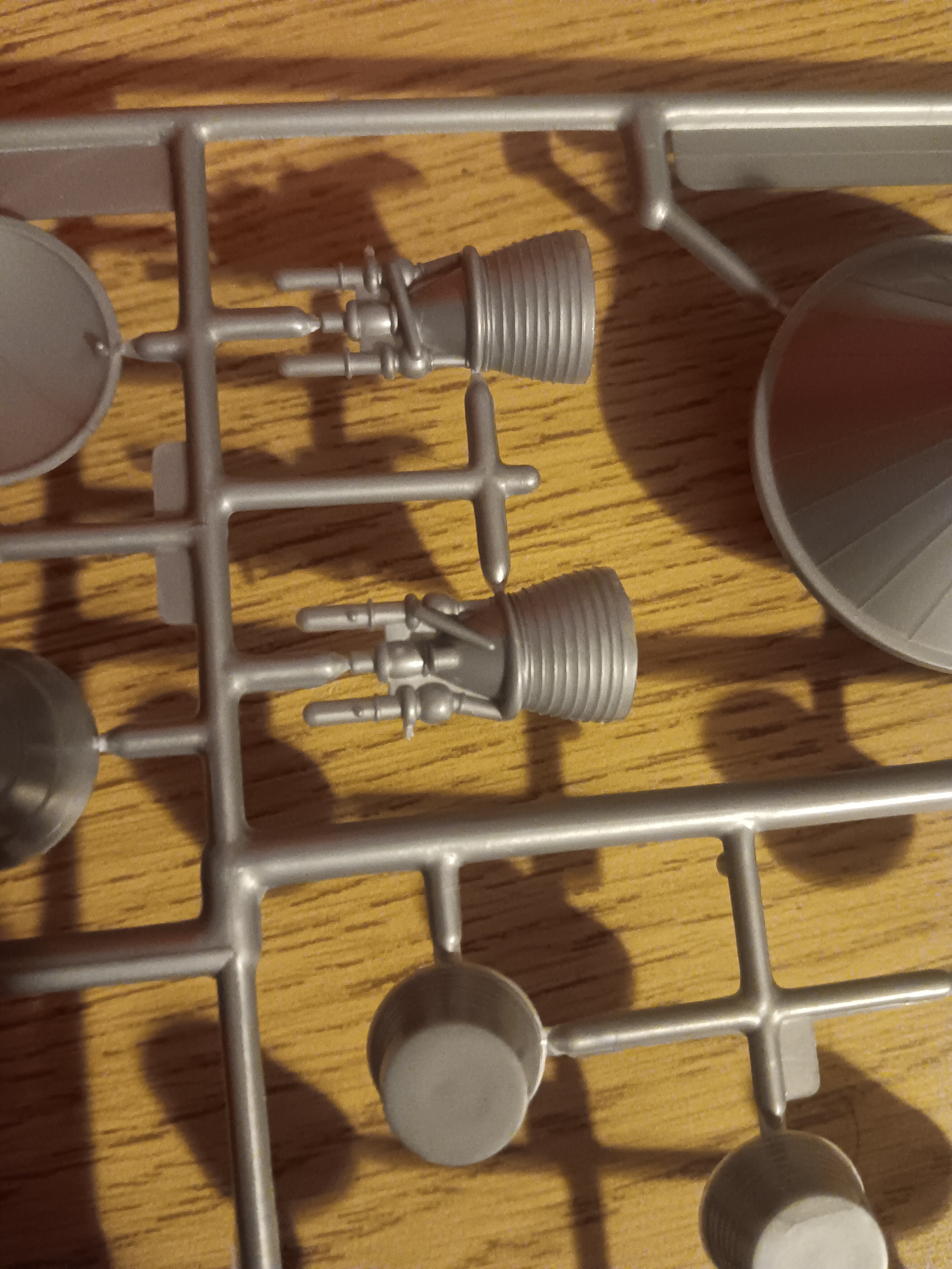

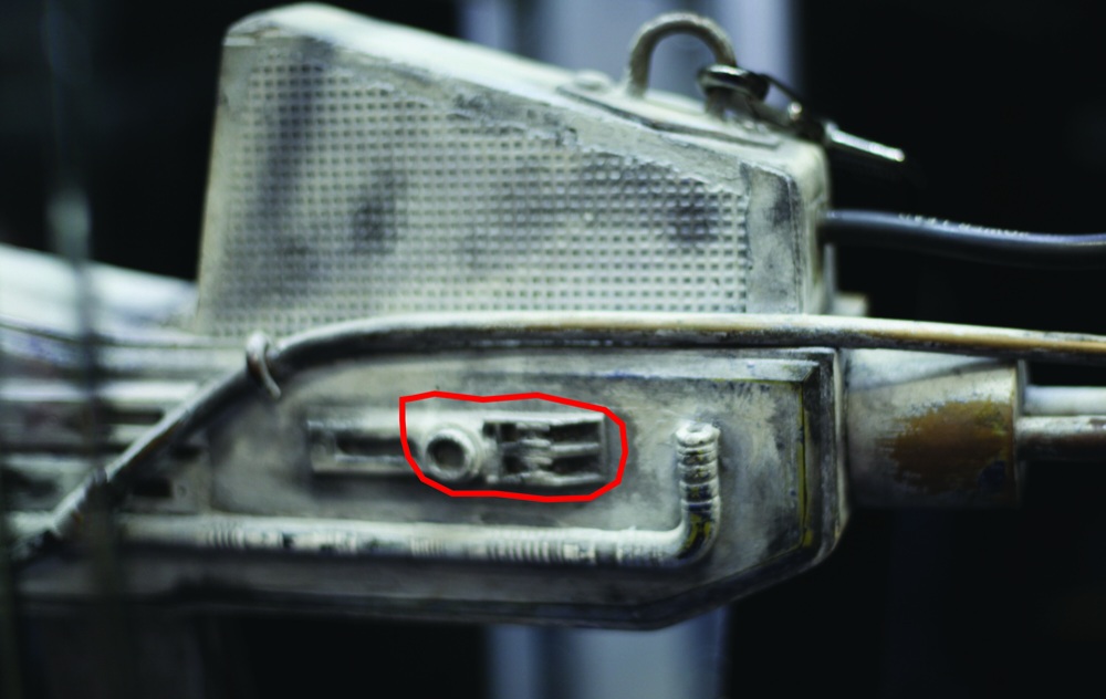

So i have found pretty much all the parts needed for this unit to become fully functional but im stumped currently on these cosmetic peices
On the image titled "flamer 2.jpg" the base component is 2x triang incline piers upside down but the circular bit is unknown and on the second photo all the circled portions are unknown
