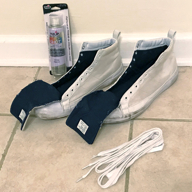

Ultra brief update, and a quickie shot of the new shoes & my fabric spray paint. You can see I've removed the ankle patches, and they are now dry.
Spent a good chunk of today wrestling with dying my Mk. 3 jacket. More on that in the other thread.

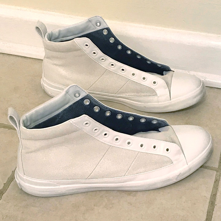

The weather was slightly warmer this afternoon than I expected, and a quick look at tomorrow's looked slightly less favorable than it had before, so I quickly slapped a coat of the fabric spray paint on my shoes. Photo attached below.
I'm not super happy with the results. Coverage seems thin to me, but there's not much paint left in that can. I will hit them again with whatever remains at the next available opportunity, with a slower pass at closer range, but I don't know when that will be. The paint leaves a sort of dotted fuzz on the canvas sections of the shoes, as any spray paint might on slightly rough fabric. Perhaps a brushed application of white acrylic paint will be in their future. On the plus side, this spray paint claims to be both permanent and washable.

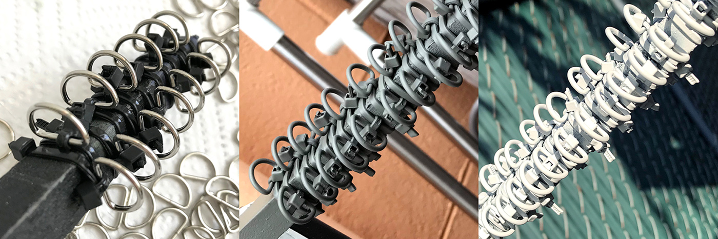

D-Ring Update:
One of my problems was going to be how to paint the D-rings. I figured out that I could use two zip ties to tie one D-ring to a stick, in an orientation that would let me line them up for spray painting. I would have preferred some twisty-ties, but didn't have enough and didn't see any at the stores, so about an hour later, I had zip tied about 38 or 39 of my D-rings to a handy stick, and was ready to begin painting. Stopped by the auto parts store and grabbed some self-etching primer and a glossy white enamel in spray cans, and then stopped at the hardware store to get a can of mineral spirits. After wiping the D-rings down with mineral spirits to remove any residual oil or sweat from my hands, I applied about 2 or three coats of the primer, waited 30-odd minutes, and then applied 2 coats of the gloss white. This should take about 48 hours or more to cure fully, but it's unlikely I'll do anything to them before next weekend.

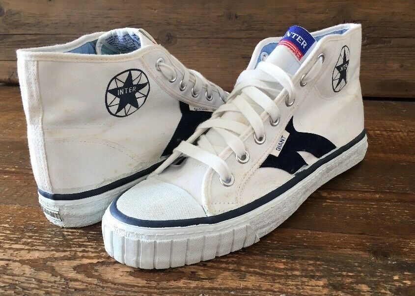

That's an incredible find! It looks like the Inter Giant is an exact match to the Dallas / 'acid' shoes!
Thank you so much for sharing that!
Look what I finally found...
These were what I owned back then. The name changed from Inter to Hi Tec in '82, if you check the link below you can see than Inter made a Silver Shadow a lot like the Hi Tec one, so maybe my pair were made later in the transition and bore the Hi Tec name:
Vintage Hi Tec / Inter - The Webs Largest Archive of Vintage Sneaker Adverts 1965 - 2005
Great find!
Though it just blew a theory I just developed about Dallas' shoes... :/
From the incoherent look of those ridges of the only clear close-up I guessed that they might have simply cut them into the rubber or the patches were single pieces glued onto the shoe. But from the look of the Inter boots, it seems they really looked that way from the factory.

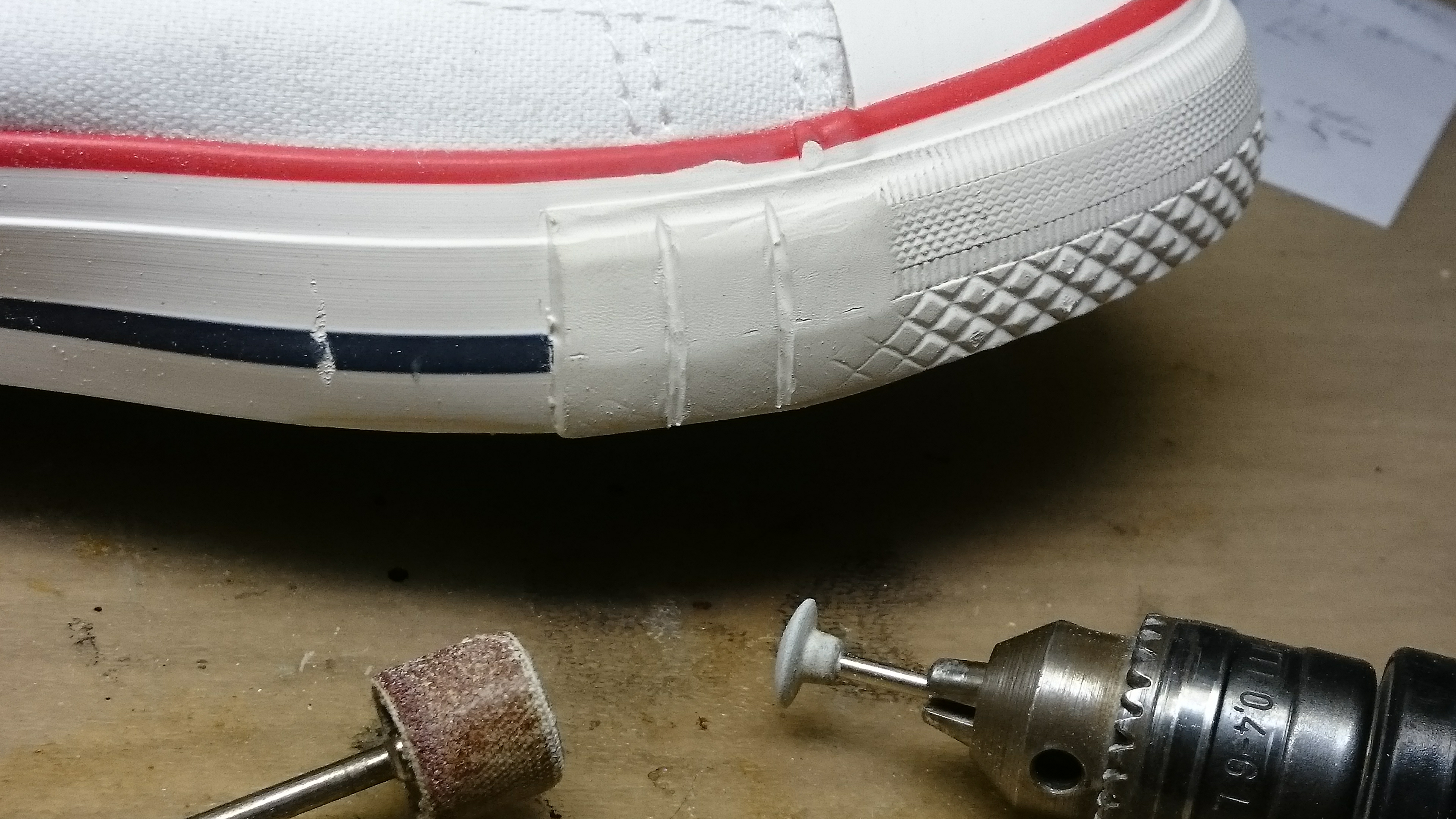

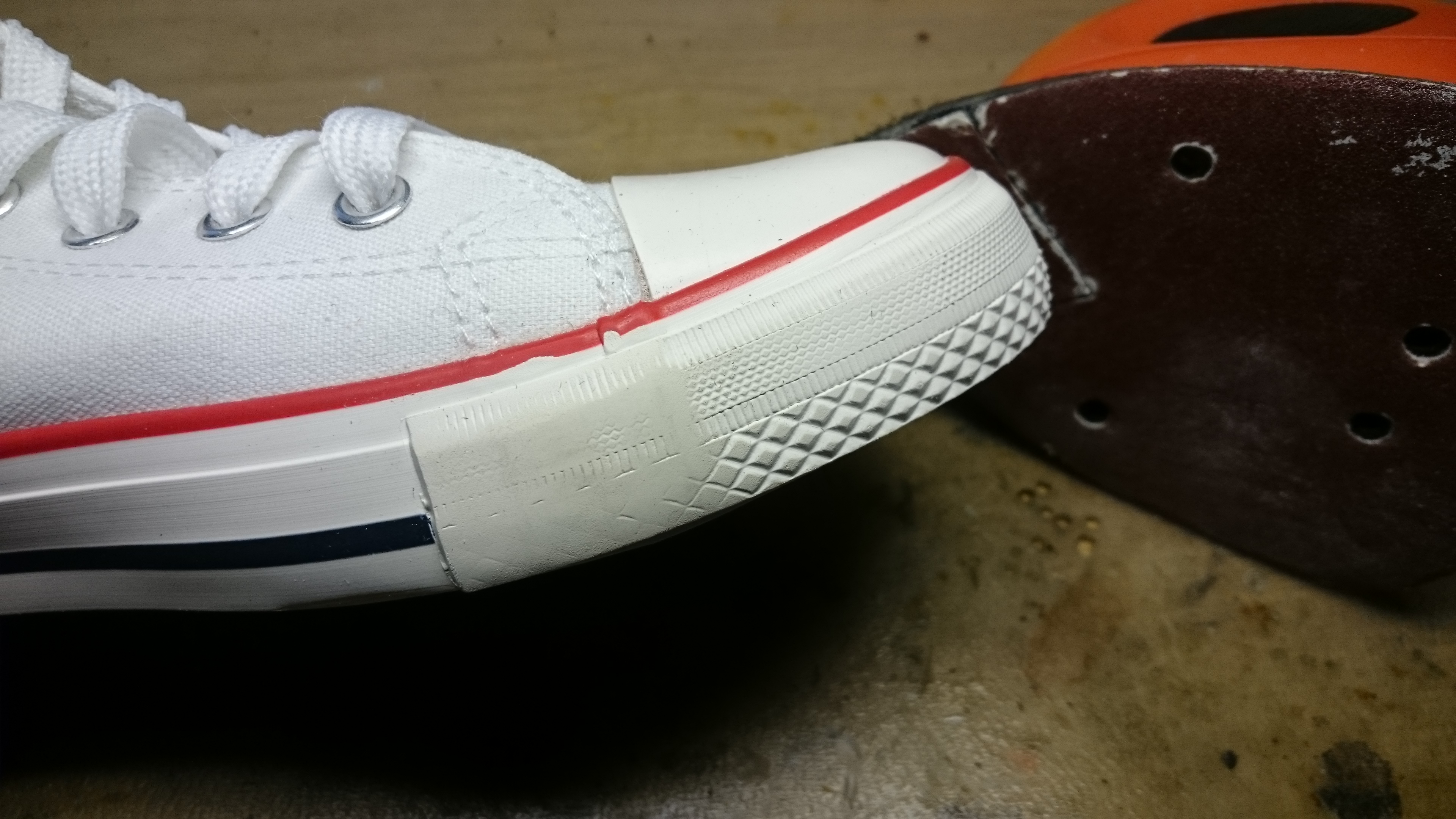

Since trying to keep the budget as low as possible, based on that idea I did a quick test for the look of our Dallas and Ripley (since the ridges on the PF Flyers are basically the positive version, which looks similar if not looked at in closeup) boots, simply using a sander to get rid of the original profil and a minidrill to cut the ridges (those must become yet a bit wider I think).
