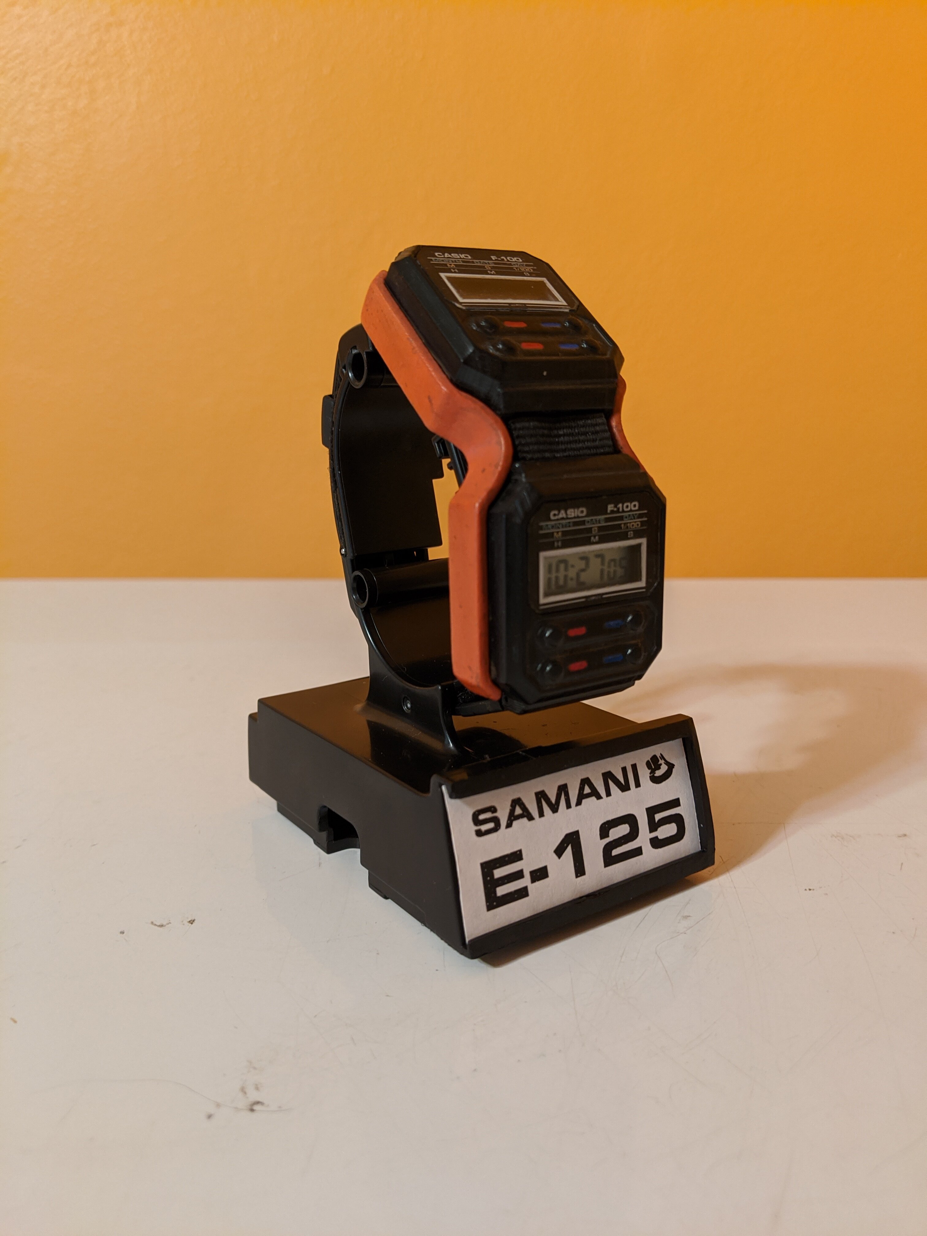

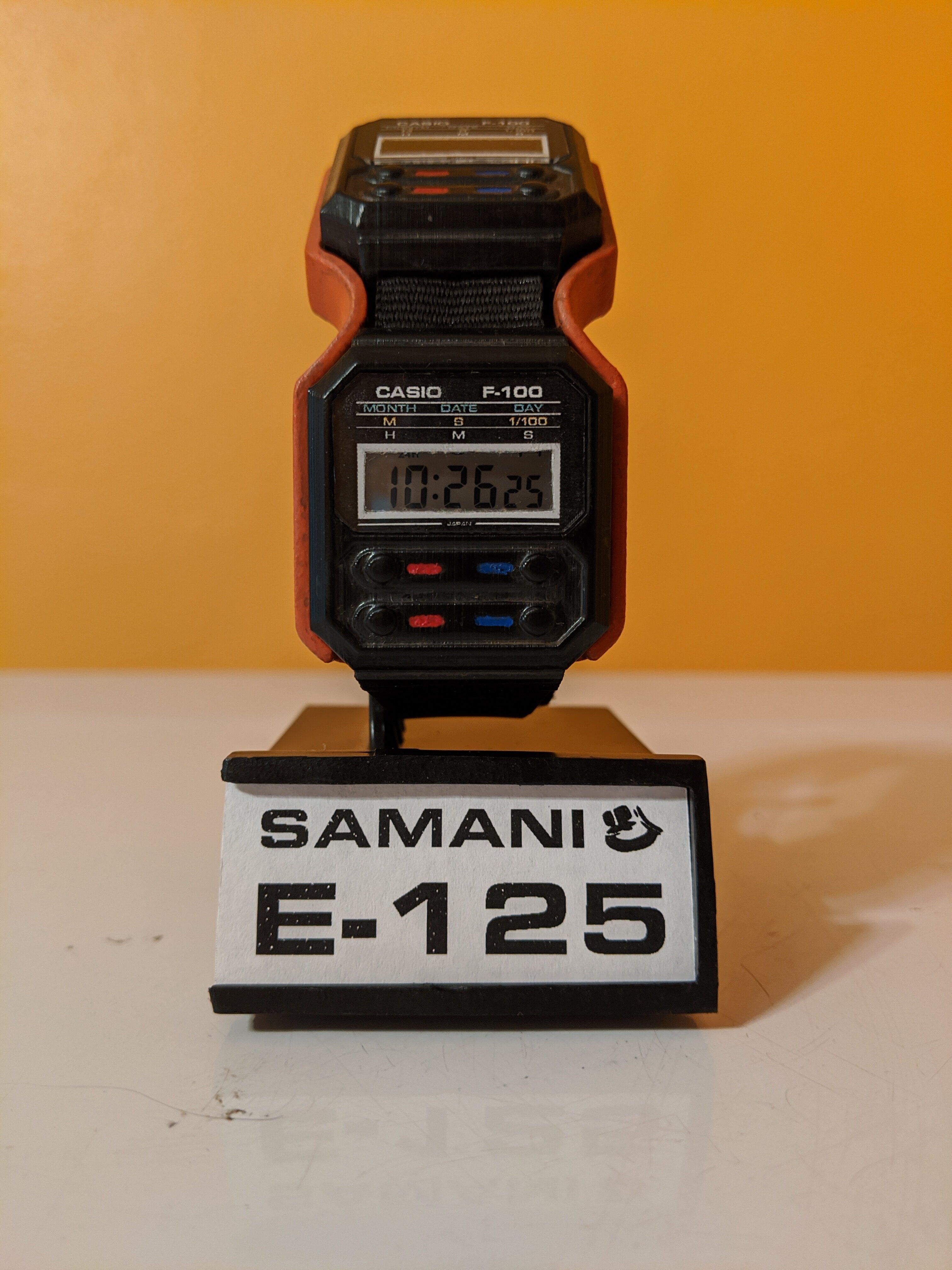

This is the Nostromo crew watch I finished recently. I 3D modeled and printed the watch case and surround, then squeezed the guts of a Casio F-91W into it. The models, face graphics, and parts list are available on Thingiverse if you want to make one yourself: Alien Nostromo Crew Watch (Samani E-125/Casio F-100) by EveningNewbs
Let me know what you think!

Very nicely done! Good paint job, the orange part looks like strong rubber and the details on the face of the watch are really nice.
Thanks! I opted for hard plastic for the surround partly because I could print it, and partly because it would sit better on the wrist. I'm sure you're aware based on your username, but the prop used in the movie with the rubber surround tended to flop around on the actors' wrists. It took me several iterations and test prints, but I got it to the point where it sits well without rolling around the wrist. I'd almost even call it "comfortable."
Test prints all lined up to show the evolution of the angle:
