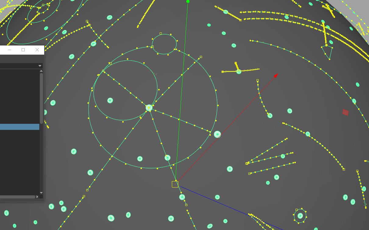

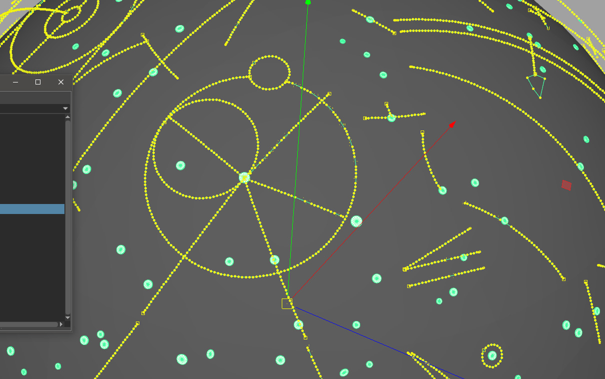

after a long time (more than a month) placing each engraving line based on 30 references! several back and forth with Julie, validating everything. The engravings were finaly validated yesterday.
After this came a bit of cleaning of the 3D file. Then a little python script to mathematically put even divisions on each curve based on its length :)
before/after:

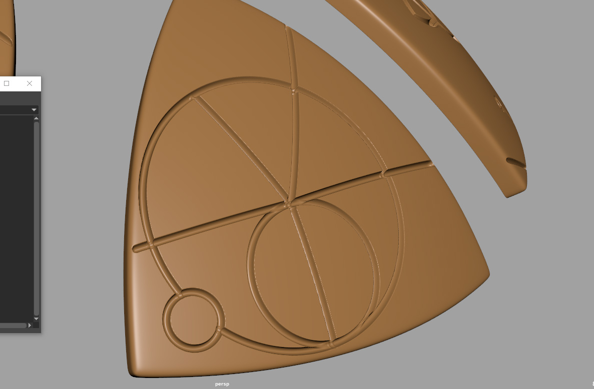

I mentioned before I was simply going to use booleans to do the actual engravings next. But this is dirty and is a crazy amount of work! After spending more than a month getting to this point, the idea of spending at least 3 days cleaning all the lines converted to polygons, merging them together cleanly and hoping the software didn't crash while calculating the boolean on so many polys didn't enchant me.
I finaly came up with the idea of using another deformer, the wire deformer. This is a deformer that uses a nurbs curve to deform a mesh object, something I used a lot before.
To do this, the mesh needs to be extremely subdivided. Maya is not intended for several millions polygons, so I have to be clever about my subdivising, in this case, i went one subdivision at a time, removed a few useless lines, divided again, removed as much as possible under the tile and so on. The triangle tile is already 400k polys, which is quite a bit for Maya already.
but then, it's just a matter of selected the tile, selecting all the curves on this tile and applying the deformer. Then I just scale all the tiles to 0.99 and it will pull the polygons around each curve slightly. This is all parametric, each line can be more or less thick. The final file/files will be heavy, but I get a great result and it saved me a few full days of work!
first test on 5 main tiles :
someone was asking for the wireframe. In this case, it will just be subdivided and deformed, so heavy, but clean :) I will probably do all the holes first with booleans though.
before/after:
cheers!
Interesting – so, this is basically the equivalent of using a displacement map, but with curves driving the displacement instead?
Yes, basically, but it's a deformer, so everything is parametric. You can change the falloff, shape, scale, rotation of the deformation.

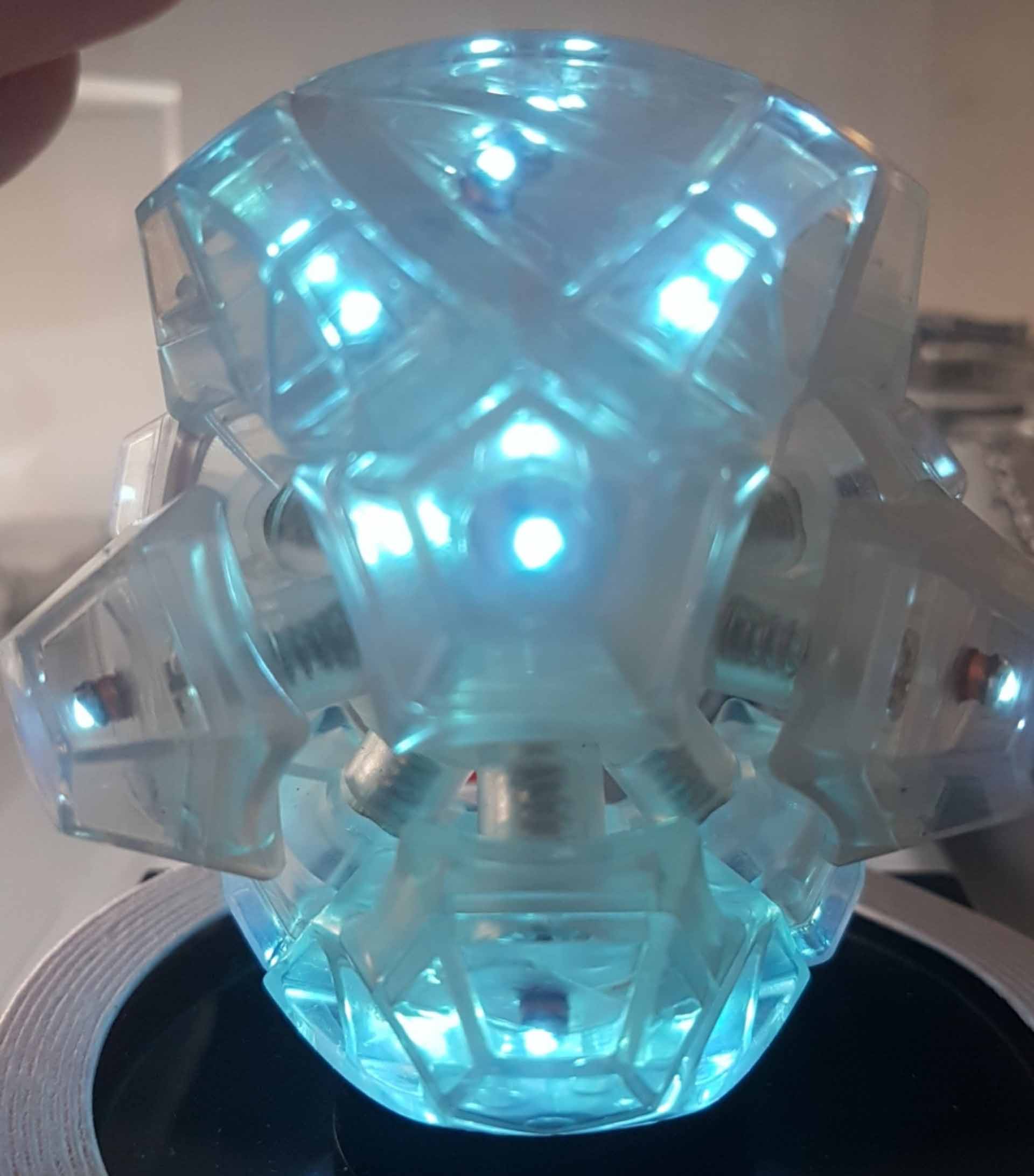

Here's my version from this kit using the clear version and transparent Megaminx ball plus lots of micro LEDs :)
Thanks again for making this happen.
Amazing kit!!! No regrets!
Did you just put them in the pentagon/screw caps or in all of the megaminx tiles?

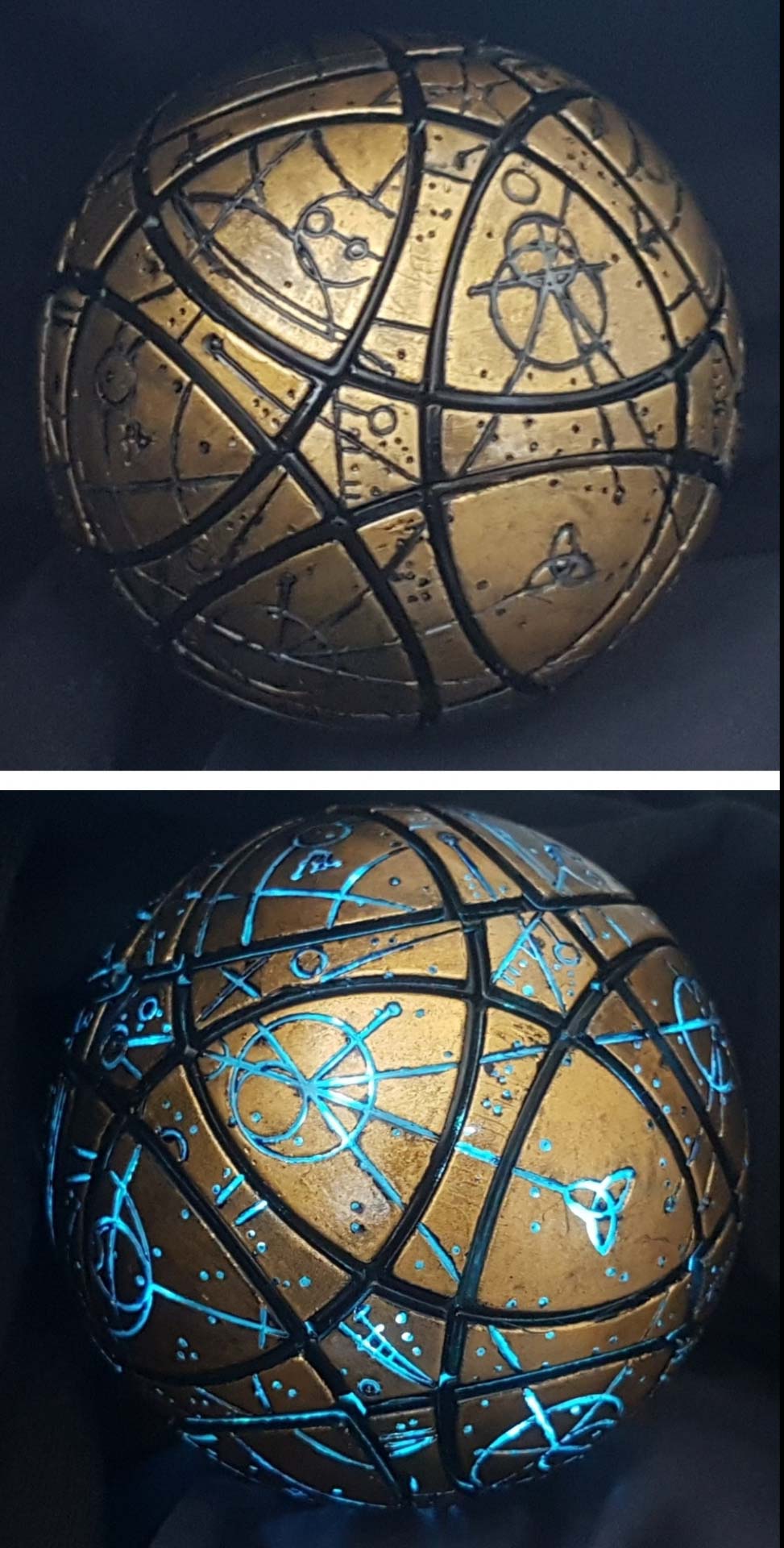

Very nice work! Do you have a build log on how you achieved this? What was your painting process?
Thanks mate!
Here are the steps:
Lighted Ahsoka Map Step-by Step DIY
1. Dismantle Megaminx Ball.
2. Glue 3mm wireless inductive LEDs in all Megaminx tiles.
3. Remove Wonderknight kits from their sprues and smoothen them using 500 grit sandpaper. Glue the kits on the Megaminx tiles.
4. Cover all the map markings (dots and lines) using Liquid Latex.
5. Mask the bottom half and Spray black the top half of the tiles. I used Mr Hobby Finishing Surfacer Black 1500.
6. Add the gold layer using Rub n Buff Metallic Wax.
7. Remove all the latex masks.
8. Weathered as desired and seal the kit using Clear spray.
9. Assemble the map.
Thanks mate!
Here are the steps:
Thanks! Very helpful and amazing what you can achieve with Rub n Buff.
My pleasure. You'll have fun with the Rub n Buff wax. Excellent stuff and it'll give a natural weathering too.
The most tedious part was masking and removing the liquid latex. For me, that's the toughest part.... not to miss out any 'stars', especially on clear resins.

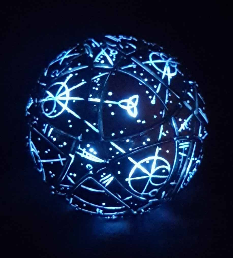

Here's the result in total darkness.
Your brown weathering layer looks excellent, mind sharing how you achieved the effect over the gold?
It's just an amateur work. Using Rub n Buff Wax, the gold paste was added unevenly. When I removed the latex mask, some gold came off when I wipe/clean up the tiles. It gave a natural weathering look against the black finishing coat/base.
You should check out Julie's masterpiece (aka wonderknight). She did an amazing work on the weathering. Simply perfect!!!
