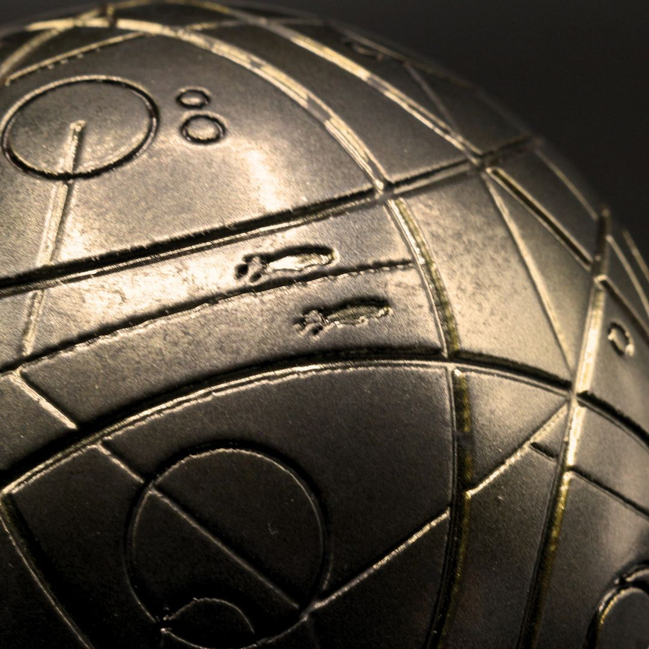

Not at all related to the run, but I am very curious what your mesh looks like with the lines cut in.
in this case it will be awefull ahah :) I'll use booleans here, there is no way I can model all the details cleanly :)
But i can definitely make a small update when I get to this as I'll be scripting the whole convertion from curves to polys before doing the booleans, fun stuff :) cheers
Okay, so it'll probably look about like I would expect. :lol:
(If this were Lightwave and/or Modo: freeze curves --> bevel to produce width --> Smooth Shift to thicken --> Solid Drill into sphere w/ a new material --> use statistics panel to select new material --> Smooth Shift again to inset the selected w/ new geo at the edges.
I'm not familiar enough with Maya to know how to do it there, but the end result would probably be very similar.)
yeah, this is in maya, and I want the channel of each engraving to be of a special shape, deeper than larger, so I'll need to define the orientation of the profile curve for each of the channel curves on the sphere before creating the poly lines, if that makes sense at all. For this, i'll script it I think :) but that's just the rigger in me doing complex modeling ;-)

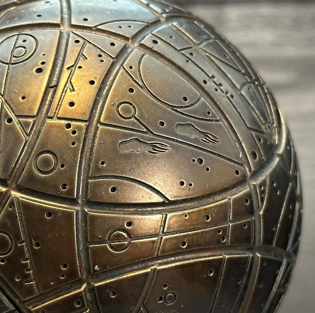

My own 3d model is based for now on 23 different reference images that I placed in Maya and matched with the camera, I am at 92% done will the engravings and haven't seen any purgils anywhere in the refs.

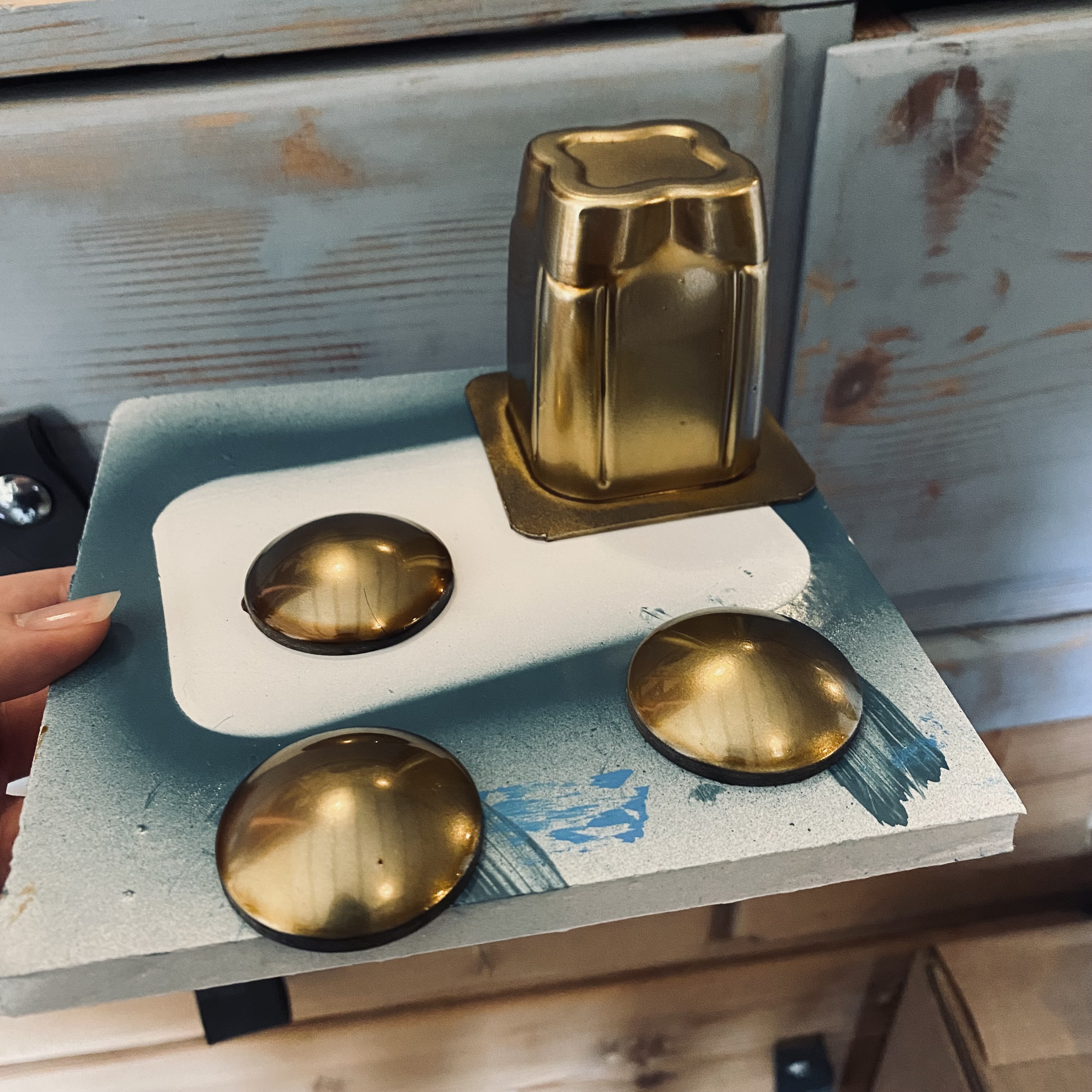

Hi everyone :) ,
I did a little test for the color of the map.
It's very difficult because it really changes color depending on the scene.
So I chose to work on the version Sabine handles, a sort of aged brass.
I still need to work on the weathering which will add a lot to the overall look.
But you can already get a glimpse.
Cheers
