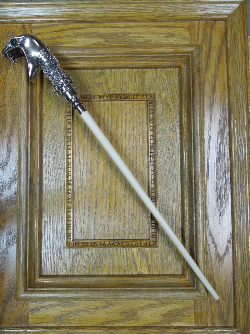

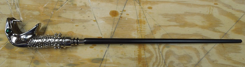

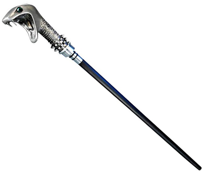

Most Harry Potter fans will recognize this wand. I added a green LED to one. It was pointed out to me that the only spell that the wand was used for was avada kedavra, which always seemed to have a green aura.

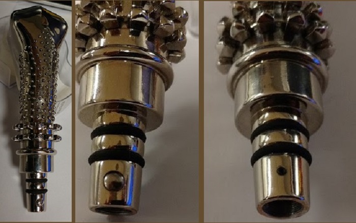

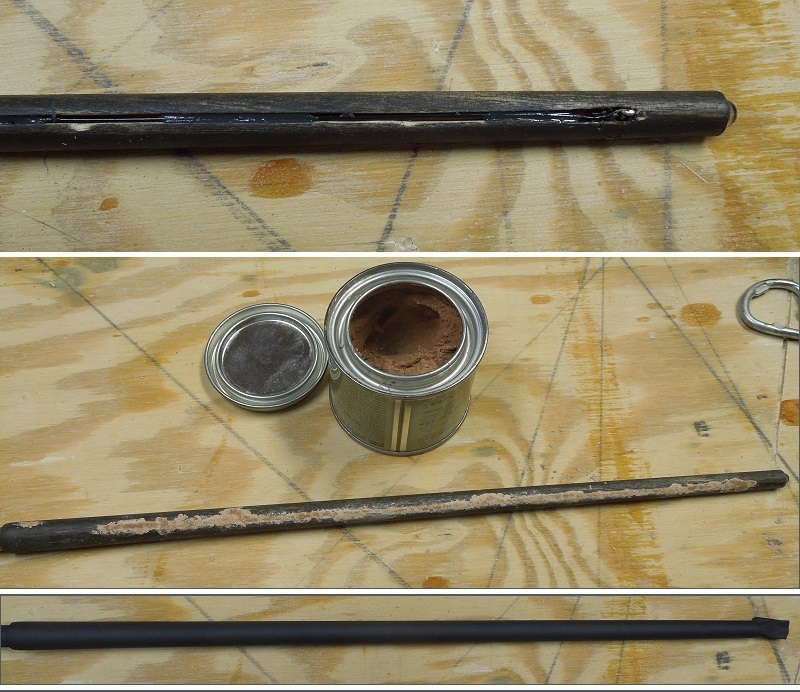

Turns out, the "collar" part threads into the snake part, so that was easy enough to disassemble. Since I needed to add a brass tube inside the shaft to hold the battery, I was not able to use the existing shaft, so it was cut off using a jewelers saw. I then drilled and tapped the collar with 9x0.5 mm tap, and threaded an appropriate sized brass tube with the associated die.
Also, in the collar a hole was drilled for a switch actuator button, and a small set screw to hold the tactile switch in place.

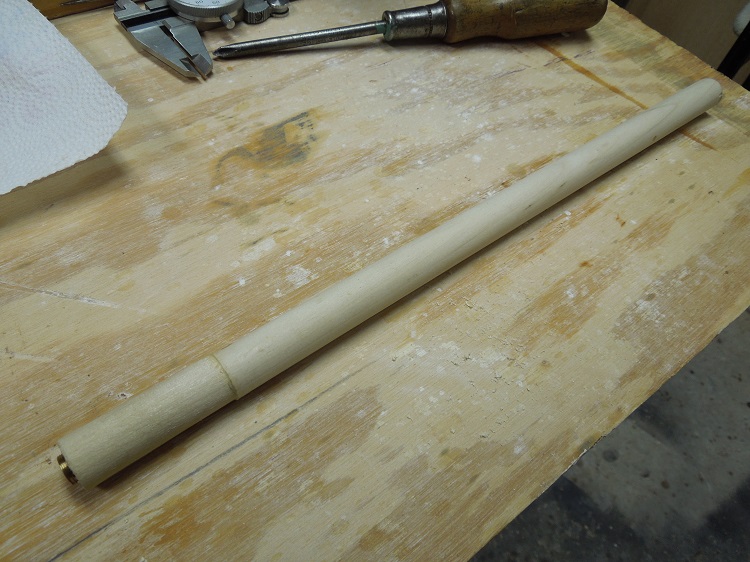

A short piece of 5/8" hardwood dowel was drilled out, and the brass tube was glued inside. This was then glued to an additional piece of dowel.

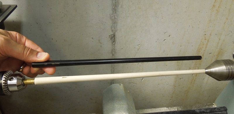

This dowel assembly was then chucked in a lathe, and turned in a long taper, to make the new shaft.
Test fit!

The finished wand. I buffed the paint and waxed it to give a fine sheen.
