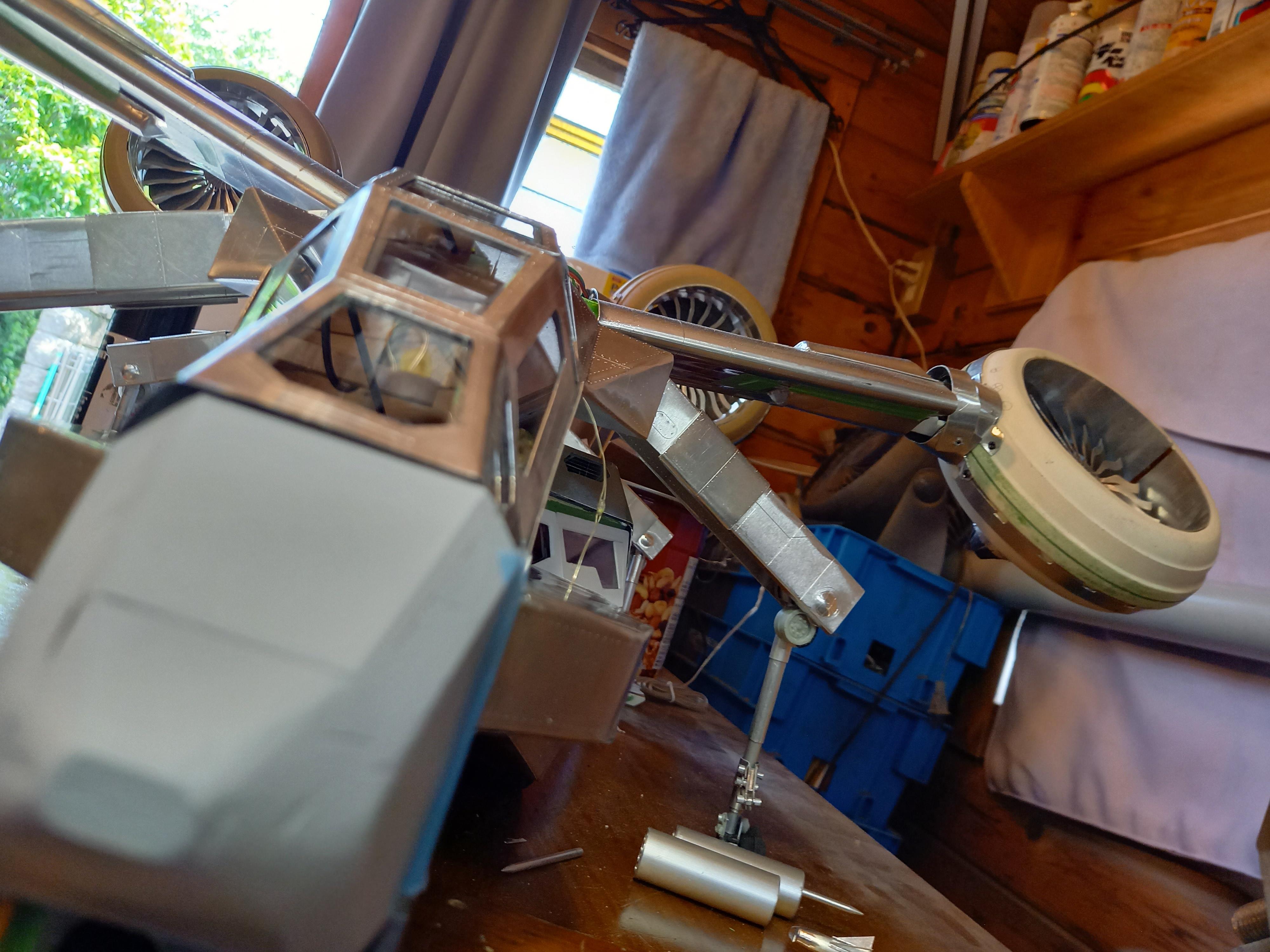

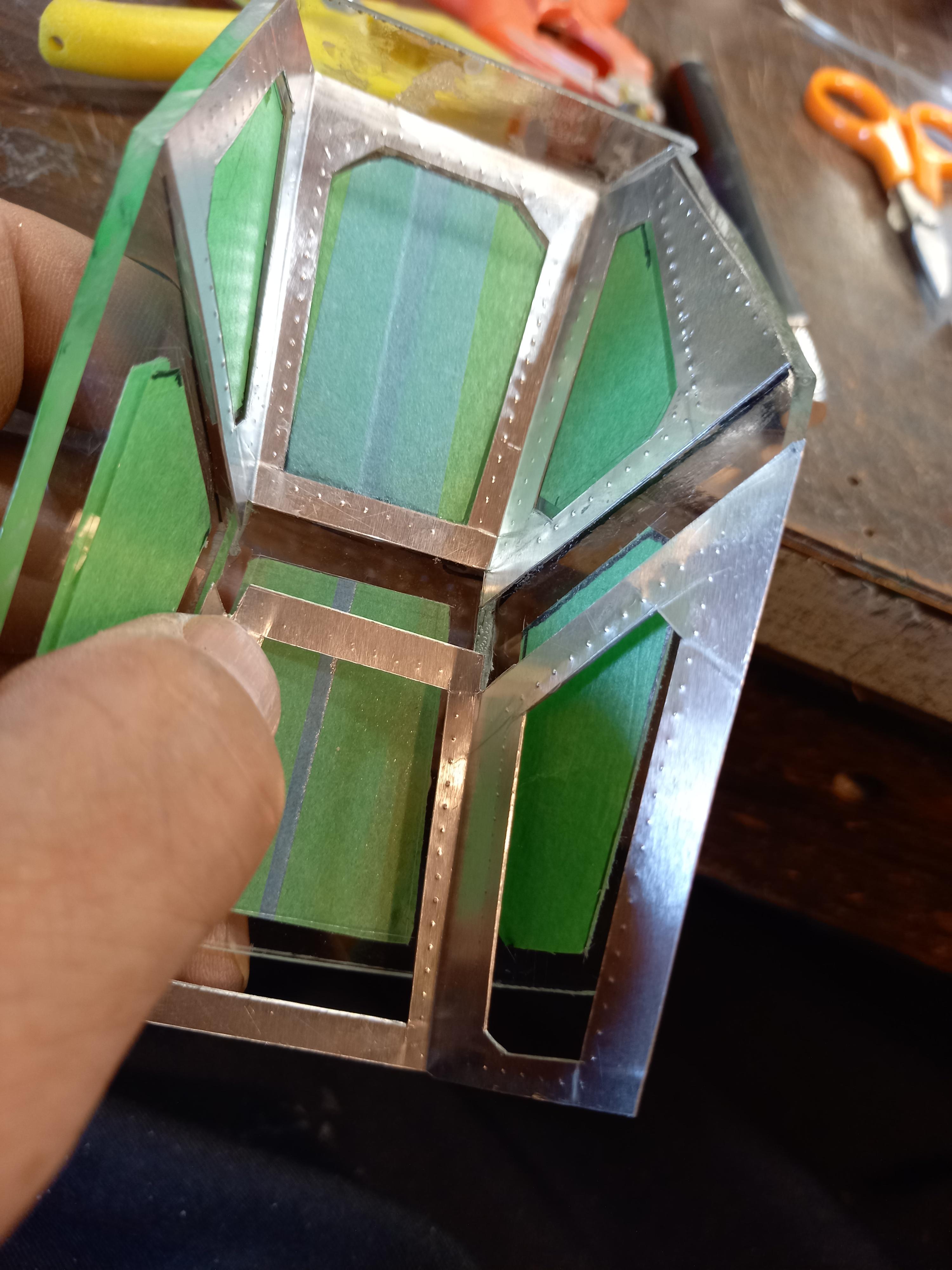

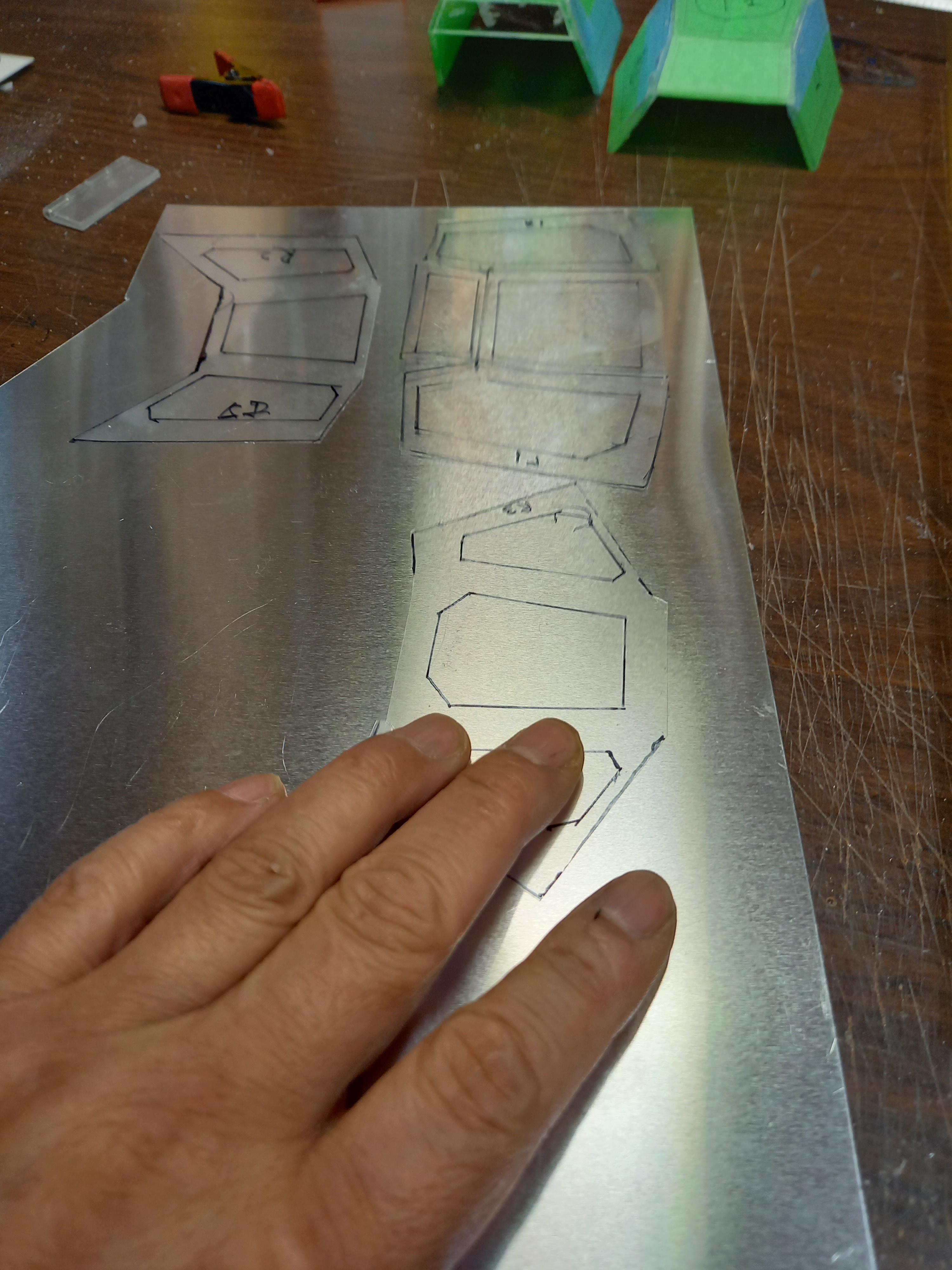

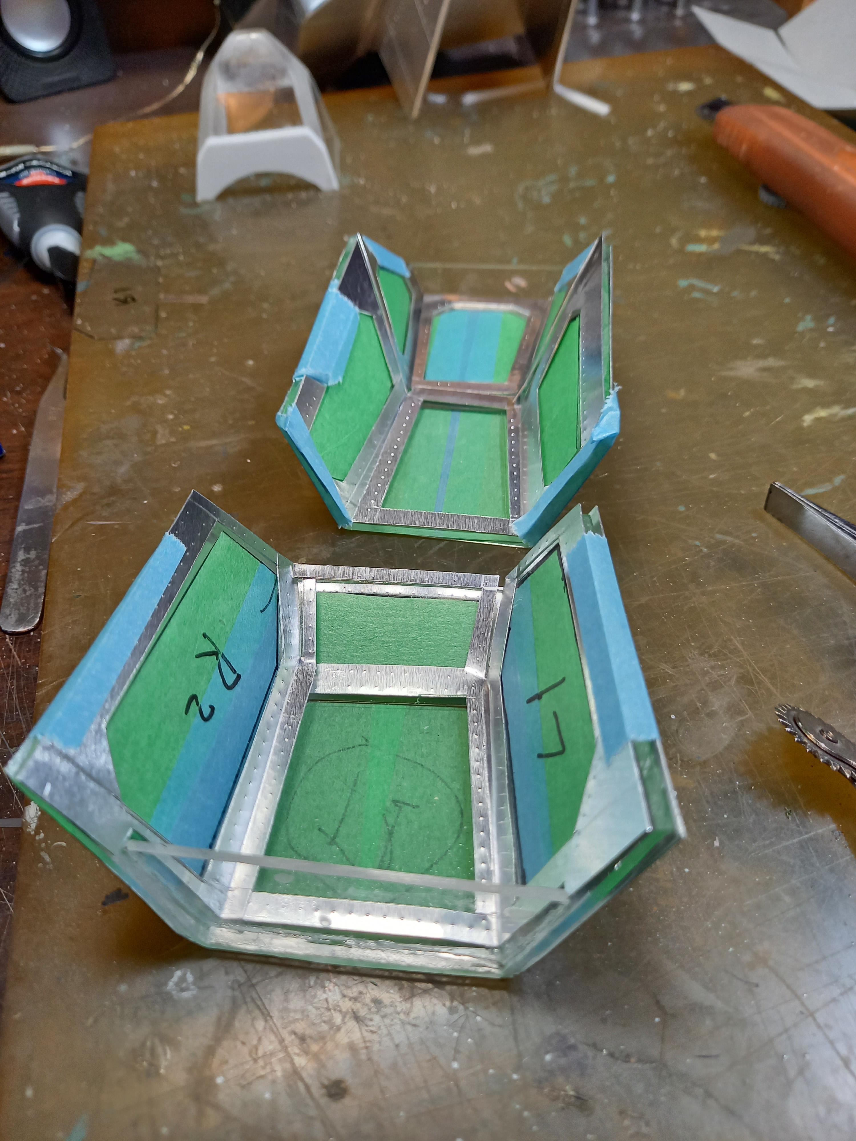

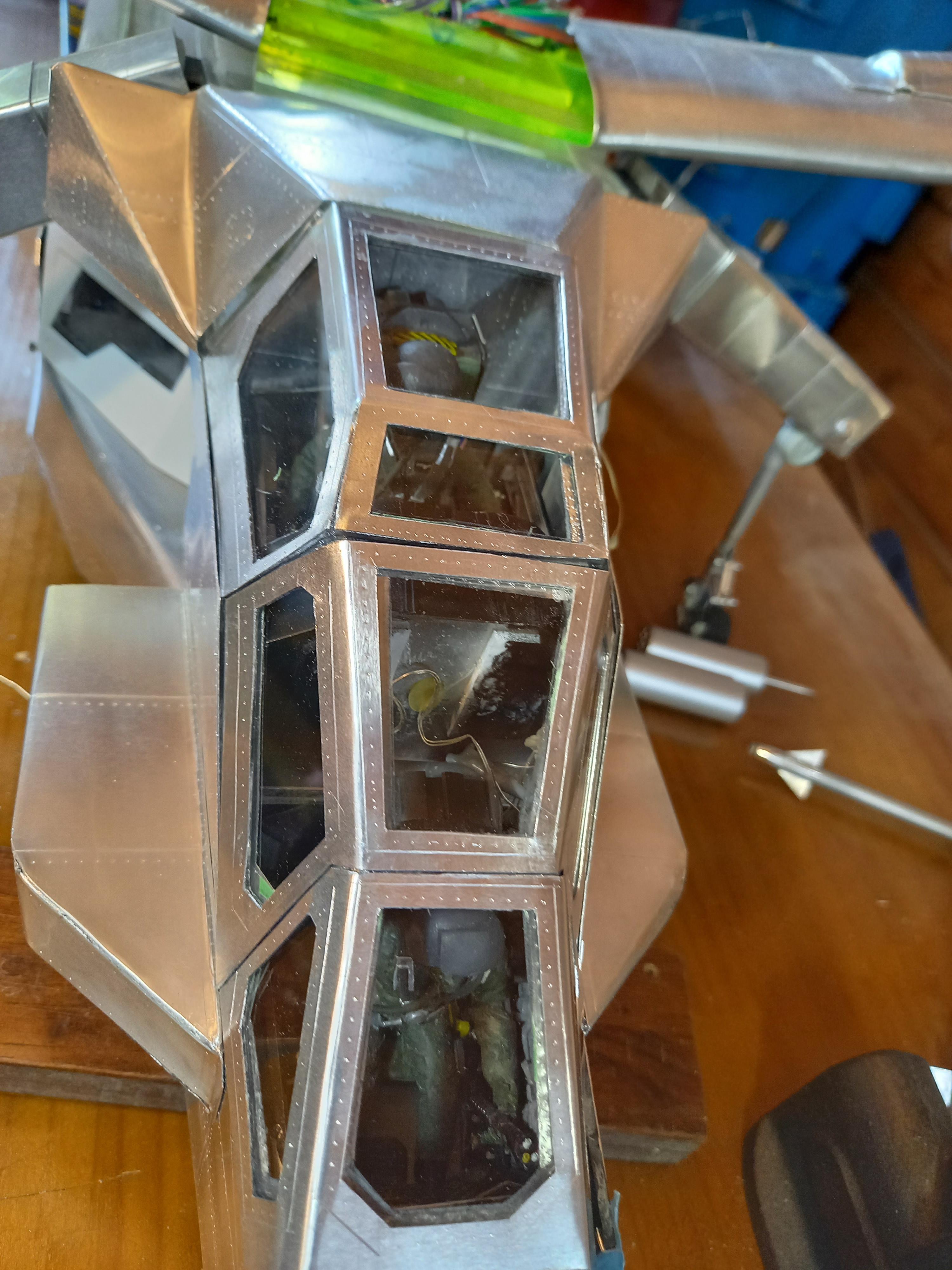

I've cut up some canopy parts from a transparent acrylic plate and grue those facets together and covered it with masking tape all over.
And then trace the window frame pattern with a thin transparent sheet.
Then I scribed the pattern on a 0.3mm aluminum sheet.
And cut them out.
The above is for the outside window frames.
I took the other way to make inside frames.
I mask them inside with masking tapes, draw the window frame patterns, peel them off, transplant them to the aluminum sheet directory, and cut them up. That was rather easy.
The rest was easy.
I didn't use super glue to attach the frames to the canopy base to avoid cloudy glass.
I used dichloromethane (DCM or MDC) I usually use for the acrylic plates. That was so fine.
A few fitting adjustments might need.
I will put the hinges on the side. The canopies will be opened up to the sideway.
Thanks for looking.

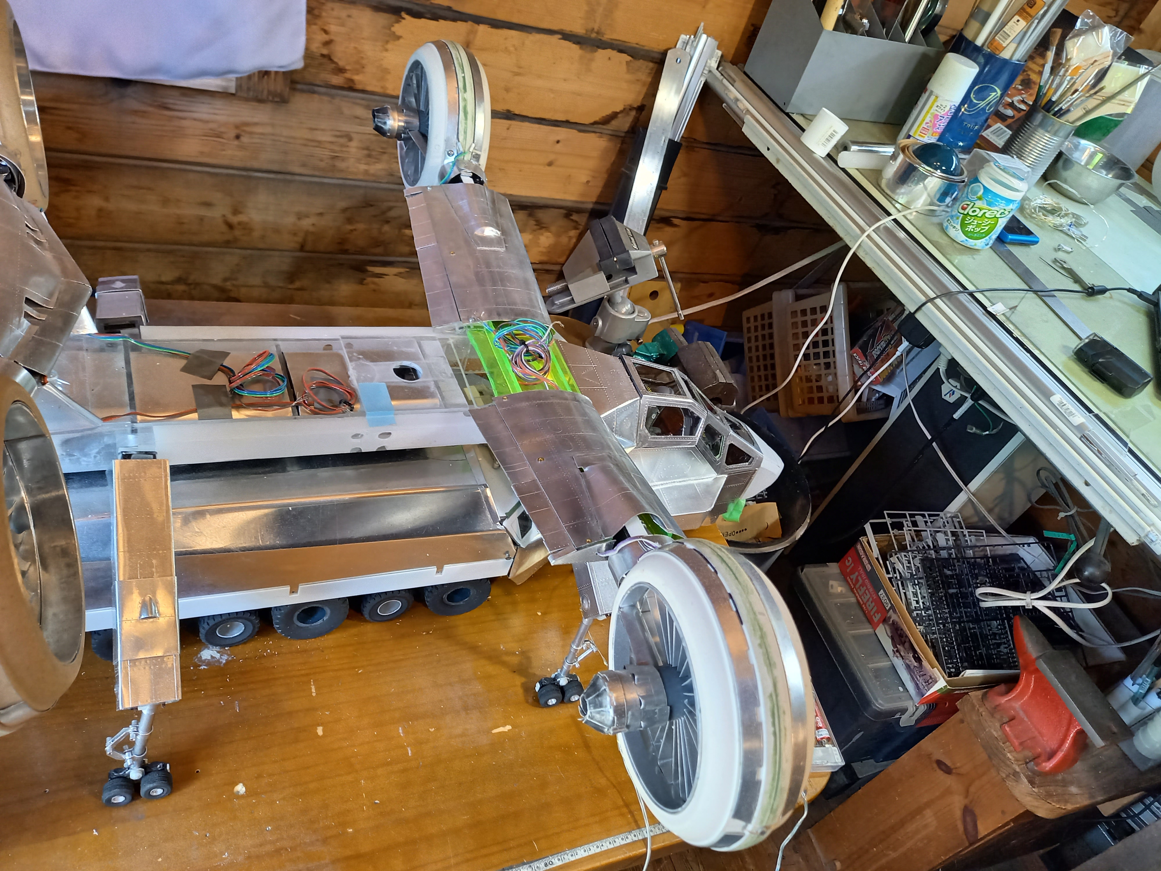

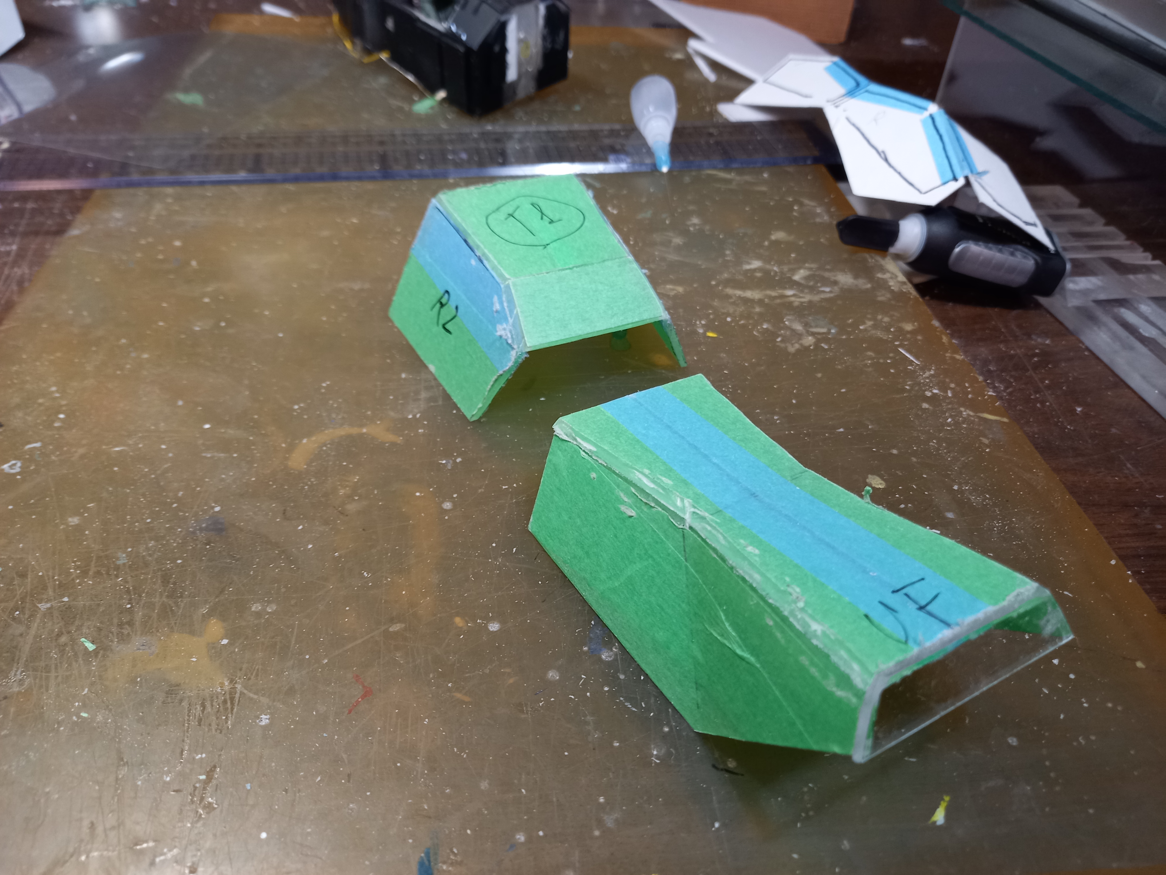

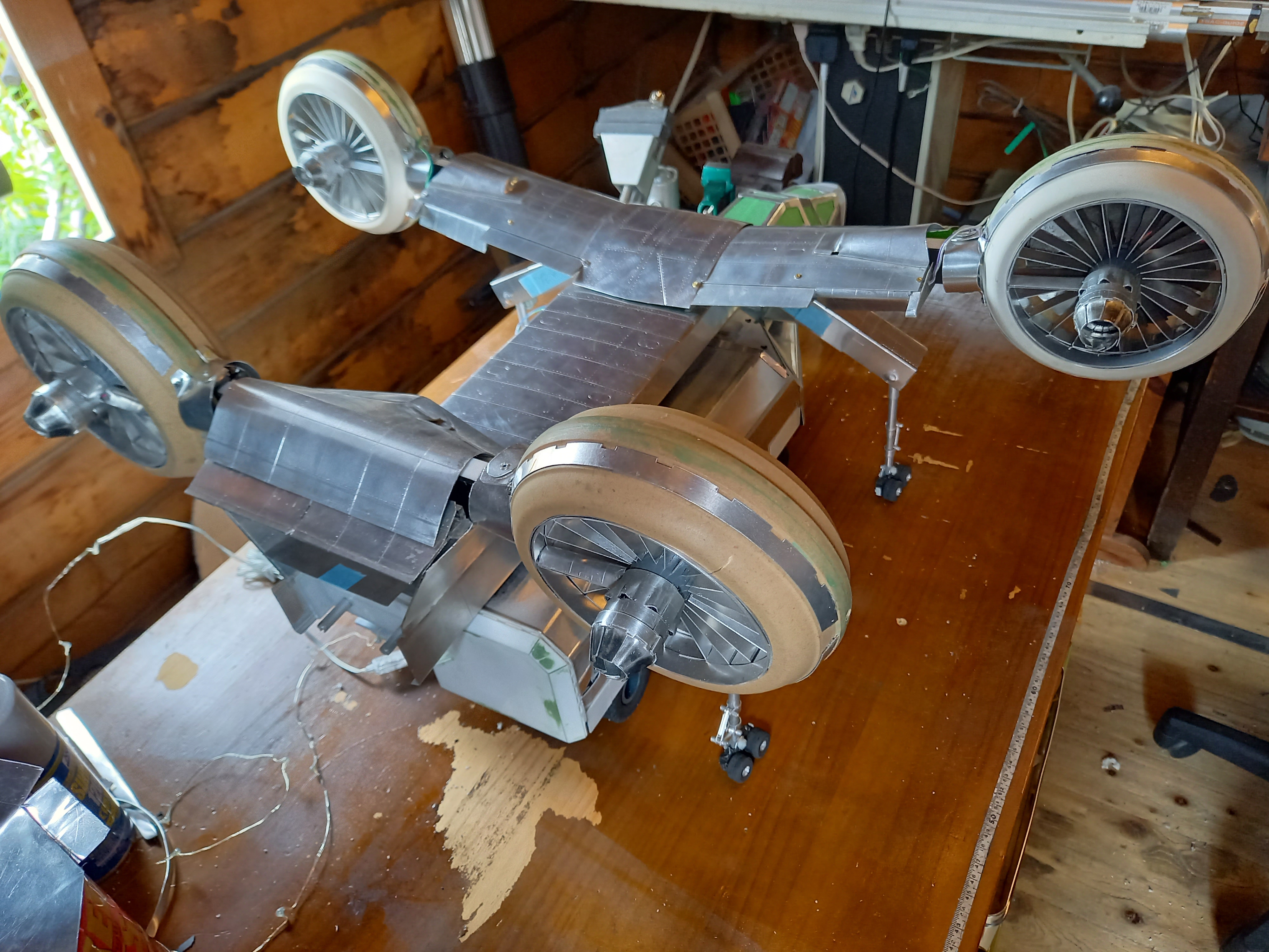

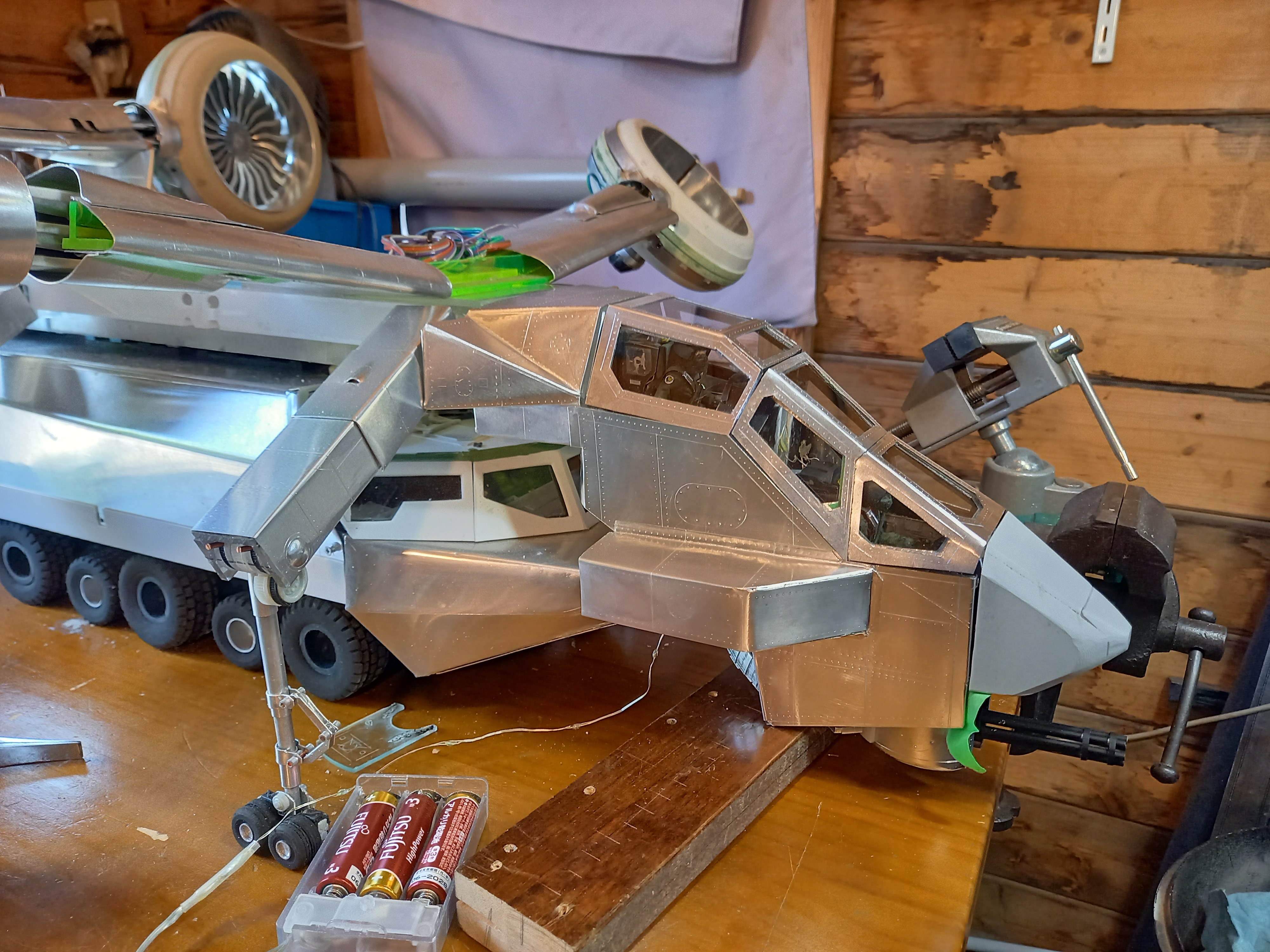

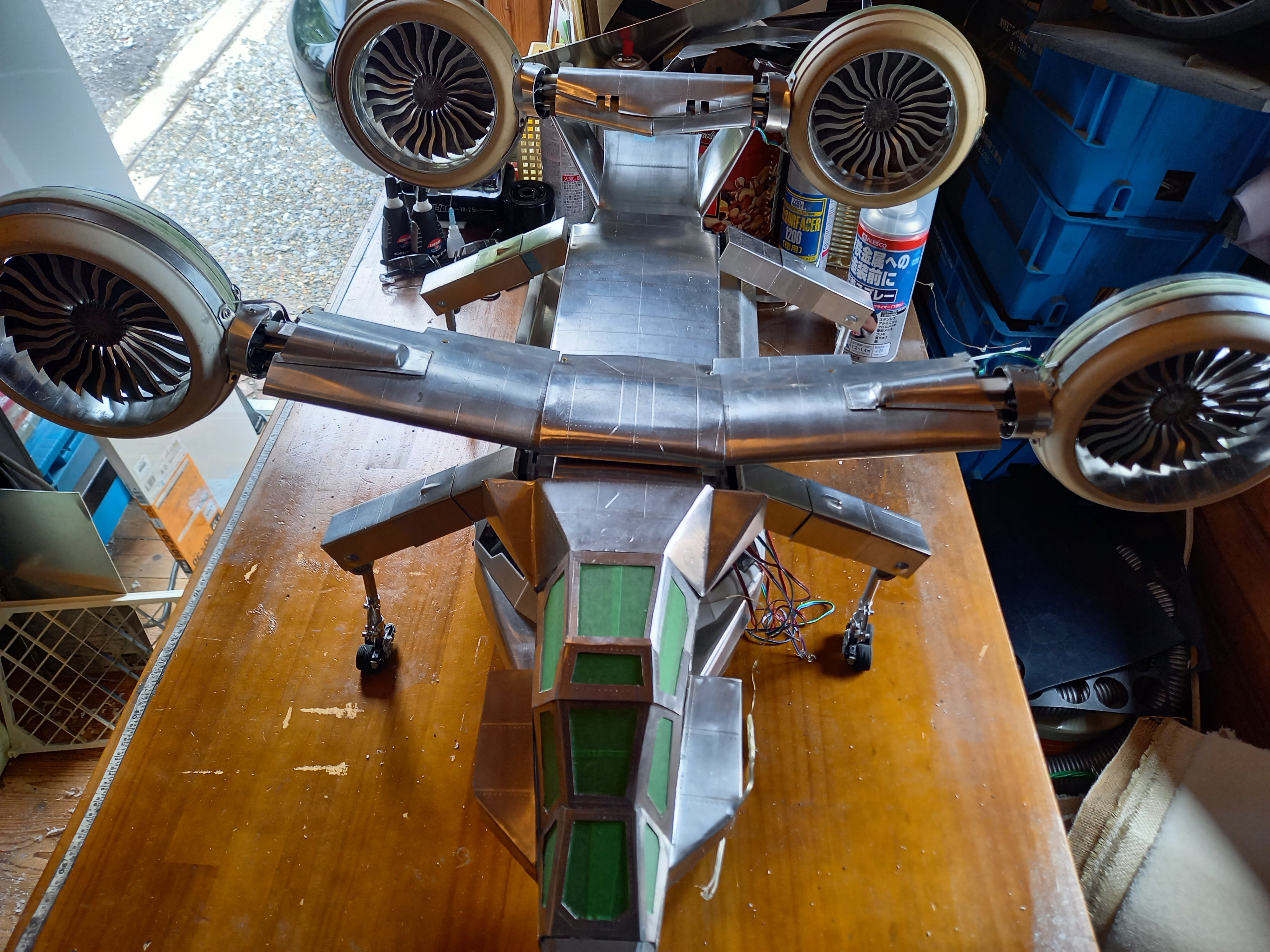

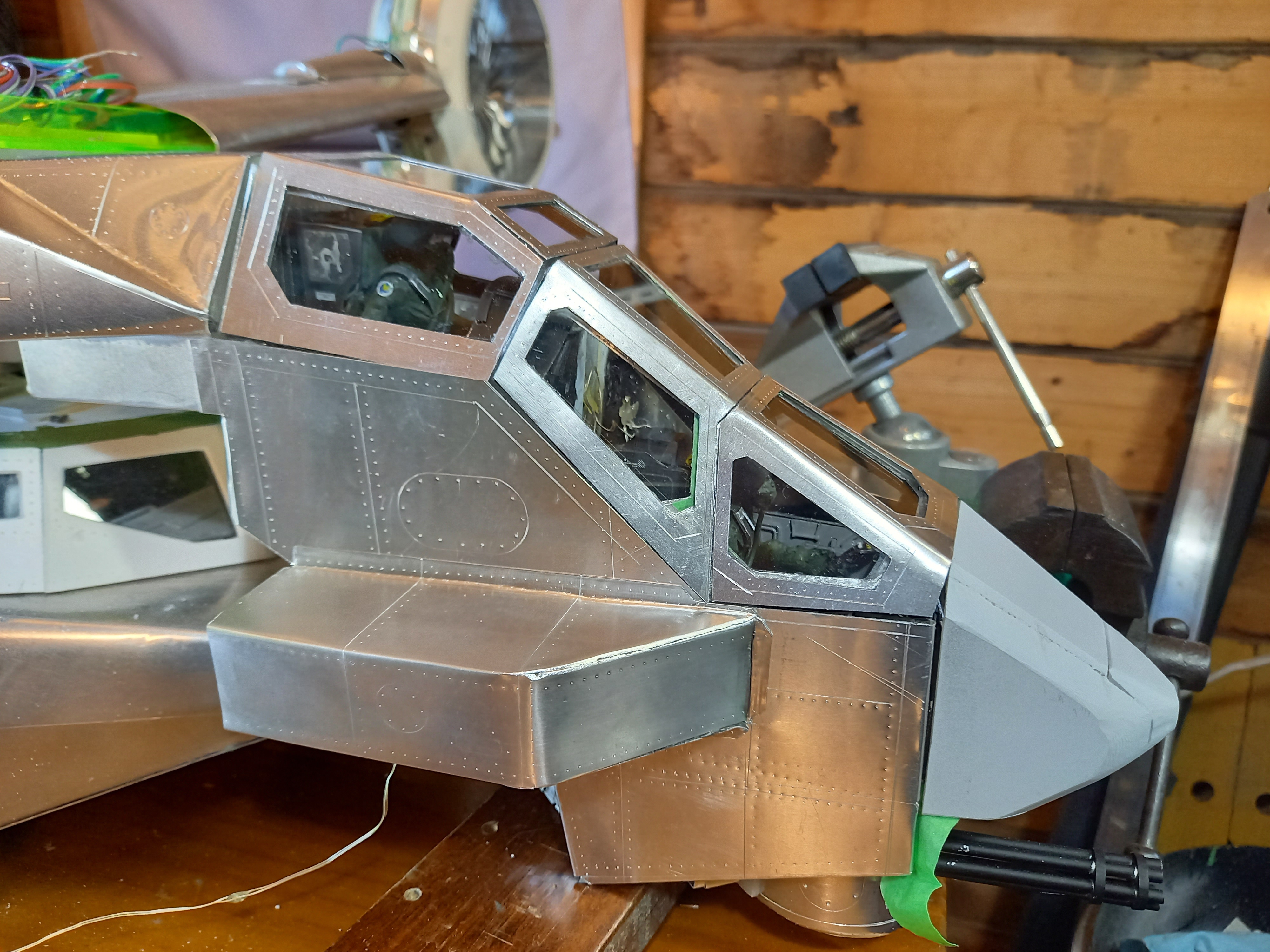

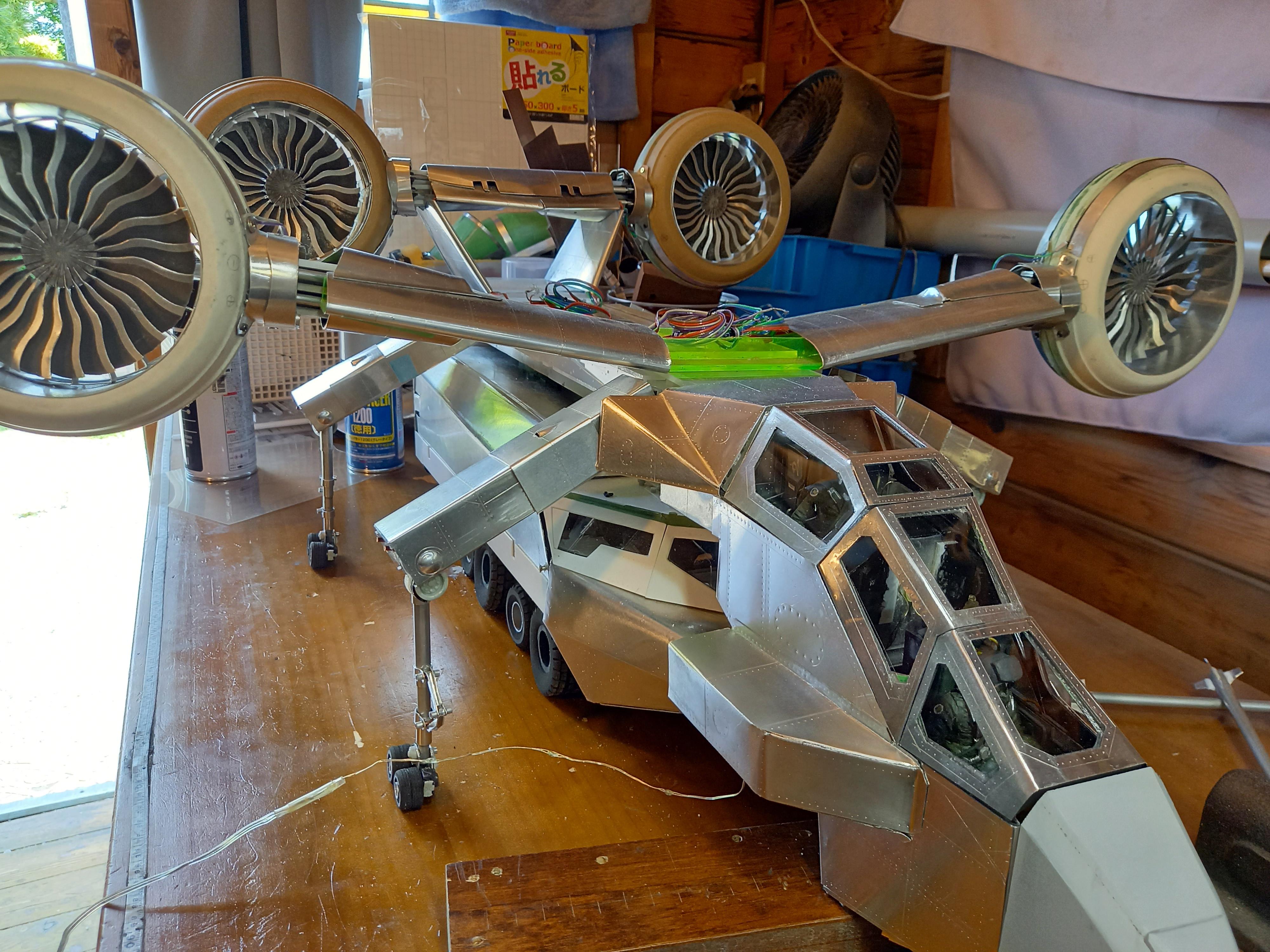

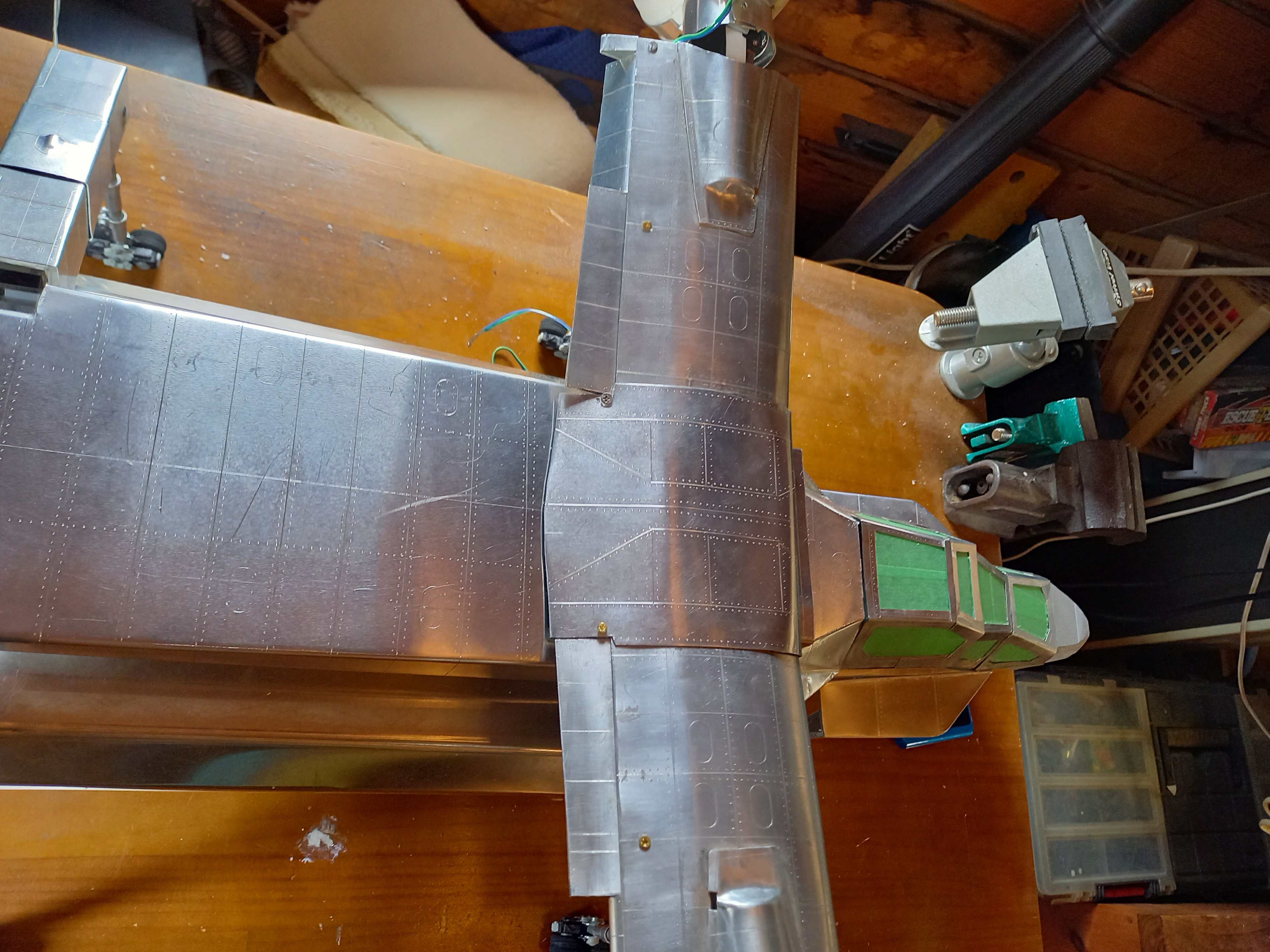

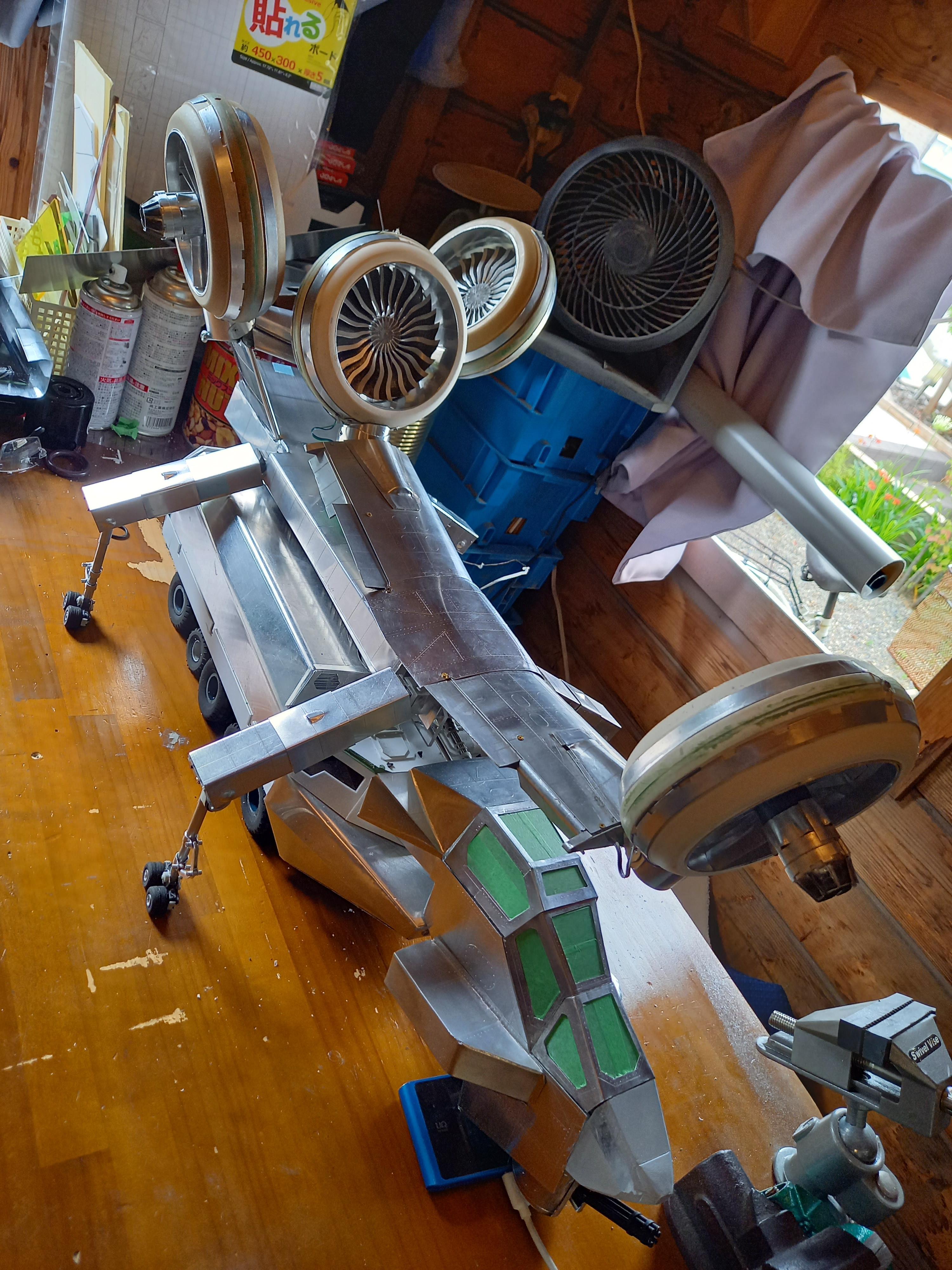

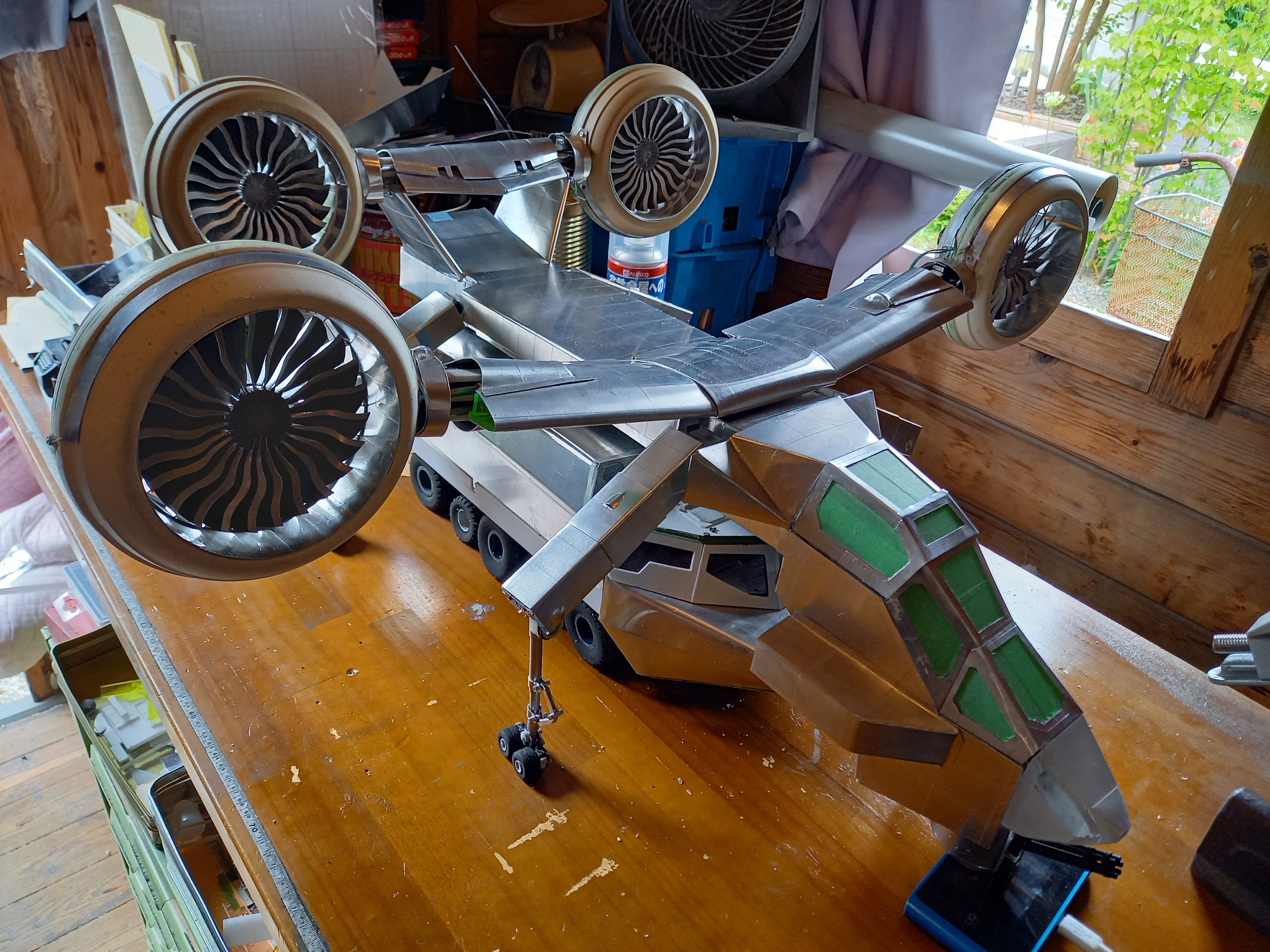

It's been almost three weeks since I post the last updates.
Here is some progress.
A new wing center cover and a new outer skin of the fuselage.
I had been thinking the design of the wing center cover this and that, but at last, I found that the simple is the best for this.
The wing will be mounted with a single pivot and fixed with a pair of U-shape plates later.
So that the wing can rotate to the parking position.
It may save space on the aircraft carrier deck. ;)
Still, there are many things to be taken care of.
Attach the nose section, get those wirings organized, detailing, and painting.
However, this time, the goal may be near.
Thanks for looking and I appreciate your usual support.
