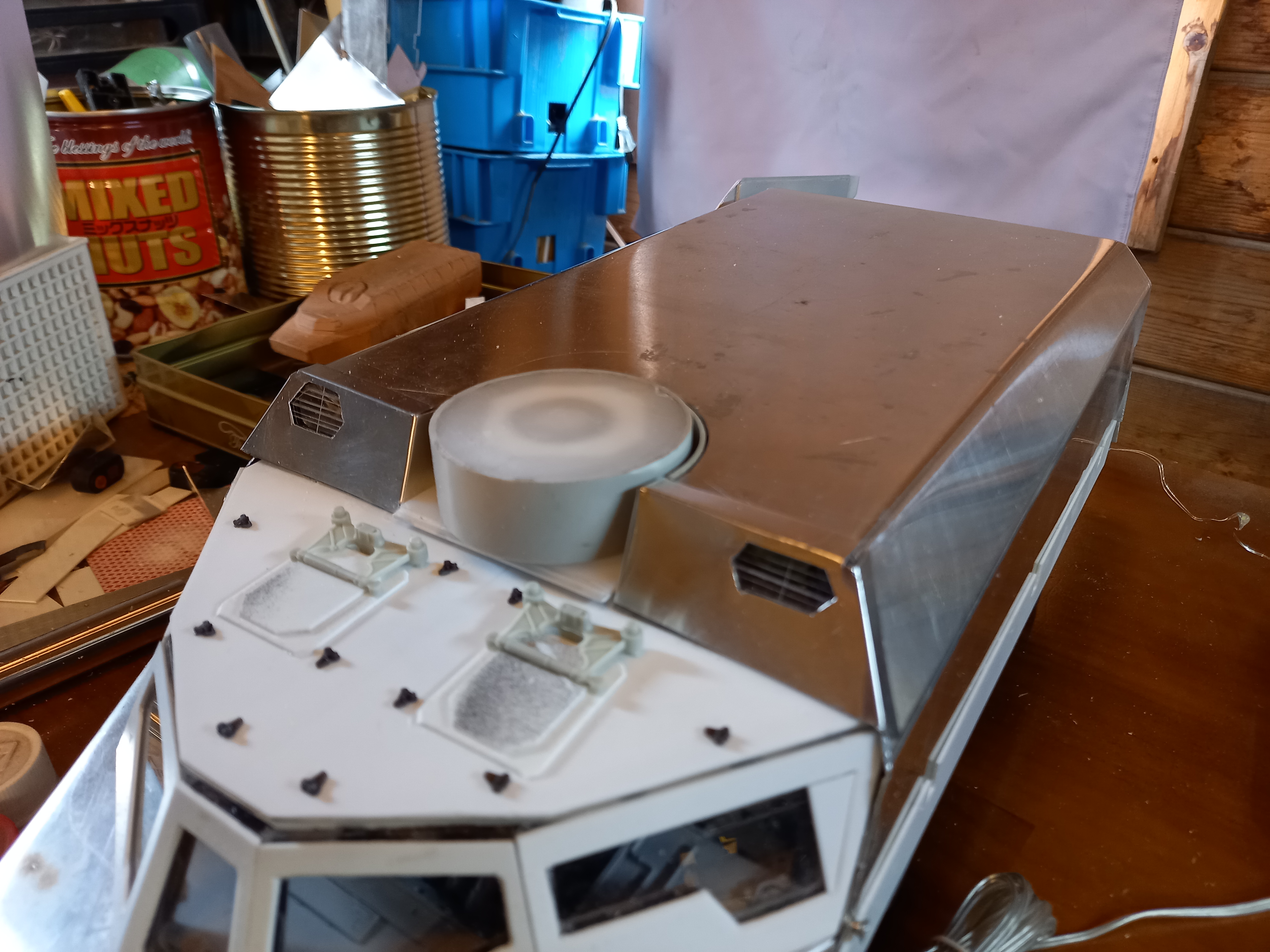

Actually, I haven't think about the pop-up and elevating function for the turret until I read Tom-san's comment.

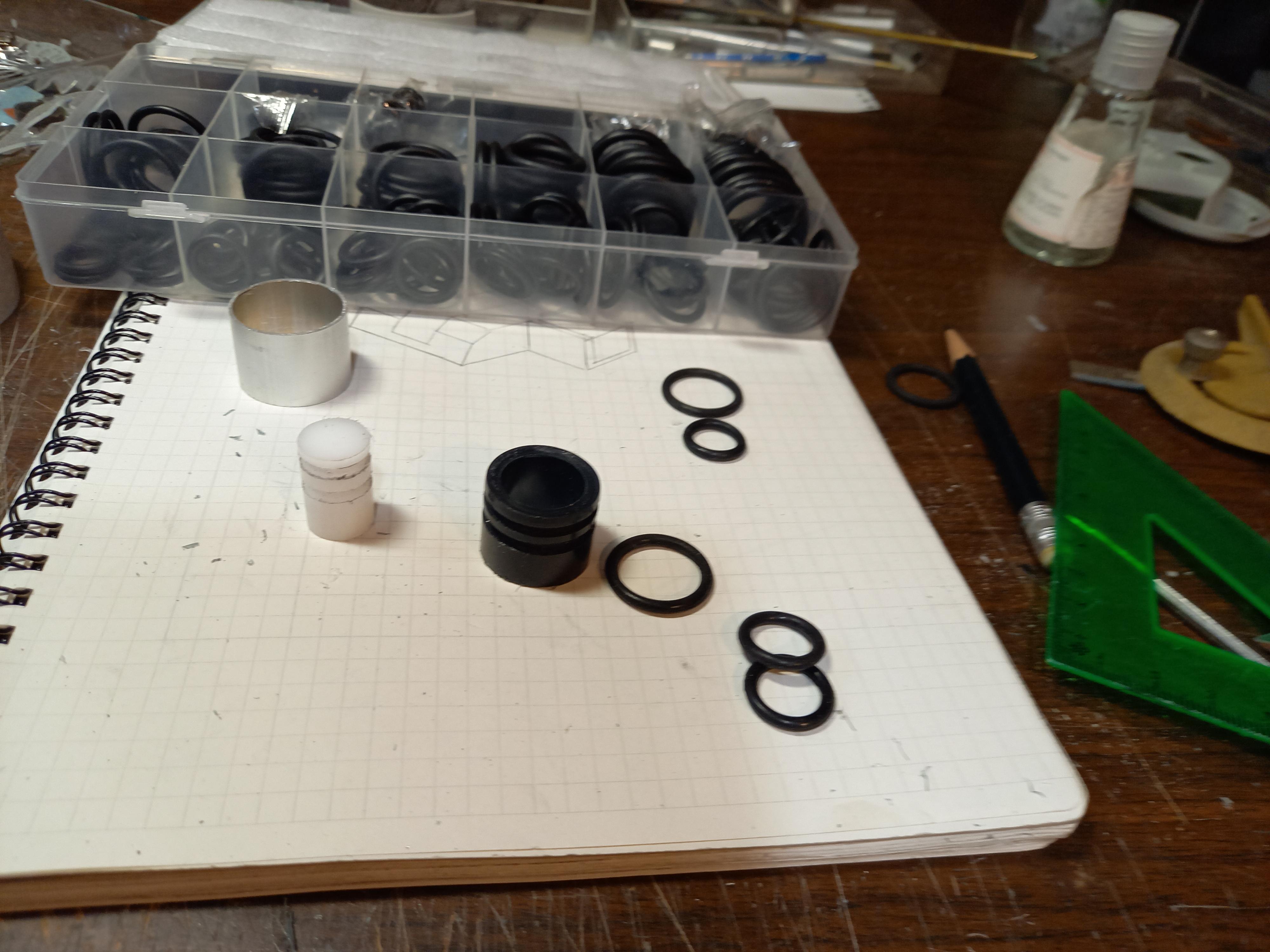

I thought it's interesting. The turret needs to elevate more than 20 mm and hold still at that place. Also, it needs to rotate 360 degrees. It may need appropriate friction on the axis of elevation and rotation.
Look around and seek for something I could use as usual.
Water pipe, aluminum pipe, and O-rings.
I had cut them up and engraved a pair of the trench around for the O-rings.
And put them on a turret basis.
This turret will be a bit more complicated in shape later.
Poping up and rotate in good friction.
That was really fun to build. Thank you Tom-san!

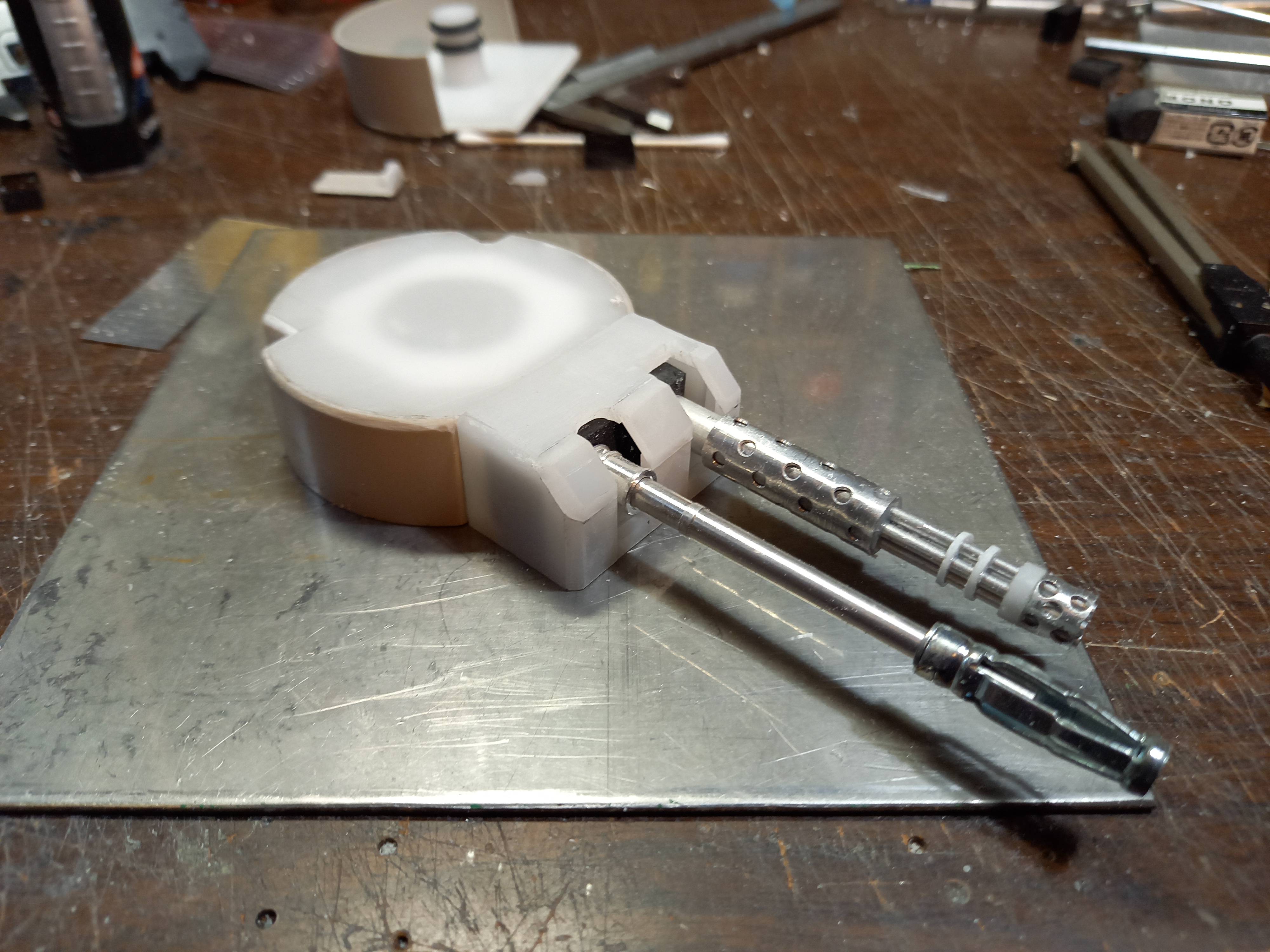

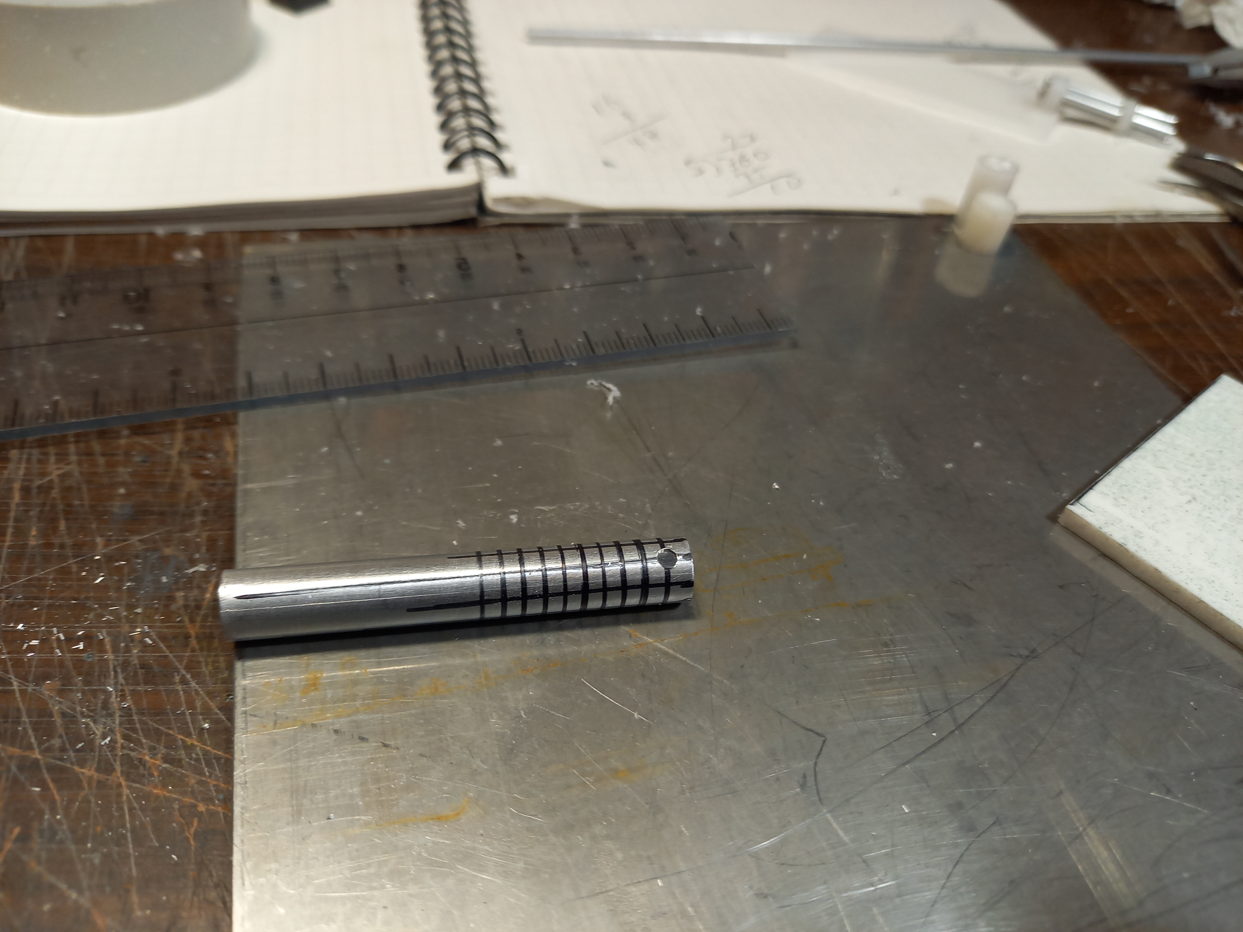

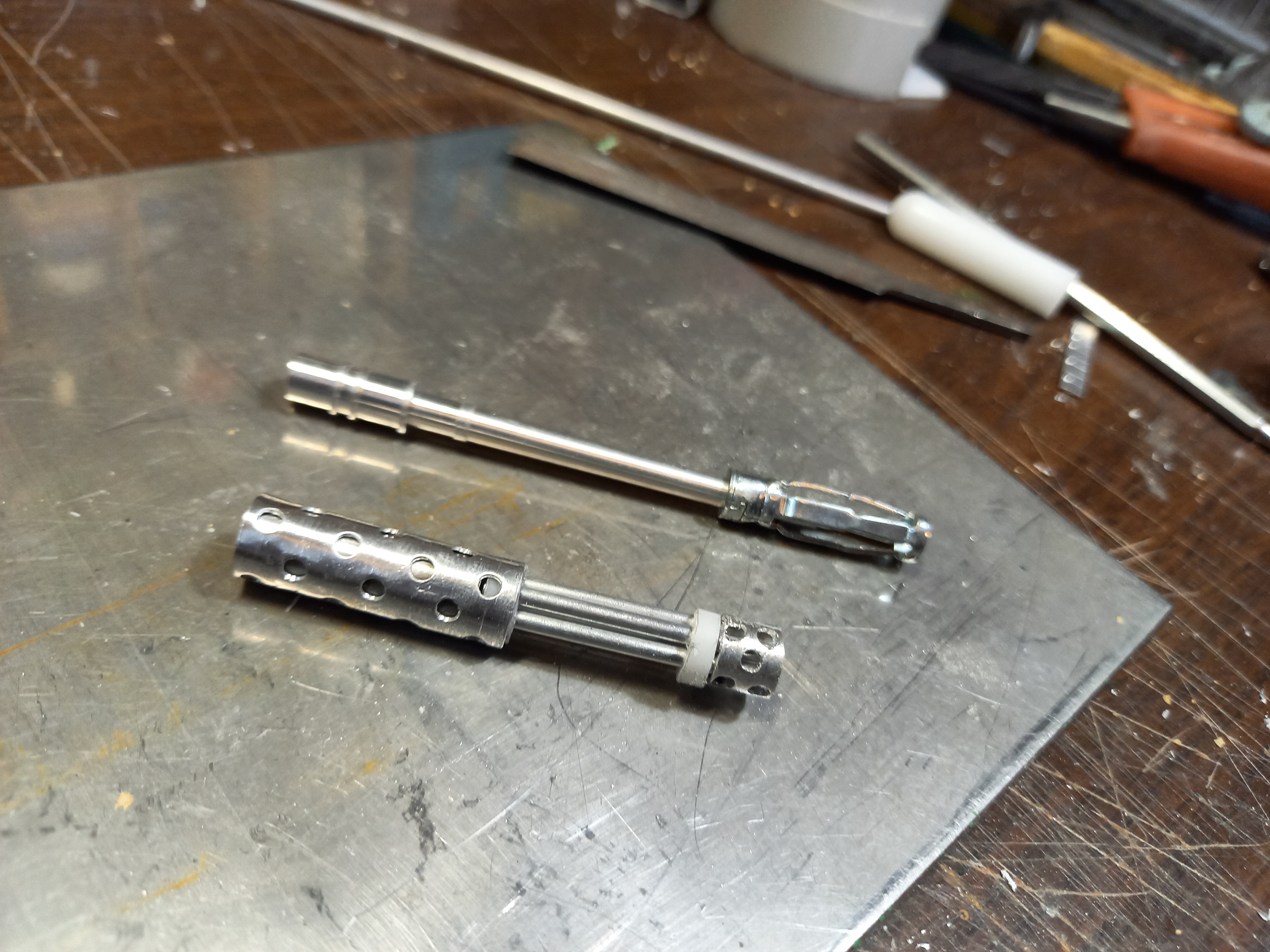

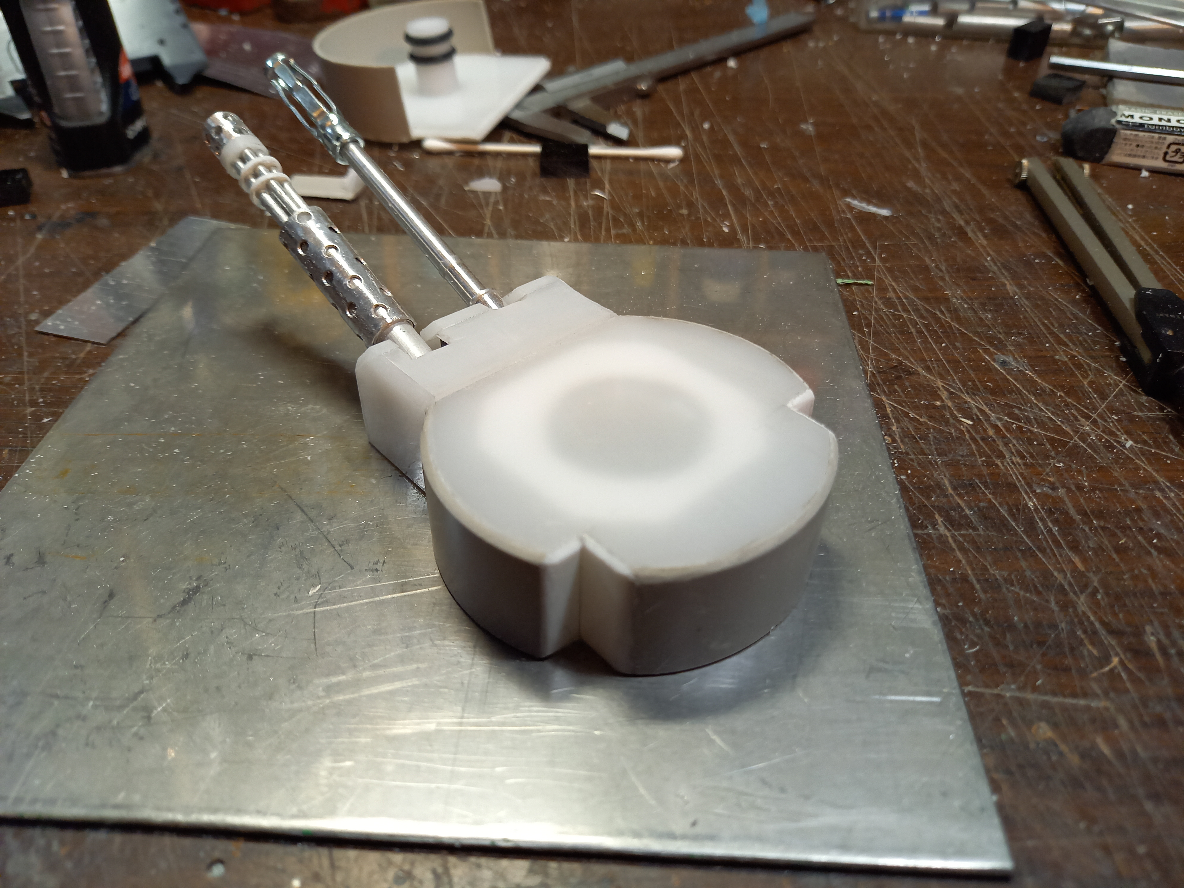

This time I am going to put a 40mm automatic cannon as the main weapon. So the flame thrower is almost identical in shape to the main gun. So, I decided to put a 5-barrel Gatling gun as a sub-weapon.

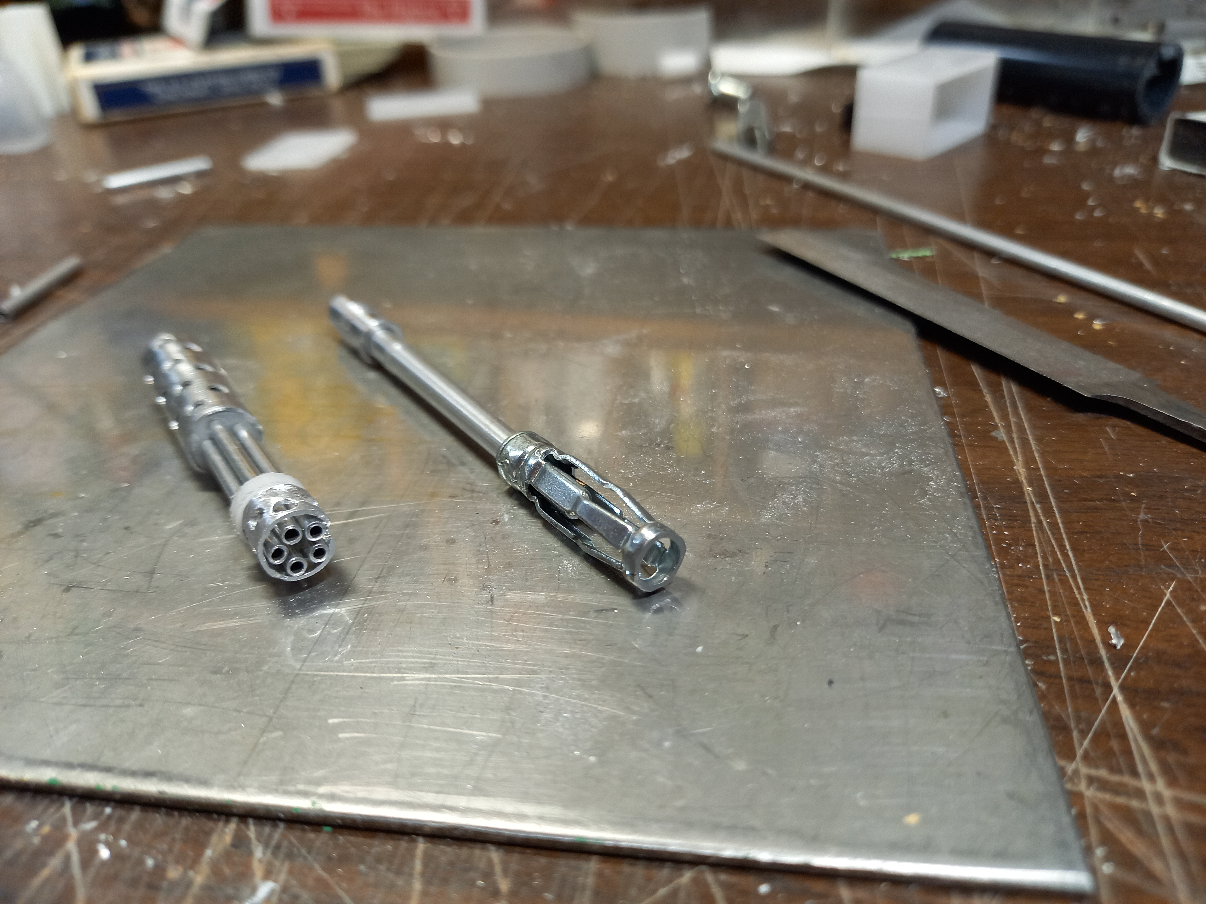

This time, I want a shroud- is this a right word?- around the barrels.

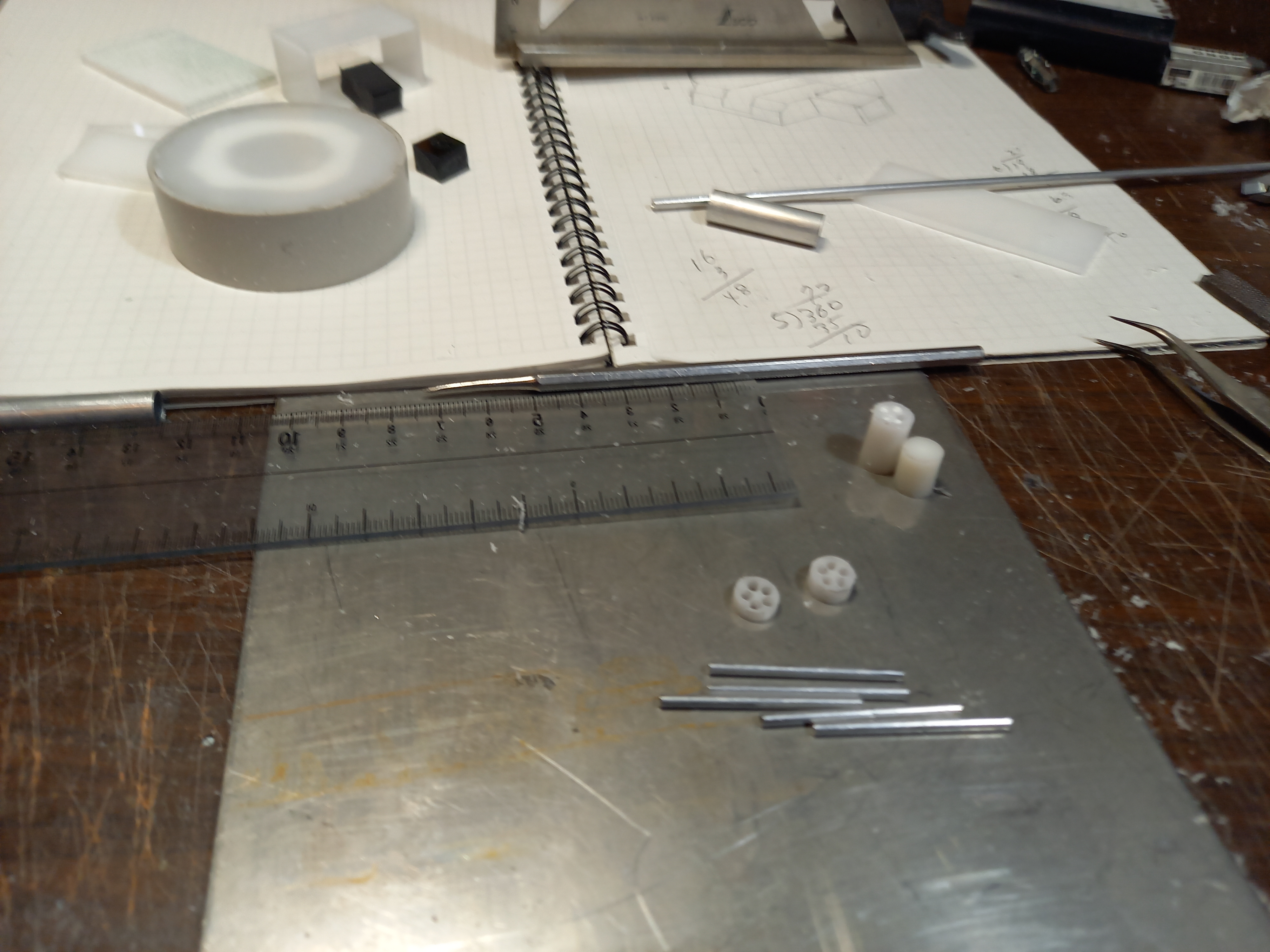

The cylinder with many holes around it. Smaller one and a large one.
I made a smaller one with drilling holes on a tube. That was so difficult to make a hole in a straight line.
So I had to make it much longer than I needed and pick up a fair part.
I made a large one in a different way.
Drilling holes was easy but to curl it to the cylinder was a job.
I really hate drilling holes in the precise spots.
At the moment like this, I really think I wish I had a 3D printer.:unsure:

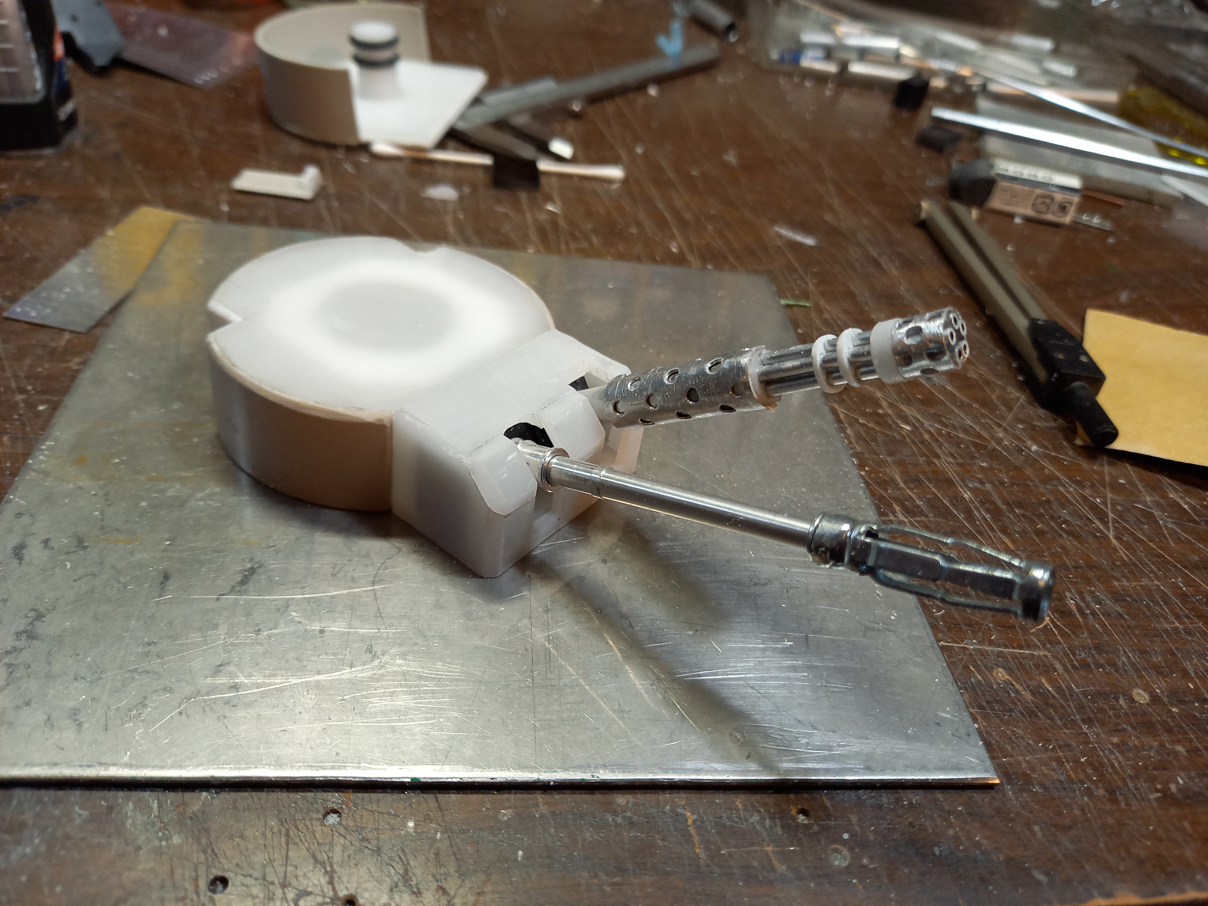

With a barrel of 40mm cannon.
It took 4 and half hours.

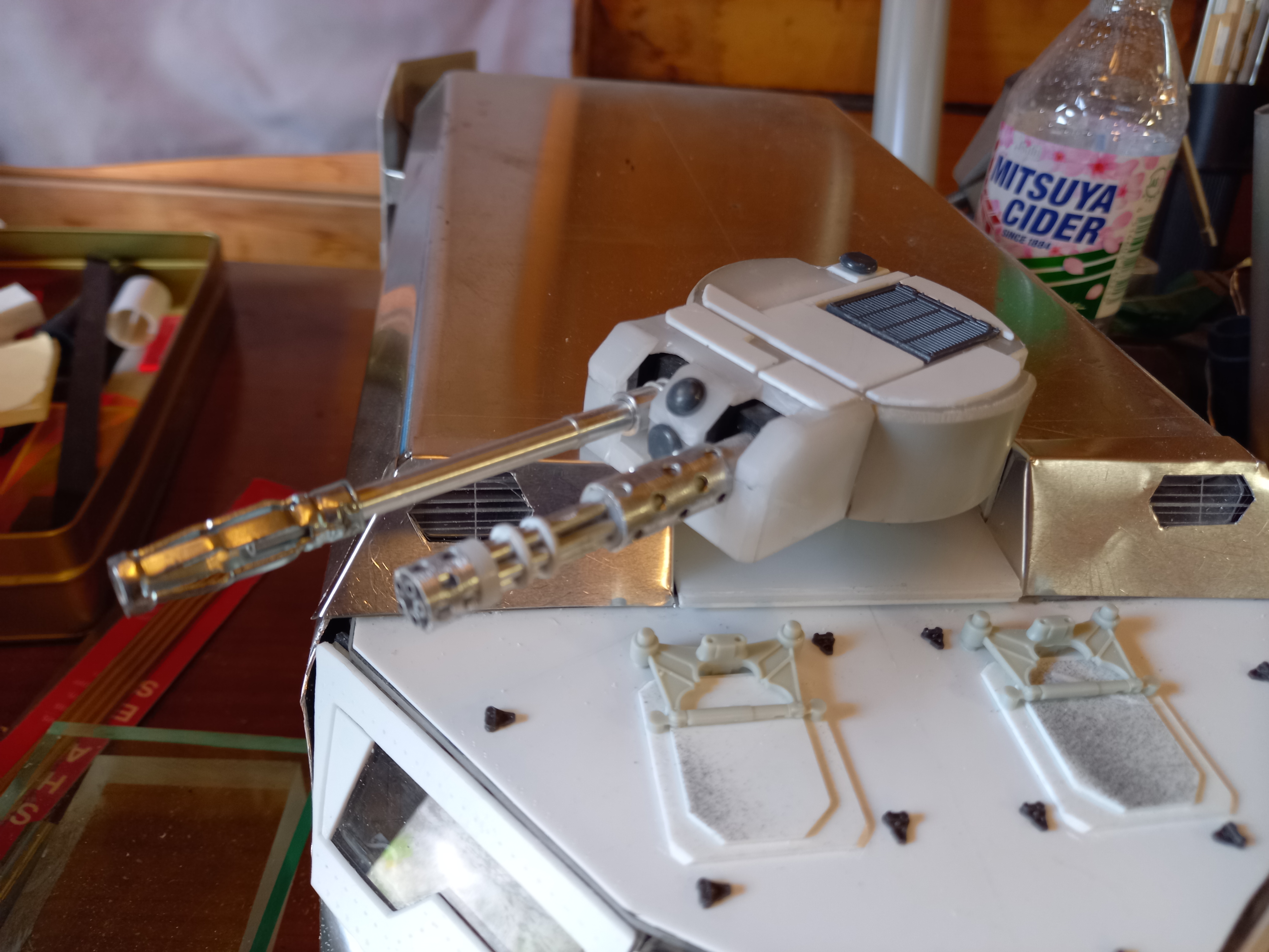

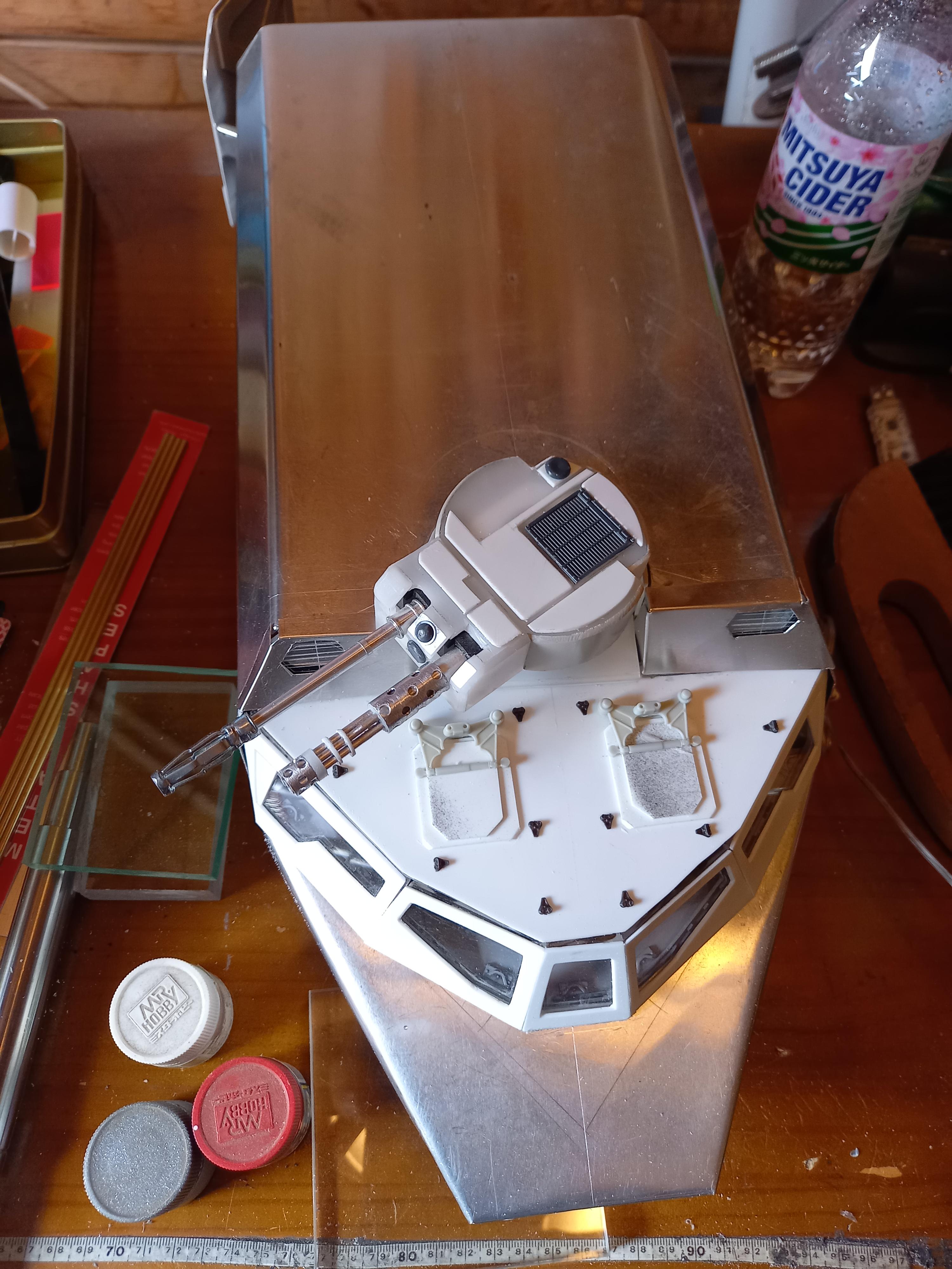

Love the turret! Wow, that looks really cool! I've noticed that wall anchor sleeves make really good gun tips and bombs in your projects. ;)
Oh, and a wicked looking 40mm shell lying there.
One detail suggestion comes to mind. After the turret pops up an armor shield for the post needs to swing around from the back to protect the hydraulic lift. Could be as simple as a concentric half circle against the back turret well wall that spins around center post. Basically a double half cylinder wall.

Wow, fire power on that one for sure o_O (y) (y) Question Katsu-san: will it still fit under the main drop ship with that big Mother turret?
Oh, I see. Let me see what I can do. Thanks!
