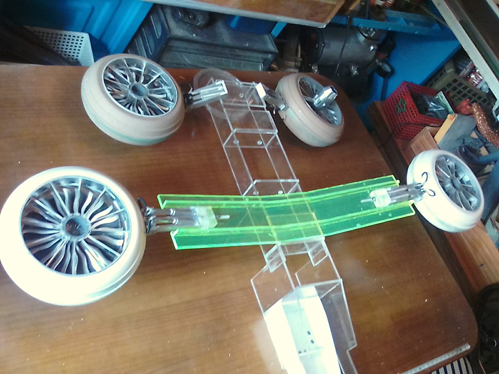

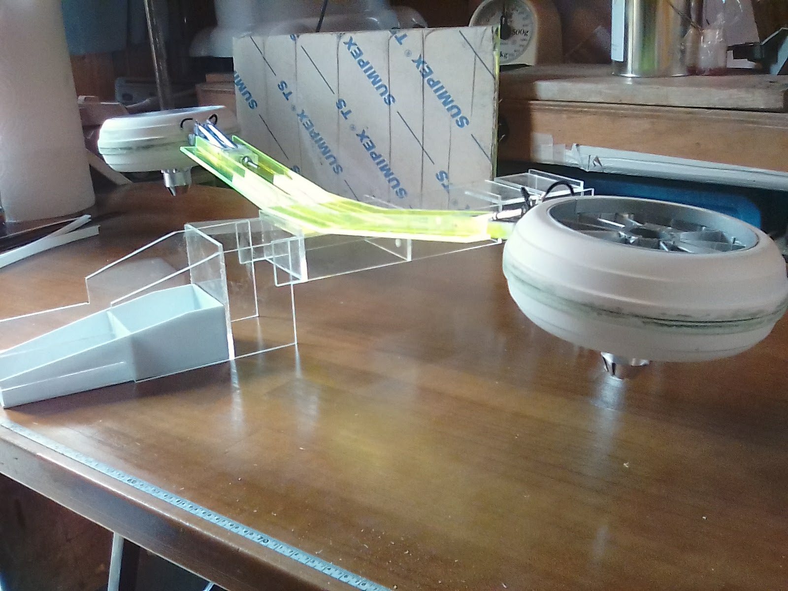

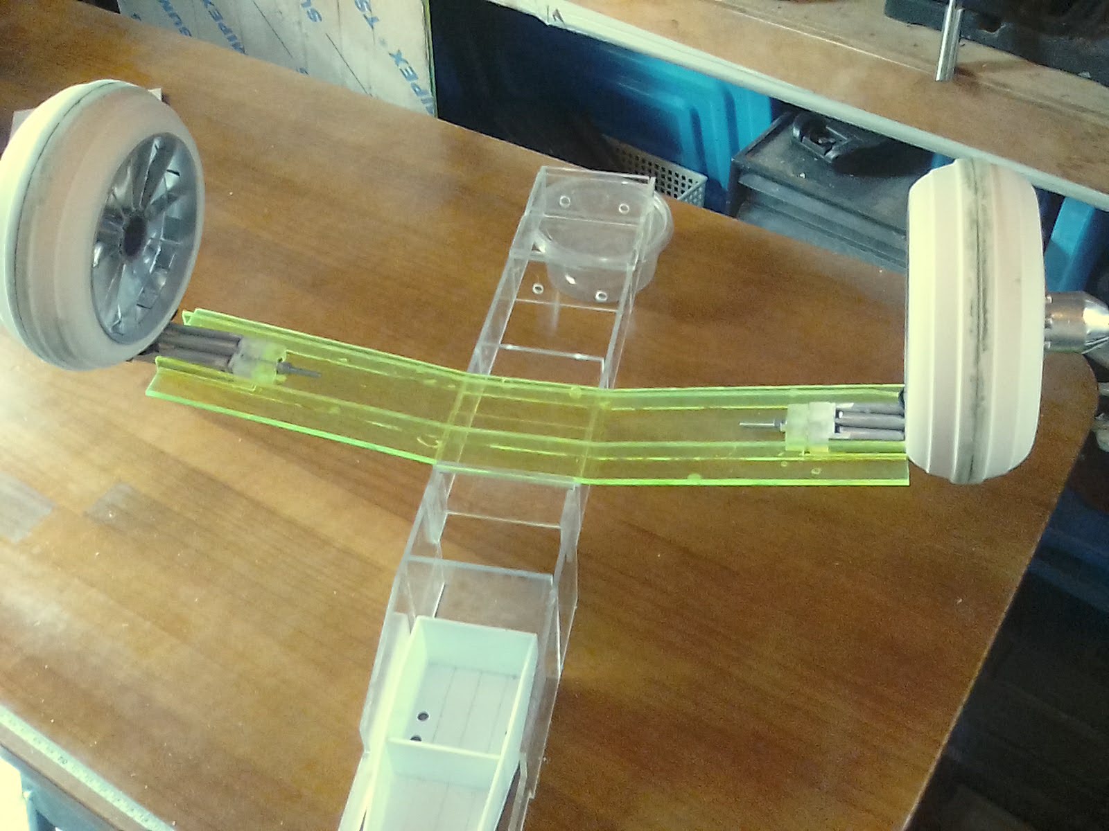

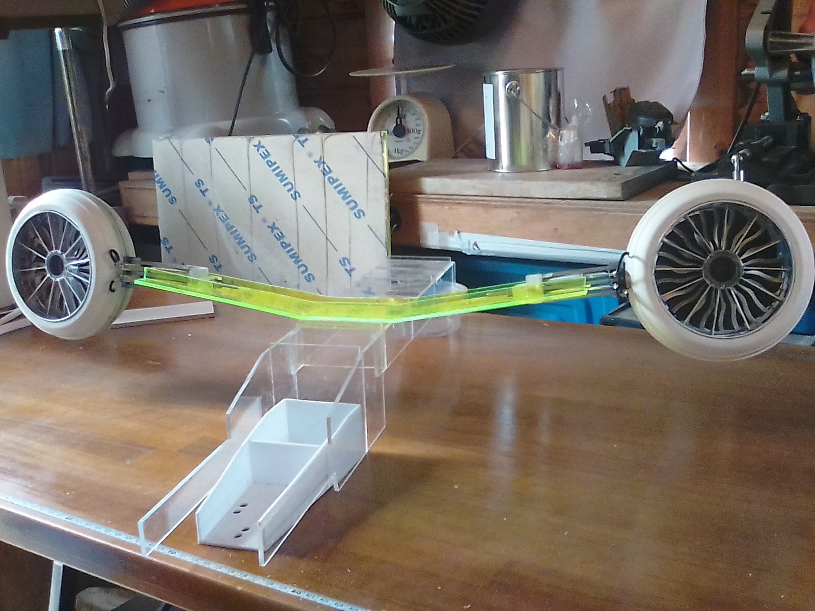

I made a structure of the wing.
Dihedral angle is 9 degrees and I have set these nacelles to the wing tip.
I'm gonna add a pair of flaps and flap actuators on a trailing edges.
I want to try to build a double slotted flap but, huum... it will be too much to me.
Thank you for looking,

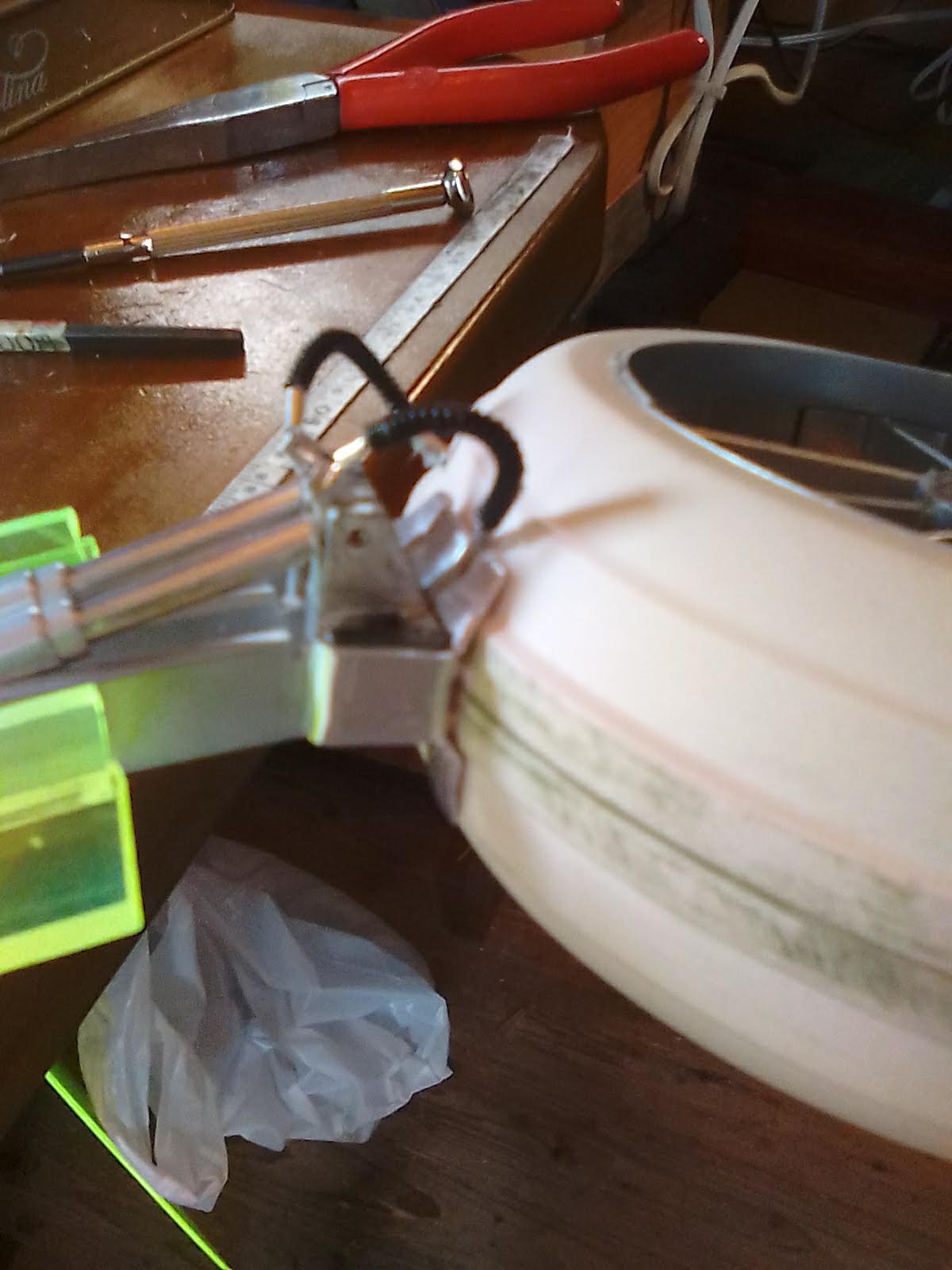

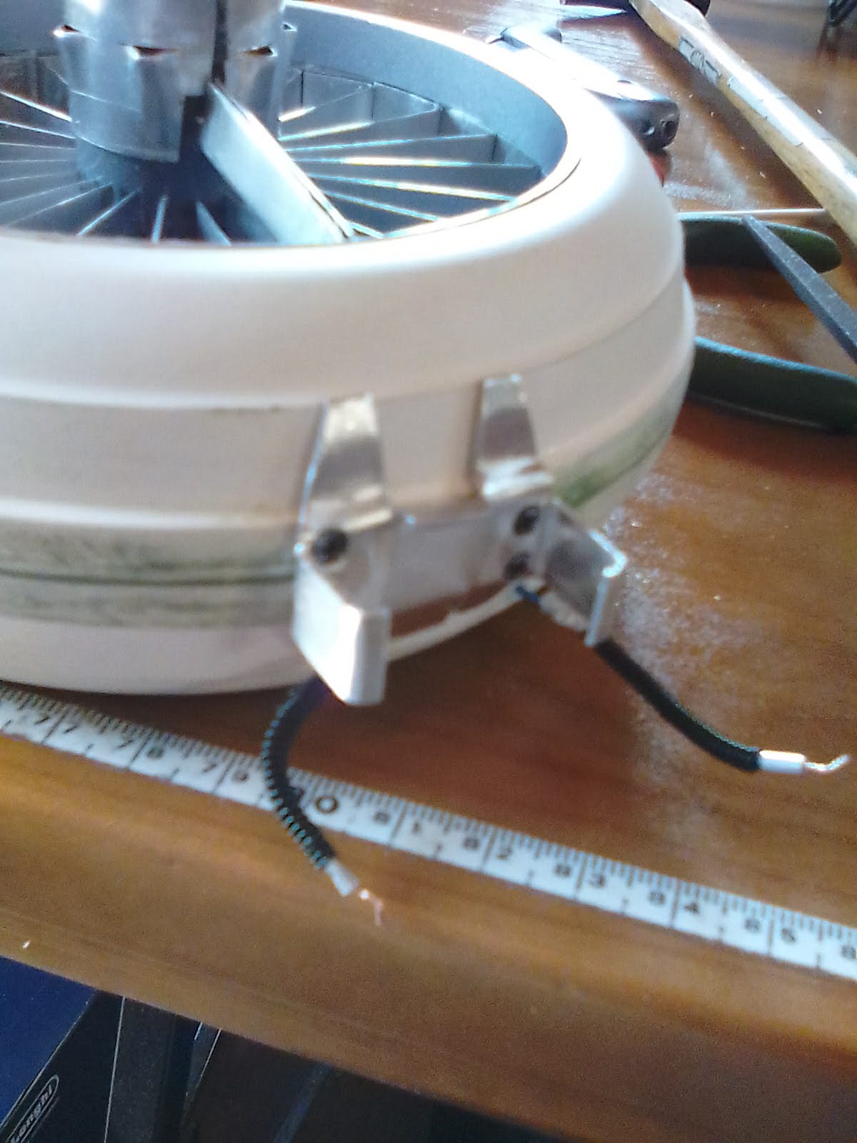

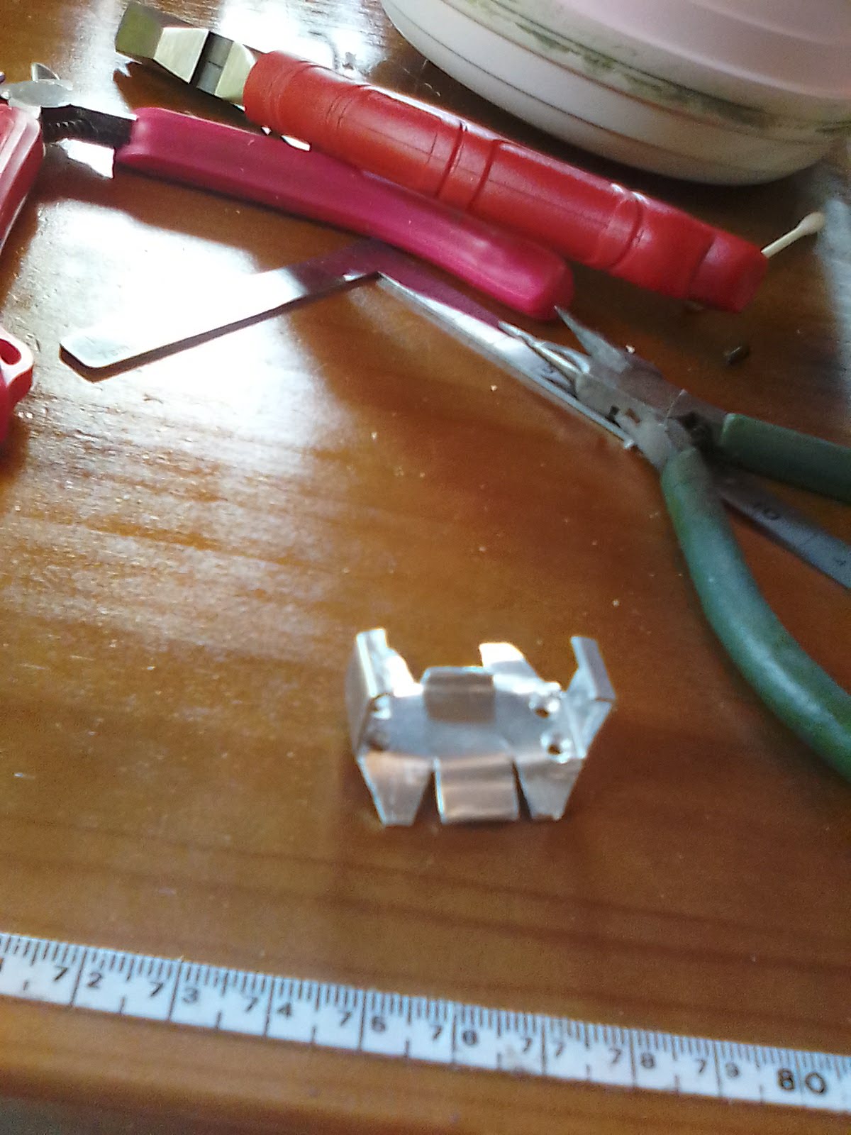

Today, I did a small metal works to connect the nacelles strongly.
Because I have been afraid that if I give it poor job on the connecting point it might even torn off sooner or later.
This metal piece is made of 1 mm thick aluminum sheet and be fixed on a nacelle with four screws and hold the hinge with claw.

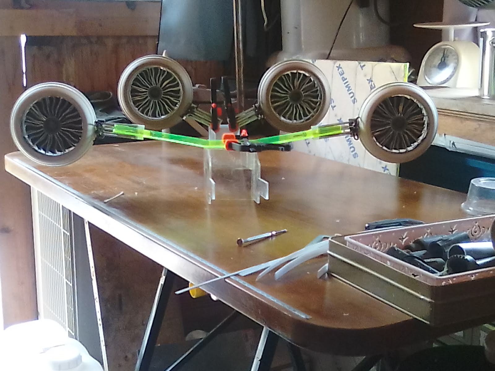

This is the view from the nose.
I designed this arrangement to avoid the jet wash of front engines interfere the aft engines.
I checked several picture of those quad duct fan engine aircraft. Most of all was designed opposing to mine. unlike mine, front wing is short span. But it's OK with me, my baby carries multi tons AAV and armed with many bomb and rockets under its front wing.
