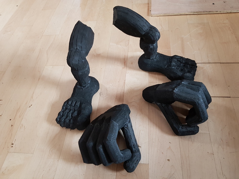

With arms we need some hands.... these are just fixed in a closed or holding position, again because the little only needs to hang about and not do much :D
simple palm and fingers....

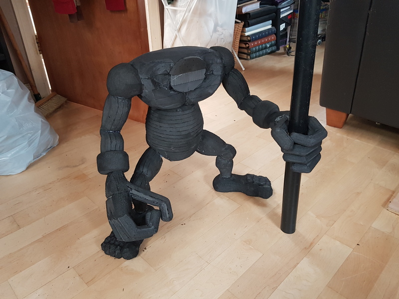

Now the legs where made the same way as the arms, layered up, shaped with the dremel... here is a quick pic of them roughed out and next to one of the boots...
This morning I just happened to wake up silly early so i got the dremmel out and shaped the hands, legs and feet...

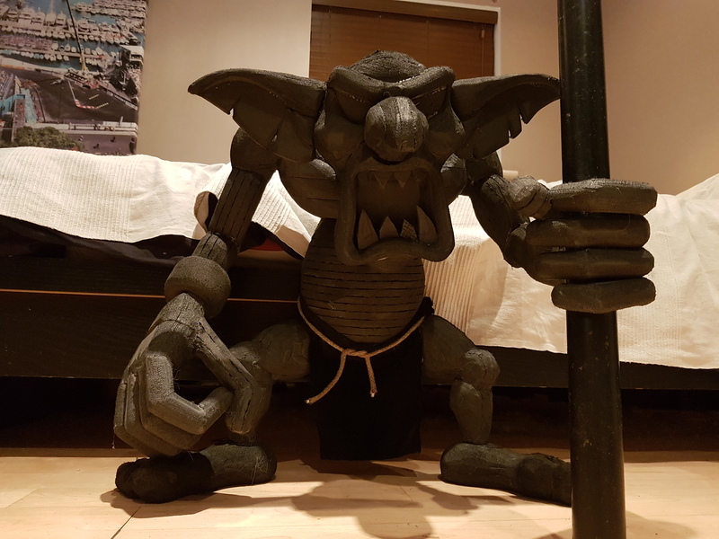

Then with dowels again just offered them up in place.....and maybe stuck a big piece of pipe in his hand.....
And then maybe drew a face on a piece of paper and stuck it on..... because I'm a bit of child!!!

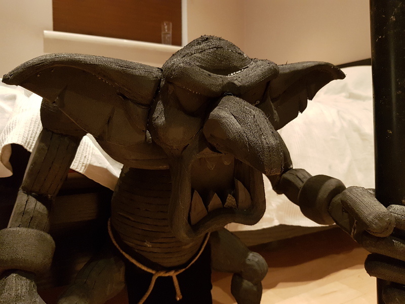

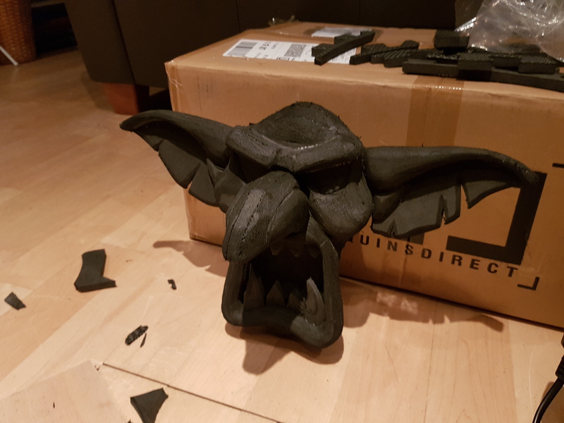

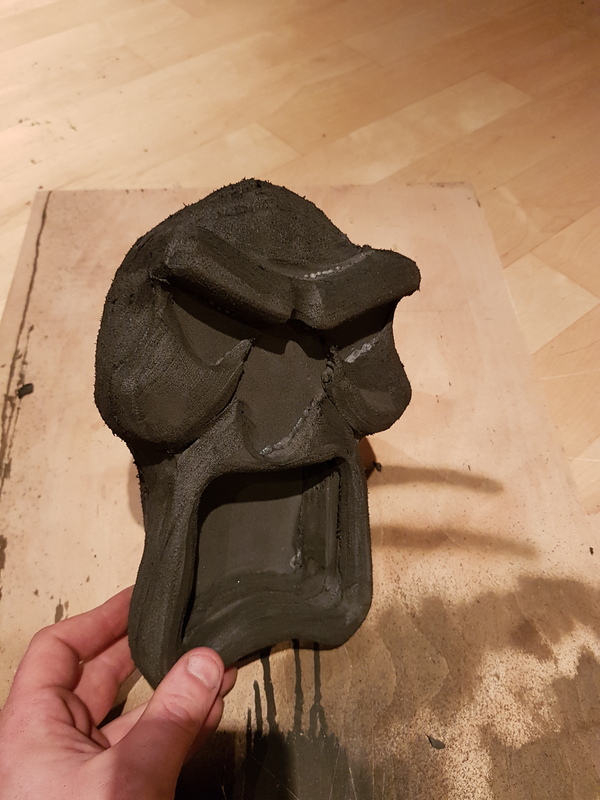

I didn't take a huge amount of pics doing the little head as i was on a mission to get it done.... I did it the same way was the legs and arms..... layered up some foam and hacked away at it before using the dremmel to finish it off.... once i had the basic shape i added some extra smaller pieces of foam to shape for the face.... the ears and nose where done separately then stuck on.... couple of pics.... not perfect but should do the job for what i want the little guy for....
Basic face shape....
The head together....
For now i have just used a dowel on the neck to hold the head on so i can take it off when I 'skin' the body.... I will get pics of that while I'm doing it....
Ok so just a quick one, I started skinning the body with a stretchy 2mm thick fabric.... which covered the pretty nicely to be honest.... though i wasn't happy with the look and painting fabric is a nightmare... so after this i sprayed the fabric with a few layers of spray glue which when dry should look kind of skin like i hope... i wont really know until its undercoated.... looks promising so far :D
with a bit more done....
then the face with the glue coat.... I will undercoat from here likely tomorrow once the glue has really gone off.... Not happy with the feet as they lack definition so i may make some busted up shoes for him... requires some though.... anyway one of the head....
