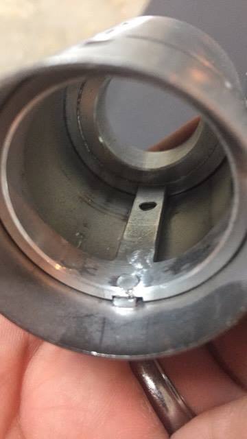

So do we have to trim the threads on the top transistor? Mine wont go in all the way.
I wouldn't trim the threads, I put the chamber together, then marked the screw hole with a sharpie. Disassembled the chamber and drilled the sharpie hole just a little deeper and wider so the screw threads fit in it
I was going to do that but...yeah, lazy
I drilled and tapped the area under the top transistor. I didn't want to trim the threads because I was afraid it wouldn't be as sturdy. FYI the thread size on the transistor holes is 8-32.

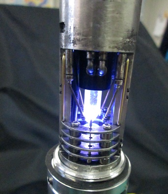

Btw Erlo--I like the dual crystal setup you have going on. I had the same idea. Looks more "visual dictionary." Nice!
I got this in the mail last night. DUDE. Super slick. This definitely completes my special MK1 that my lady bought me for Christmas.
i also drilled and tapped the top hole and it turned out fine. Took maybe two minutes in total. I can also confirm that the transistors are 8/32.
