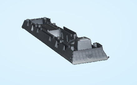

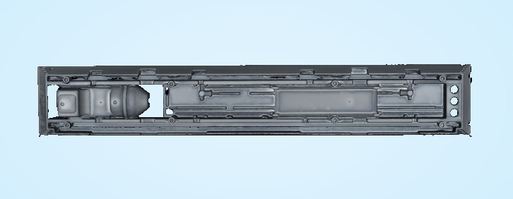

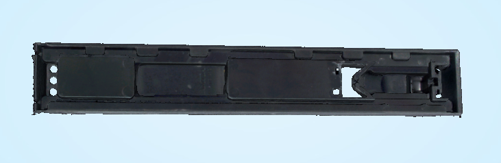

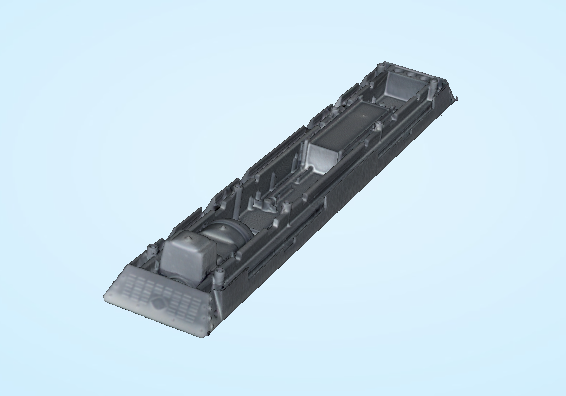

Tamiya 1/35 8Rad (Modified) Lower Hull - used all over the place on Y-Wing and Millennium Falcon and others.

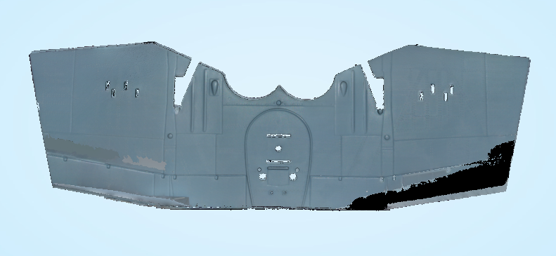

Can't tell -- it seems to be the "thinness" of the part at the trailing edge. But leading edge also wonky. This was done in raw blue plastic state, with some baby powder sifted on -- so next I'll spray paint it flat white and see if I can get the scanner to "pick it up" better.
But this is truly exhausting -- four hours, and this... and the recognition that each piece is going to be this time-consuming.
I have a crude old David Scanner setup (now HP 3D Scan) and I often see this with glossy reflective surfaces like plastic. Sometimes it seems like the laser or structured light is reflected directly back to the camera like a highlight in a photo. The software cant make sense of this.
As suggested by Jedi Dade, different orientation of the subject can sometimes fix this, or applying a dull coat to the surface.
Having spent a ridiculous amount of time trying to scan surfaces I understand you pain.
I can say however that the quality of scans seems to be really good!
Almost... spent all day on it yesterday, and for some reason the upper left wingtip/backside isn't getting "picked up" so I'm still figuring it out. The front looks great, but I'm concerned that if I make a watertight mesh with what's there it will create a baloon-bubbled hot mess again.
