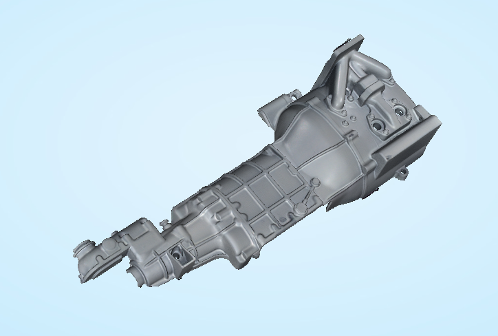

Studio Kitbash, you've had the scanner for a couple of weeks now... When are we gonna see the first scan? I'm really excited to see the results! :D
The scanner came: awesome.
Then the computer said: Insufficient Memory
So, new computer, new software, troubleshooting, testing, and then...
"8 seconds per scan"... that's what the marketing and advertising for the scanner says.
8 days later... the learning curve is still very steep.
Day One: Set up scanner on kitchen table, excited like a kid in a candy shop - clear/colored object scanned -- no good
Day Two: Light adjusted, move set up to basement -- no good (computer giveing "insufficient" memory problems still)
Day Three: Get/install new computer, software glitches, tech support -- no scans, day of frustration
Day Four: Try scan in new "vampire" basement dark room conditions - no good
Day Five: Spray paint object with grey primer -- no good
Day Six: Spray paint object matt black -- no good
Day Seven: Tech support with Scanner -- no scans today, but some better clues as to how to get results
Day Eight: Spray paint object flat white (on top of black, on top of grey primer) -- RESULTS (9.9 million points scanned!)
Day Nine: Some really good results, but still some holes and wonkiness. So One More Layer of Tamiya XF-27 Flat White (the object you see below has 5/6/7 layers of paint on it, so beware that some of the scan is lacking in precision not as a function of the scanner, but as a function of layers of paint applied. Future scans will have fewer paint layers added, and thus be even higher-definition)
Day Ten: Very Good Results. Try to post RESULTS to RPF, but this is not possible: "The attached file is too large and cannot be uploaded." This message arrives again after compressing file to Zip file for minimizing.
So I can post these Snips instead:

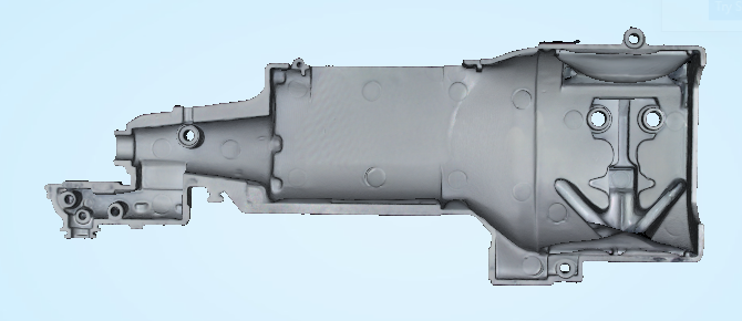

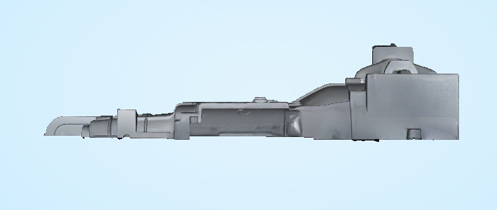

Overhead view
Bottom view
Top view

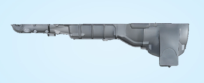

Underside view (here is where you can visually "see" the most errors - I'm hoping this side doesn't matter to folks)

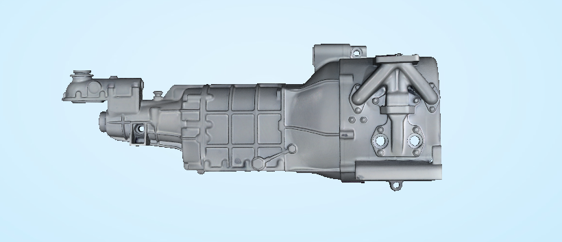

Quarter view
PM me for the actual file of the results, and then test-print it. I want feedback on how it prints out in ABS, in PLA, in resin, on a Formlabs2 and on an Anycubic or Photon printer. I want to know if it's "good enough" or if it still needs tweaking. Cuz this took WAY longer than I thought it would..
Meanwhile, like everything else in this hobby, practice your personal patience: the learning curve on 3D scanning is a lot steeper than I imagined.

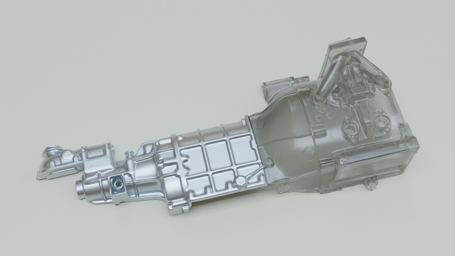

Just to let the community know... I was able to print this model on my FDM printer... it was too large for my Resin printer. This was the first successful thing I printed on my printer. As such there was some learning curve failures with Slicer settings, print temperatures and bed heights... but it printed proving that Studio Kitbash's efforts to scan the object were successful. Now in the interest of full disclosure the print isn't perfect - its my first successful one and I'm confident that the quality can only get better from here as I learn to dial in the print settings. when I get home form work I will post a picture of the raw print... just taken off the print bed and wiped a few "strings" of PLA off. I think you'll see that while a bit rough with some TLC could actually be used for a model.
