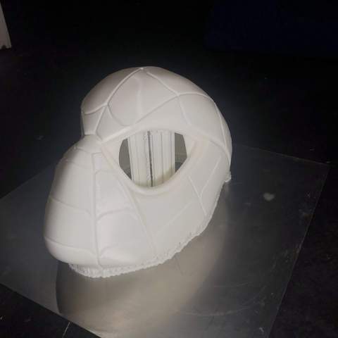

After scaling the armor as best I could using Armorsmith Designer, I printed out and finished the helmet first, then all the armor pieces.
The helmet was easiest because it had a LOT of smooth surfaces and minimal webbing compared to the armor pieces. It was also the most fun and rewarding piece. After sanding it thoroughly, I primered and painted it. Then I printed out the lens "rings", and applied this really cool metal mesh to the inside! This mesh is excellent because unlike other Spider-Man lenses, these won't fog up because there's no need for a reflective film! These are shiny and really fine mesh, yet let air through! I also used some elastic to hold the back piece to the main helmet body, which lets me get my head in and out of the helmet.

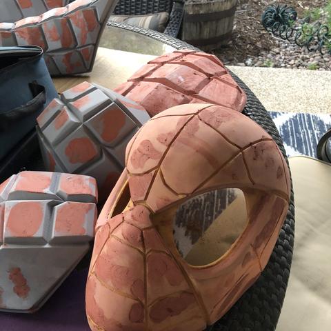

Once everything was printed out, I spent about a week sanding! I kid you not, this took about a week to sand because of all the little indentations across each piece because of that "webbing" look. It was absolutely horrible! I even used a mouse sander, bondo, and all kinds of sanding tools to make it easier, but it was just a ton of work. I feel like that's all I did throughout the month of May.
Good thing that due to COVID-19, I wasn't going anywhere!
My process was to sand everything down using the mouse sander, even getting into the web crevices where I could using 150-grit paper. Then I switched to 220-grit sandpaper and hit everything again with the mouse sander. The main goal with the mouse sander is to get rid of as many layer lines as possible. After that, I used some Bondo to put an even layer on the flat surfaces, and mainly to fill in the web crevices where I couldn't really sand out the layer lines. This great Bondo putty helped to fill in those webbing gaps in-between and fix any issues as a result of the 3D-printing process. After application, then I went back in with my 220-grit mouse sander, then sanded the bondo in the crevices by hand and using some sanding files I found on Amazon.
Then came the primer! I use Rustoleum Filler Primer whenever I have these 3D printed objects that look a little rough no matter how much I sand. It works great, and after a few coats really smooths things out! Of course after I'd coated everything, I then took the crucial step to let it sit for 5 months!

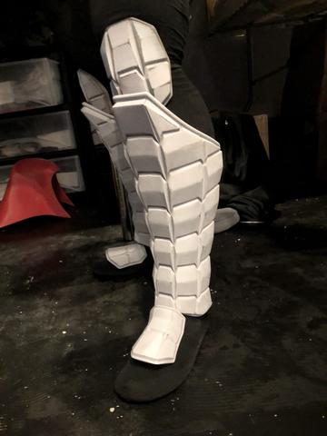

Of course I did a little test fit of all the armor. I'm noticing that I must have accidentally printed the wrong scale of shin armor, as they are a bit too long and dig into my ankles. I'll have to modify those.
And, I'm noticing that my body type is not quite right for this. While my upper body looks alright due to my broad shoulders, my legs just aren't cuttin' it! With the help of a muscle suit from Flex Design Costumes (the same I've had for years), this suit looks a lot better!
