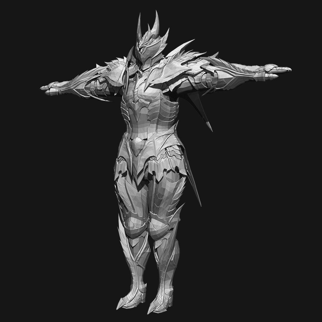

I started by extracting the in-game model.

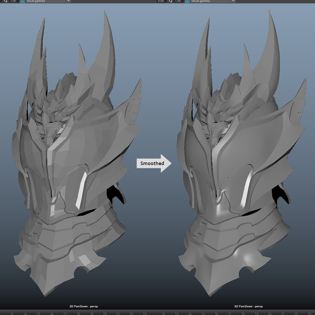

Smoothed the geometry...

How do you extract models from this game? And what program do you use?
I used a Nexus Mod called MHWorld Chunk Tool. That will uncook the game models and allow you to navigate through the game files to find any particular model. Had no luck with the textures though. It will extract the models into a .mod3 file format which you can use the Blender Mod Mod3-MHW-Importer-master, to import them into Blender, then export them into what file format you please. Be warned though, you have to use a specific version of Blender for the mod to be compatible. Forgot which one.
I use Maya as my main 3d modeling software to clean up the geometry, add details back in, and make them 3d print ready. ZBrush for organic texturing.

Hi! Do you use blender? How do you smooth the model? By hand point by point or with some modifier? I've tried all the modifiers and cannot smooth it as you have!
The helmet looks amazing! Good job on it.
Sorry to inform you. I do not use Blender; I use Maya. But how I do this is through two methods in my program. One such method is universal across most polygon based 3d software. In Maya I use a Crease feature that will protect a selected sharp edge from the Smooth feature.
The second method is a technique my teacher taught me in my 3d modeling Bachelor's Degree program.
Look at this top ridge.
You'll notice I have extra lines around the edge. Concentrating extra geometry in a small spot or line protects sharp edges or points from the smoothing process. This is how I get my sharp edges and creases on this project.
This technique should work with Blender's Smooth modifier.
