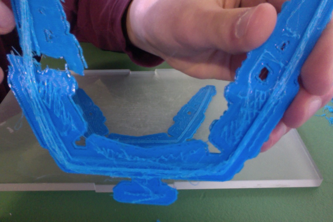

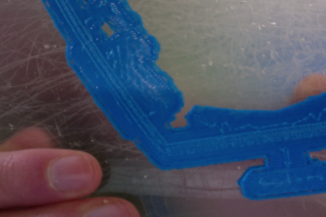

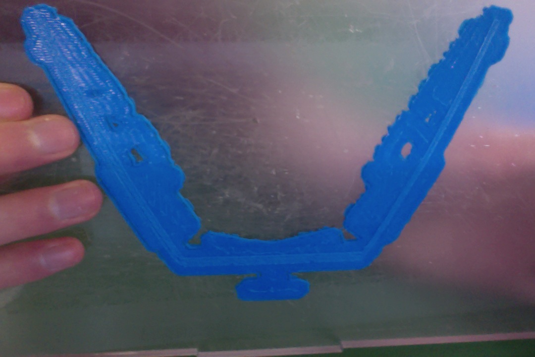

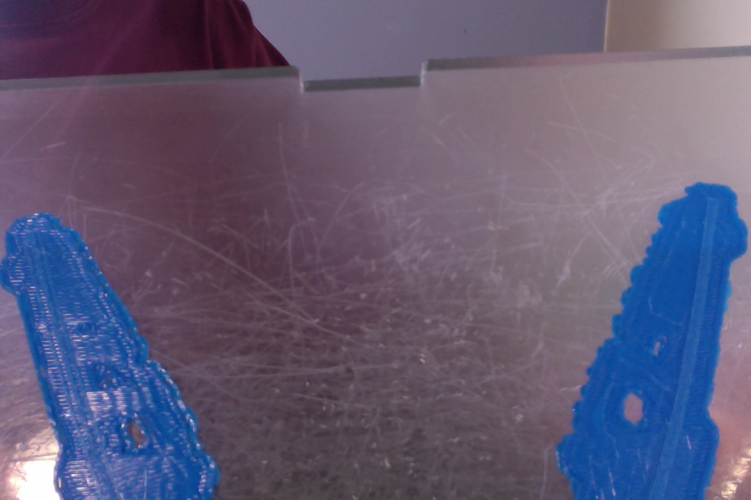

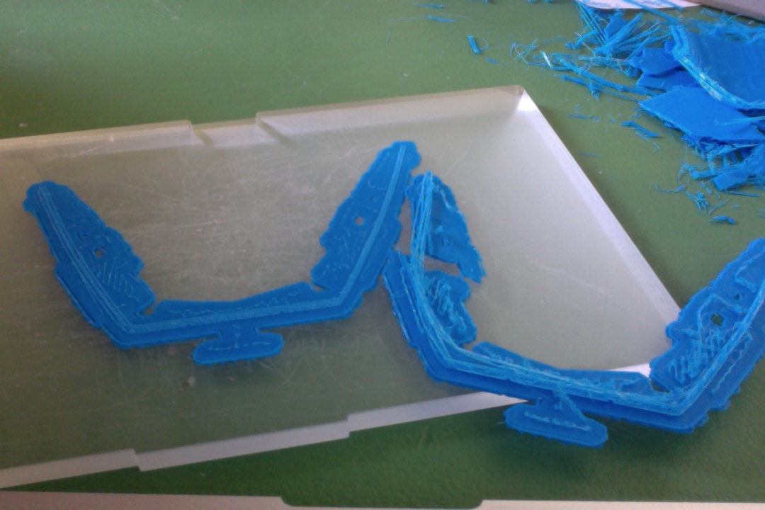

Re: 3D printed Iron Man helmet and gloves - Failed print HELP!
Two more failed prints.
Photo on 4-15-15 at 11.27 AM.jpgPhoto on 4-15-15 at 11.27 AM #2.jpgPhoto on 4-15-15 at 11.27 AM #3.jpgPhoto on 4-15-15 at 11.28 AM.jpgPhoto on 4-15-15 at 11.28 AM #3.jpgeditedprint.jpg
Here you can kinda see the difference in thickness on each side.
