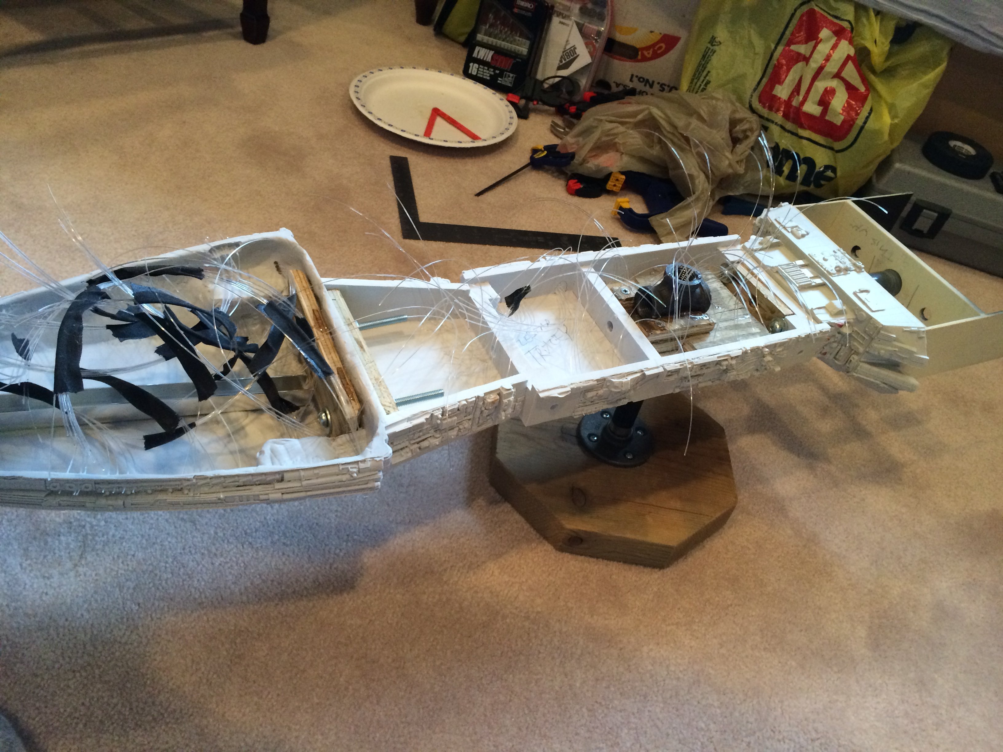

I have another general question. I have stuck approx 130 0.75mm fiber optics into my BSG and I need to group them together to not only get them out of the way, but to also attach them to individual LEDs. I have both 5mm and 3mm LEDs. How many fibers should I put in one group if I'm using the 3mm LED and how many in one group for the 5mm LED?
Ken
I think the best plan of attack is to get some styrene tubing, like 1/4 inch i think for the 5mm Led's. You can then route as many FO thru that tube as will fit. Leave the FO long for now, route the ones near each other thru the tube, using the tube like a sleeve to hold them all. You can then trim back some of the FO as you route everything so the all kind of terminate in the same spot, still being sure to leave a little slack so you can move them around. Then slide the tube so that one end can accept the LED, wrap with black tape to eliminate the light leak and hold everything in place.
I'm in the process of getting all the FO in order. I'm using TB syringes. They fit quite a few FO filaments and the 5mm LEDs fit snuggly into the ends. I have one question though. Can I spray the FO (and the interior if the model) with black automotive primer to prevent light leaks? Will it harm the FO like cyanoacrylate glue does?
Ken
Ken, I dont think it would hurt your spraying the out side of the model and the optics seem fine even though you will be snipping these off at the model I wouldn't use a aggressive paint like laquer paint. This is also my plan to paint all the model black on the inside. I would use a dollar store primer not auto. Thanks......Jim
